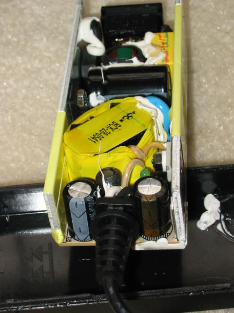

                              Initial impressions: looks fairly packed with a large transformer and main input cap, along with adequate input RF filter and decent heatsinks running the whole side length of the adapter walls. Also has a bridge rectifier (__206 part). The primary switcher is in a TO-220 isolated case (could not read label), and the output rectifier is a Y2010PN (i.e. most likely 20 Amp, 100V) also in TO-220 case. For a 12V, 3 Amp (36 Watt) power adapter, I think that's adequate.
                              What's not so good are the cap choices. Some of you may already have noticed the “KF” writing on the input bulk cap, suggesting this unit has CapXon caps. And some of you may also have noticed the problem too, already. No?
                              https://www.badcaps.net/forum/attach...1&d=1531433621
                              See it now? (I bet so! ) – Yup, bad caps… or in this case, just a single bad cap right after the output rectifier. The output caps and their arrangement is as follows:
                              1x CapXon LZ, 16V, 1000 uF, 10x16 mm (after output rectifier, before the PI coil)
                              1x CapXon KF, 16V, 1000 uF, 10x16 mm (after PI coil)
                              I decided to replace only the bulged CapXon LZ, as the other one tested okay on my component/transistor tester for both capacitance and ESR. The temporary recap was done with an Elite EB, 16V, 1000 uF cap that I pulled out of an LCD monitor many years ago (which had an issue not related to the caps, but I recapped it anyways).
                              That said, after replacing the bad cap, the power adapter function was restored. It now outputs 11.99V unloaded. Also, using the same 20W halogen bulb as a load, the voltage did not go out of spec. I don't remember exactly how low it dipped, but IIRC it wasn't more than 11.85V (which is not ideal but acceptable, I suppose). So the bad cap was definitely the issue here.

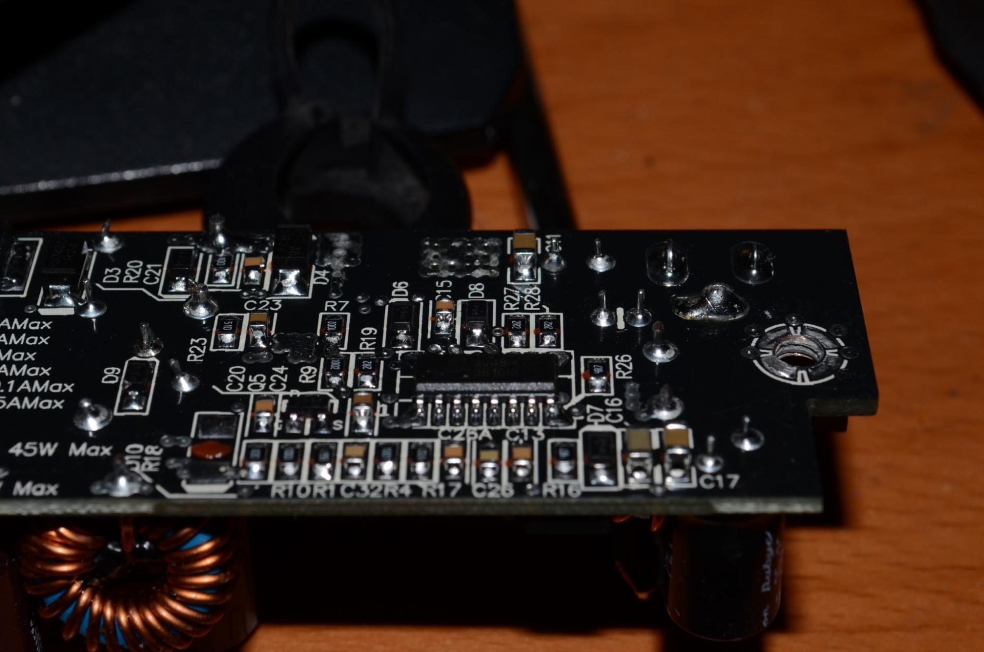

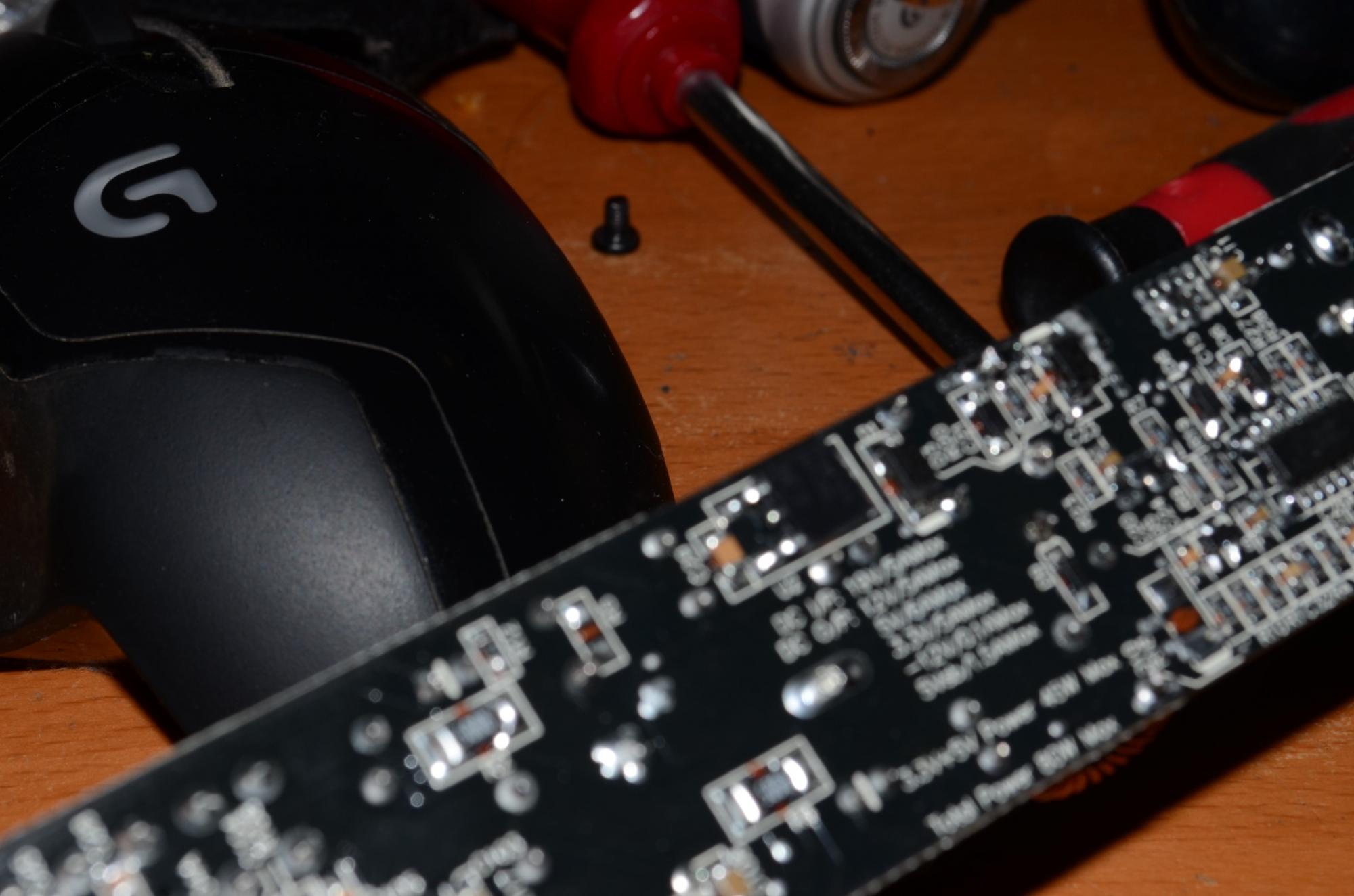

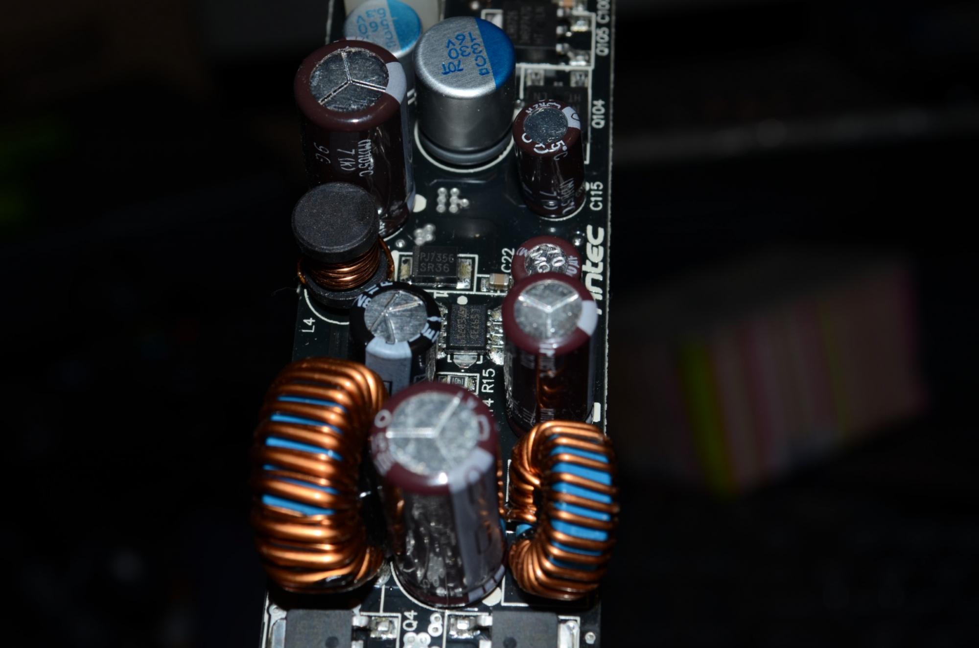

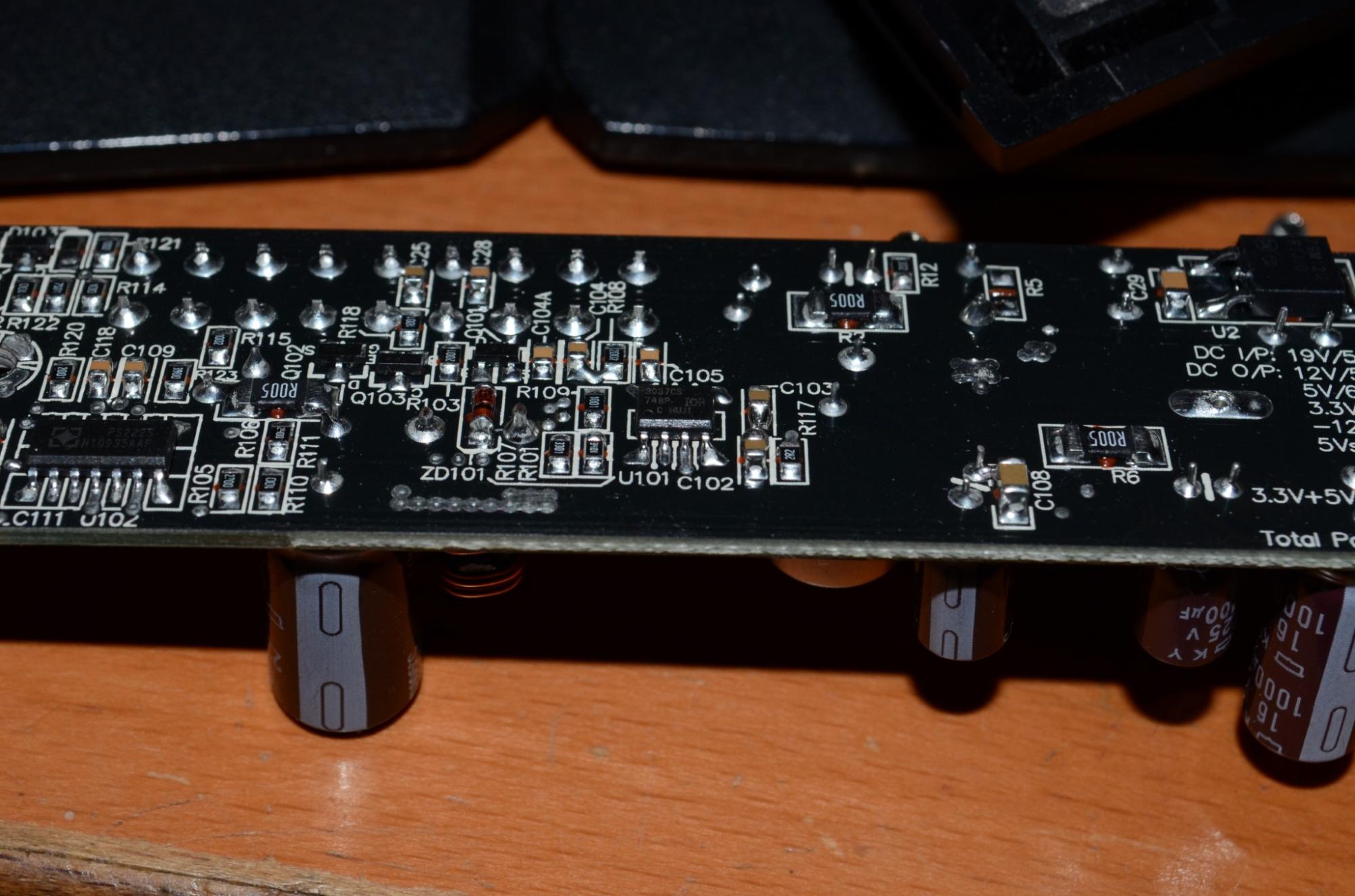

                                        • Stefan Payne
                                          • 1267
                                          #2940
Name:	DSC_5088 (Forums).jpg
ID:	2022177 Click image for larger version
Name:	DSC_5099 (Forums).jpg
ID:	2022178 Click image for larger version
Name:	DSC_5100 (Forums).jpg
ID:	2022179 Click image for larger version
Name:	DSC_5102 (Forums).jpg
ID:	2022180 Click image for larger version
Name:	DSC_5103 (Forums).jpg
ID:	2022181 Click image for larger version
Name:	DSC_5108 (Forums).jpg
ID:	2022182 Click image for larger version
Name:	DSC_5117 (Forums).jpg
ID:	2022183 Click image for larger version
Name:	DSC_5110 (Forums).jpg
ID:	2022184 Click image for larger version
Name:	DSC_5112 (Forums).jpg
                                          https://cdn.badcaps-static.com/pdfs/...bf1a346042.pdf
                                          'nen ON Semi 79M12
                                          Switcher are International Rectifier IRLR8726
                                          and for +5VSB an L5973D
                                          https://cdn.badcaps-static.com/pdfs/...2e3aac8bb9.pdf
                                          Protection is a SiTi PS222S
