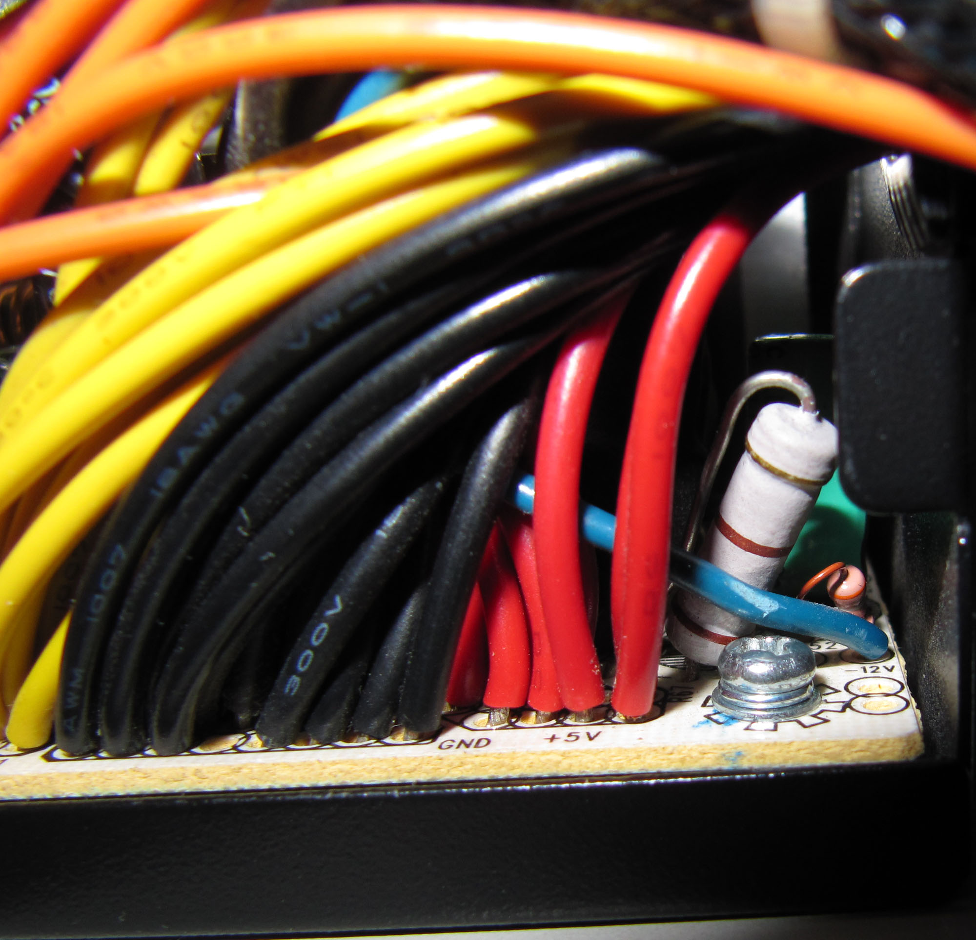

Partial Recap
12V:
I replaced 1000uF caps with 1x 2200uF 16V Nichicon and 1x 3300uF 16V JunFu WG.
5vsb:
I also replaced 5vsb YC caps with better quality parts.
Fan mod
9.13kohm resistor in parallel with the thermistor
Psu remains silent without getting hot even when PC case cooling is intentionally compromised.
Minimum load resistors
Original --> New
3.3V: 15ohm (~0.75W) --> 27ohm taken from 5V (~0.43W)
5vsb: no minimum load resistor used
5V: 27ohm (~0.926W) --> 120ohm taken from 12V (~0.22W)
12V: 120ohm (~1.2W) --> 240ohm (~0.62W)
-12V: 390ohm (~0.37W) --> no change
Finally, I oiled the fan with original Singer sewing machine oil.
Pics attachedAttached Filesif you find these attachements useful please consider making a small donation to the site
Might be worth replacing the secondary rectifiers as well. I replaced the 5v one with a 16A rectifier and the 3.3 with a 20A rectifier, as well as the 12v rectifier with a 20A 60v part. Now it's powering a 2.8GHz Northwood just fine, and the air that comes out of it isn't really hot. (just warm).I tested the Turbo X power supply in a Pentium 4 3GHZ HT, 2 hdd drivers and Geforce 6600 PCI-E. I disconnected case fans and ran IBT + Furmark for more than an hour. The psu got warm but not hot at all. According to my online UPS I use to estimate watts of connected devices, it drew 210W.
