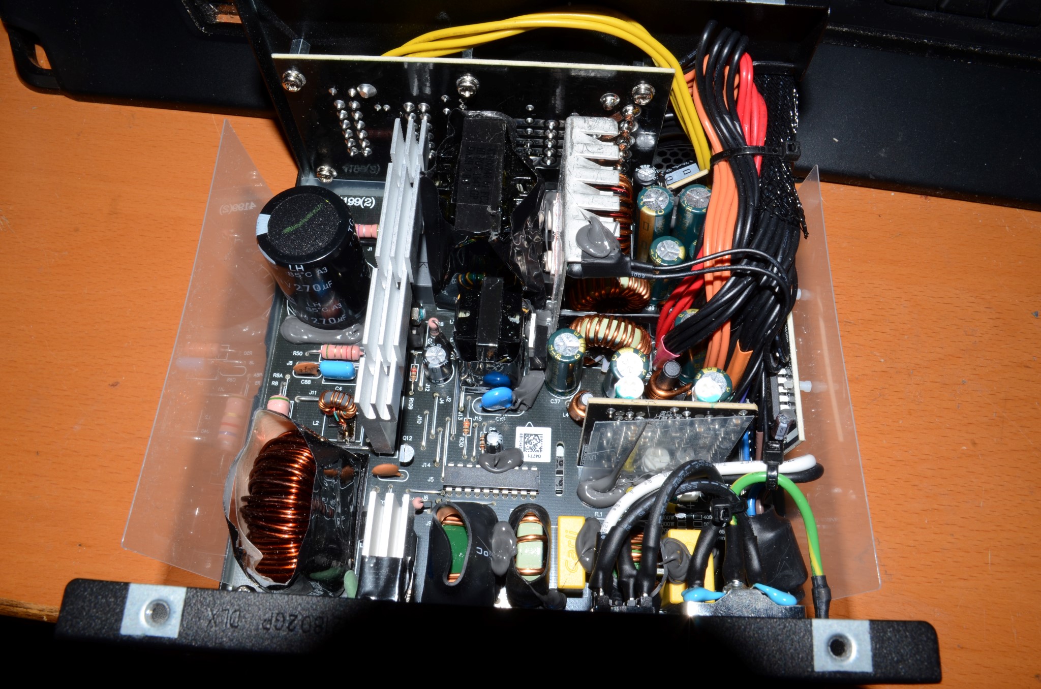

    Something new, pretty good unit, especially those connectors. You just have to put them in at least once in your life. No, really you do
    • Stefan Payne
      • 1267
      #2702
      And doesn't cost more than competitiors, while more efficient and more capacitance on +12V...
