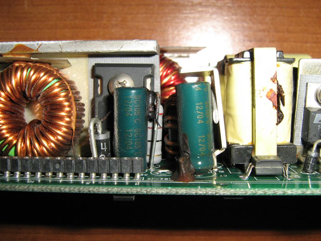

    Hello everyone!

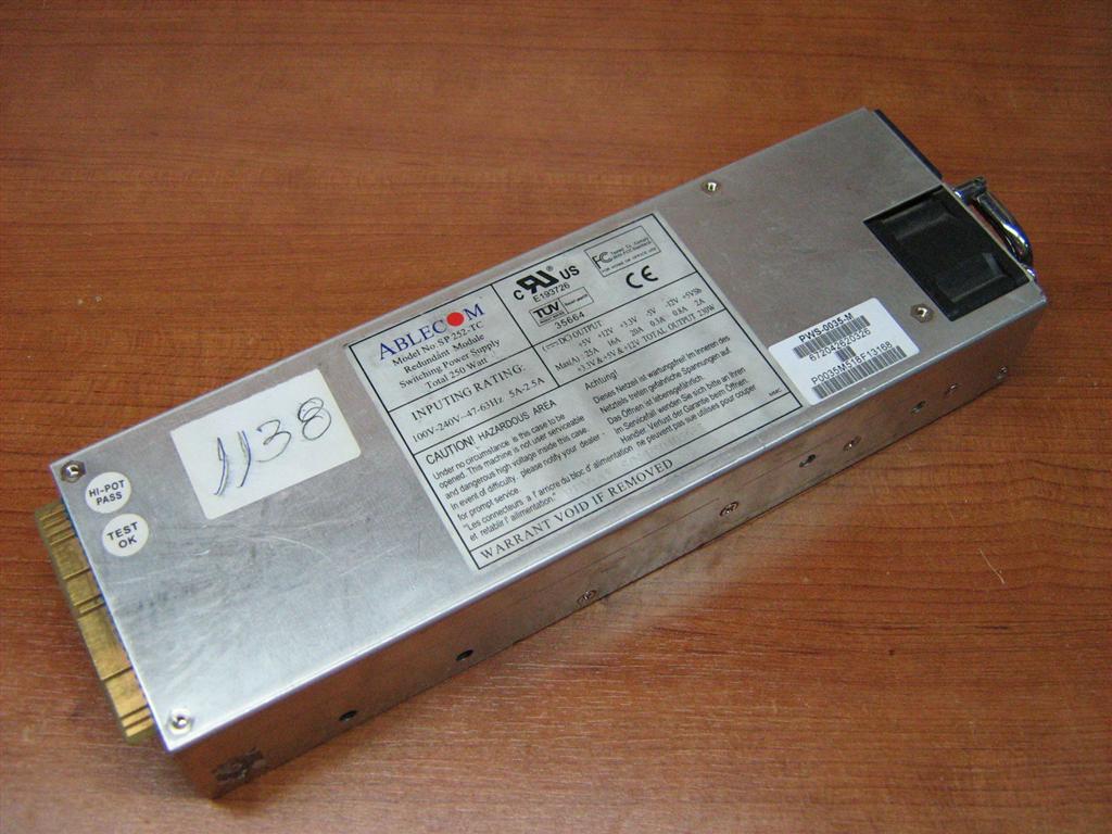

    I have a couple of this type of redundant power supply, from a server with 3 of it:
    SP-252-TC (PSW-0035-M)
    250W
    (Ablecom)

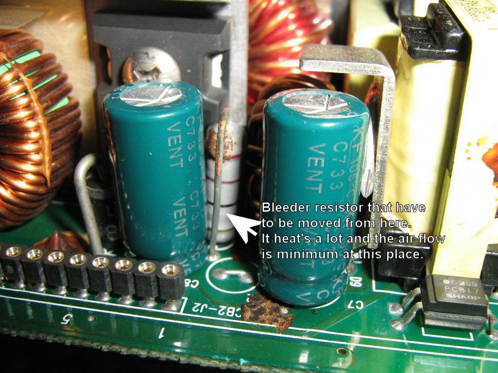

    They stop working some days ago; I'm trying to fix them... I think is a problem with the cap's that are too close to a resistor that heat's and then they get 'empty'. I've allready change to news one's but my real problem is that I can't get them to real work: I want to make them output the respective output's before installing in the server but I think, like there are too much pins, i'm missing some connections too activate them out of module of the server. Someone knows the pinout of this kind of power supplies? or where I can get some information about the connections?
    Thank you very much. (Portugal)

      One of those capacitors looks like it may have a seal failure on the bottom.

        second the one with the seal failure. fix that.

          Yup, most probably Teapo SC - it's worth replacing all of them at one shot.

            oh, and what leaked out of the bottom appears very burnt. dont be fooled, that is not glue. probably smells great!

              I'have allready put two new capacitors picked from a LCD power supply that I dont need it a the time; This caps are not very easy to find here because the small external diameter. The fault of the caps get 'burned' is on the bleeder resistor next to them. My intension is to move it a litle far to a point that the air flow greater.
              370forlife, my bad bad luck is that i dont have the module with me so i cant follow the wires to the PS_ON switch
              I tried to short all the signal path's to the GND one at the time but I get no positive results. I have in one terminal +5vdc that i think is the +5v_Stand By; I shorted all the signal path's with this output but results are the same: nulls. The supply only get's the Led light on red and the +5v_Stand By; the power outputs still dead.
              It seems that this type of supply is more hard to fool, or still there is a major failure.

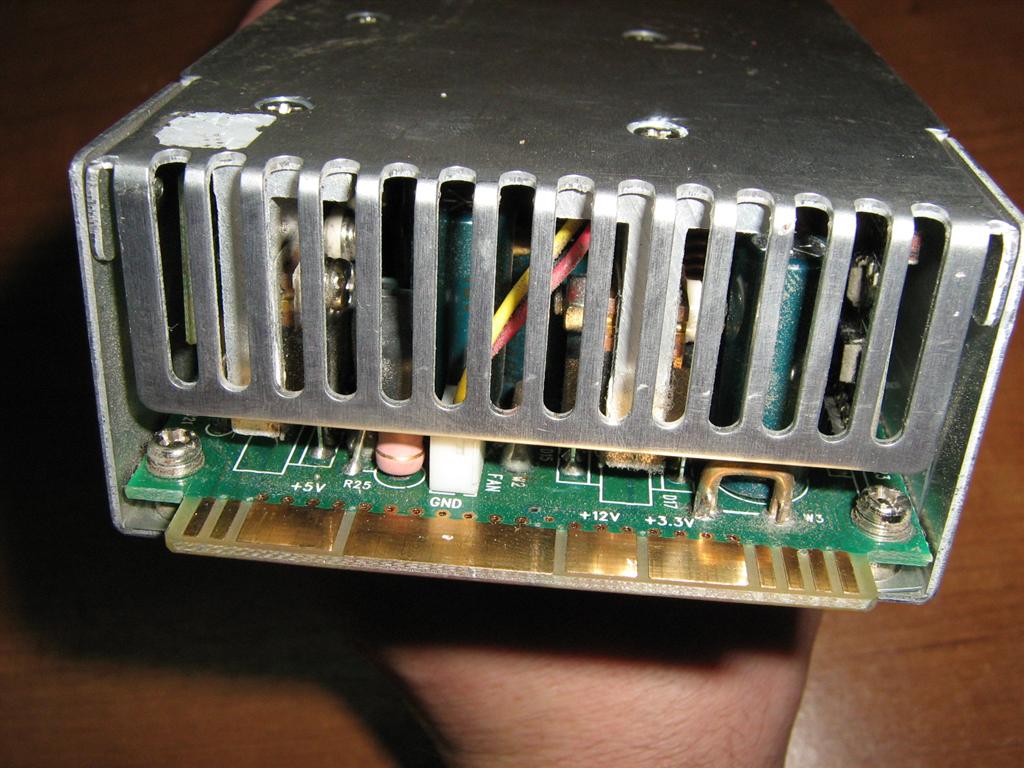

                    Let's look at the unit from the back, placed such that the PCB is on the bottom and you can see the PCBs top layer with the markings "+5V", "GND", etc.
                    I suppose the purpose of these connectors is obvious ;-)
                    The rightmost connector is the ON switch (corner of the PCB, group of 4), which is sitting at about +5V if the unit is idle. This needs to be pulled low. But unlike with ATX, shorting it to GND is not enough.
                    Flip the unit and take a look at the PCBs bottom plane.
                    The connector layout is quite similar, and in fact, the big connectors carry the same voltages (GND, +3.3V, +5V, +12V). There is also a group of 4 (now on the left side) and a group of two (on the right). These are now DIFFERENT than on the other side.
                    Also, you'll find there is one additional connector in the middle, sitting between the huge GND connector and the +12V connector. That one needs to be connected to GND, too.
                    The backplane my units came with permanently connects this connector to low, so you should be safe doing the same. There are even holes in the PCB behind the gold tips, which you could repurpose.
                    There is also a 5V standby (now outermost on the left, part of the group of 4), but the unit runs quite warm just sitting there. So if suppose if you use it in a project you're better off pulling the plug.
                    My unit erratically was turned off by the controller sitting on the backplane while the ATX connector was shorted out. No idea if that's just because the backplane senses the PSU is idle, or if it was some low-load protection kicking in.
                    I'm too lazy to draw a pin out diagram, but once it's turned on, you can use your DMM to figure out where to find the non-labled ATX voltages. They should all be there.
