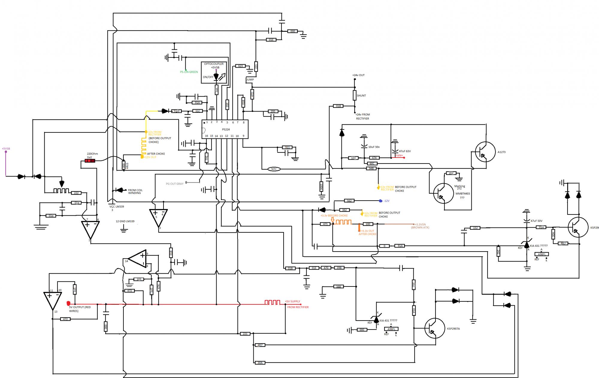

v3.0 - replaced physical LM339 op-amp with individual internal op-amps

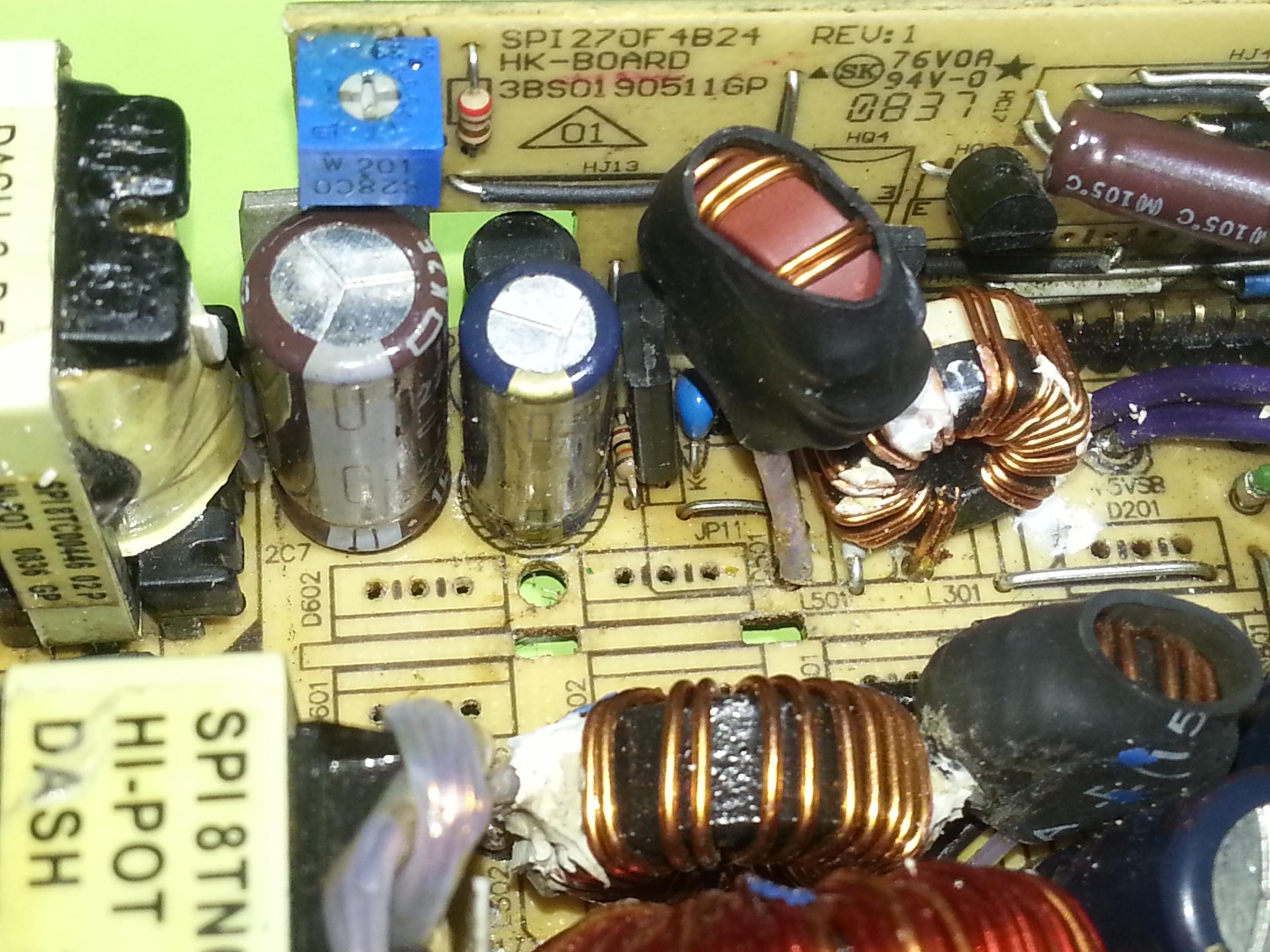

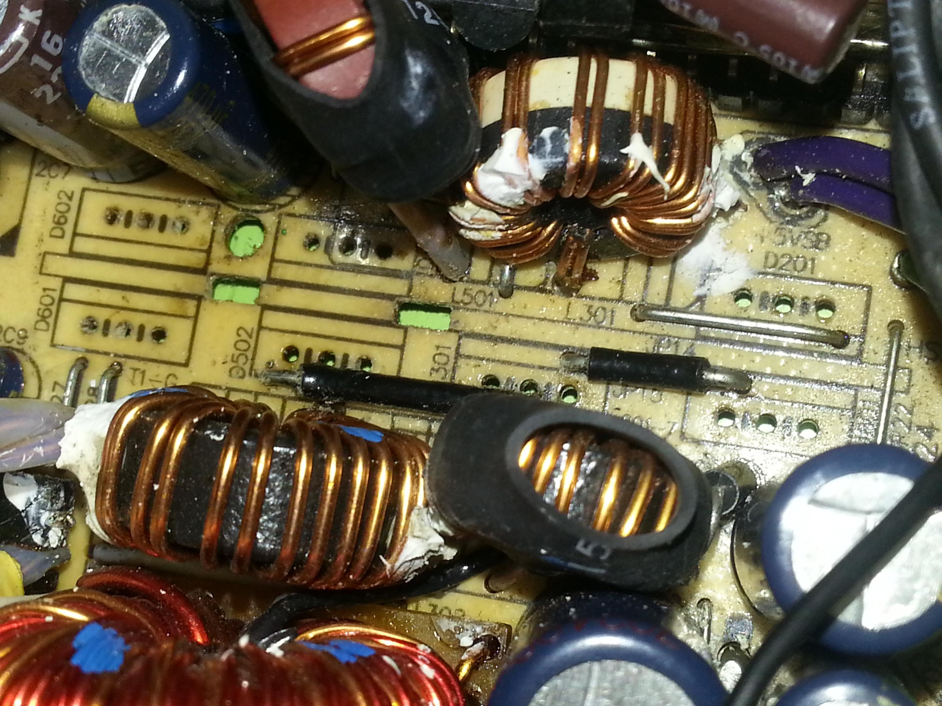

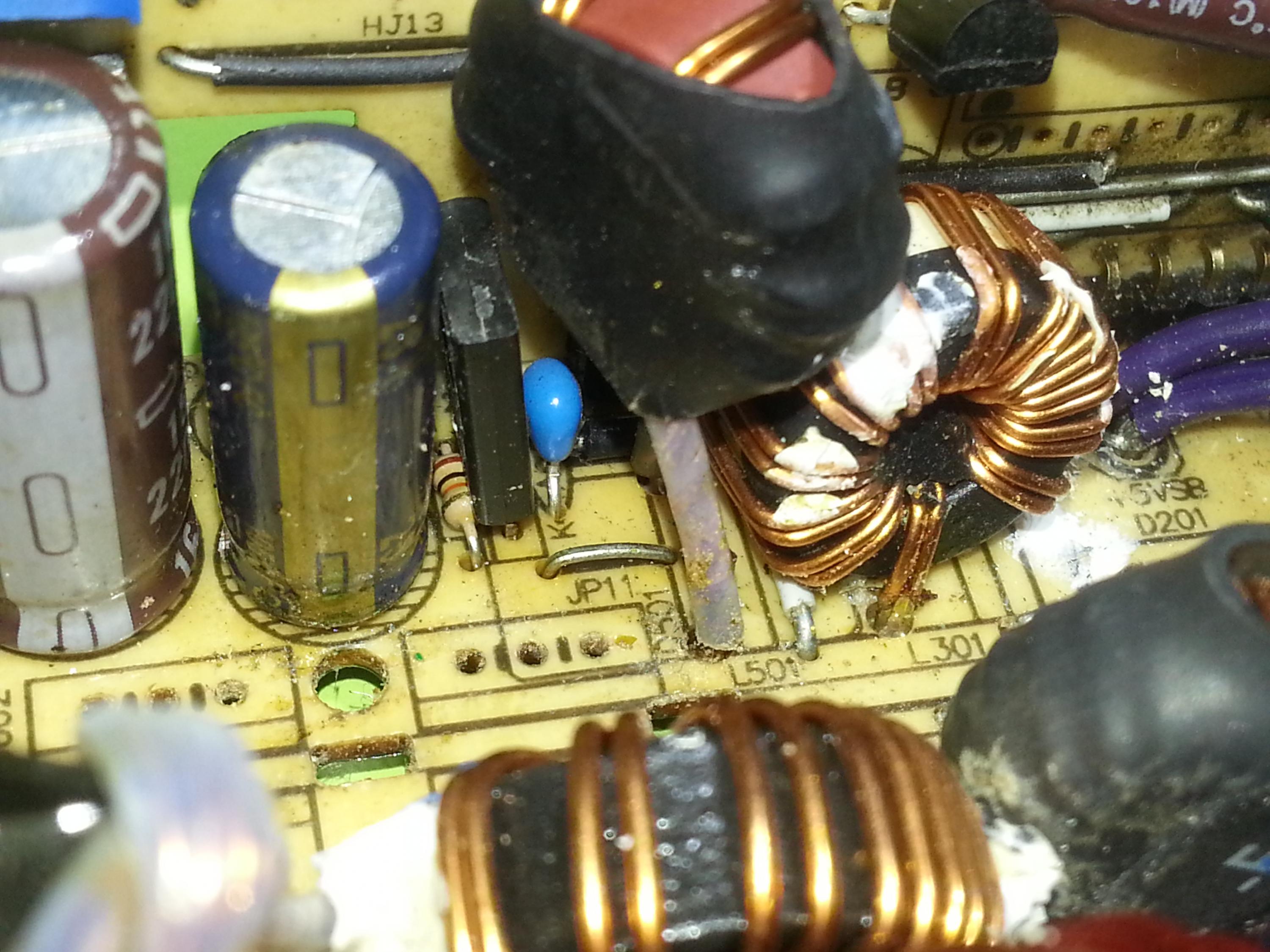

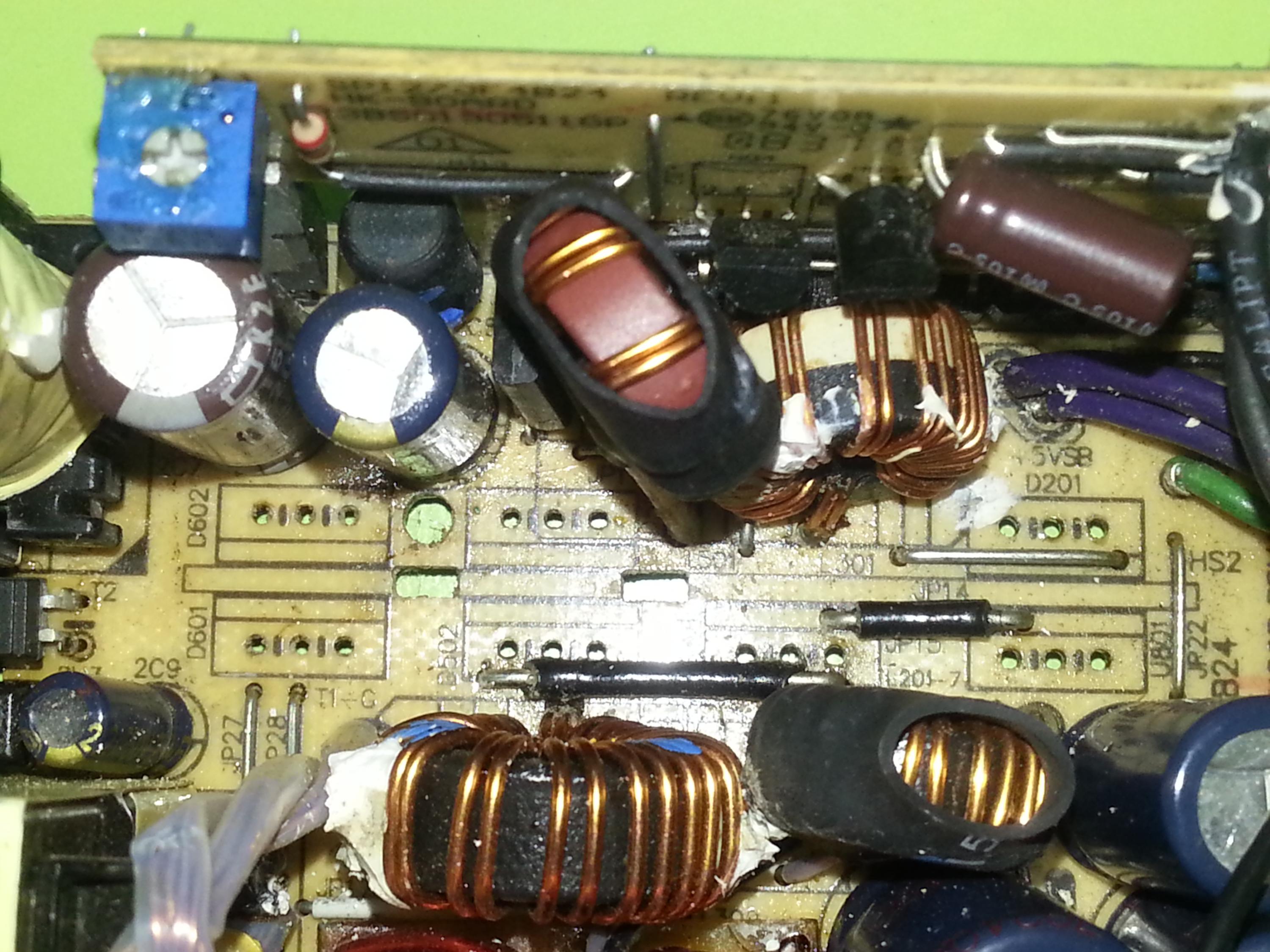

). Of course, I did some more digging in the meantime, removing the whole heatsink assembly on the secondary so I could get a better look down there, but again: nothing - just coils and jumpers, none of which appeared charred or burned. After all, the pop was rather small - not like what happens when something on the primary goes wrong for instance. It was more like a small spark with no smoke afterwards.if you find these attachements useful please consider making a small donation to the site
