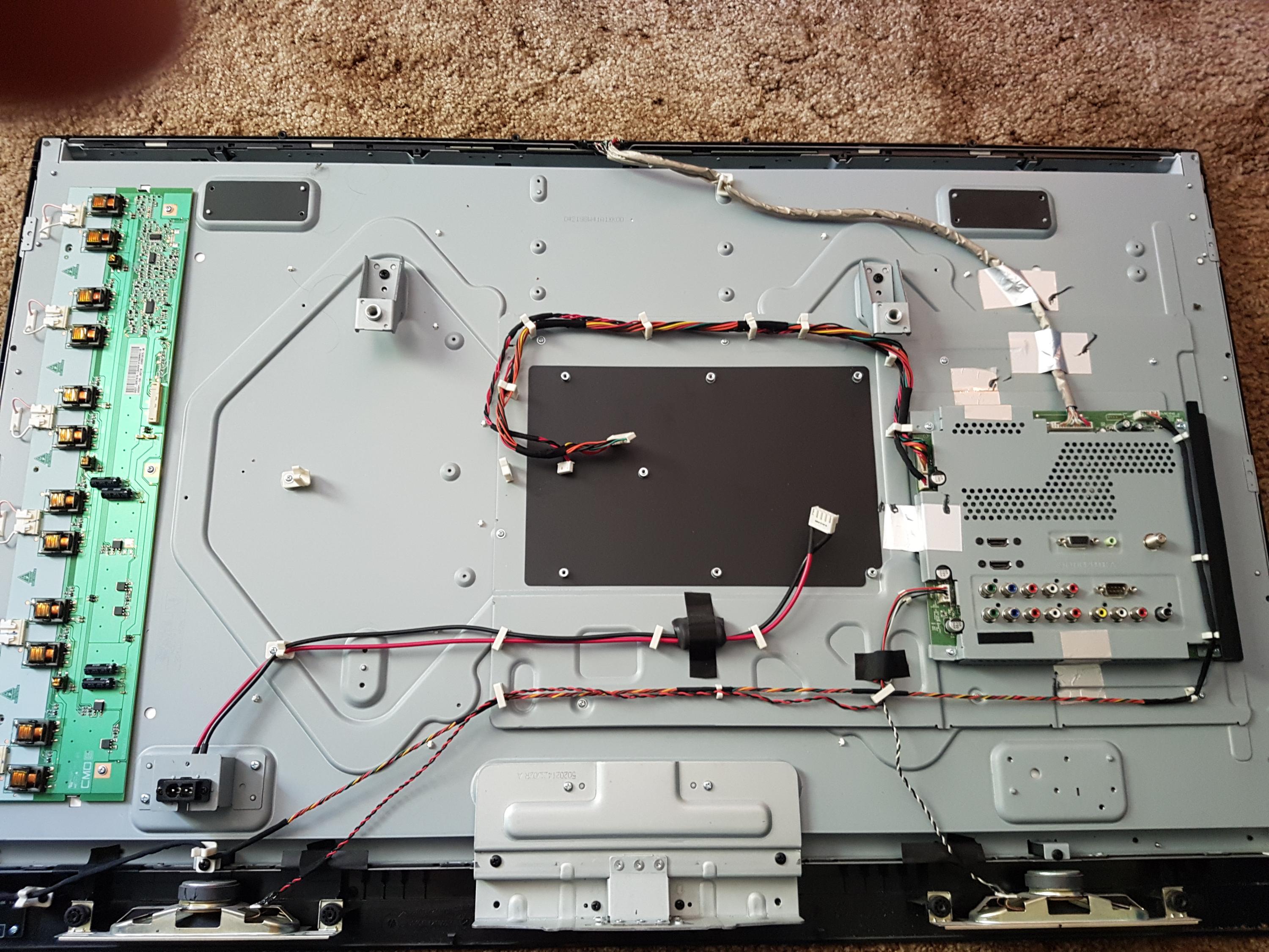

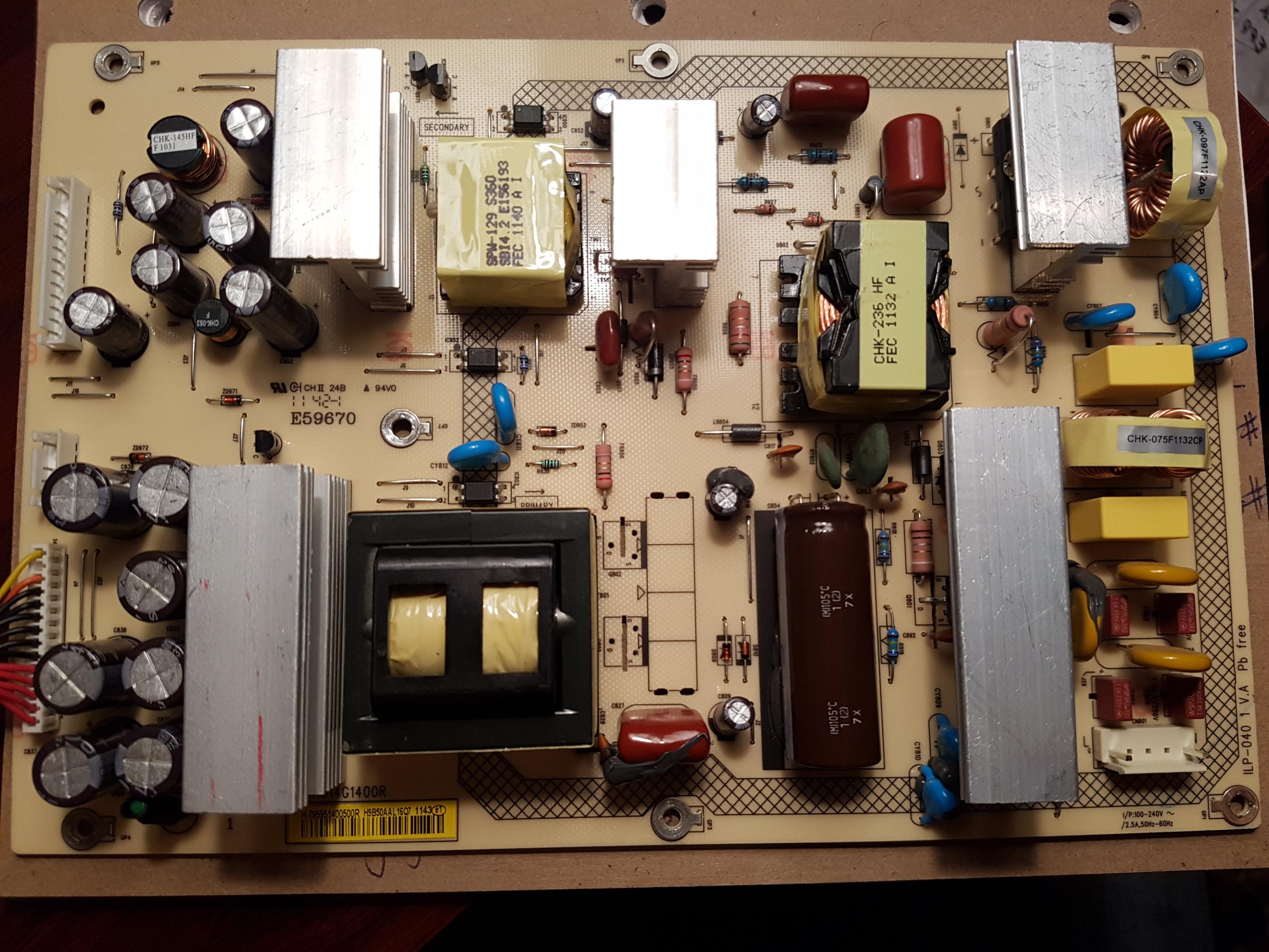

    We do need to see the pictures of your boards and pictures of the whole backside of the TV showing all the boards.

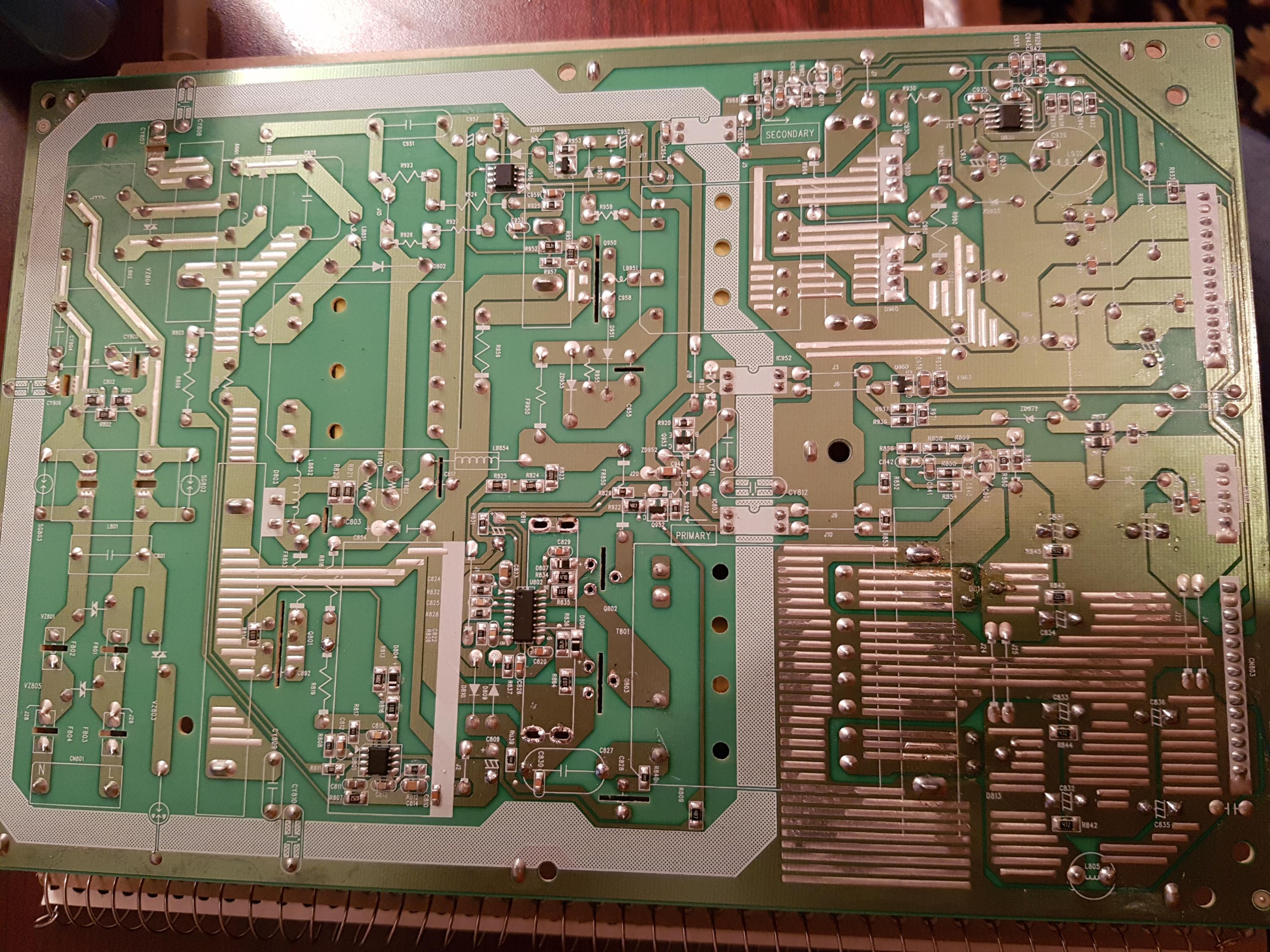

      The mosfets and heatsink are currently out. Hence the empty space above the transformer.

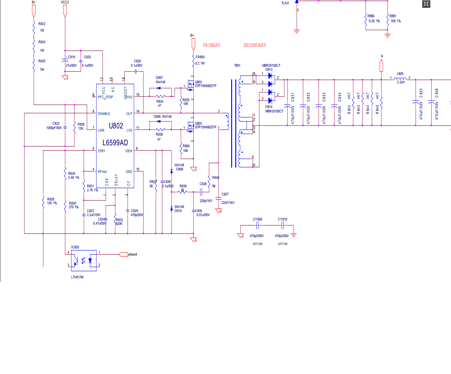

                Had some time and I may have narrowed it down more. Noticed that there is a PFC_stop pin that goes low when the IC shuts down. According to the IC schematic this is controlled by an OR gate with three inputs. Two of those inputs are from disabled features that are not used in this design leaving only the overcurrent (Isen) pin to be tripping the shutdown. Using a multimeter on the Isen pin never shows a voltage near high enough to trip the OCP. But that is just slow multimeter...
                Applied 24v to the output of the supply (mains disconnected) and it charged to 24v while drawing a normal amount of current. So I think there are no shorts all the way up to the COLD secondary diodes from the 24v output.
                I am (stuck) thinking there is a problem with the start up cycle, transformer and or the mosfets driving it. The mosfets tested normally on my multimeter with no shorts, diode working and gate confirmed to turn on/off. The transformer is harder for me to test. Tried, "ringing it", using my scopes square wave CAL output. Seemed to ring but without a known good reference/experience I am not able to judge it confidently. Is there a way to remove the transformer and insert some load resistor to help confirm the transformer is faulty and causing the overcurrent? The start up circuitry is all surface mount stuff and probing with my multimeter has shown no shorts across any cermaic caps or diodes and no resistors open when testing in circuit. The section of the circuit in question is shown below.
                Any suggestions? If I can confirm its a transformer short/fault I'll autopsy it. But I don't want to get destructive....yet

                  What Voltage do you have in that pin 7 line sensing pin of the IC? check those three 1M Ohms to see it the value has gone up.
                  BTW, c827 (22nf 1KV) capacitance is OK, right?

                    The line sensing pin gets 1.69v and the 1M resistors test good. C827 also tests well, right at 22nf and no DC leakage up to my testing limit of ~100v. C828 also tested good in the same way.
