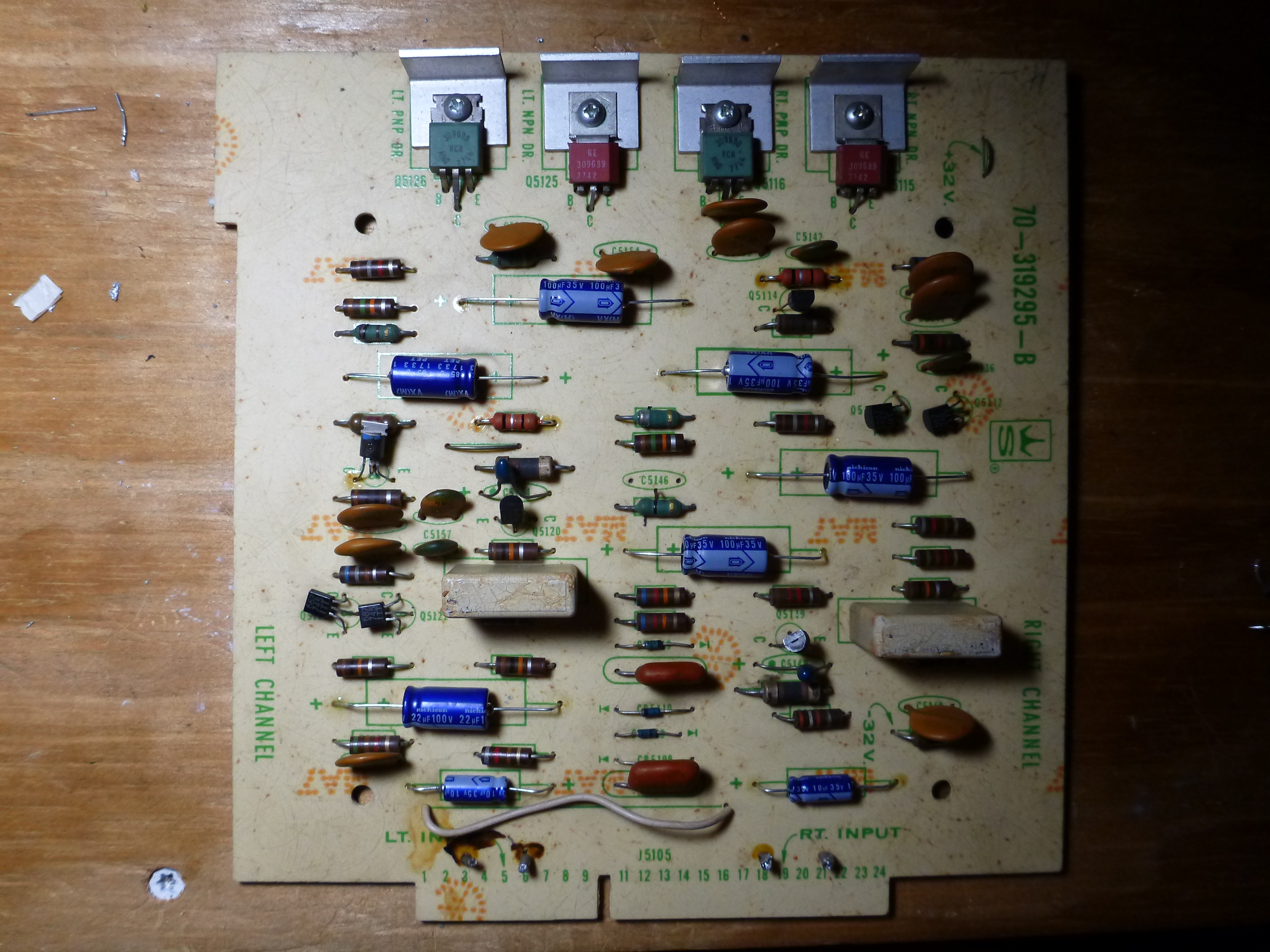

    I am working on a slew of Seeburg Juke box boards, and while trying to procure the caps.... lets just say I ran into a few snags. These were built in the early 70's and some of the caps on the driver and amp boards have some small uF values. One in particular is a 75v 20uF axial Lytic(that is what is listed in the schematic). I can't find a new replacement(in regards to voltage). My understanding is(keep in mind, I am not real bright) as long as the capacitance is the same, a higher voltage can be used. I can find 100V 20uF axials(pricey), but I also see them rated to 450v(strangely not as pricey). Can someone with some experience in this give me a clue? Maybe in crayon? Thx.

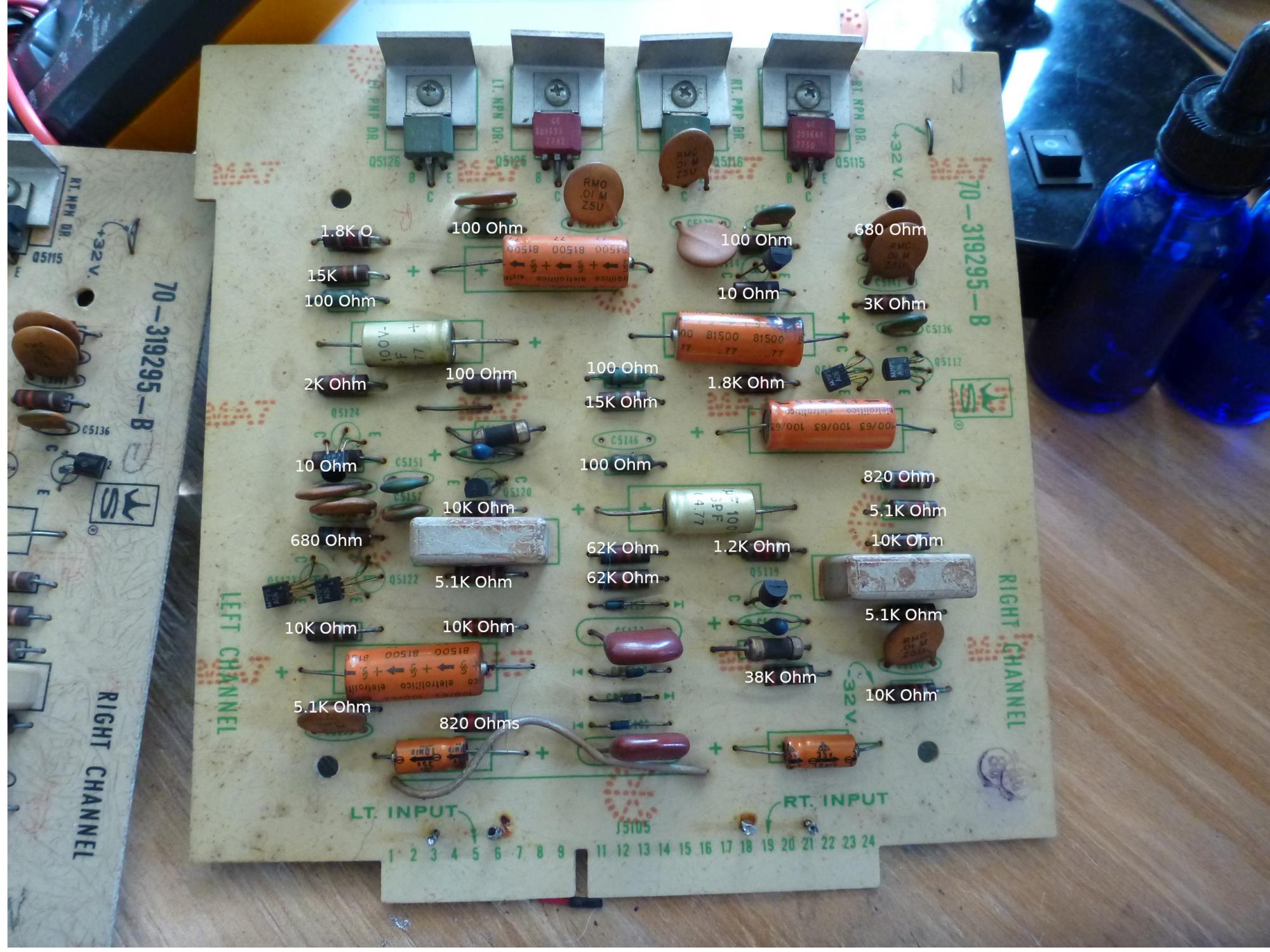

          Looking over my notes, and I could verify by checking my order, I substituted 12V 50uF caps with 16V 47uF caps, and 6V 50uF caps with 10V 47uF caps. These were the only two instances where I used a lower capacitance rating as I would assume since capacitance goes down over time (generally tossing anything with 10% or greater loss) that as long as the caps are good, 47uF should be enough. Everything else I was able to keep close at slightly above. Should I order some bigger caps or do you think these will suffice? I should state, after I restore function to the amp and give it a thorough inspection with slow run up on the Variac, I plan to put a signal through it and check for distortion on the O-scope. Some of these caps may be replaced again with something better. I found it hard to spend a lot not knowing the variables. Still have plenty of issues not related to the caps such as resistors on the driver board that should have a value of 100 Ohms measuring 180 Ohms out of circuit and over 200 in circuit. Little things like that. So far, no dead shorts. But if I do come across some of the transistors being fried in these, I have a feeling it is going to be a real headache trying to find equivalents. Feel free to chime back and thanks again for your help.

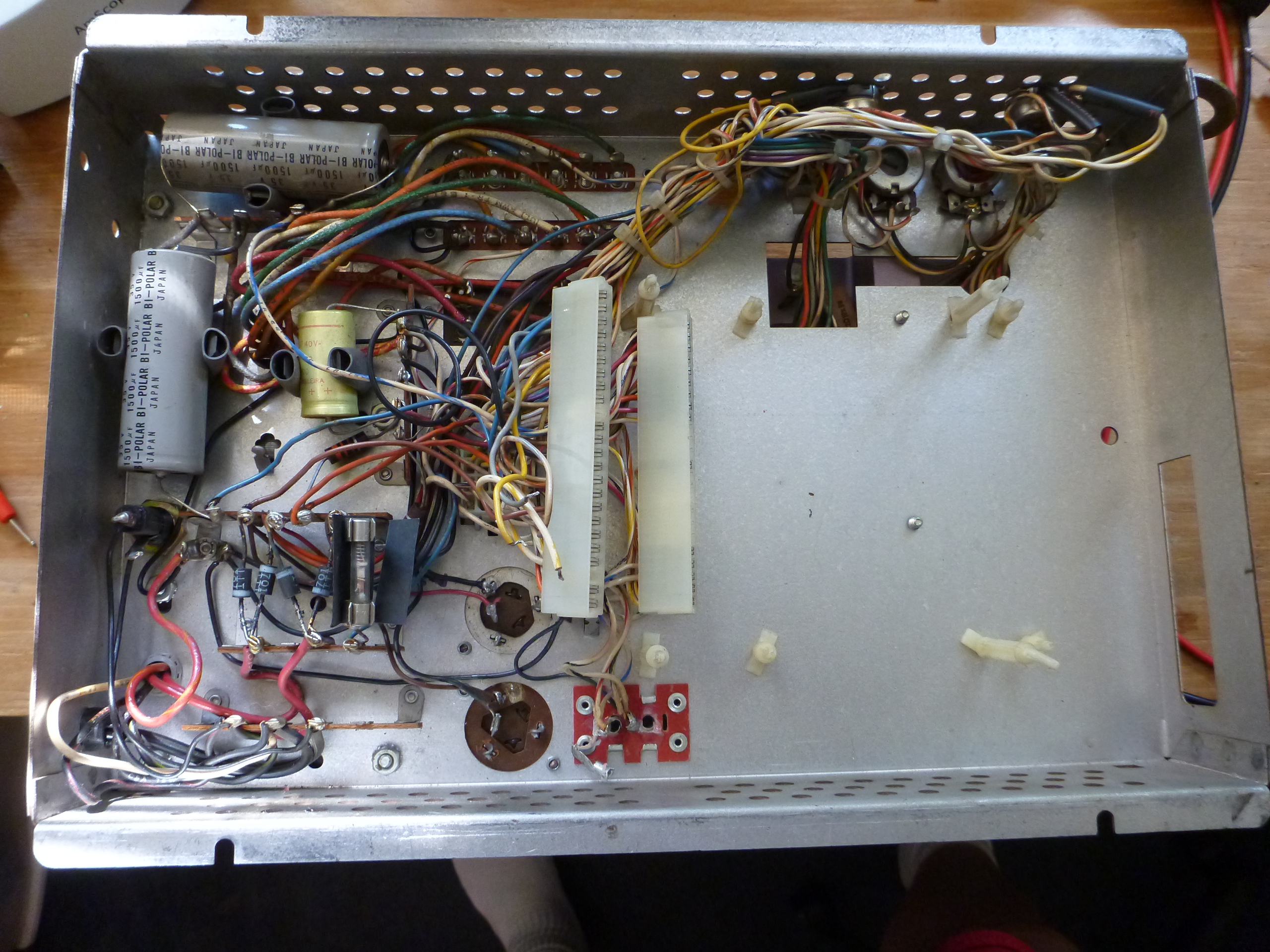

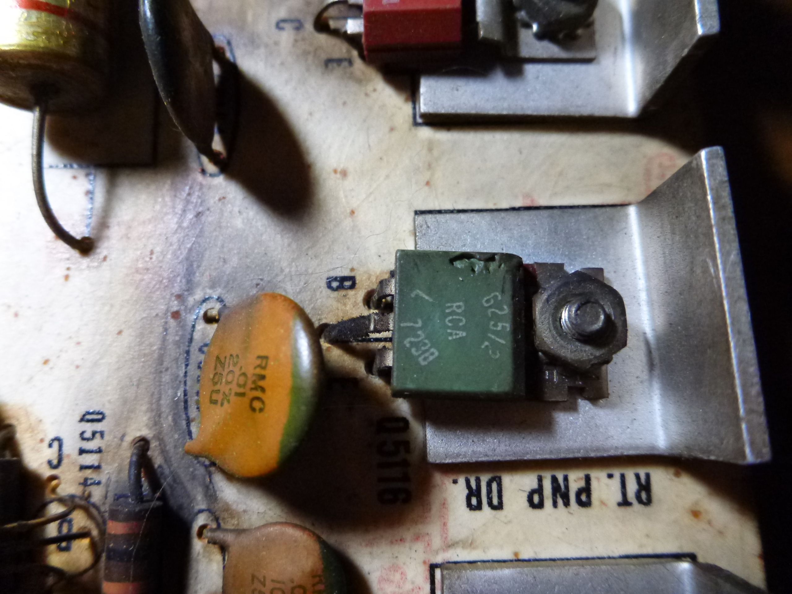

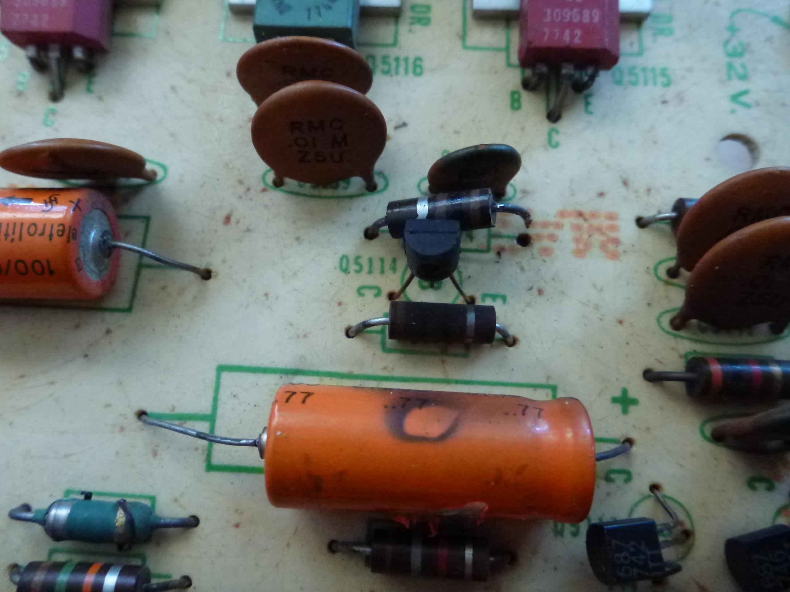

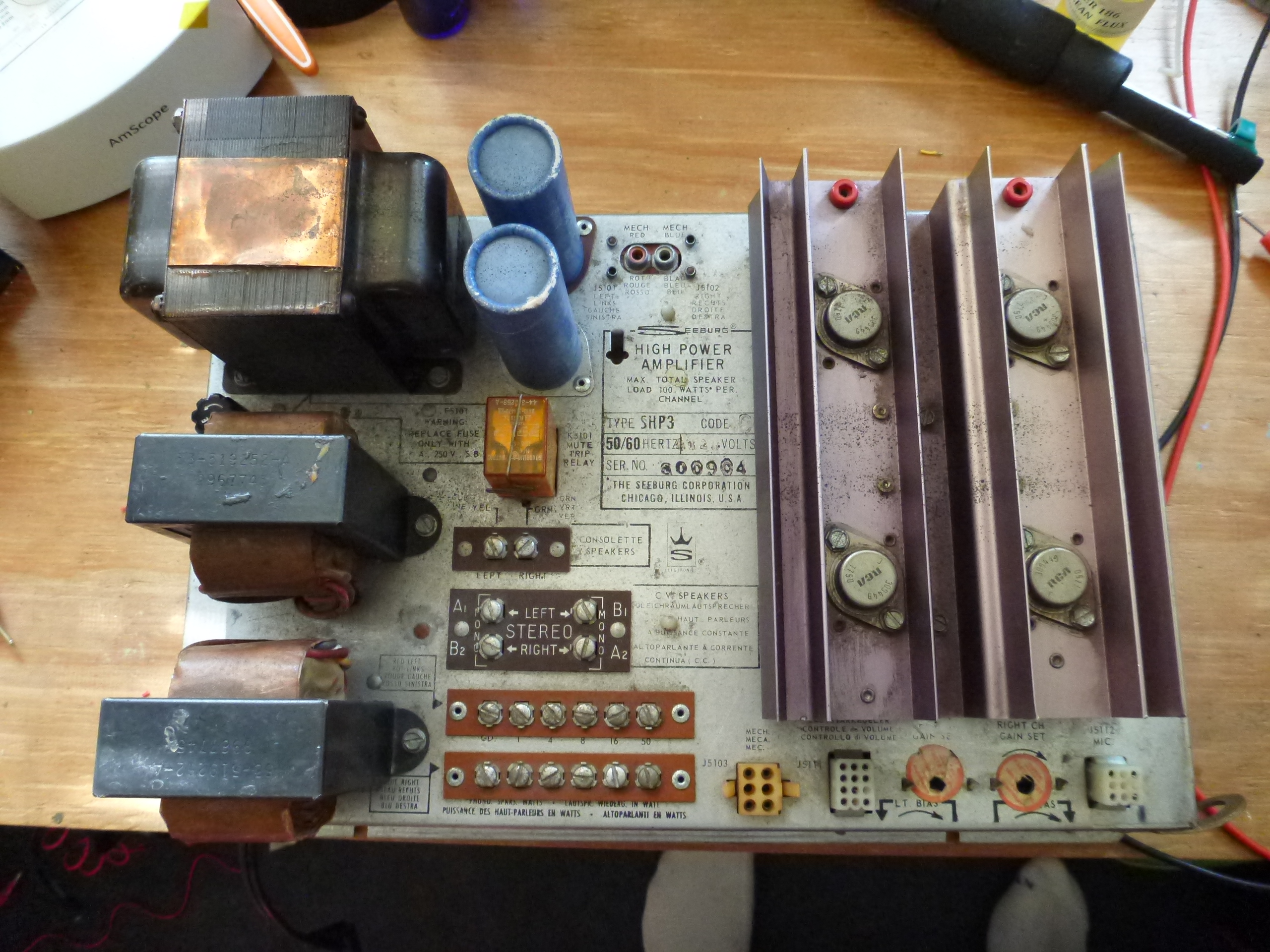

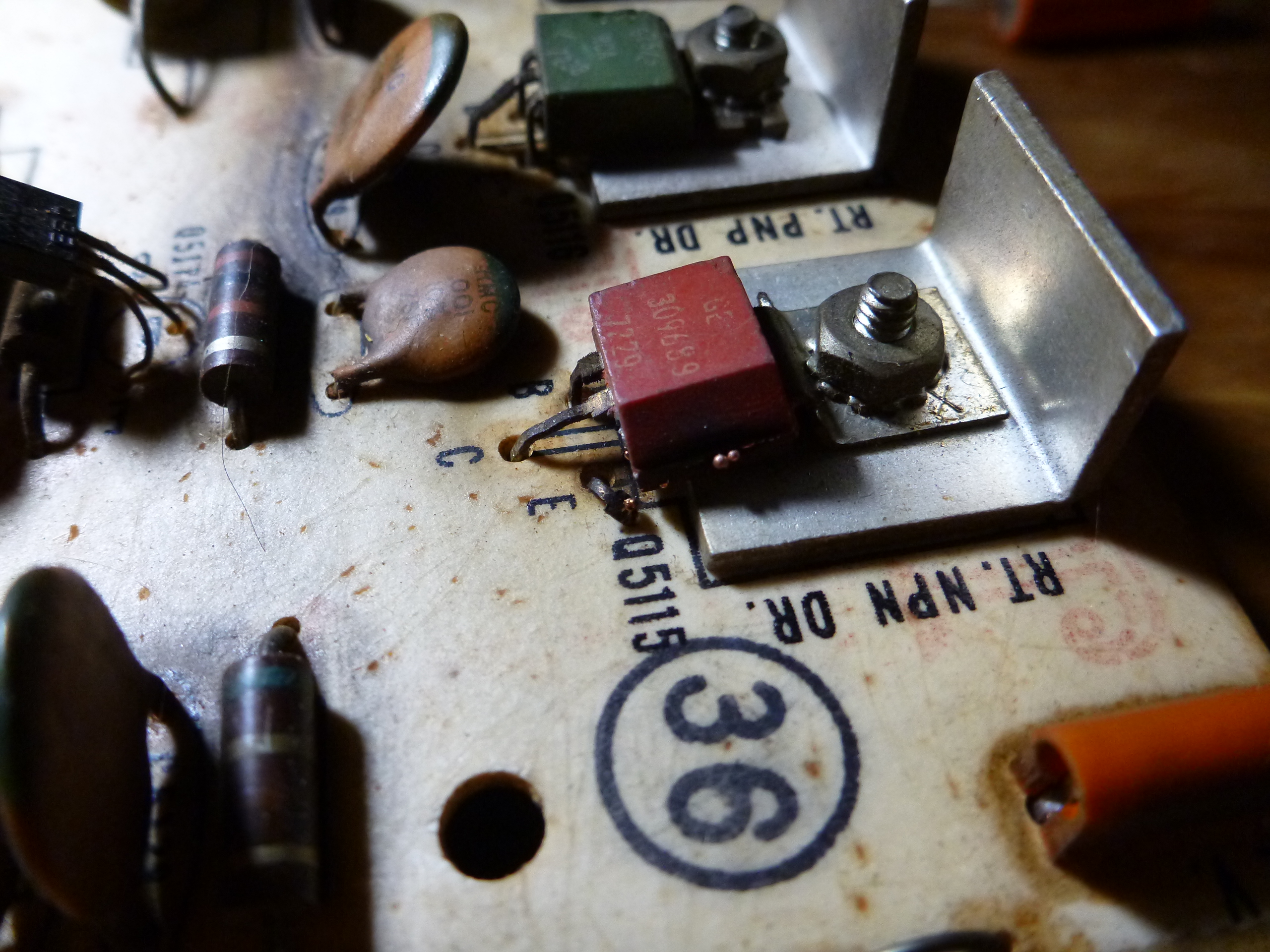

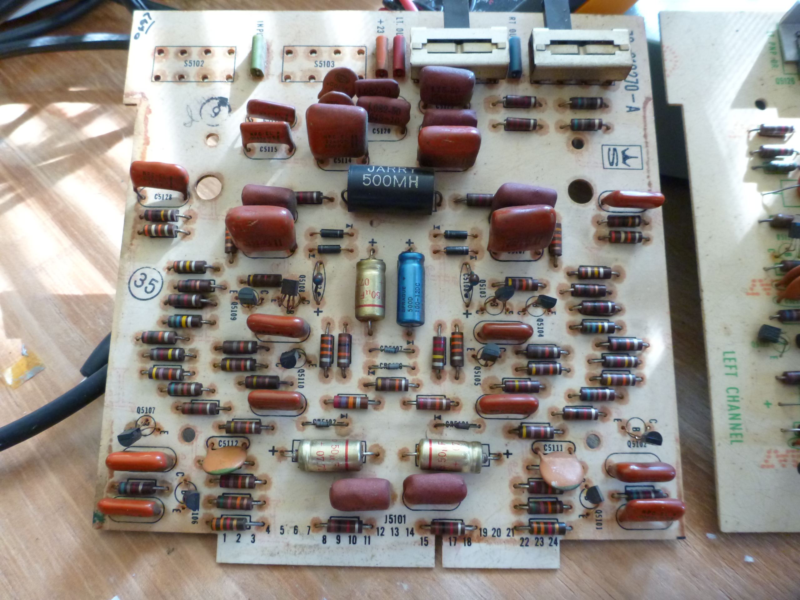

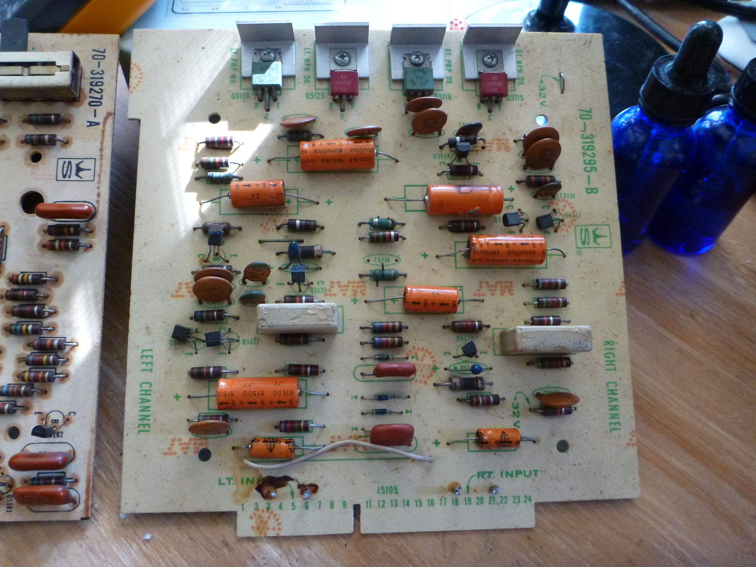

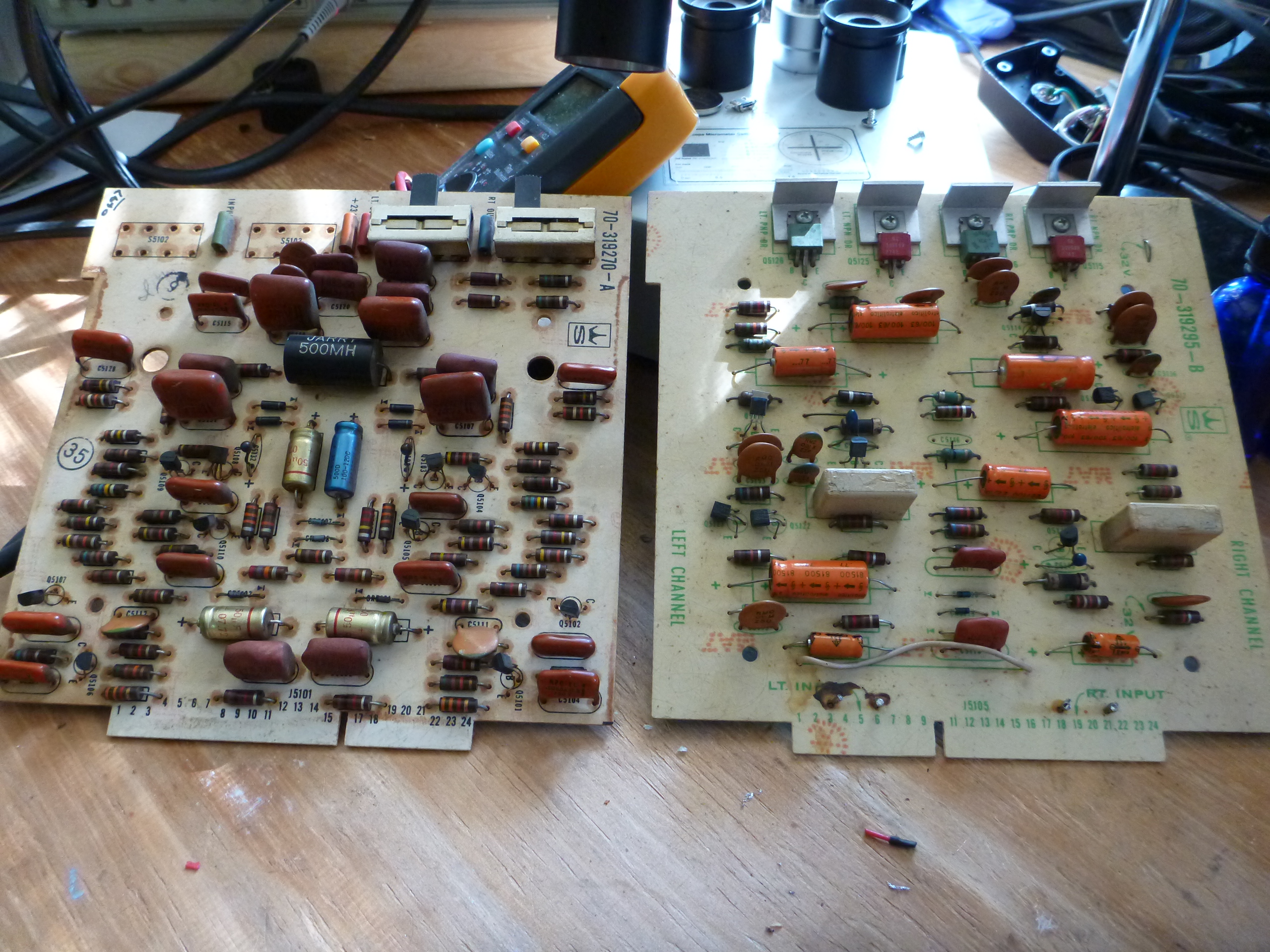

            Some pics of the disaster occupying my bench.
              Re: Replacing a cap with higher voltage, same capacitance.
              If I were you I would replace those carbon composite resistors with carbon film type at least.
              BTW, you can also use 56uF cap in place of 50uf.

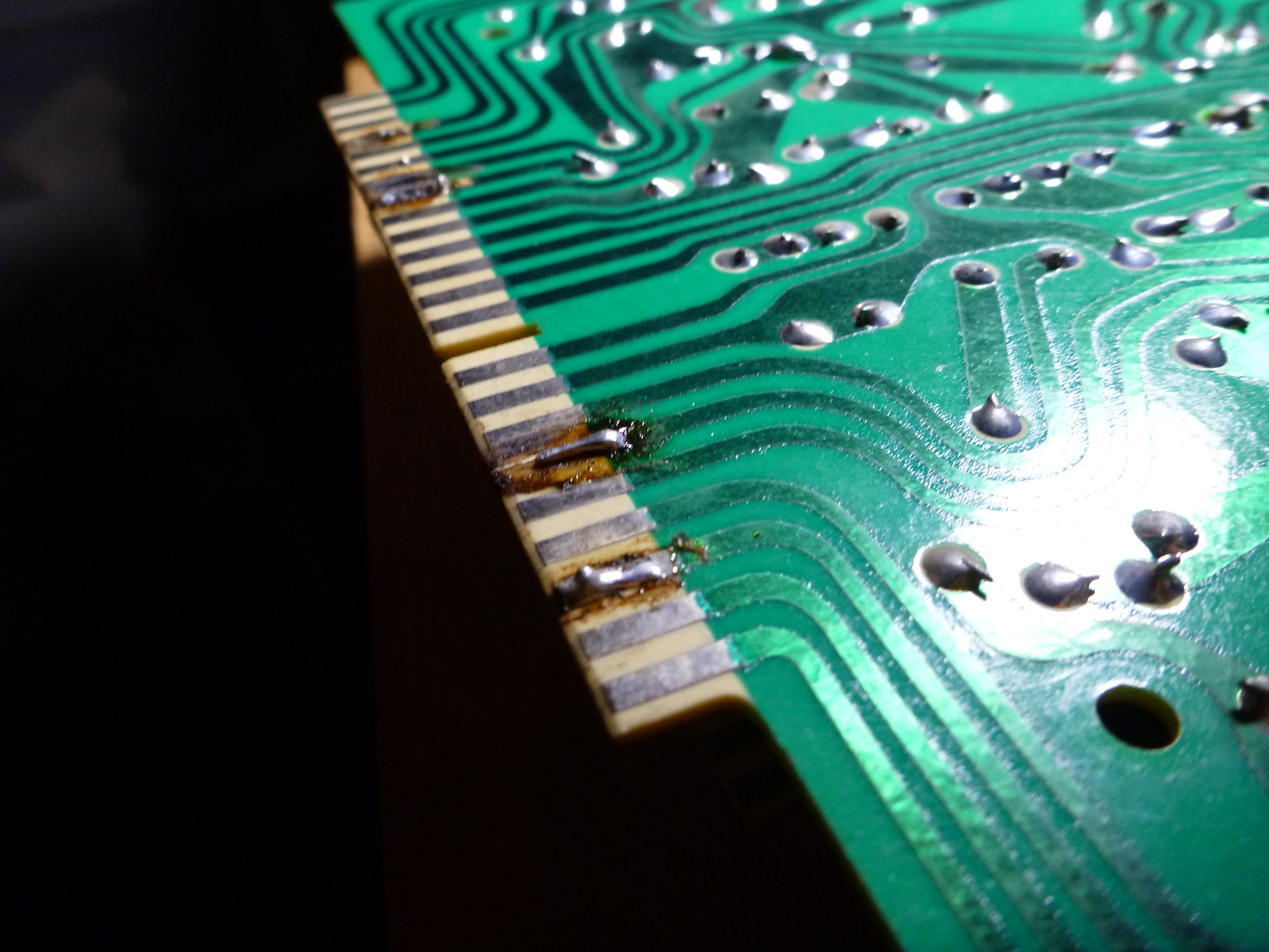

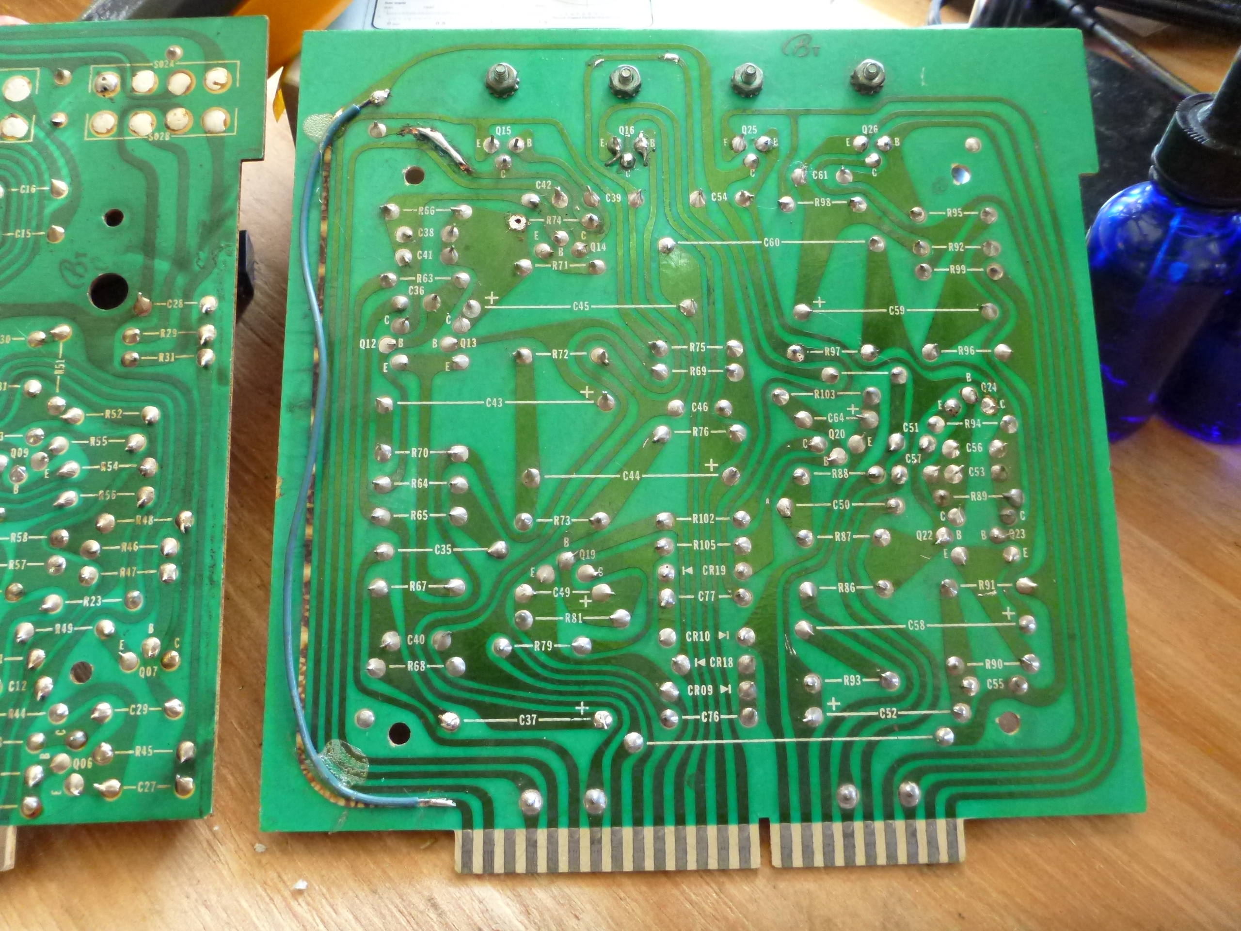

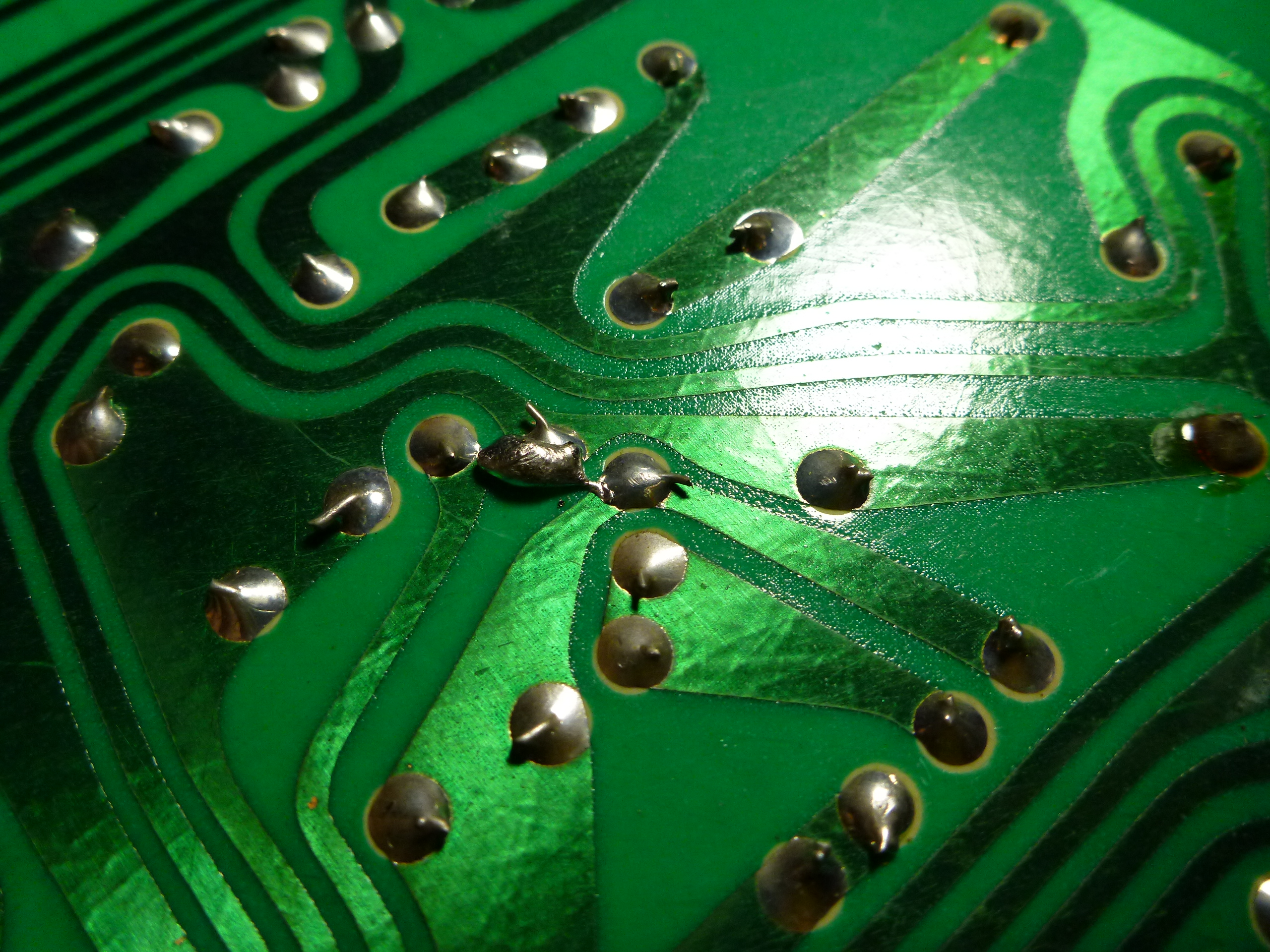

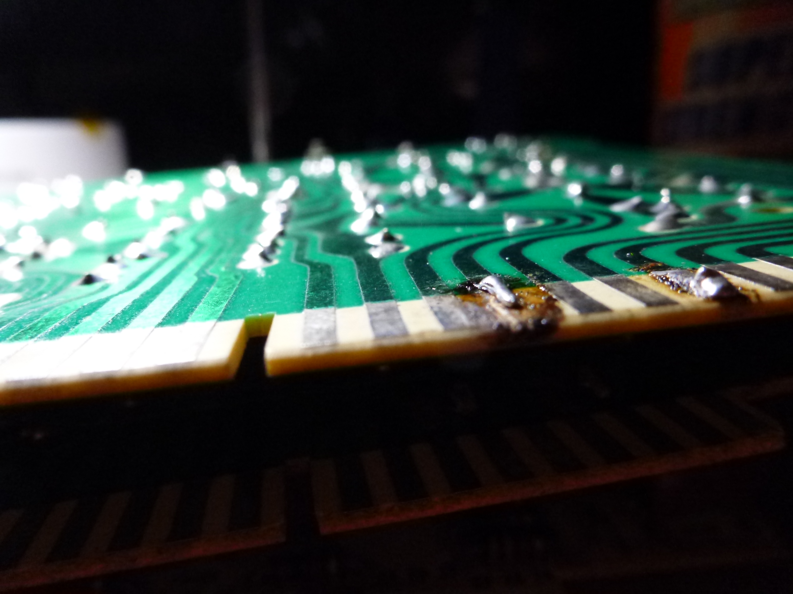

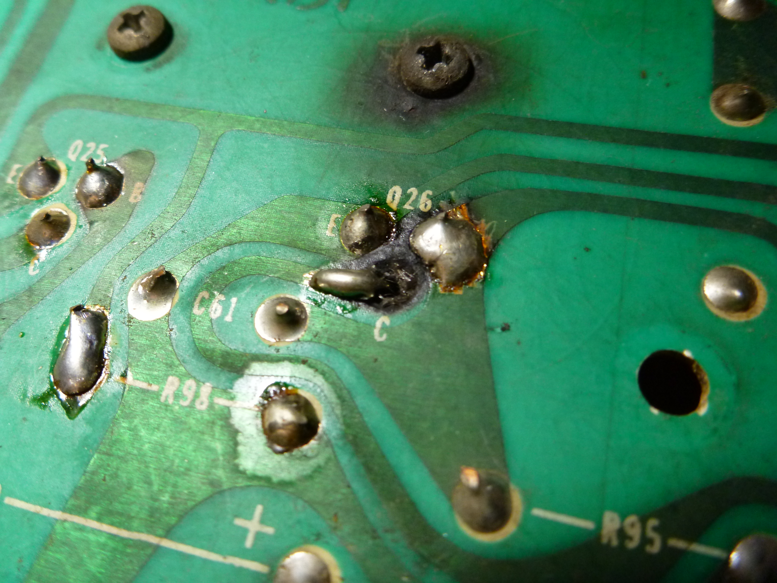

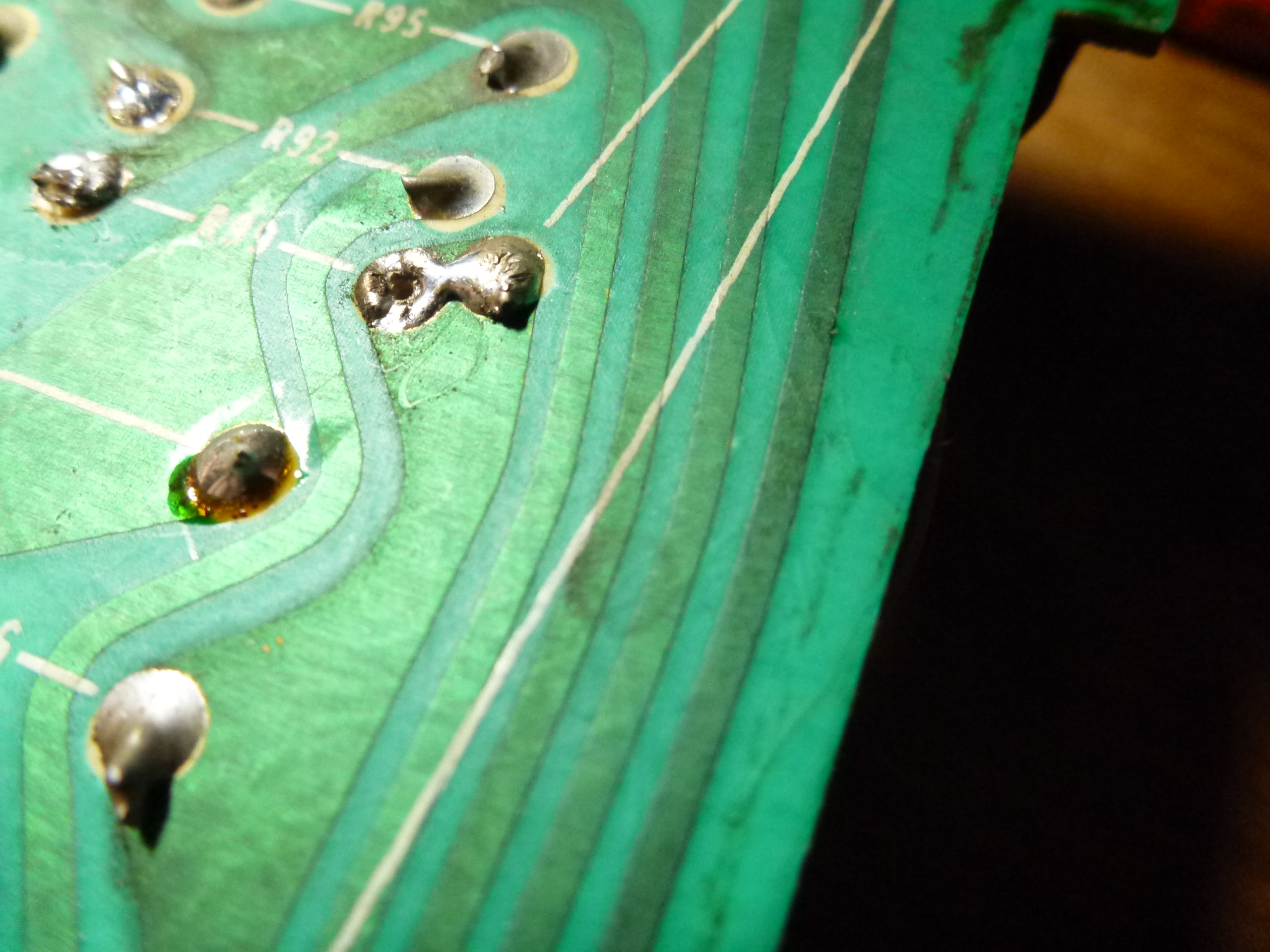

                I looked into your resistor comment and you are right. It seems that metal film might be the best composition for audio resistors. Any reason I might not want to use those? I had already purchased Nichicon caps, so I'll check the signals once I restore function before I grab something a little longer lasting. I'm making some cheat sheets for quick reference as I have at least 10 of each board. It is going slow, but I took this job to learn and that I am. I appreciate all the input. Here's some more pics. Burnt/blown traces, components, bad.... everything. You know, dirty circuit porn. Enjoy!
                  When those composite resistors start drifting in value, they can affect the biasing of the semiconductors which will cause problem.
