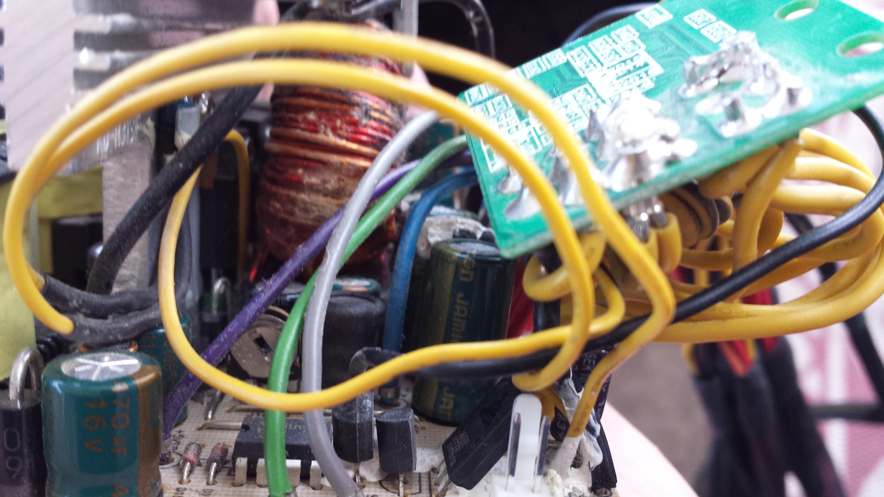

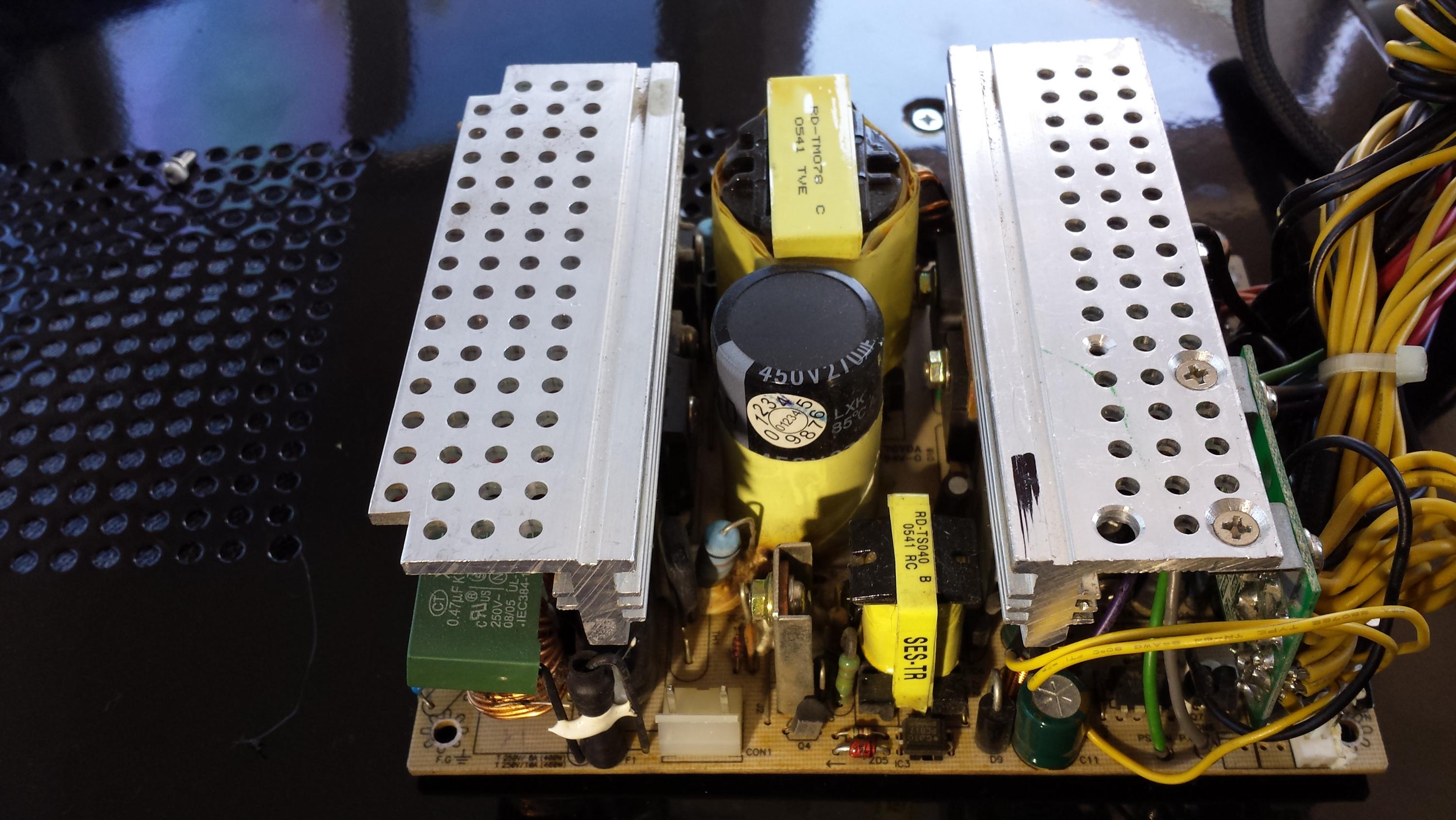

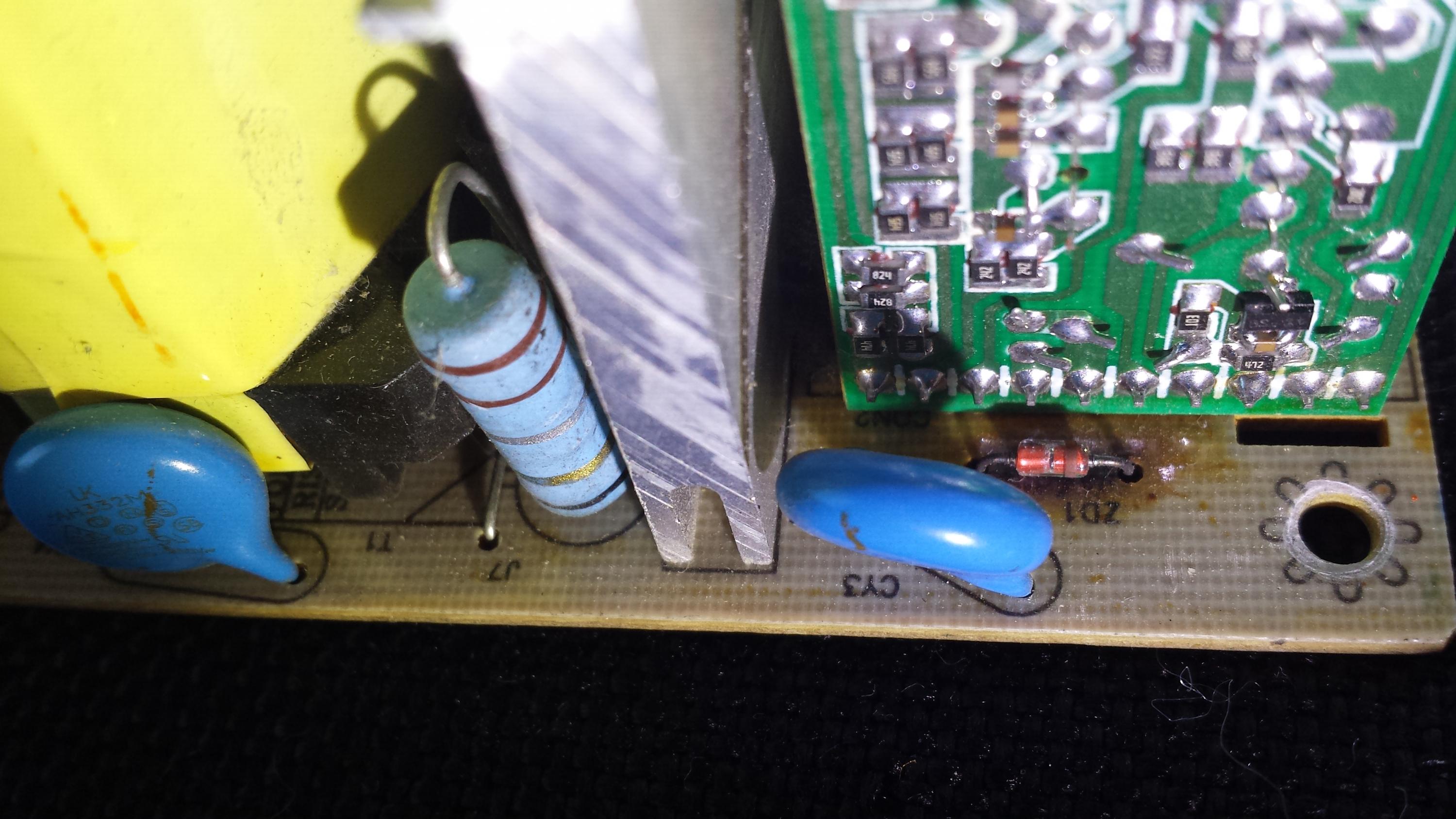

    This is some old power supply, it stopped working (didn't power on) several years ago. Bought new replacement. Recently I needed some psu for temporary built non important stuff. Bringed up this psu, replaced a few bulged caps. PSU is kinda working now, voltages reported from motherboard are o.k. (except some strange usb disconnect problems if more than few devices are plugged in), sometimes psu didn't turn on by pressing button but only manually connecting green and black wires.

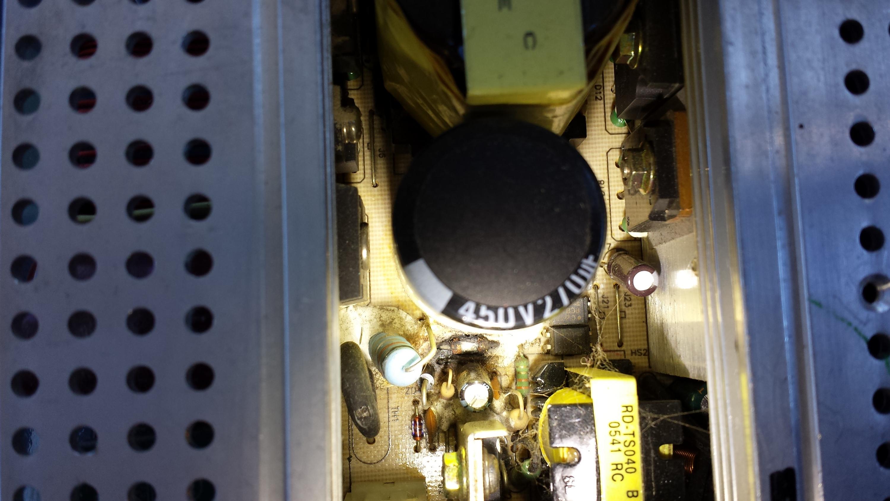

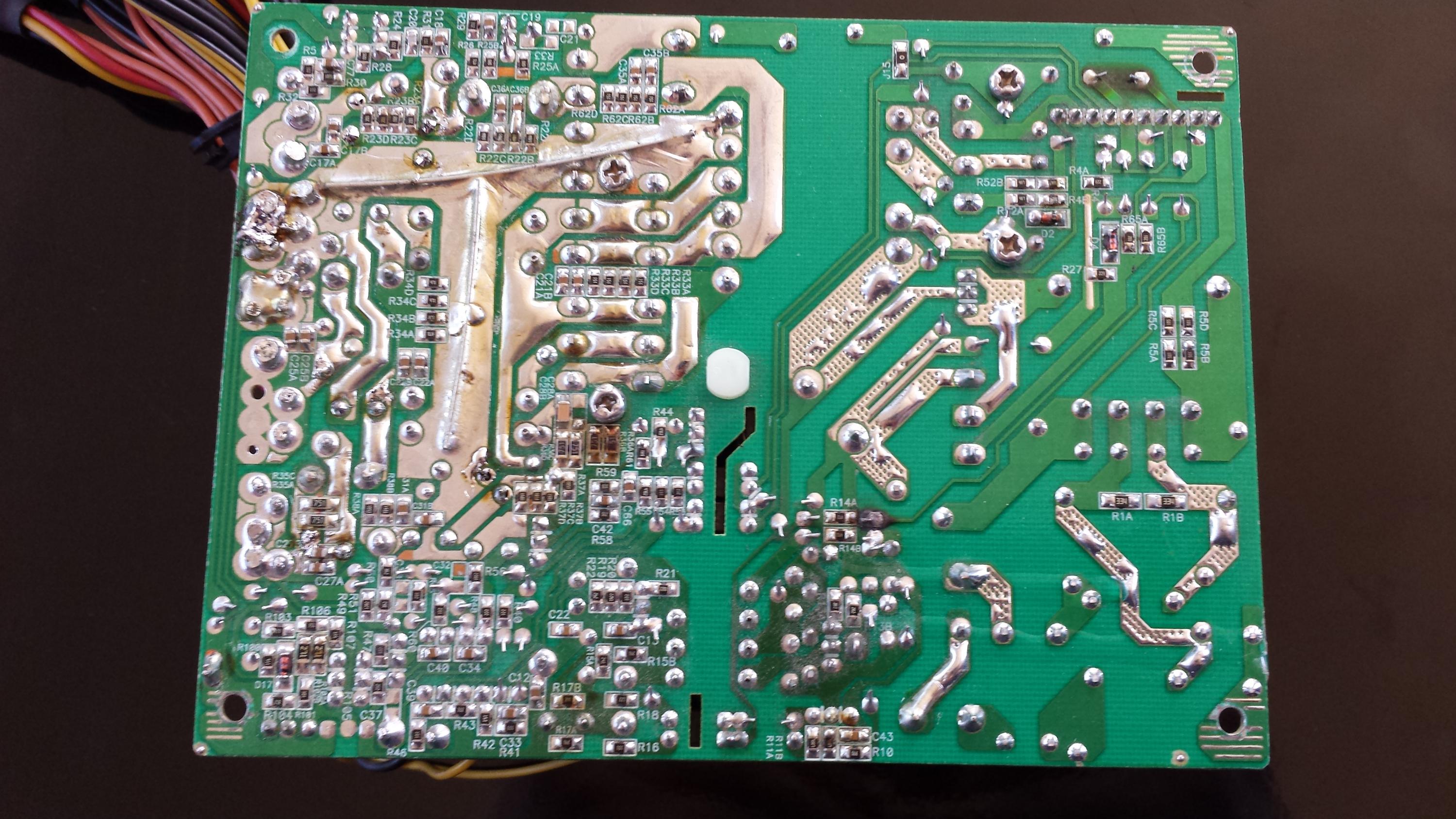

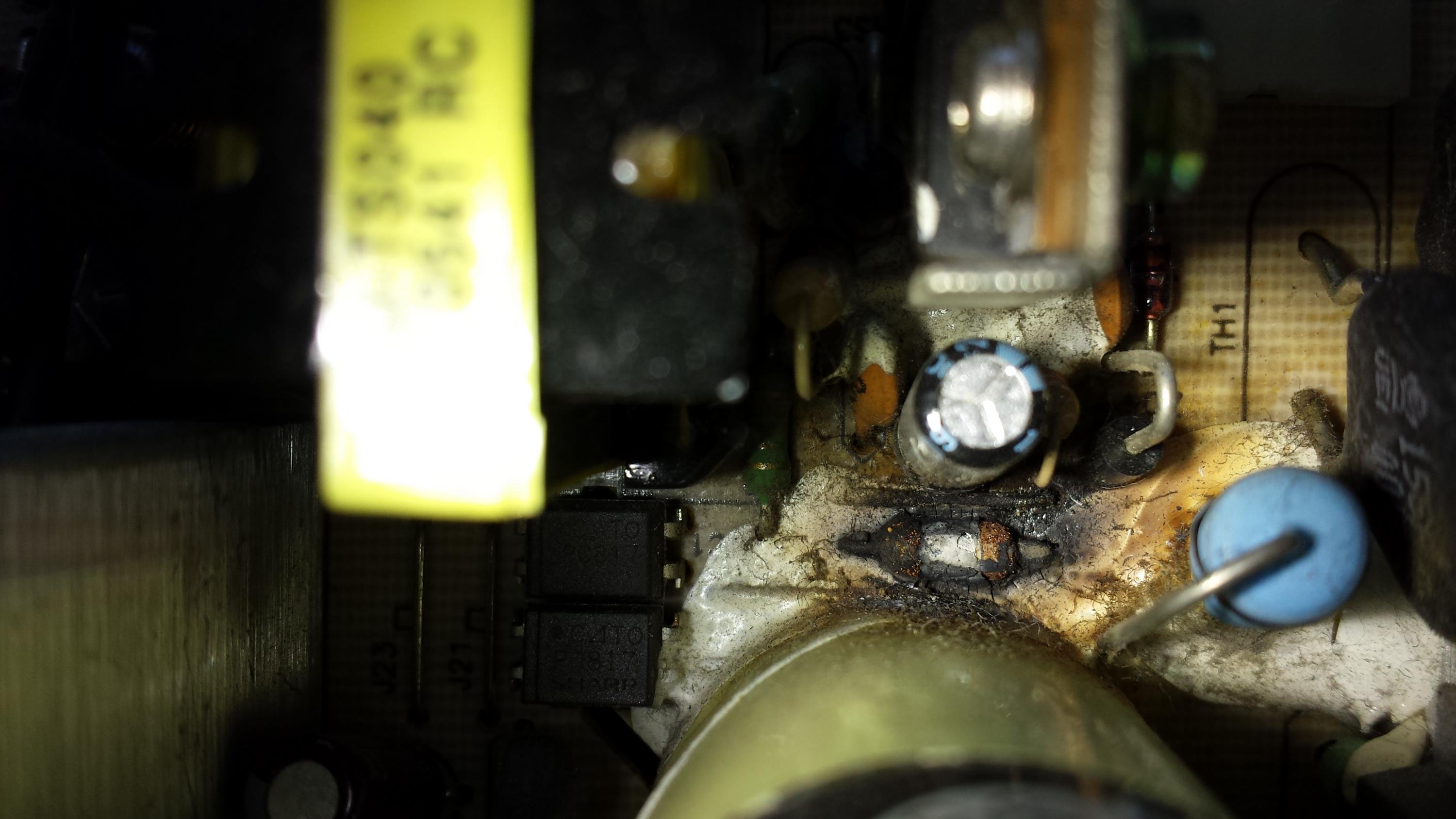

    But there is more. Looks like something was overheating there. On the board backside you can see burned mark too below R14A that is about right side in the middle of the board. Is this repairable? Too much components in a tiny space perhaps caused this?

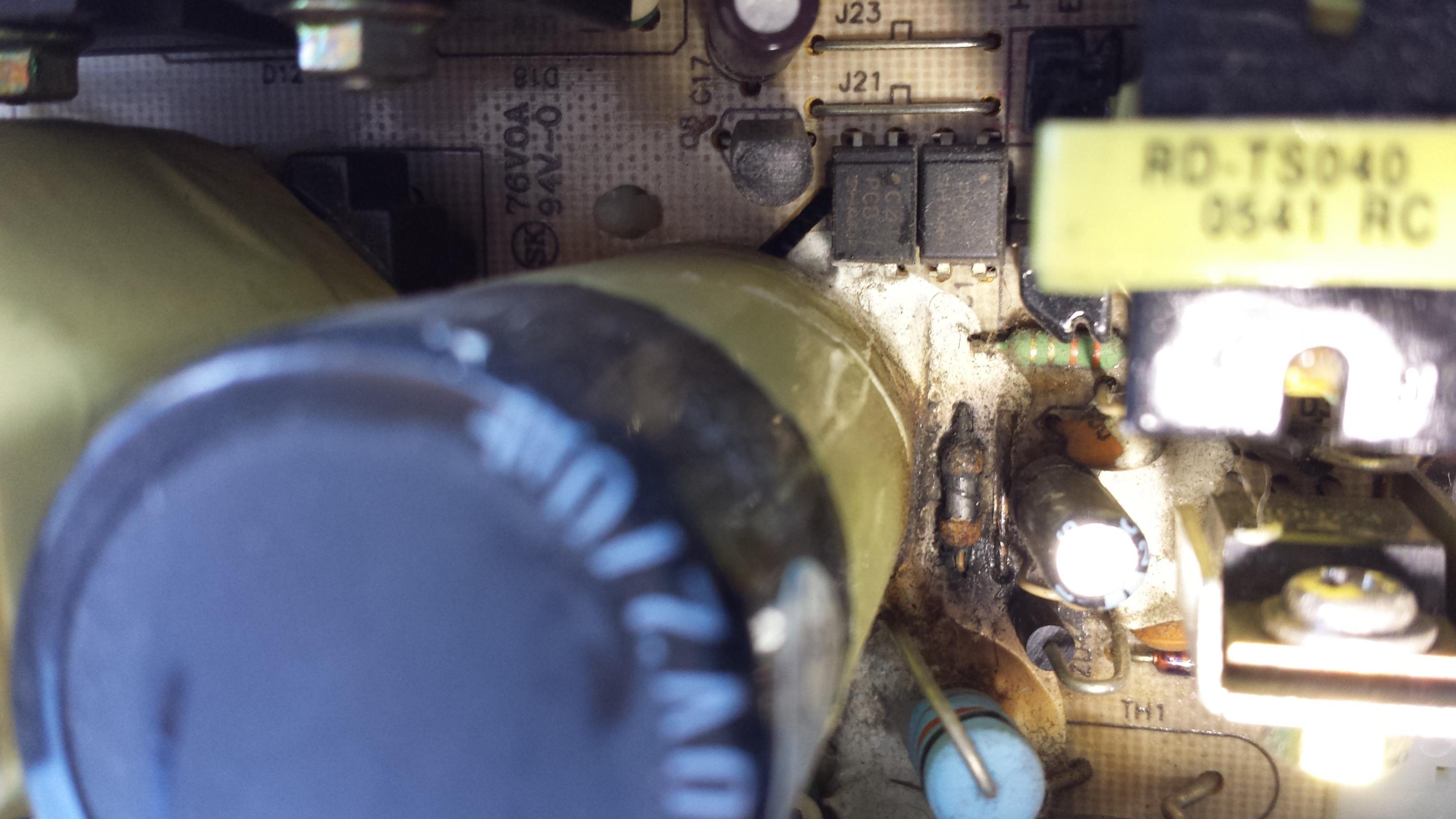

    R14A is the spot burned by the resistor, the black mark at the pad looks almost like poor contact.
    Follow that trace and you will find another burned area, what's on the opposite side there?
    Coming back to the other side of that resistor I think it's related to the 5VSB sircuit, seems to go down to the lone optocoupler at the boards edge.
    On the left side of the board you have a capacitor or something which is not soldered on, a bit above R56.

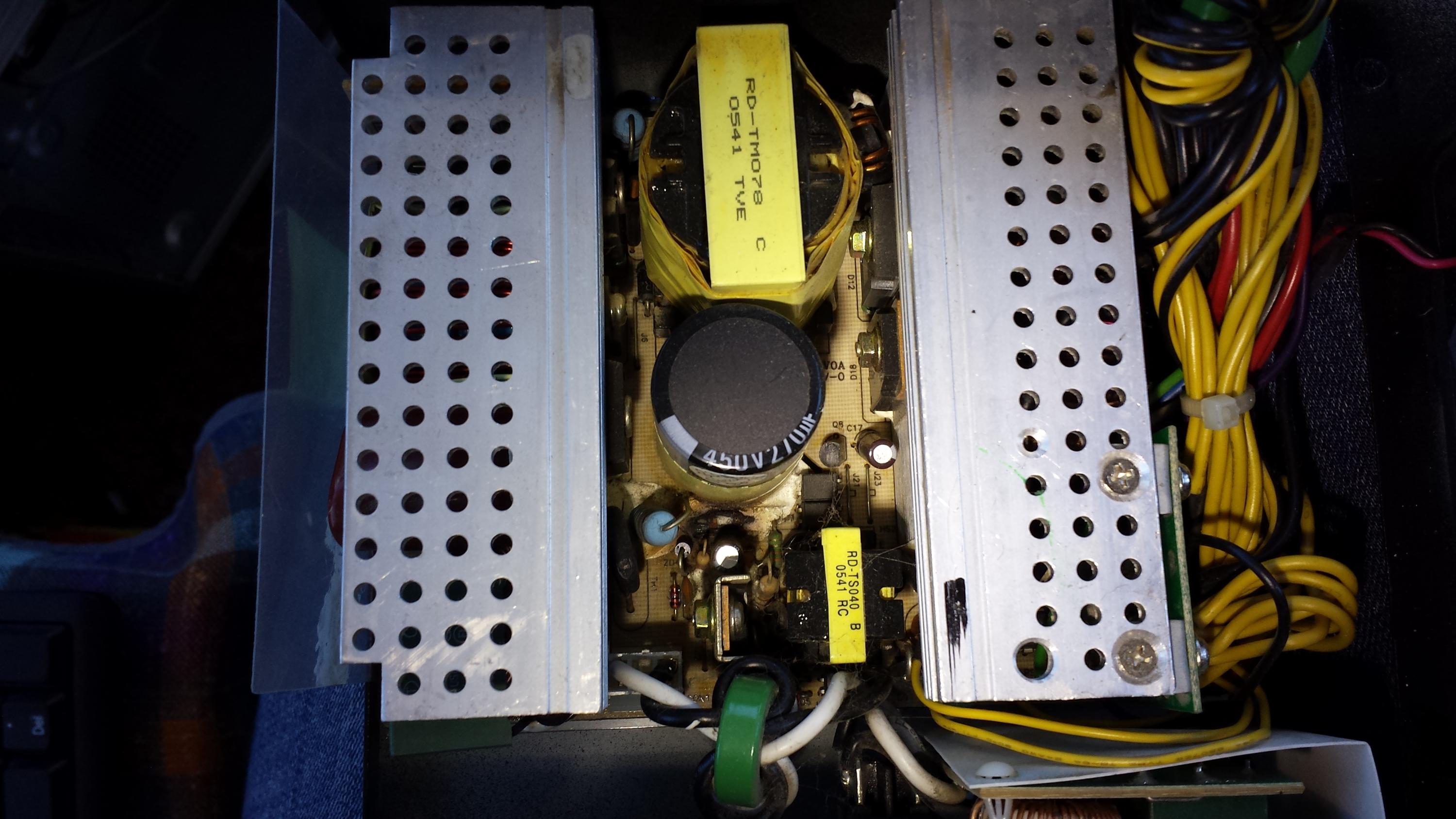

      Above R56 is what I believe is my replacement capacitor and my bad soldering skills, it sure needs resoldering properly. I will check it out later and what's on the opposite side on the burned area.
      Ok, looks like on the opposite side of the burnmark is diode below ZD1 mark. If I need resistor and diode replacement, what to look for? Are they common on spare psu parts or other board I can borrow from?

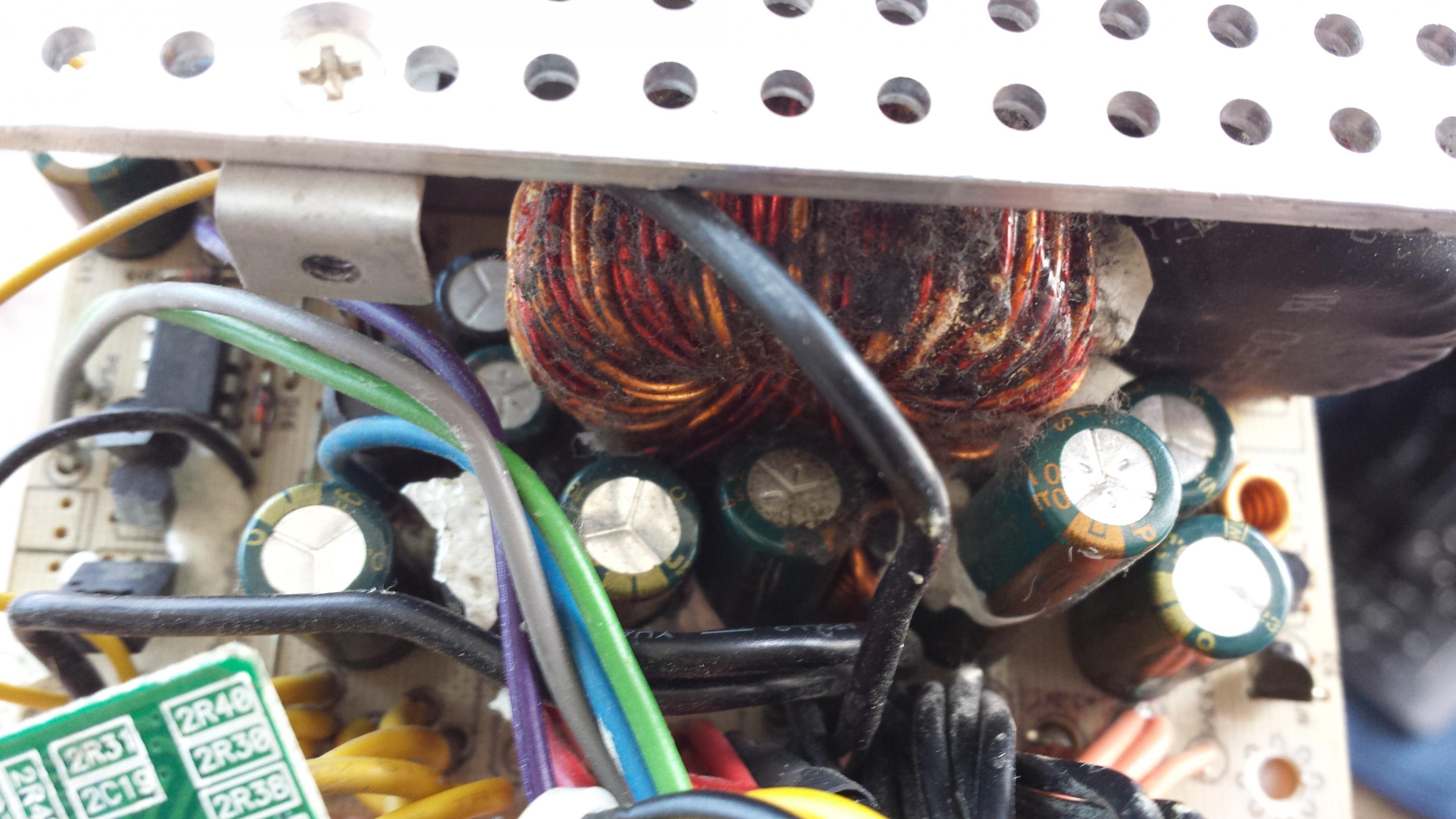

        I see two potential problems with this PSU: cheap Teapo capacitors and tan/brown glue that goes conductive over time.
        Regarding the PC not turning all the time and USB devices becoming disconnected... that would most likely be related to bad 5VSB output filter caps. From the pictures you posted above, it appears that the 5VSB rail still has the original green Teapo (SC?) capacitors. I strongly suggest replacing those first, along with all other Teapo caps, before looking into the overheated resistors. Chances are, the Teapo caps are the reason why that happened. Removing as much of the tan conductive glue, especially from the primary side, is also very important. Once you get these two things fixed, then check if the overheated components are still in spec (they should be if the PSU still works after the cap replacement).

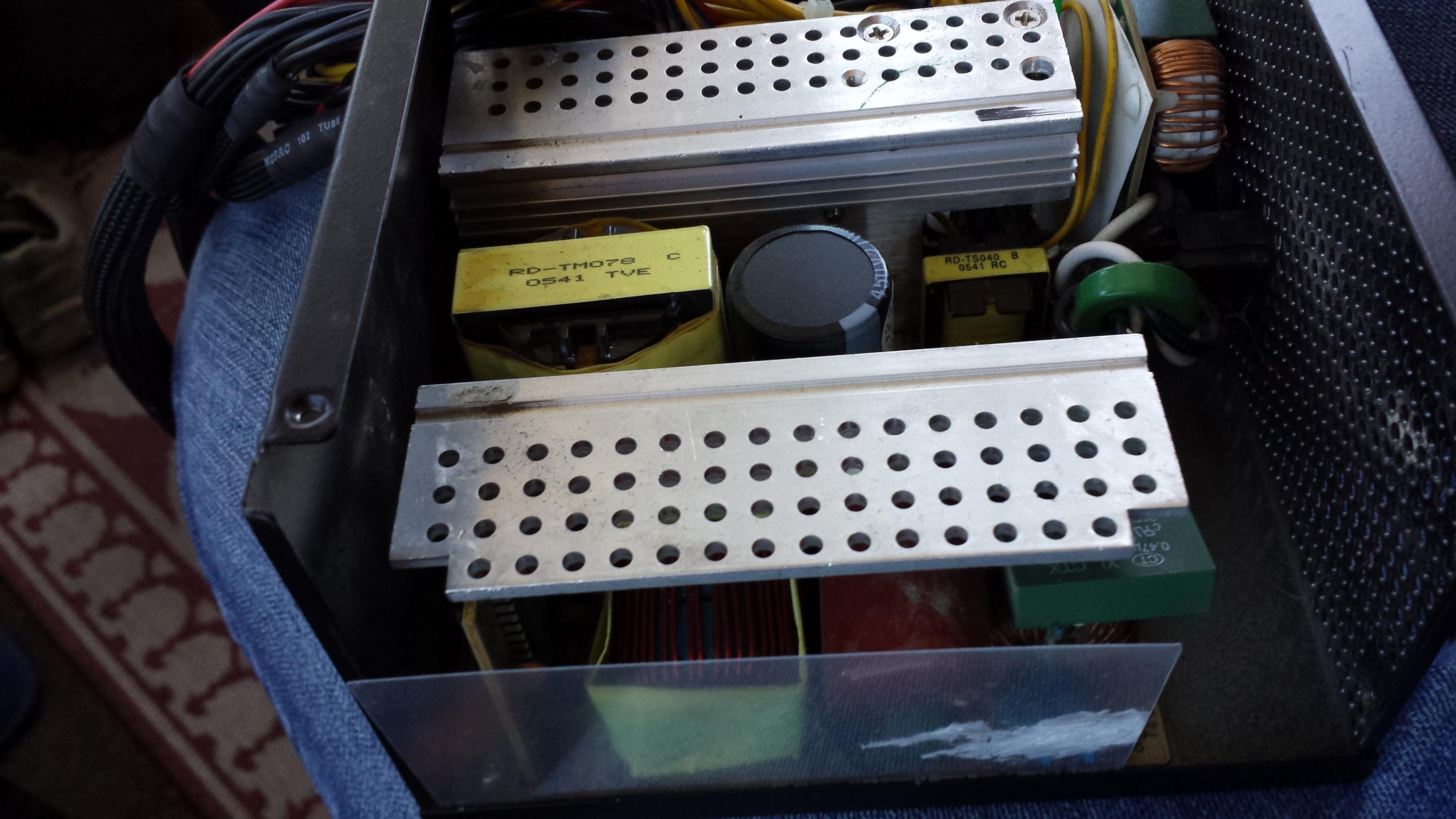

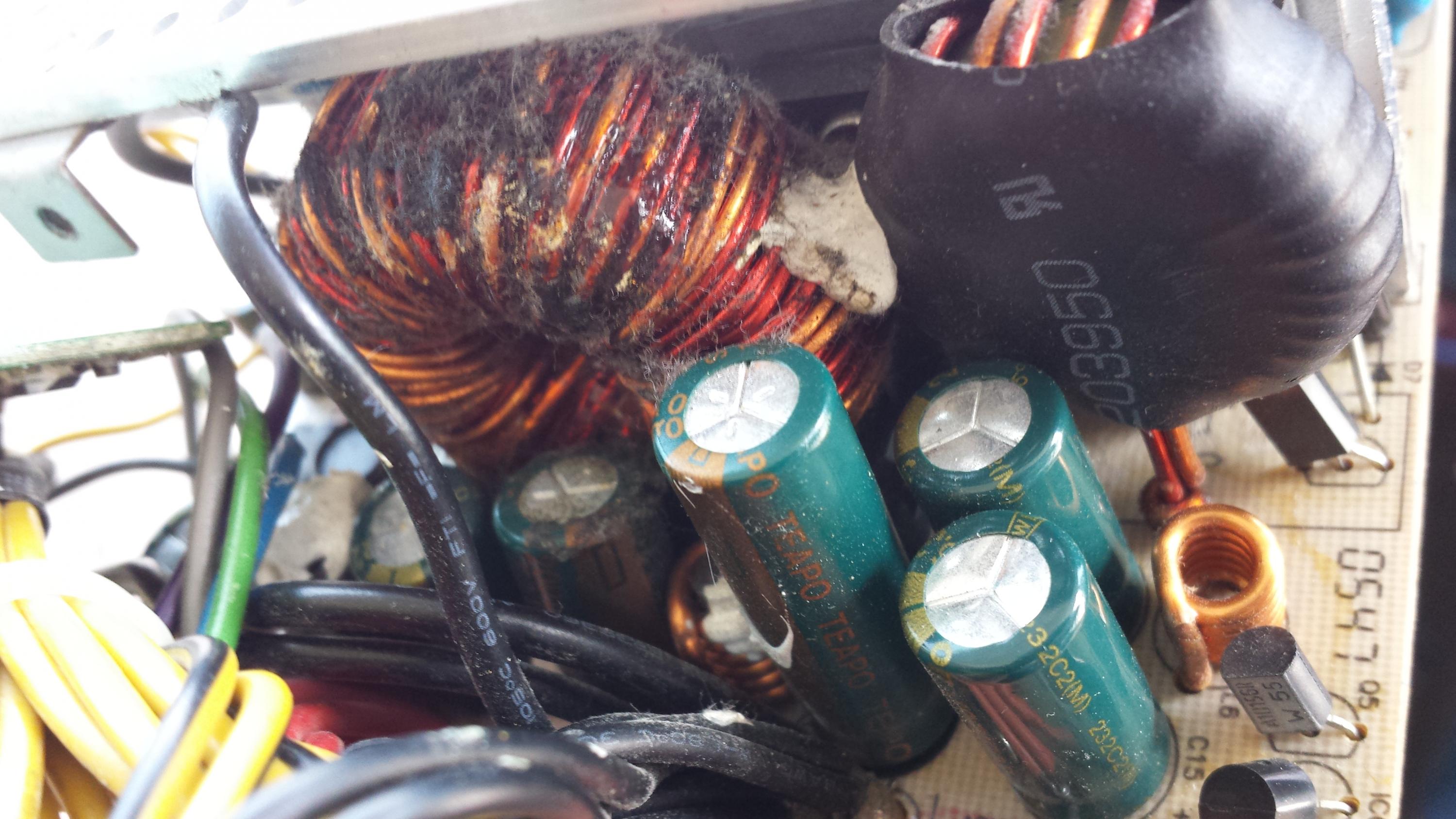

          There are two big Teapo caps, larger one is 3300uf 10v, smaller one is 200uf 6.3v and there are two others hidden in the middle too far to easy reach and read labels. So I will replace these two ones with recommended caps. About the glue you mean that white-ish compound between components seen on the first pictures? If so, how to remove that hardened stuff?

            Probably your 5vsb has gone high voltage but is being saved by that blackened zener diode on the primary side.
            Replacing all electrolytic capacitors on the primary side except for the large bulk cap would be par for the course.
            And at the same time all capacitors related to 5vsb on the secondary side.

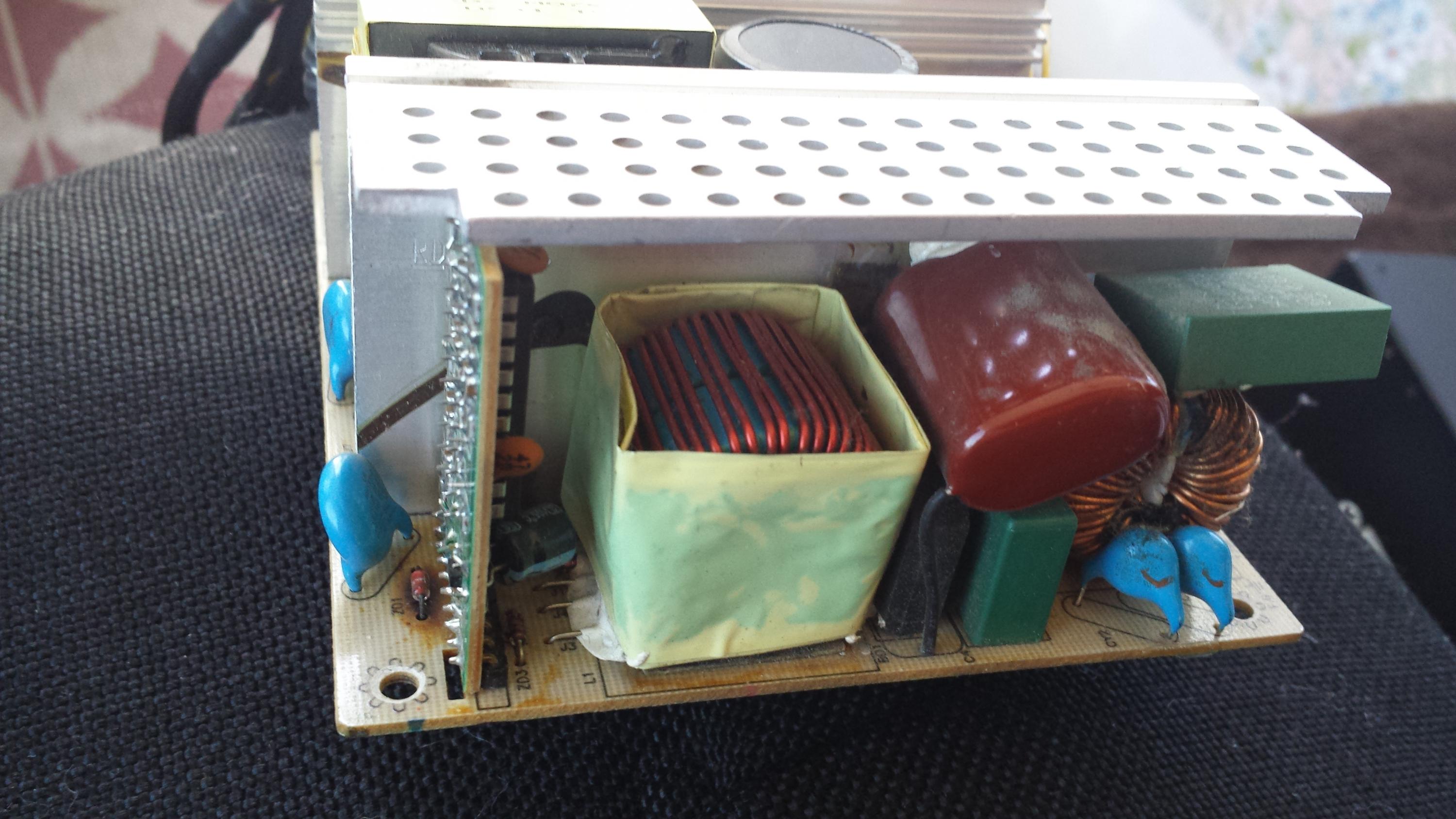

            But seeing how close the capacitors are to that big coil in there I'd replace them all in one go.
            As I'm sure they must be really well baked by now.

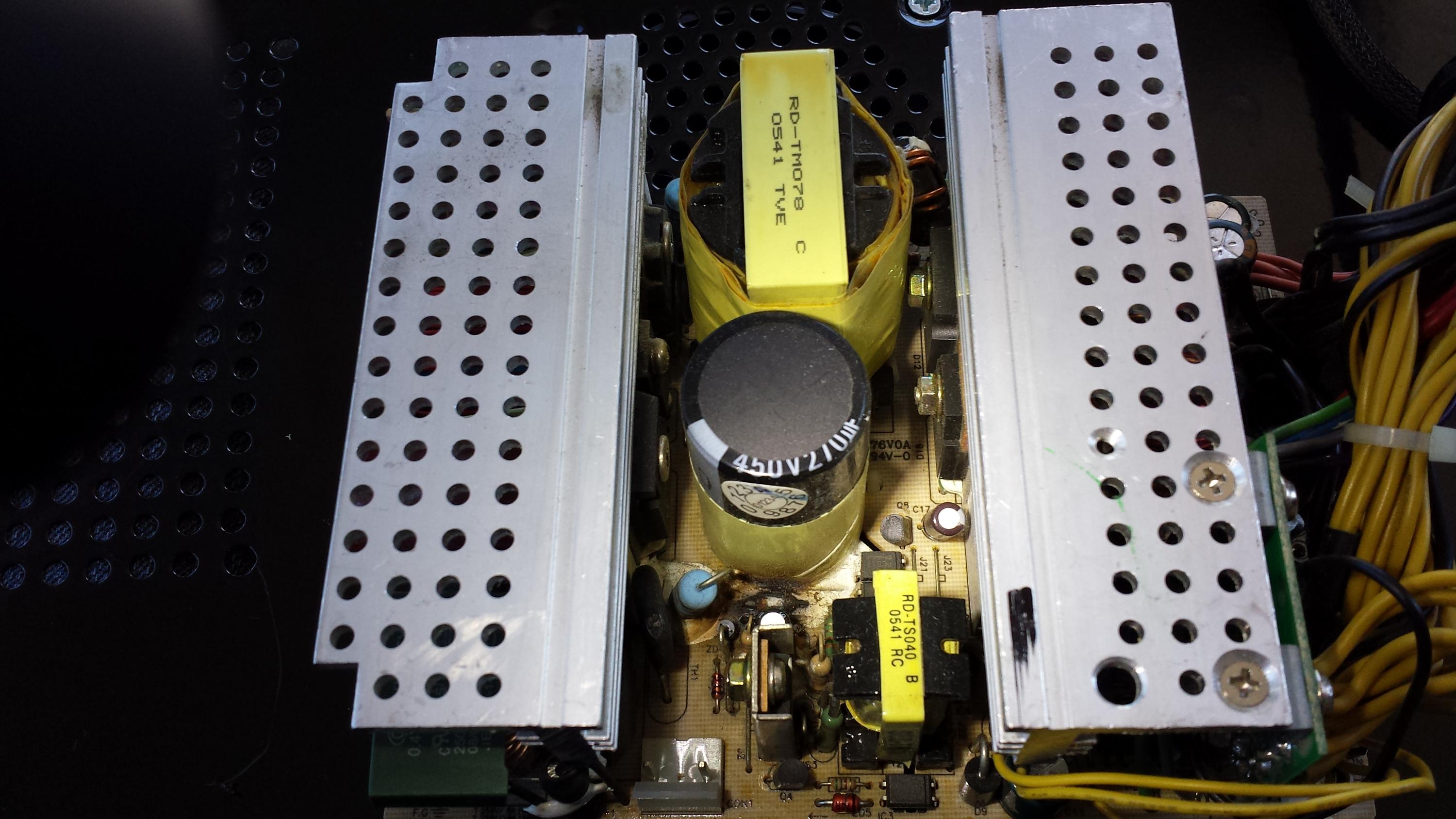

              Never come to my mind that these big coils reaches high temp too, then maybe it is not good at all to use that psu at upcoming hot summer days when it reaches 25-28 degrees C in a room where pc is placed and instead just buy a new psu with cleaner design and more airflow inside. If only it was that simple...
                Don't replace just one or two caps. Replace all of the output caps and be done with this so that you don't have to take it apart and open it again or wonder why the PSU is not working when more bad caps pop up.
                That said, it is most important to get the 5VSB output filter caps replaced, as that will likely stop the overheated components on the primary from overheating further. You can see one of the 5VSB output filter caps (Teapo SC, 16V, 470 uF) on the bottom-left side of this picture:
                https://www.badcaps.net/forum/attach...2&d=1528023173
                There is another cap behind it, right next to that purple wire, which is likely the second output filter cap for the 5VSB (probably same voltage and capacitance). I recommend going with 6.3V or 10V cap rated for 1000 uF instead of 16V, 470 uF that is there originally.

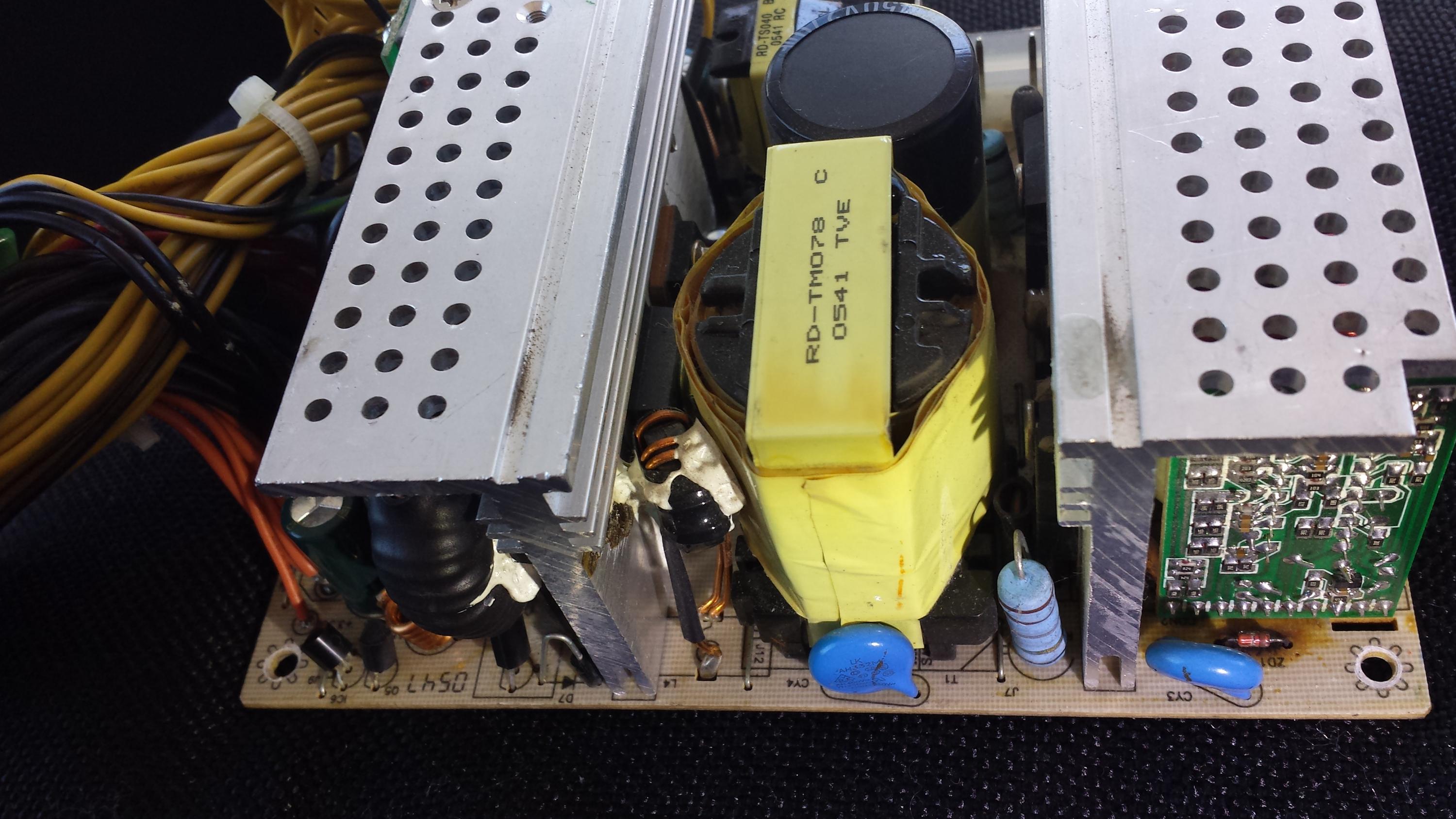

                Well, I had a second look at your pictures, and it appears that I am wrong and your PSU only has regular white silicone glue, which is safe. So disregard my previous comments. It looks like when this component overheated, it discolored some of the white glue with sooth. But there doesn't appear to be any tan conductive glue anywhere else.
                Nah, the PSU will fine, even with those temperatures. My room regularly reaches 28-30C in the hotter summer days, and most of my old PSUs are fine with it.
                While these big coils/toroids can run hot, they don't run that hot - at least not more than the insides of an LCD monitor power supply.
                But if you use good quality Japanese caps, this won't matter too much, because they will withstand the temperature just fine.

                  So it is ok to replace these 2 Teapo SC 16V 470uF with 6.3V or 10V 1000uF caps?
                  I have Panasonic branded 6.3V 820UF FJ caps. Are these decent for replacement?
                  And I do not have 3300uF 10V cap, so I will need to order that one. I do have Panasonic 3300 6.3V FJ caps at home but my guess is 6.3V will too low to use there (tallest cap in the last picture) so I better go safe and order 10V or 16V rated cap.
