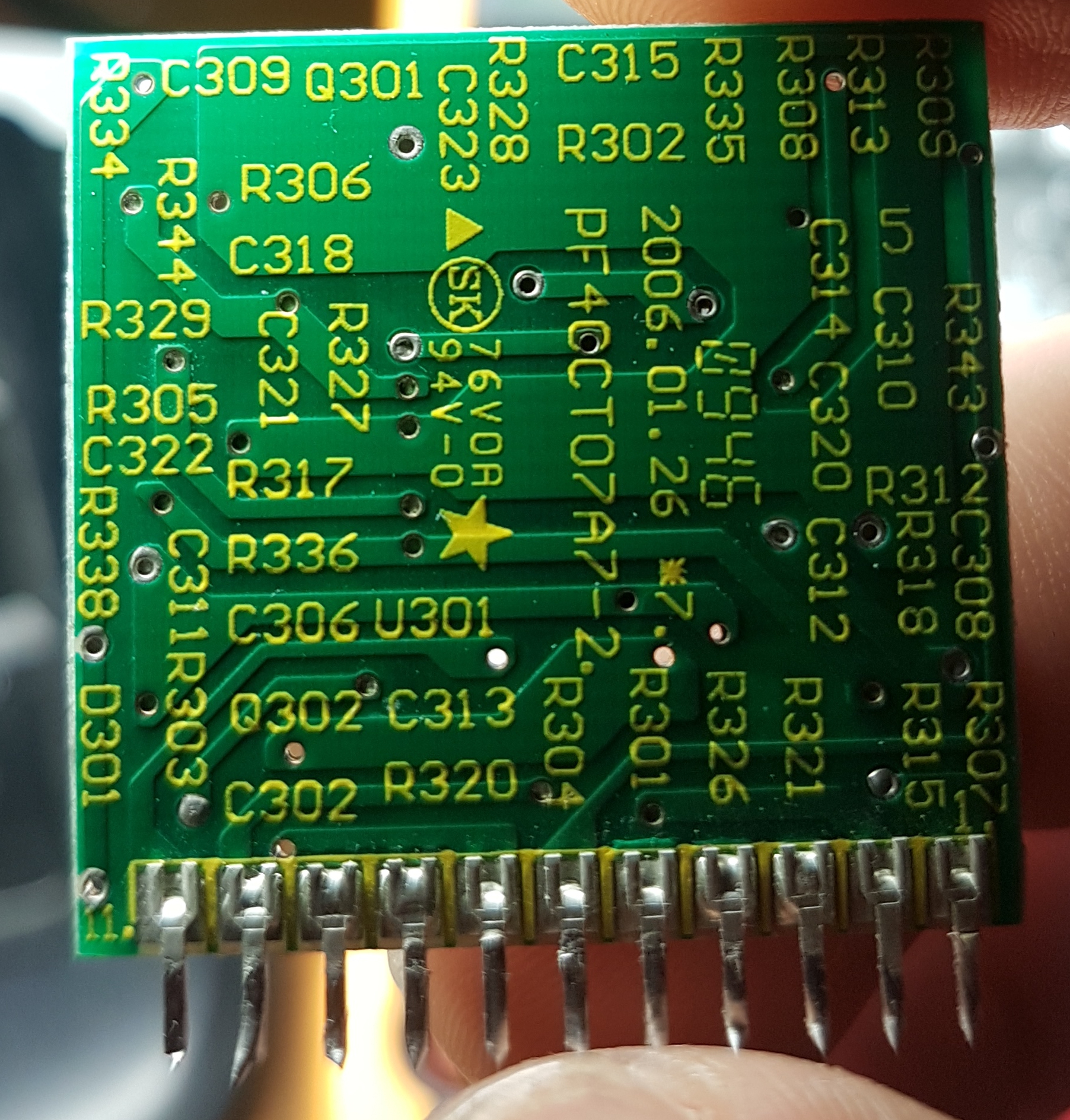

    Hi guys.

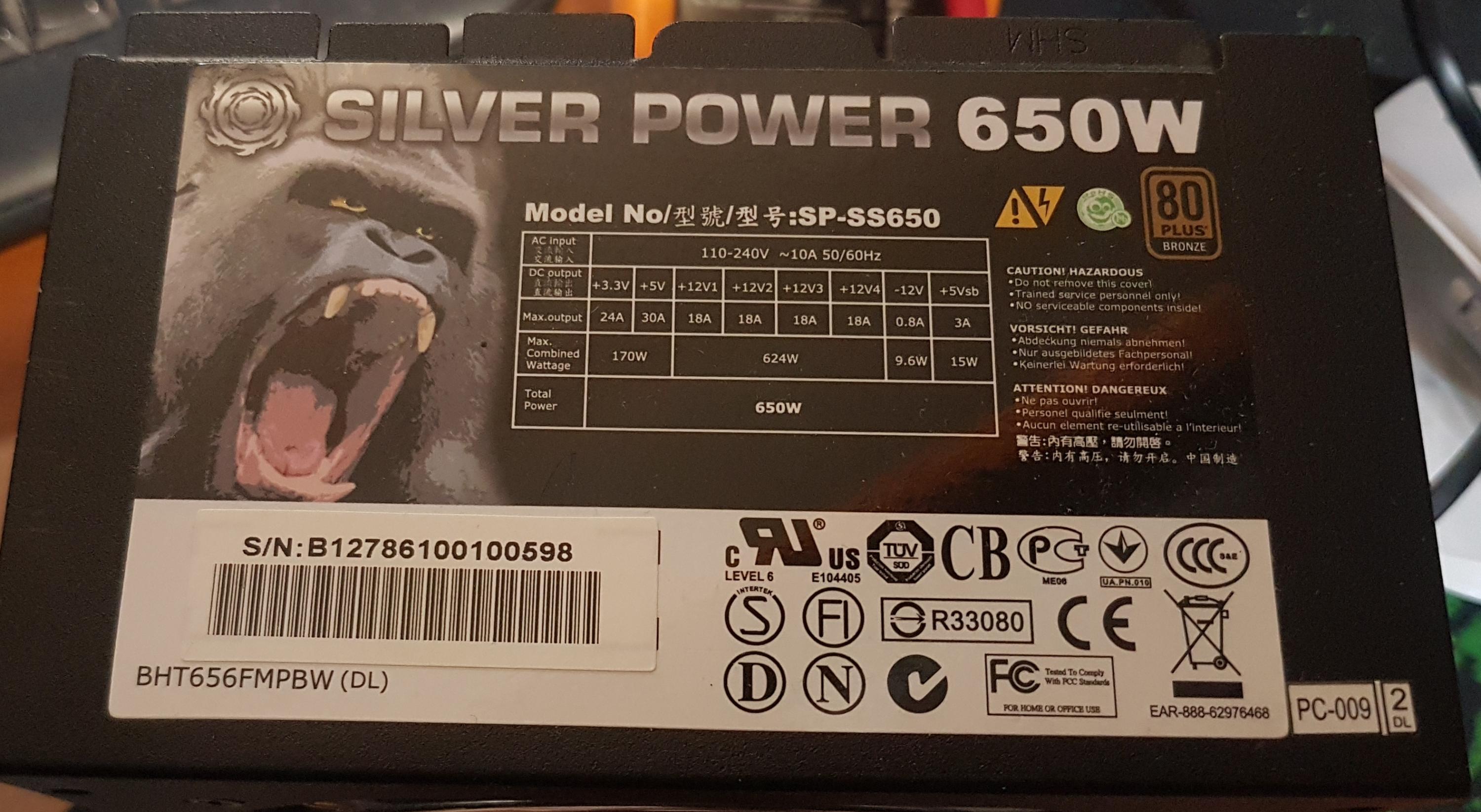

    Recently, I troubleshot PC power supply, that was dead. It blows his fuse.
    The power supply is - SILVER POWER 650W - SP-SS650
    I change the fuse, Bridge Rectifier, Capacitator, Transistor and some other elements... Now it's turning ON without blowing fuse, but there is no low-voltage (5V, 12V ...)

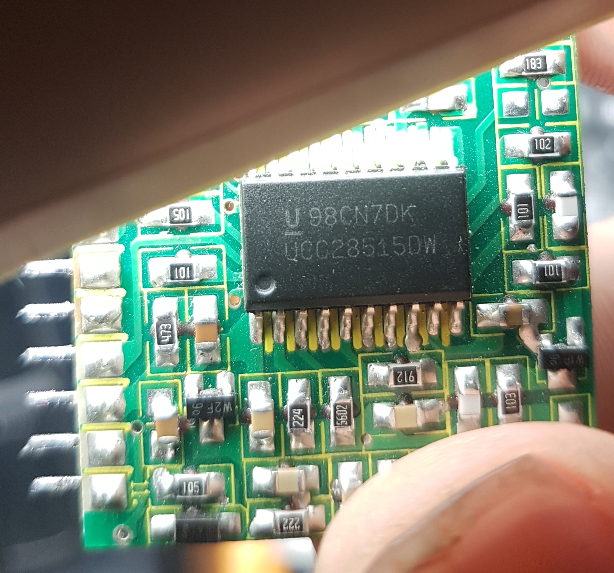

    In this power supply, there is a board that I think is for switching ON low-voltage, and I want to see if the IC is OK, but I can't find what model is...
    IC p/n: U 98CN7DK UCC28515DW
    I put some pictures on the board and IC.

    Re: Trouble finding an element on board!
    Probably compatible with http://www.ti.com/product/UCC28515
    Looks like a multiple failure issue now... ensure you have APFC boost voltage and 5VSB at least before proceeding.
      So finally I have 5VSB, but I don't know what is this APFC boost voltage...
