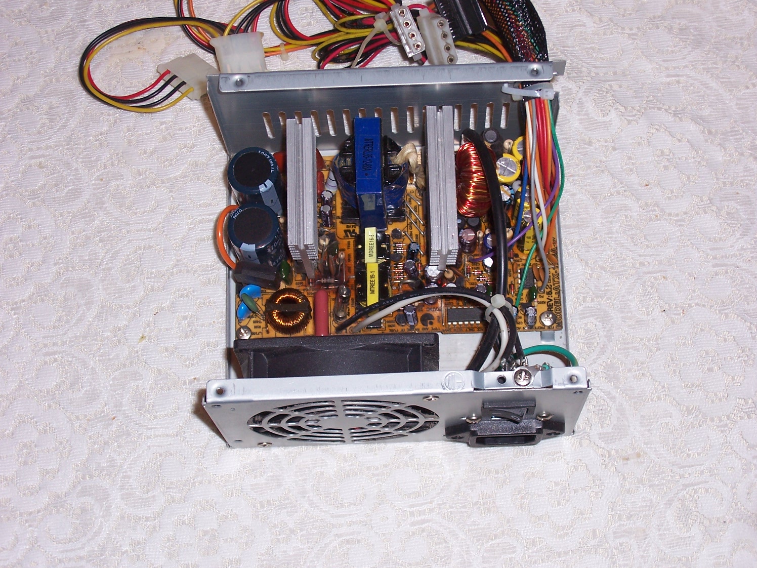

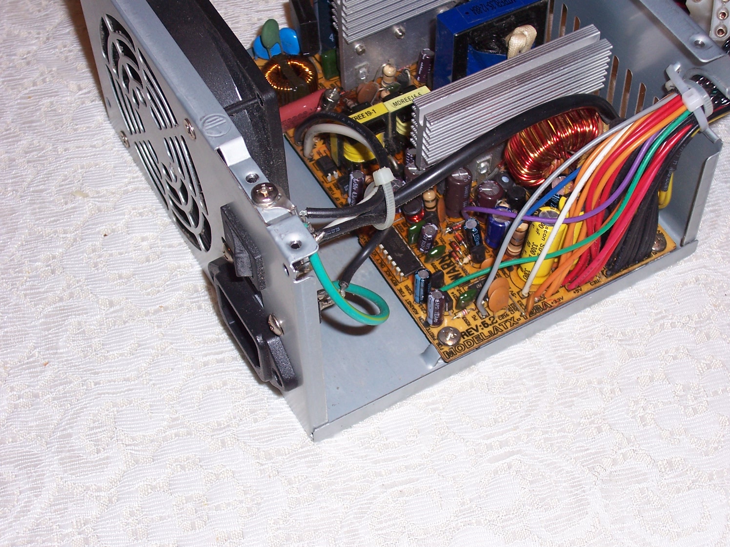

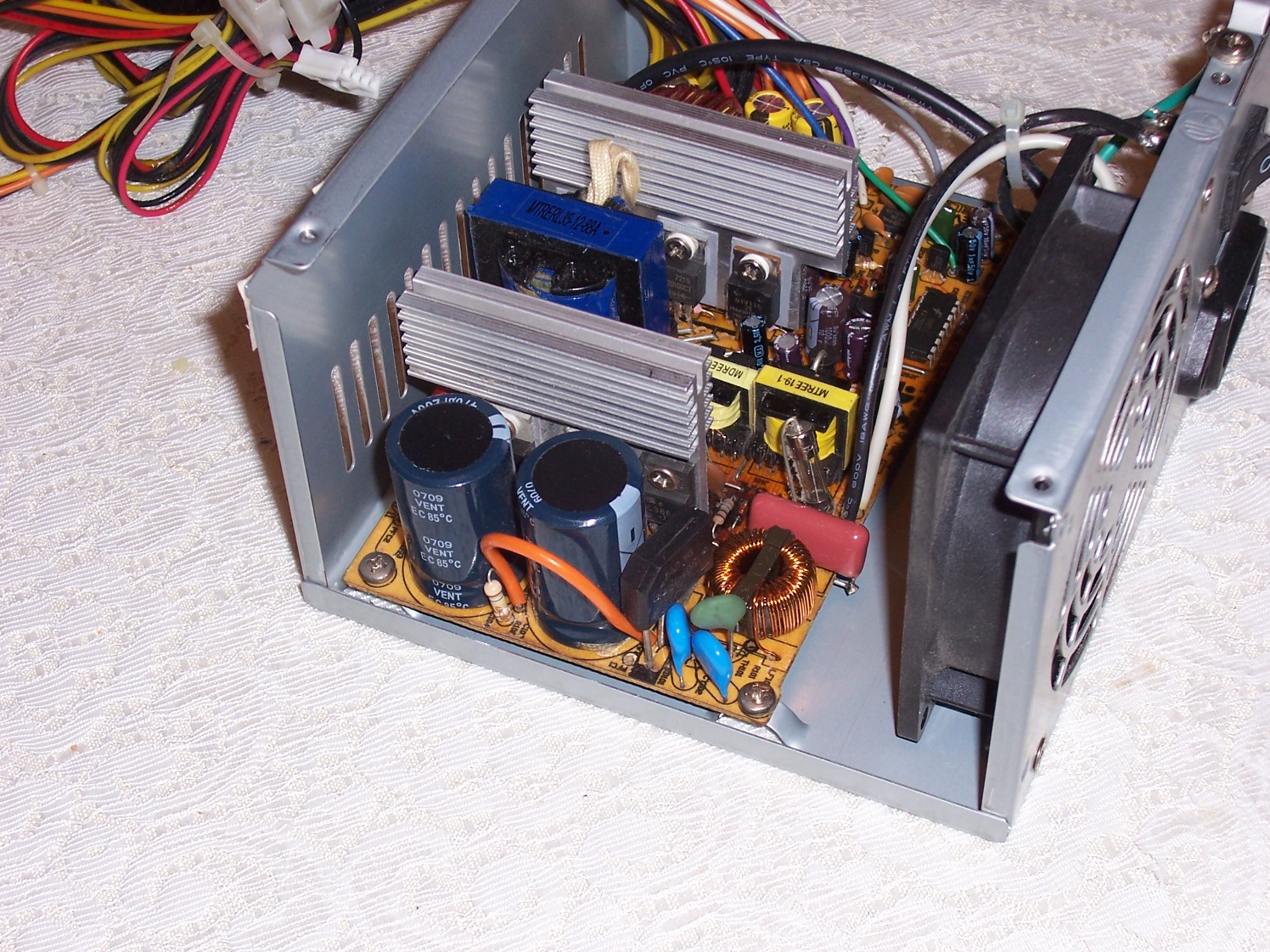

    Here is a Starpower Model PIV550 (peak load 450 watts), probably better known as a POS not really worth messing with. However, I accepted the challenge. The 5VSB was working, but the power supply was otherwise dead. I began by using a scope to look at the output signals on the 7500 PWM chip. No signals. Next I looked at the Vcc on the 7500 pwm chip which was a pulsing signal rather than DC voltage. I determined that the filter capacitor on the 5VSB feedback line was totally open. Replaced this 470 uF capacitor and the power supply came back to life, but no power good signal. So I decided to do a capacitor study on this power supply.
    All of the output capacitors were Sus'con, and all of the small capacitors were Fuhjyyu. Strange combination! One of the output capacitors on the 3.3 volt rail was Sus'con 2200 uF/10 volts but measured 1480 uF with esr 0.09. Replaced it with a Jamicon pullout measuring 2350 uF esr 0.02. All other Sus'con capacitors on the outputs measured OK for capacitance and esr.
    ALL of the small Fuhjyyu capacitors were a different story. I used measured pullouts for replacements. What I found was as follows:

    As can be seen, many of the Sus'con capacitors were in good shape, but ALL of the small Fuhjyyu capacitors were very bad. This demonstrates that replacing the bad bulging large capacitors but assuming that the small non bulging capacitors are good is a bad idea.
    I also added line filter coil and capacitor. Now I don't have to call it a cheap POS.

          Has anyone else worked on a StarPower psu lately? After a recap and adding a line filter I think this one should be good for at least 150 watts. What do you think?
          Old proverb say.........If you shoot at nothing, you will hit nothing (George Henry 10-14-11)
            master hoarder
            • May 2008
            • 12175
            • Bulgaria
            Re: Starpower with bad capacitors
            Yes, should be okay for 150-200 Watts continuous, depending on the capacity of the input and output filter caps. The heatsinks definitely look decent enough.
            The only thing I will pick on is the large "dummy load" resistors near the output capacitors. Anything dissipating more than 2/3 of a Watt I would either remove or replace with a different value resistor. Otherwise your "new" replacement output caps might get cooked soon too.
            In general, I recommend no less than 15 Ohms for the 3.3V rail (22 Ohms or more preferable), 47 Ohms for the 5V rail (68-100 Ohms preferable), and 270 Ohms or more on the 12V rail (I usually do 500-1000 Ohms, or none at all on newer PSUs that have heavy 12V rails) - all of this if the resistors are rated for at least 1 Watt of power. This output resistor modding will lower the heat on the secondary side capacitors while also improving PSU efficiency,
            Other than that, looks good.
            I'm guessing the burned PCB is from the opened output capacitor on the 5VSB. I've seen that happen many times. And it's exactly like you said - 5VSB is unstable, which makes the secondary side auxiliary rail that supplies Vcc power to the PWM controller also unstable, and that brings the whole PSU down.
