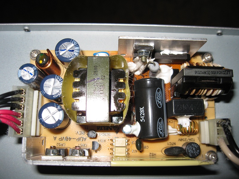

    Dell PowerConnect 2716 Switch PSU; low voltage
    I have 2 of these, one working, the other not so much
    I know the large 100uf, 400v cap is good
    i did test the 47uf startup cap, it did barely pass, but maybe i forgot to read the unit on the multimeter
    i assume the capacitance will degrade over time so i probably should replace it, and i assume a EEU-FR1E471Y will be fine, but it is still within spec so the issue should be else where right? I have read this cap is a common cause of failure in these
    my issue is i am getting 0.7v output, before testing those 2 caps i think i was getting 0.5v
    none of the caps are showing any bulging or leaking
    i attached a picture of the power supply i found with a google search
    what part should i check next

    Re: Dell PowerConnect 2716 Switch PSU; low voltage
    You need to find the switching power supply IC chip on this board it is going to be any where from 4 to 8 terminal to it google the part number it could even be s surface mount IC chip ones you found that chip look for a capacitor near that chip replace it first before you do anything else
    Please post a photo of the bottom of this power supply board
    Some things to check the main board fuse also look for blown apart part or burn up parts and where they are on the board
    If fails to turn on the power supply then I change that chip
    Then if still does not want to work then we go from there
    I hope this helps
      i assume the capacitance will degrade over time so i probably should replace it,"
      So you did not test the ESR of the cap? You should replace it anyway, needed or not so you do not have to deal with it in the future.
      The primary section has been cooking for awhile as you can see the board is turning brown from the heat.
      Caps and diodes in the cold side tested fine for sure?
        Caps and diodes tested fine for sure?
        I tested the capacitance, it was i think -18% ish, from what i saw all Electrolytic have a 20% tolerance, does that +/-10% or +/- 20%?
        So if i use a working garbage cap i am going to replace from my other board do you think it may get it to put out 5v? obviously not intend to leave it in there, just to see if that cap is the issue
          Well the garbage cap worked, i just stuck it on a 1" lead made from Ethernet wire to the left over solder from removing the failed cap on the bottom of the board
          it lasted over a year and a half doing the same thing, so why not another 15 seconds?
          well it puts out 5v and it is able to power the switch up
          The stock 47uf cap tested at 39.27uf, my scrap one tested at 50uf
            wich still seems fine.
            Especially for high voltage caps the capacitance is on the lower side.
              When you check the cap, you need to check ESR also not just capacitance. That 47uF more likely to have high ESR.
                          Tester just arrived
                          This is the not working start up cap
                          35.85uf
                          vLoss 17%
                          ESR 40 Ohm
                          i take it that is pretty bad given a new Nichicon 10uf cap is 10.75uf; 0.8% vloss;1.4Ohm ESR
                          PN: UKL1H100KDDANATD
                            Tester just arrived
                            35.85uf
                            vLoss 17%
                            ESR 40 Ohm
                            That ESR reading means that it has gone high which means that it is ( bad )
                            A new one would read about .350 to about 1.something
                              Tester just arrived
                              35.85uf
                              vLoss 17%
                              ESR 40 Ohm
                              As expected.
                              BTW always fully discharge the cap before making the measurement or you will blow up your new meter.
