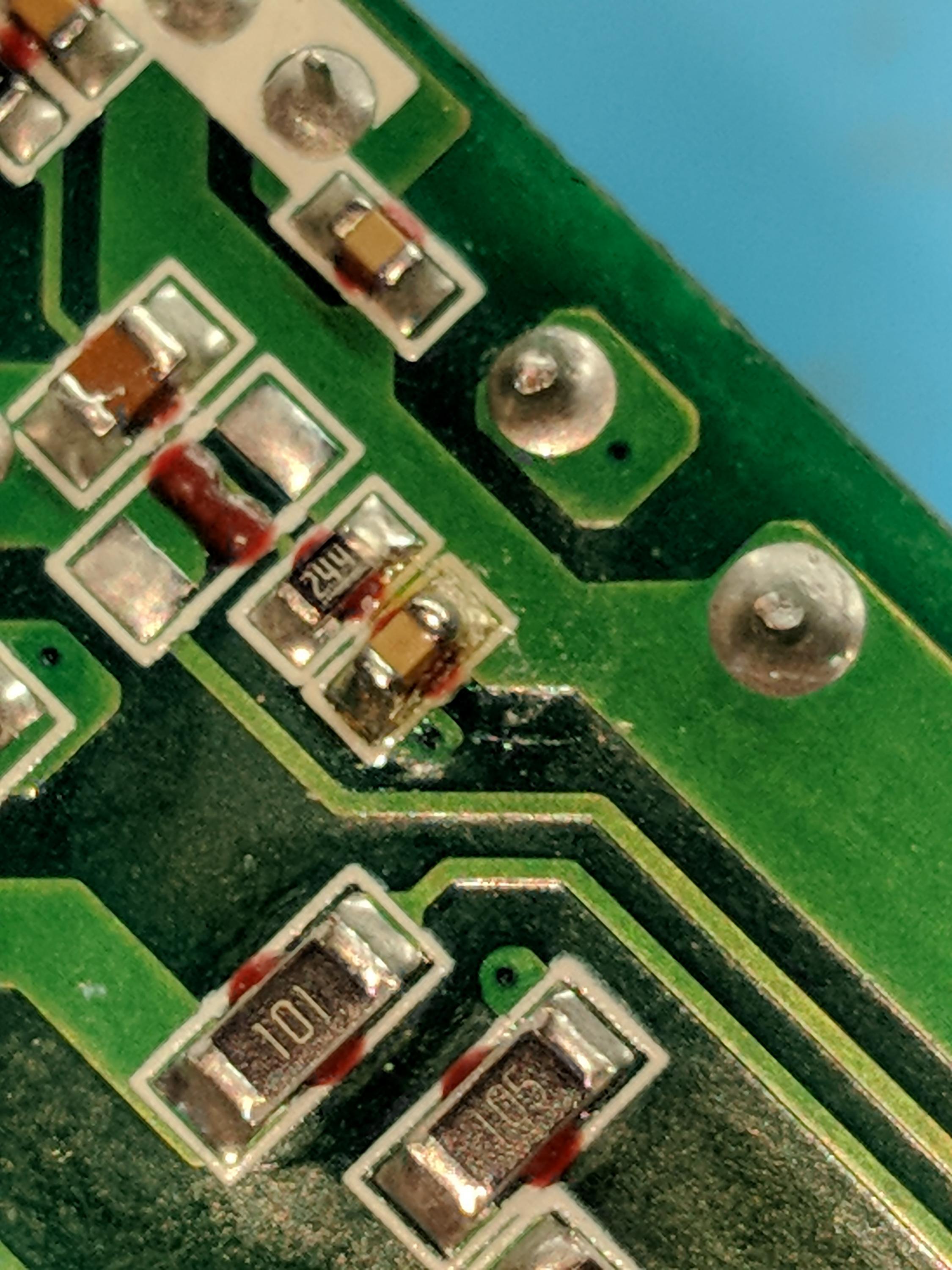

    I have a SST-ST45SF-G that has failed on all of the 3.3/5/12 lines, but the ps_on (green wire) is reading 3.7v and the 5vsb (violet wire) is reading 5v. I disassembled it and checked for any swollen or shoddy looking caps but found nothing. No components are discolored, nor do I see any scorching. It all looks perfect. It's a SFX so it's possible i missed something but i looked very closely. No sounds or fan movement either, even when the paper-clip test is done. I tested everything strait from the PSU with no cable attached to make sure that wasn't the cause. The fuse checks out as well. I checked the back mosfet but there may be one more I havent looked at yet i'll have to check. Does anyone with more experience than me (so practically anybody lol) have a probable cause to this failed PSU, or a push in the right direction?

        Re: SST-ST45SF-G failure 3.3/5/12 lines but not ps_on or 5vsb
        Disregard the images. What I suspected as a discolored component was actually just a drop of factory flux that cleaned off.
          Technically it's glue: used to hold the SMD components in place as the board goes through the solder oven
