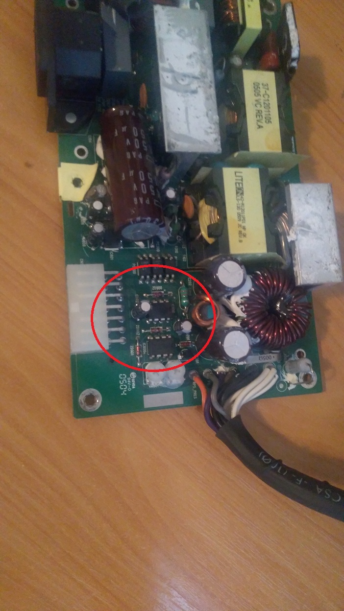

    hello. have this PS from cisco switch.
    it have V+/400V/, but dont have VCC, VG and VS. can someone lead me to repair?

    Check R310, R318 and C306,You need at least +8 volts vcc for ic300 or you could have a faulty ic300

      Also check C308, the 10uF, 50V small electrolytic cap. If it's bad, IC300, the 3845B PWM IC, cannot start up. If it's bad, use a Nichicon PW, Nippon Chemi-Con LXZ, or Panasonic FC series part. C308 is stressed some.

        i have 8V on 7pin of IC300, but no voltage on any other pin

          IC300 pin 8 is zero volts? It's the 5V Reference for the IC. IC300 may be bad, or C301 may be bad. Do you have a really low resistance from IC300-8 to IC300-5?

            8 volts is at the low end (cutoff) I believe it should have a bit more voltage to start up. I would think it should be at least 10 volts when first powerd on. I might also check D304, R311 and ZD301 That part of the circuit keeps the ic running
            I also think the ic300 could be bad

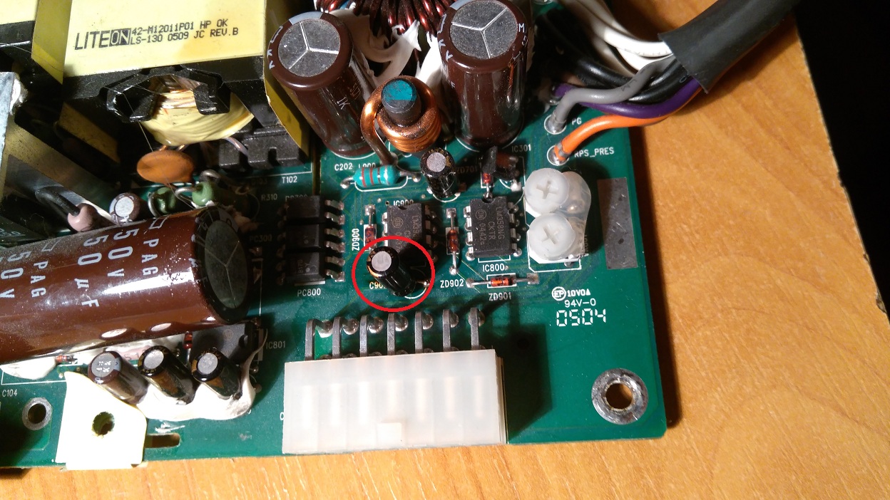

                                      i try tip from youtube, where guy trying to find capacitor that were little bad with hot air
                                      so i heat some of them with hotair gun and u know what? when i heat one of them i have good output voltage :-)
                                      VCC also rise up to cca 10V
                                      it was C902 - 4,7uF so i check it and have this reading:
                                      4,4uF, ESR-2,3ohm, Vloss-1,3%
                                      i replace it and PSU now work
                                      as i see there are some same capacitors, so i replace them all

                                        Re: LITEON PS1211 power supply
                                        IM REALLY GETTING SICK OF THIS SHIT
                                        replaced all small caps, but still after some time/hour or little more/ the PSU failed to start
                                        as i said earlier after little heat from hotair station/which was a tip from youtube for finding failing caps/ in one location the PSU start
                                        What can be bad?
