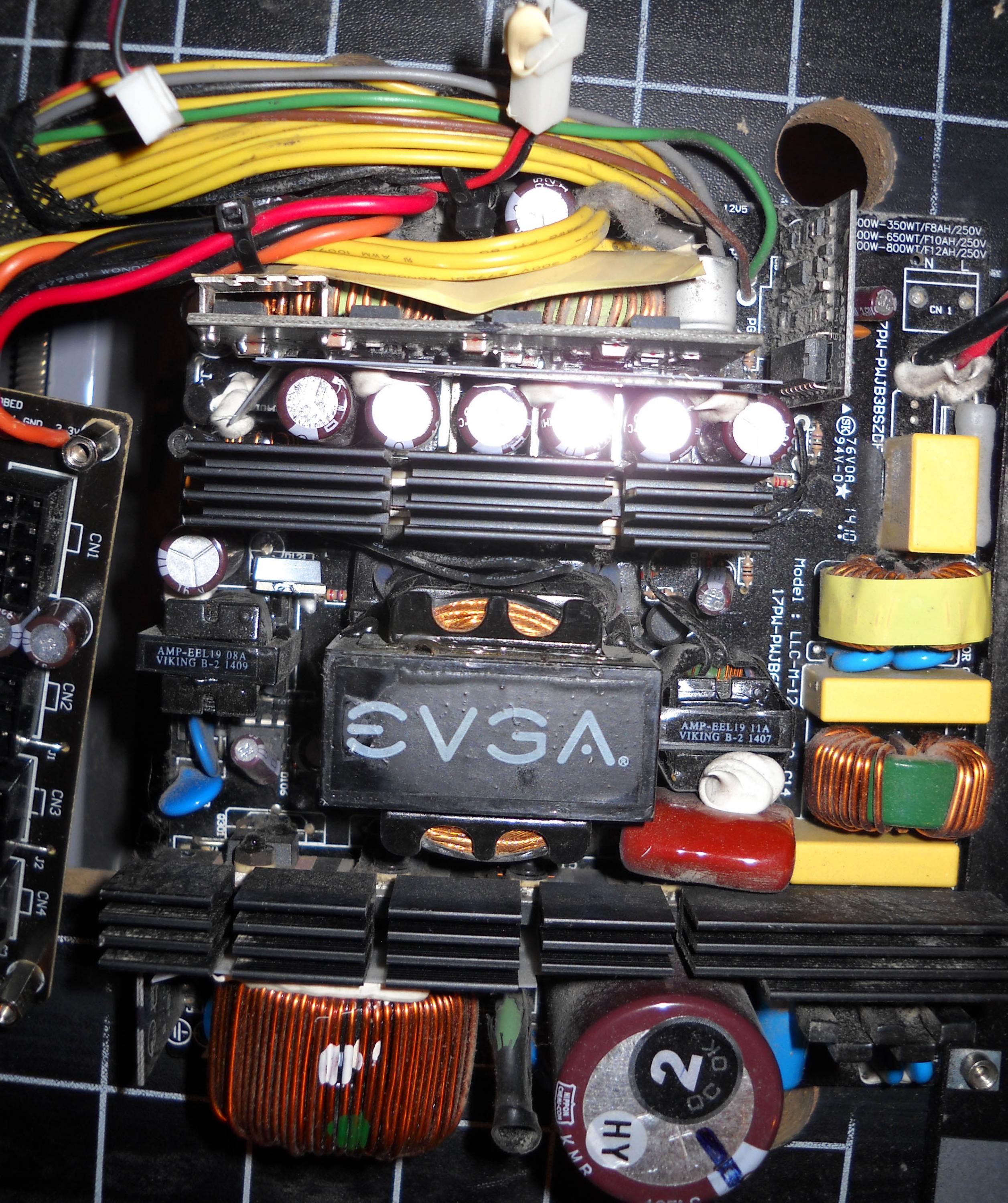

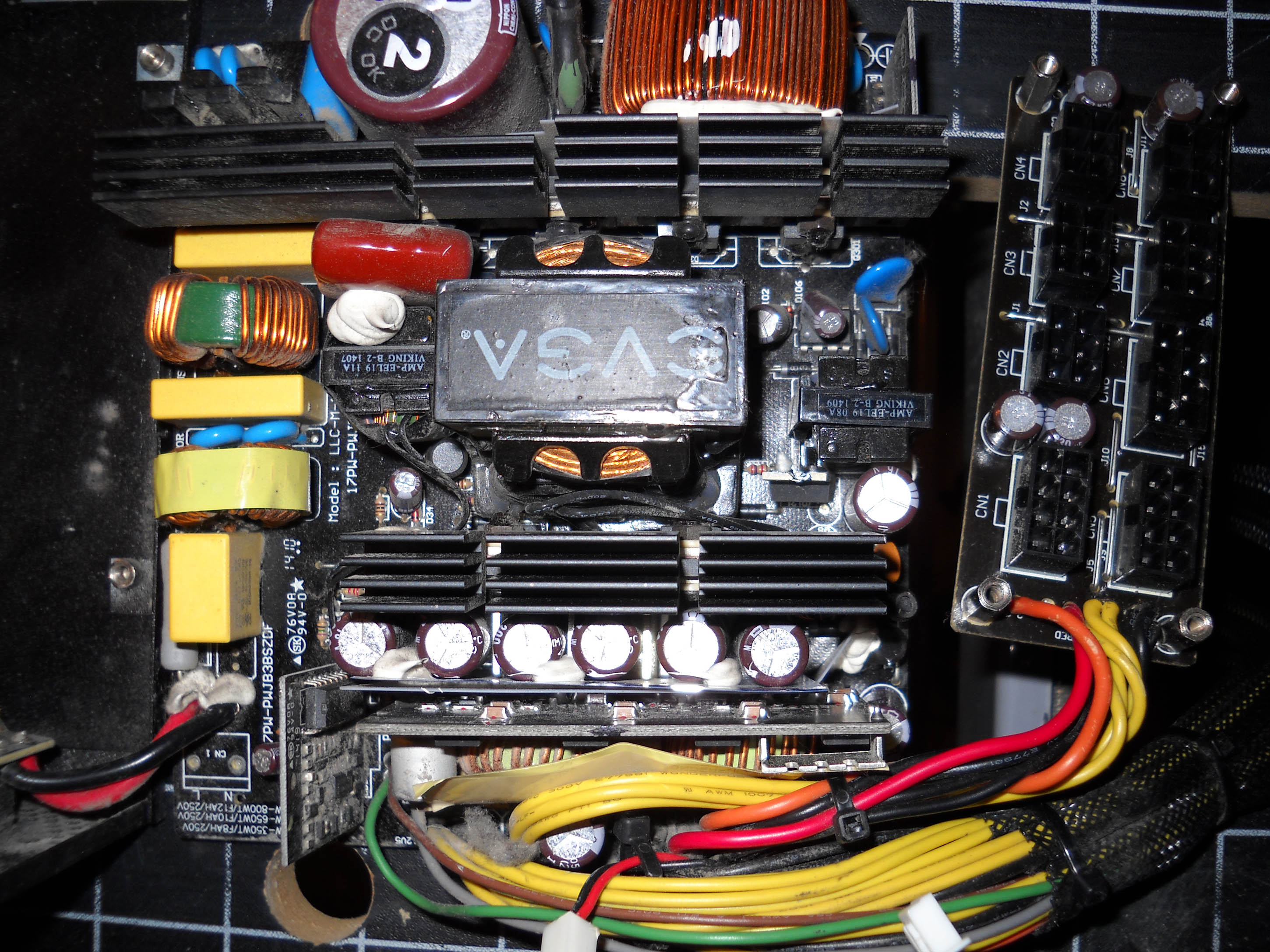

    Hey guys I'm looking for a quick tip from a pro to get this fixed as soon as possible. With the info I have it should be a fairly easy diagnose.
    I overloaded a 850 EVGA and it got real hot and made a loud pop. I'm wondering what component I blew. It shut down and now it only has 4v on standby and not enough to start it up. So running ok - to getting hot when I added 2 400w video cards, then pop about 45 mins later and now no power on and only 4v on stby.
    Good news is I have a second one for parts. Just looking for a head start to get up as soon as possible. Fuse is obviously ok as there is some power.

              Standby and PS-ON are two very different things on an ATX PSU.
              Standby provides 5V to the board at all times. It is pin #9 on a 24=pin ATX connector.
              PS-ON is what the board pulls low to signal the PSU to turn on the main power supply (3.3V,5V,12V,-12V). It is pin #16 on a 24-pin ATX connector.
              Forget about the PS-ON pin for now and focus on 5VSB. What voltage do you measure on the 5VSB pin relative to ground?
              As for the popping... that might have been a rectifier/FET on the secondary side.
              When you pull PS-ON to ground (i.e. try to jump-start the PSU), does the fan twitch?

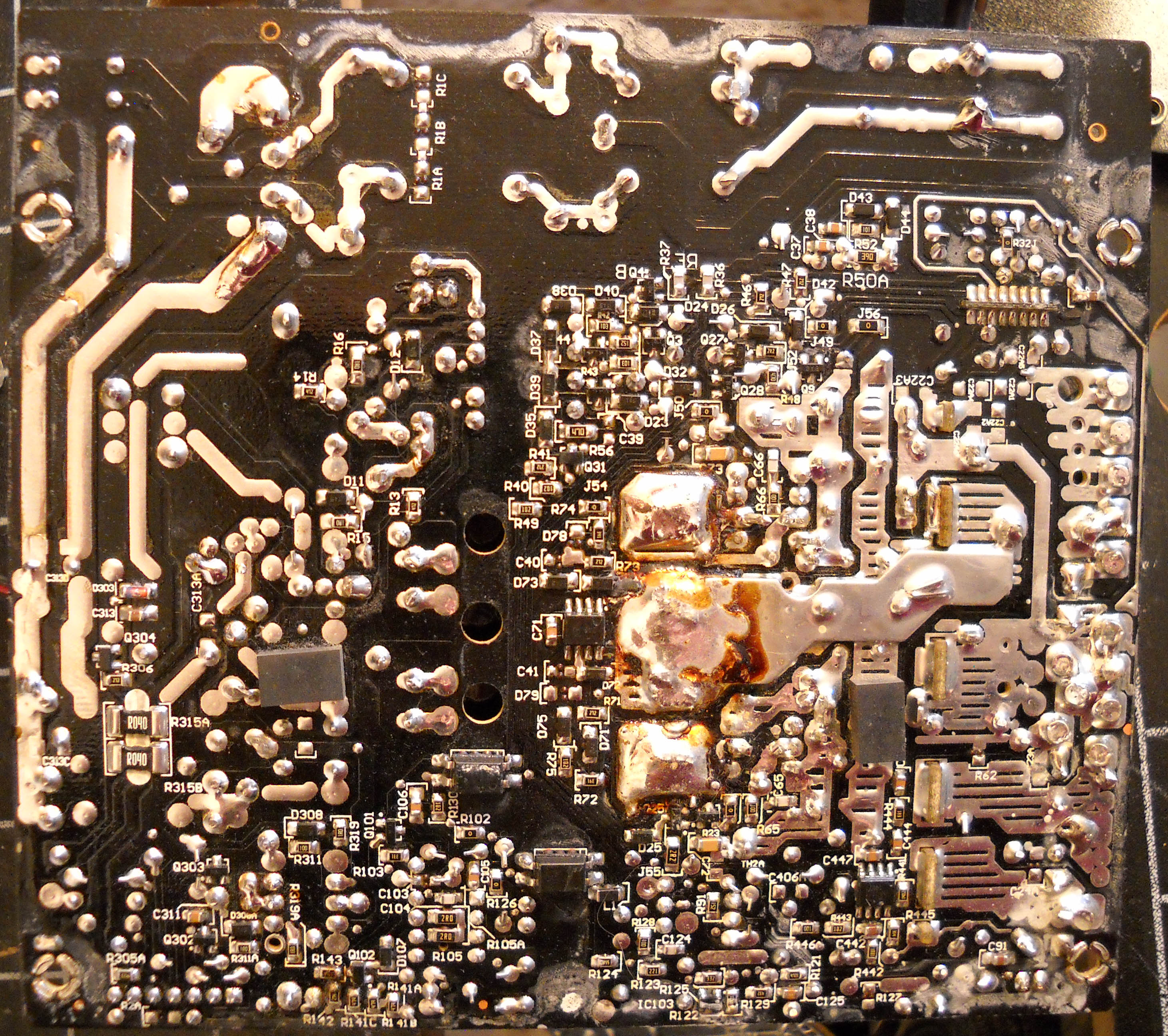

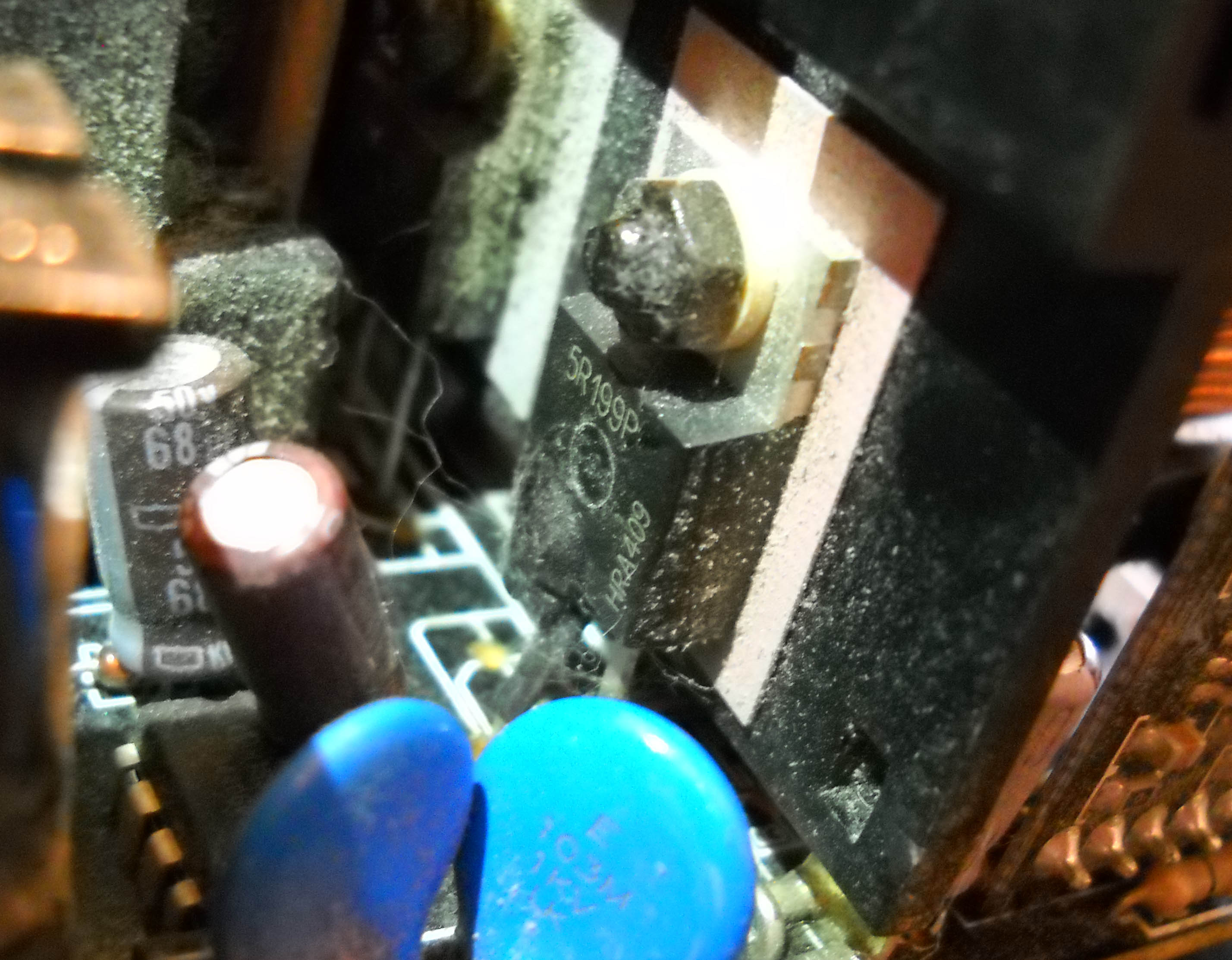

                    Some progress. I stuck a flashlight and cam in there and it looks like Q301 was the pop. Its a 5R 199P / HRA 409

                      There you have it! -A blown MOSFET. Just need to tell us if it's on the primary side or the secondary, so we can go from there.

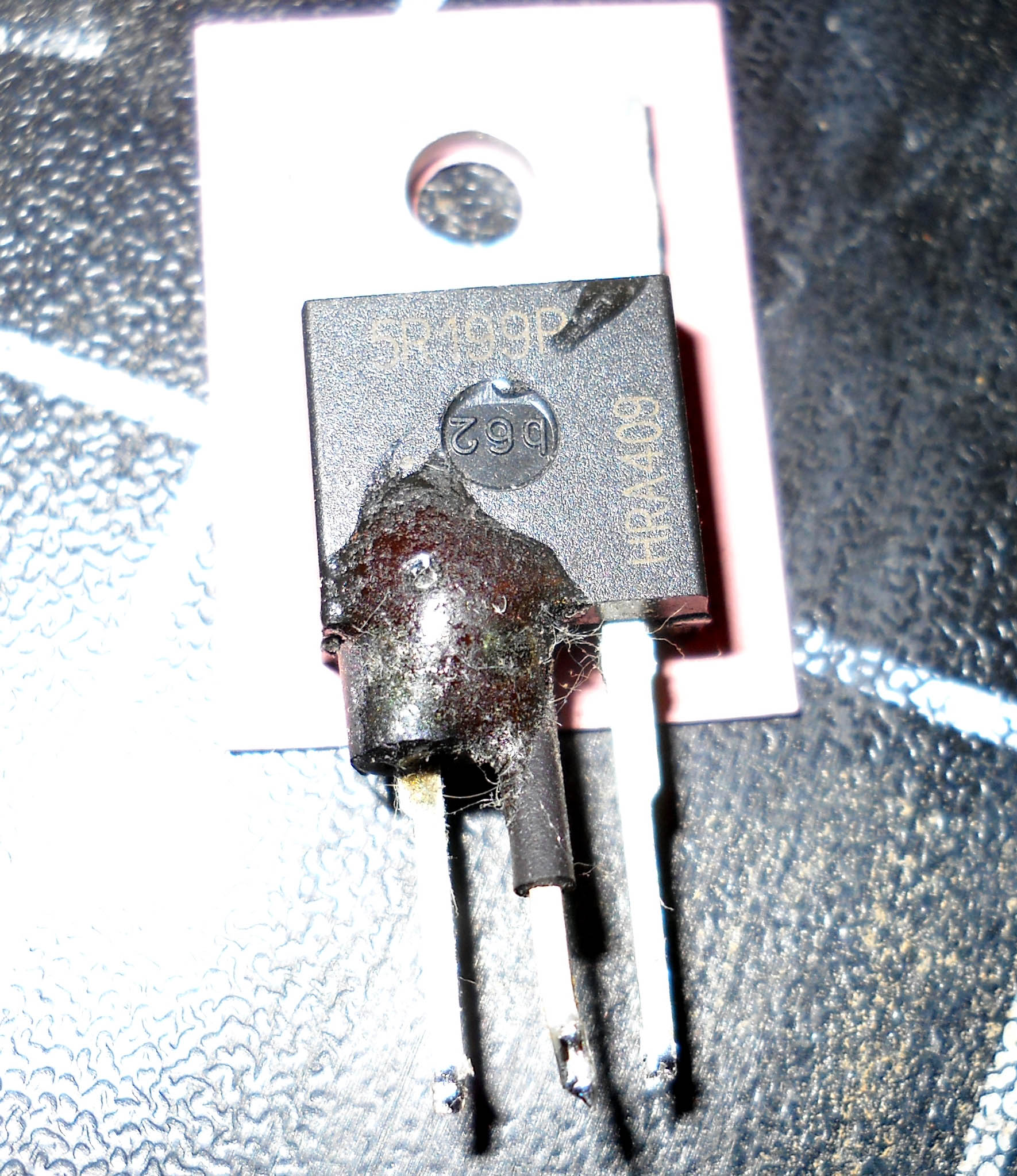

                          What do you guys think of this ? Its got 0 ohms on every pin in every direction. I think that means its blown right. I just want to make sure its bad and not sure if that is melting on it or a secret sauce compound the mfct puts on to hold on the pin sleeve in place. I'm just stumped because the other one looks the same so they are either both blown or both have compound and the problem is elsewhere.
                          It was a pain to get to and I had to remove the copper coil because they hide the screw behind it.

                            pic attached 5R199P

                              I believe this is the part, IPP50R199CP
                              If its all shorted, I would also check the gate drive circuit. and order more than one
                              That is just glue to hold the ferrite beads in place

                                That is sort of what I as asking, if its blown ? I'm not familiar with mosfets and how to test them but I figured they must have some resistance. All pins seem to be 0 no matter which direction or configuration I try it.
                                  Re: only 4V on standby - EVGA 850 B2 SuperNova
                                  If you get 0 OHMS on any combination of the 3 pins then it is bad. Are you sure it is showing 0 OHM since the meter leads will have 0.5~1 Ohm by itself.
                                  • luvtrumpsh8
                                    • Jul 2017
                                    • 18
                                    it actually shows 1 on the meter but thats just the default of the 200ohm setting. It basically doesn't move no matter which combination of pins I touch and I tried both ways. the meter works because when I test a resistor its pretty close to perfect.
                                    • R_J
                                      • Jun 2012
                                      • 9582
                                      If you short the meter leads together that reading would show a short, if checking the fet and it does not show a short, it could be good and something else is bad.
                                      You should also use the diode test if your meter has it.
