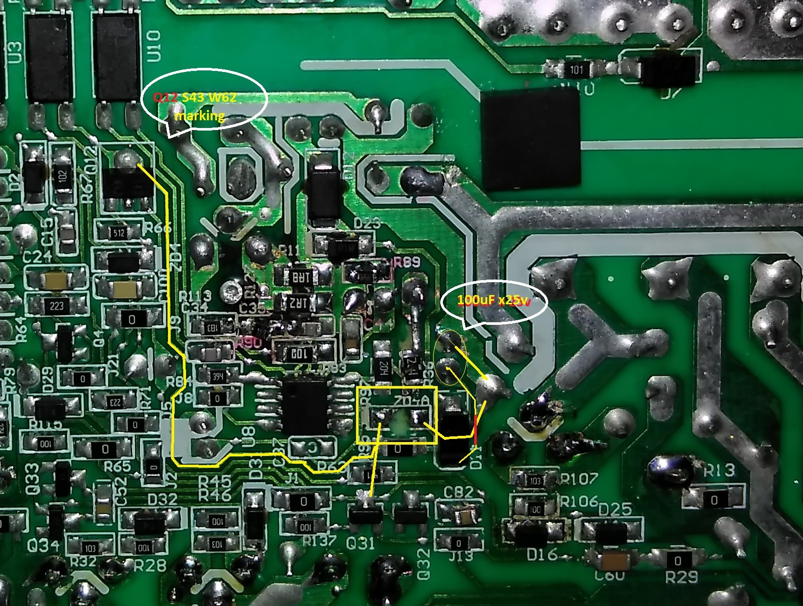

    Hi guys im trying to fix a Corsair CX650M,same like the Vengeance (I didnt saw any more change than the sticker) the zener diode is under PCB marked ZD4A anyone know the value?
    Thanks!

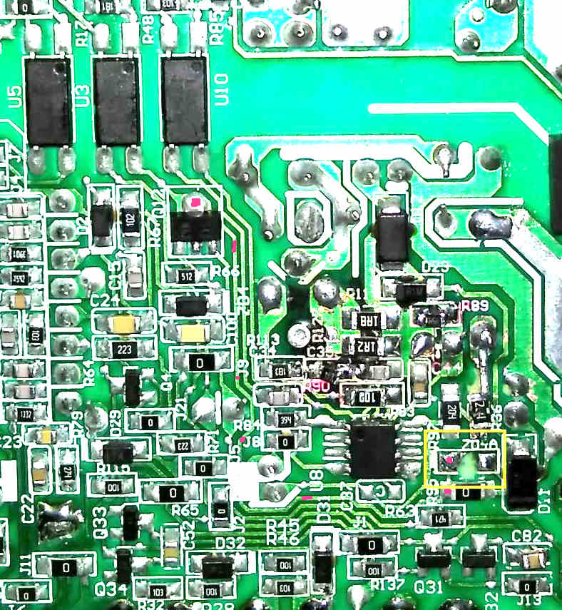

    None?
    Because it doesn't look like there was ever one there...
    Another possibility would be to look at the datasheet of the Chip it's used for...
    And the real problem seems to be above that...
    Broken (SMD) Resistors, broken Traces of the PCB...

      there was one once - the laq is missing indicating a glue-spot.

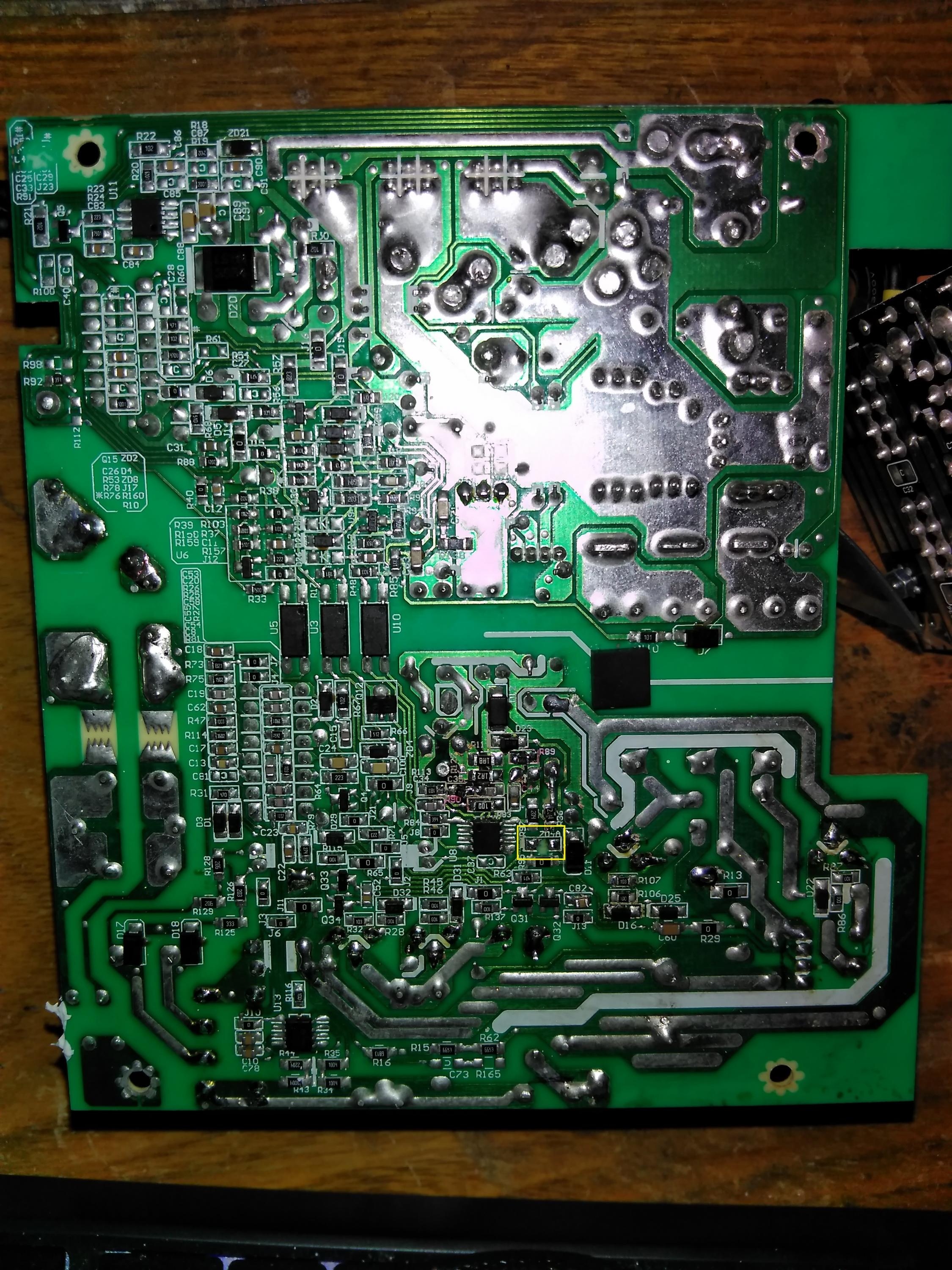

        Stefan, i just cleaned and changed 6 resistors, 1 mosfet CEF04N7G , 1 ceramic cap, 1 fast recovery diode (FR157) and reconstructed the PCB trace.I just need to know the voltage of that Zener diode. Messy solder job but all was replaced in this picture. Check this to see what was like when i opened it https://www.badcaps.net/forum/showpo...postcount=1318 Regards!

            Re: Corsair CX650M AKA Vengeance, help identifying zener diode value
            Can you post a better picture of that area where the missing Zener diode is? Also, can you post the part number of U8?
            From what I can trace so far, ZD4A appears to be connected to the Cathode of D11, which has its Anode connected to the Cathode of D12. So to me, this looks like ZD4A may be part of a circuit that regulates power to Vcc/Vdd of U8. If this is the case, then we just need to know what is the maximum voltage that U8 takes for Vcc/Vdd, and chose a Zener diode accordingly, so that the regulated voltage does not exceed that.
            FWIW, I had to do that once on a TV power supply that blasted its Zener diode to pieces. So if we know what U8 is and with some better pictures, we should be able to figure this out.
              Long PCB trace run ZD4A appears to connect to Q12 (SOT-223; collector?-) then HV opto U3. Not sure what this subcircuit is about.
              I don't see a path to U8. In CX650M teardown, U8 is OB5269 +5VSB PWM controller which typically does not use any zeners. It has a built-in 32V zener on VDD pin 6, and HV pin 8 is ok to 500VDC) R36 has HV across it, should be no flux and good soldering)
                Your right, redwire. I traced the circuit again based on the improved contrast version you posted (don't know why I didn't think of doing that), and ZD4A indeed does not appear to be associated with U8.
                That said, some of what I said about the way it is connected still stands. Mainly, it appears that D12 is the first rectifier of the 5VSB's primary-side auxiliary winding. It likely provides power to all ICs on the primary side, including U8. After the rectification from D12, looks like the primary-side auxiliary winding rail takes two paths: one through D23 (which does appear to be associated with U8), and another through D11, after which it goes through that zero-Ohm resistor and then gets regulated by ZD4A. So that second path there probably provides power to the primary-side PWM/PFC controller, and ZD4A likely is used to limit the voltage going to that controller.
                So what to use in place of Zener diode ZD4A? I say check what the PWM and PFC controllers are and post the part numbers here.
