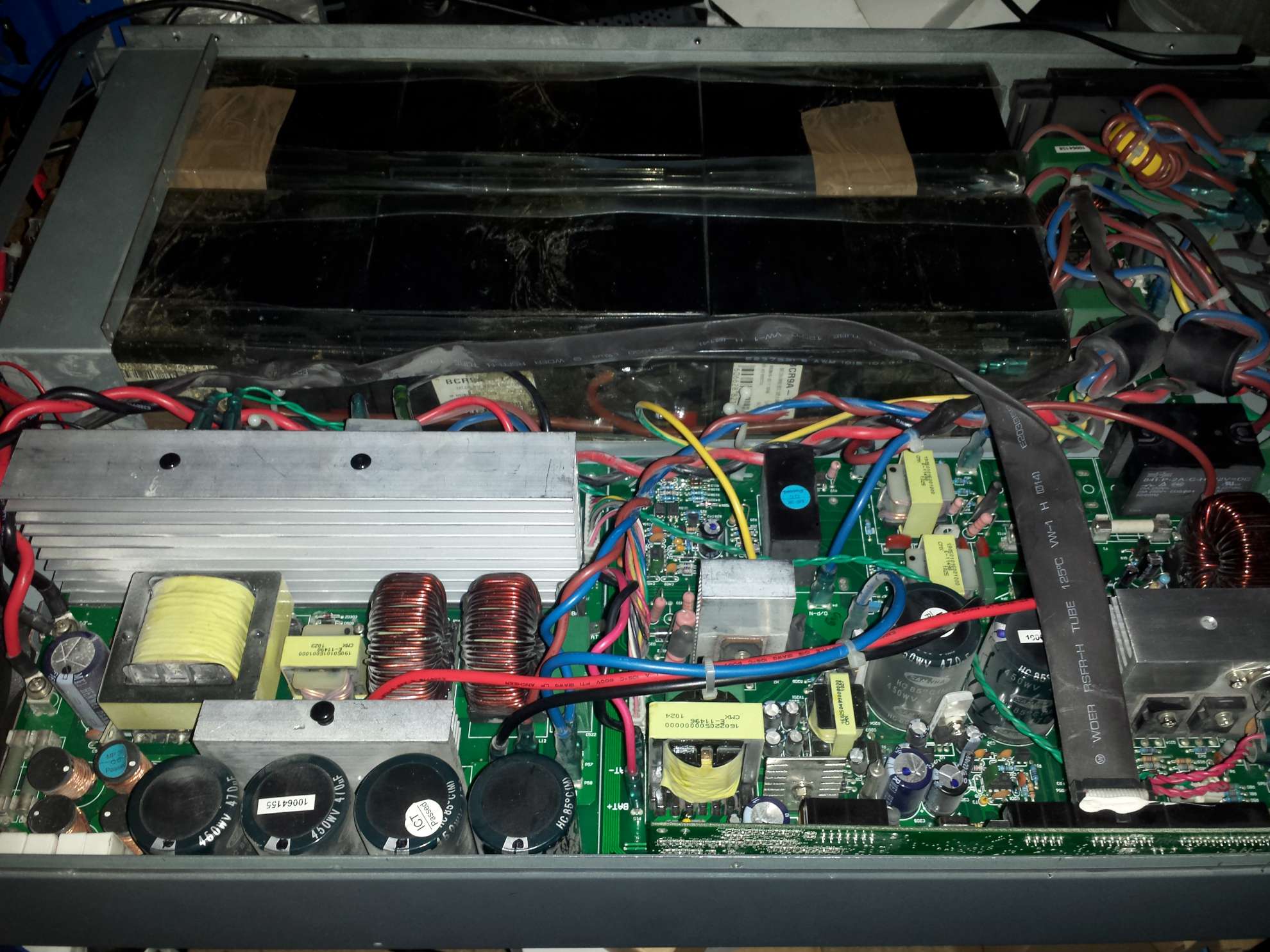

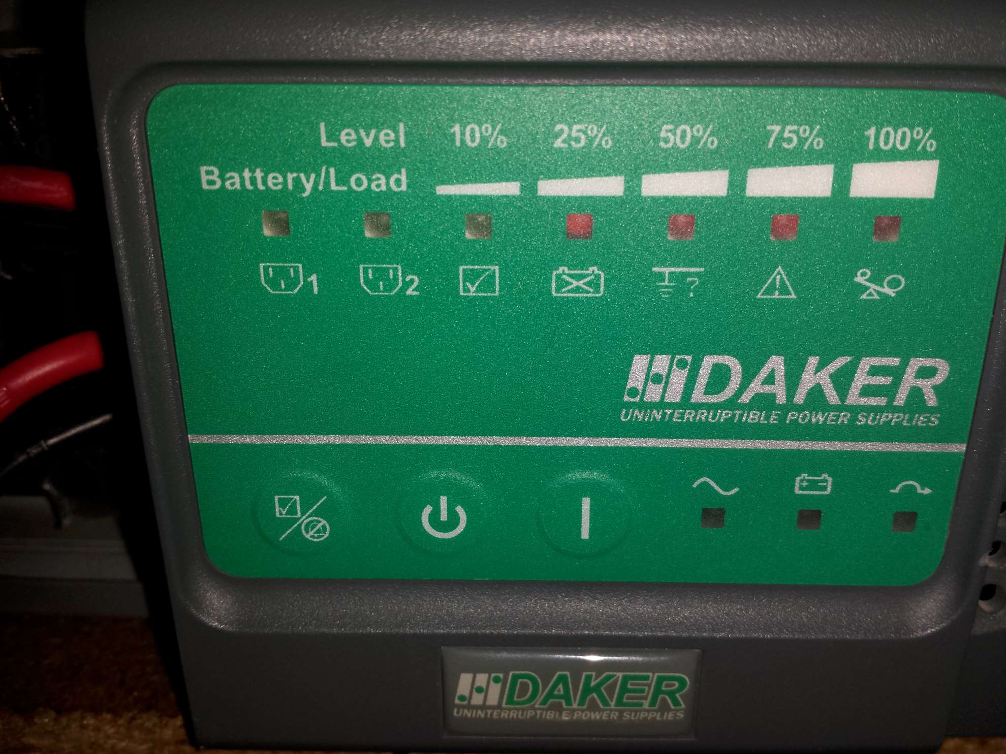

    Hi.
    I'm turning my head around a Daker (Legrand) DK 3000 UPS.
    This is an online double conversion UPS that seems quite good.
    When powered on the "!" led lits and there is no power on the output sockets.
    With the software, the error I get is "no output" (can't remember the exact words, but that is what the error means).
    While testing I noticed that the BUS voltages (positive and negative) go up for a moment to about 450V each (close to 1kV between BUS- and BUS+ that sometimes the Multi-meter overloads) and then start falling down slowly (CAPS discharging).
    I couldn't found any short circuits and the Big Relay never seems to close (I tested it offline and it make a big noise that would be very audible), nor the one small relay in the main board. From what I can tell only the output relays seems to switch, and those I was able to switch from the software.
    It also doesn't have power output with a cold start from batteries.
    Any ideas?
    Cheers.

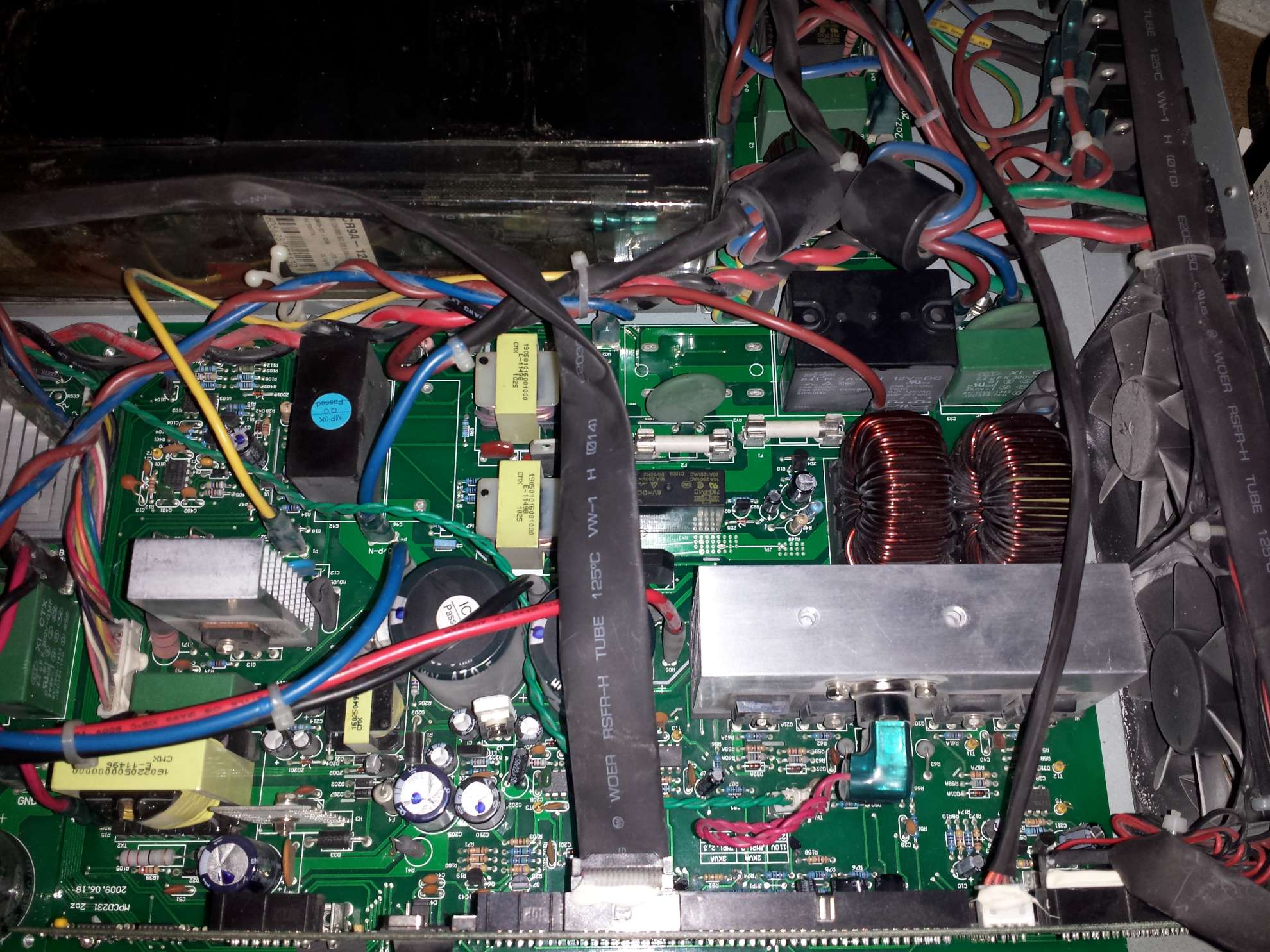

          Re: Trouble with Daker DK 3000 UPS
          Hi.
          About the Startup without batteries or with bad batteries, I'm pretty sure this one does: this is not a kick low price UPS, it is on-line. I agree you for off-line and line interactive UPS, if fact I know that most of those wont start without or with dead batteries.
          I'm sending pictures of it, any ideas?
          Cheers.

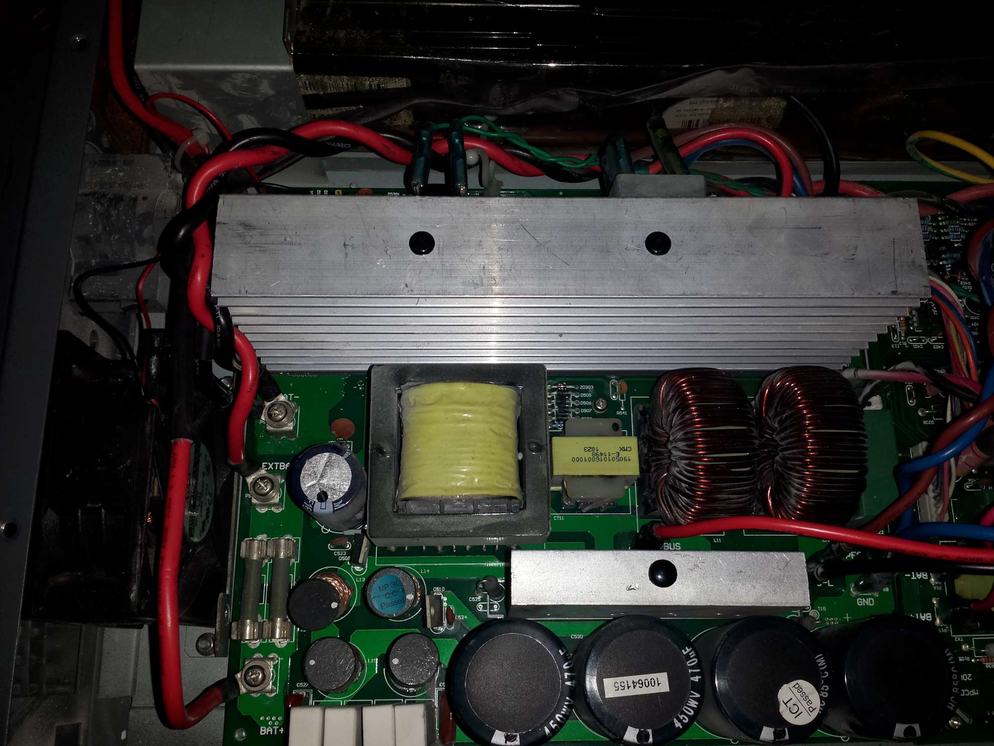

              start by load testing each battery.
              one looks bulged.
              a simple cheese grater tester is fine.
                It does not look anything like this one:
                Heatsink looks too small to be for 3000VA.
                https://www.badcaps.net/forum/attach...4&d=1486979341
                Did you check all the fuses the main supplies board.
                There are at least 4 fuses.
                What are the Voltage rating of the caps that you read +/-450VDC on? Booster circuit must be working at least to get Voltage that high. to get 230V RMS, the peak to peak out has to be around 650V P-P.

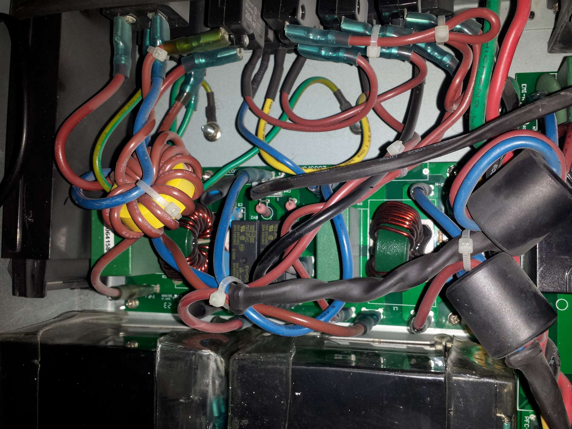

                    Hi.
                    In replay to kc8adu:
                    - I inspected each battery and none is bulged, anyway I will test each one in another smaller UPS with some load.
                    In replay to budm:
                    - The one it that PDF it is very similar, that seems to be a newer model/design, I bet that the insides are mostly the same.
                    - About the heat sink, I don't fully understand this UPS (obviously), but the heat sink in the picture you referred is not the biggest, the other one that has the FETs on the other side is bigger.
                    - I checked all the fuses I could find (At least 8, and none is blown);
                    - There is a bridge of wires (blue/red/black) between the two boards labelled (GND/BUS+/BUS-) where I measured at least +450 and -450 to the GND, the multimeter overloads when measuring BUS- to BUS+. The caps are ratted 450WV/470uF.
                    In reply to CapLeaker:
                    - Yep, that is what I think about it wanting to turn on and something not letting. About it working without batteries, I think that I've seen it working without batteries when it was here to replace them, but it was a few months ago and I'm not 100% sure.
                    I hope my input can help you helping me.
                    Cheers.
                      Did you check the DC voltage on the main filter capacitors to see if the PFC turns on or not?
                      • CidiRome
                        • Jan 2015
                        • 49
                        • Portugal
                        Hi.
                        If I can remember correctly the DC power goes from the left board (smaller) to the right one but I don't understand the exact functionality.
                        Where should I measure the main filter caps, where are those?
                        How do I check if the PFC turns on?
                        It seems that the SG3525 is not generating the signals to the FETS but I don't know if this is caused by itself or if it is not "instructed" to start. I replaced it with one from a scrap UPS that I had around but it may also be bad. I'm waiting for new ones to arrive.
                        Sorry for the beginner questions...
                        Cheers.
                                        Hi.
                                        I've compiled a pack of pictures of this ups with more quality, it can be downloaded from http://vieirasoft.net/DK3000_Pictures.zip
                                        Meanwhile I've tested each battery and they were all able to cold start an UPS with computer hooked on it and work for a few minutes.
                                        The YouTube Video is not related to this UPS and curiously I had seen it before...
                                        Couldn't find any coin type battery, how the a super cap looks like?
                                        I've been using this multi-meter for a few years, it is not a top of the line one, but has always done the job.
                                        I think this UPS should have an internal bypass, but if it has I've never seen it working nor I know how to activate it.
                                        Cheers.
