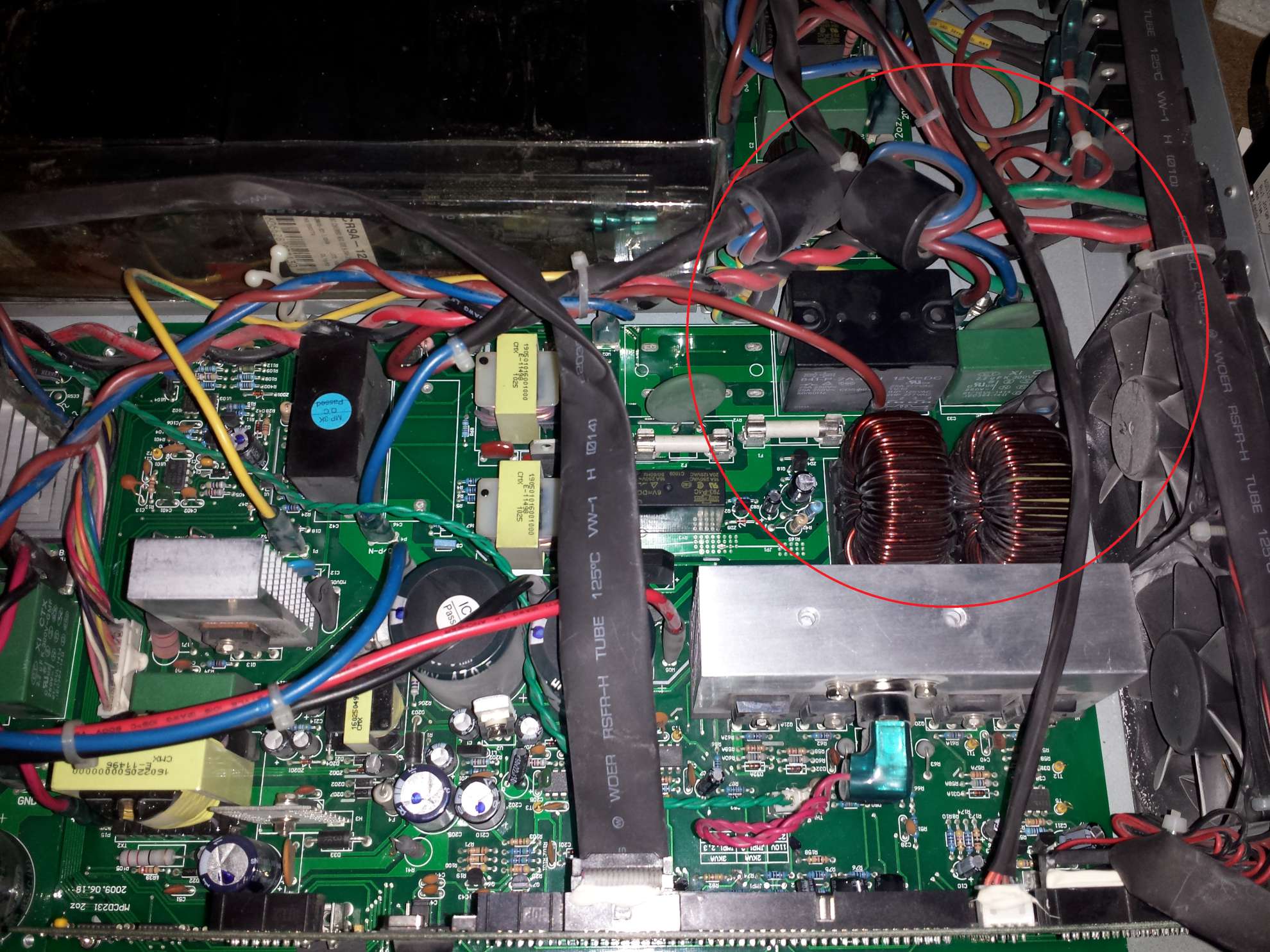

            Hi.
            About this UPS, I have news: I was able to repair it (some bad component that was not entirely short, but was hard to detect).
            But presently I have a second one of the same model that is not working correctly.
            Based on the error code 14, the problem is "FAN ERROR", but all the fans are working correctly and I don't even know how it knows that a FAN is bad.
            The fans are simple 2 PIN 12V fans with no rpm counter nor pwm controller.
            It seems to be a controller board problem because while I had both UPS to test, this controller board did exactly the same with the other UPS that was otherwise working correctly.
            Also: this one has a small vibration sound that come from somewhere close to the big relay. This sound is only present when the AC in connected.
            Any Ideas?

              Re: Trouble with Daker DK 3000 UPS
              What was that "some bad component"? State that you found it is useless for others when you don't say what it is.
              I guess it looks what power draw there is from fans to detect their status?
                  Hi.
                  Sorry.
                  The bad component was a diode RHRP8120 (I found it by comparing the two units, but a close up checkup paying more attention would eventually find that bad diode).
                  About the fans, I also thought about that, but...
                  Cheers.

                    #29
                    Yeah, I also blasted one in a different UPS once.
                    Maybe some small transistor went bad, there are often small SMD transistors around the fan headers, I guess to control the speed.

                      #30
                      Hi.
                      If the small transistor have to be close from the fan header pins, then both UPS would have the same problem.
                      I was getting the fan error with both UPS but only with one controller board (pictures 20170220_182313.jpg and 20170220_182341.jpg in the zip file, this pictures are of the board that works correctly), the only difference between the boards is the firmware version.
                      Presently one of the fans is of a lower AMP rate and this also happened with a different fan of the other UPS. Can it be that the different firmware (newer) is being less sensitive to the fan consumption?
                      For the sake of the possibility, I will hook another fan in parallel to get an AMP rate closer from the original fan.
                      Cheers.

                            #33
                            Hi.
                            About the failed diode, that situation was was in the previous UPS, I replaced it and is working correctly.
                            In the second UPS:
                            - I'm still making tests, but, in the present UPS the FAN AMP rating seems to be important. I hooked another fan in parallel and it is now working.
                            - I mentioned before that this UPS has a vibration sound, it comes from somewhere in the red circle of the picture I'm attaching. What would be the most probable culprit component?
                            Cheers.

                              #34
                              The PFC coils are making noises, that's quite normal.
                              I have had couple similar units in my hands, as stated, they are quite often a cheap Must Power (or something similar) crap. Dozens of different brands use the very same OEM, they are dying the same way after mostly the same time.
