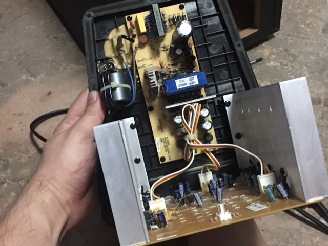

Altec MX6021
  • Behemot
    replied
    Re: Altec MX6021
    You tell me, just got this BIG sub from Cambridge-whatever-something under Creative, expensive like hell, also SMPS in there (no wonder with the power the thing puts out) and ofc all caps busted. And vitually TONS of that chloroprene stuff EVERYWHERE.
    This is just crazy! Power supplies went ahead and even the El Cheapos start using two-forward topologies at least. But in audio equipment, everybody continues to produce the same shit they used to. Often even worse.
    When you start testing it, I suggest the lightbulb in series. Often it takes one bad SMD components to make the PWM driver explode again. This hould limit the current and protect it, plus you see right away there's a problem.
    Leave a comment:
  • ant3202
    replied
    Re: Altec MX6021
    Originally posted by Behemot
    OMG! SMPS in speakers and chloroprene glue on top of that! What crap is this?
    1R0 is likely, it is fusible resistor which acts as fuse when something goes wrong on the primary.
    thanks for your help Behemot
    you are right.... really crappy.... SMPS inside is really.... (
    older models were using transformer...
    can I say to change all to 1R0 ???
    i had checked.... the ic chip is busted, guess drawing too much current, burning the smd resistors and pcb 1.6A FUSE.
    as a precaution ... i will also change the filter capacitor and misc to better and reliable one.
    as checked with some tech guys ..... seems this board fails quite often.
    now no more decent stuffs from altec lansing...
    plantronics ... and stuffs are really going down......
    Leave a comment:
  • Behemot
    replied
    Re: Altec MX6021
    OMG! SMPS in speakers and chloroprene glue on top of that! What crap is this?
    1R0 is likely, it is fusible resistor which acts as fuse when something goes wrong on the primary.
    Leave a comment:
  • ant3202
    replied
    Re: Altec MX6021
    there are 5 smd resistors in parallel they should be all the same rating. I would change all 5 of them out.
    yea, CapLeaker, thanks for the tips, definitely it need to be changed.
    need help to identify... as it is badly burnt...
    i think it could be 1R0 but i might be wrong.
    Leave a comment:
  • CapLeaker
    replied
    Re: Altec MX6021
    there are 5 smd resistors in parallel they should be all the same rating. I would change all 5 of them out.
    Leave a comment:
  • ant3202
    replied
    Re: Altec MX6021
    Hi Jazzie366
    thanks for the tips...
    You are right, the SMD has been burnt and i cannot read the values properly.
    Perhaps i need to ask people around and compare on it.
    Yea, i can lend a smd rework station from someone.
    Leave a comment:
  • jazzie366
    replied
    Re: Altec MX6021
    Originally posted by ant3202
    Hi All , greetings, someone pass a Altec Lansing MX6021 and I would like to learn how to repair it.
    The issue is there is no power to the speaker set.
    Note: Mods please move this post if you think it is in the wrong section.
    Upon inspection of the speaker power board, there were burnt components, of the resistors. the resistors were FUBAR.
    The power transistor seems to be shorted and I'm planning to replace those.
    The fuse is also open
    Normally for this caused? faulty filter capacitor? transistor? or shorts?
    As attached, it seems that some have gooey black stuffs on it.... i suppose glue become conductive?
    Many Thanks
    Well, the first obvious thing I can see is an exploded SMD resistor.
    Nothing else looks too bad other than shit got really hot due to the glue being browned.
    You're going to need an SMD rework station and a schematic to repair this, you up for that? The rework station isn't expensive, 60$ will get you one that can do the job.
    Leave a comment:
  • ant3202
    started a topic Altec MX6021
    Altec MX6021
    Hi All , greetings, someone pass a Altec Lansing MX6021 and I would like to learn how to repair it.
    The issue is there is no power to the speaker set.
    Note: Mods please move this post if you think it is in the wrong section.
    Upon inspection of the speaker power board, there were burnt components, of the resistors. the resistors were FUBAR.
    The power transistor seems to be shorted and I'm planning to replace those.
    The fuse is also open
    Normally for this caused? faulty filter capacitor? transistor? or shorts?
    As attached, it seems that some have gooey black stuffs on it.... i suppose glue become conductive?
    Many Thanks
  • TinkerTron
    Schematic vs. Reality: Where Are the Resistors on My Sharp Clock Radio? Model FY-70CH
    by TinkerTron
    Hey everyone,
    I'm currently working on a mid-70s Sharp Electronic Digital Clock Radio, Model FY-70CH. I found the service manual online, printed it out, and have been studying it for a while. My main reasons for tackling this are: (1) I want to learn electronics and figured I'd start with something I had on hand, and (2) I want to fix its issues. Right now, the radio sounds awful, has about 5V DC at the speaker terminals, and the alarm time setting doesn't work. But I'm not asking how to fix these problems.
    Instead, here's what's been bugging me so far:
    The schematic...
    03-06-2025, 02:03 PM
  • brightest_z
    Hot Air Blew Away Resistors Near Bios
    by brightest_z
    Hi All - I'm in the midst or reprogramming the bios on my gen1 Surface Laptop Studio and I accidentally blew away 2 resistors nearby the bios. I don't have another board to measure values of the missing resistors and schematics aren't available, bbut the bios is a 6x5mm Winbond WSON8, W25R256JWPQ model. The traces are conductive to Pins 3 and 7 (IO2 & IO3 respectively) so I have reason to believe they are 10k pull up resistors since IO2&3 pins are used for Quad SPI instructions.
    Does anyone with more knowledge, and experience than I, know if this is the case?
    12-11-2024, 08:34 PM
    Multifix 425-01 and 450-01 Rework Flux Datasheet
    REWORK FLUXES Multifix 425-01 and 450-01 are tacky fluxes designed for use in a wide range of electronics assembly and rework processes. They represent a range of activities and residue levels to meet different customer requirements.
    - No Clean Formulations
    - Low residue
    - Range of activity to deal with different component solderability
    - Halide free
    - Suitable for dispensing
    - Compatible with solder coatings and/or No Clean flux cored solder wire product range
    Both products are supplied in syringes or cartridges for application by dispensing....
    10-07-2024, 06:02 AM
  • jinu_j
    LED driver circuit. Burnt Resistors
    by jinu_j
    Hi Folks
    This has to do with a LED light driver rated for Output - DC36-65V 300mA. This is used to drive a 15W LED panel light.
    Now this does not work so opened up and found 2 resistors burnt to crisp. Sensing a learning moment, i looked around the circuit to figure out that it is built around the OB2538 chip. The circuit to a large extent follows the sample application circuit mentioned in the data sheet. I have traced the actual circuit and the same is also attached for reference.
    But i have some queries on this circuit
    1. The resistors that burnt to crisp...
    08-26-2020, 01:24 AM
  • vikivng
    guys..i need help with this lcd display used on ebikes pls.
    by vikivng
    This is an lcd display used on ebikes.
    long story short, there was condensation inside the unit.
    I opened it and thoroughly cleaned the pcb with isopryl.
    The board had no visible corosion.
    It powered on fine and was tested for an hour or so.
    However when connected to the bike,,it did not power on at all.
    I took it home and reopened it to take a look. There are no shorts based on MY testing.
    However,,when I probe the transistor and the mosfet gate in diode mode or contuinity mode, (one probe on transistor collector and one probe on mosfet gate}the unit...
    09-16-2025, 12:56 PM
