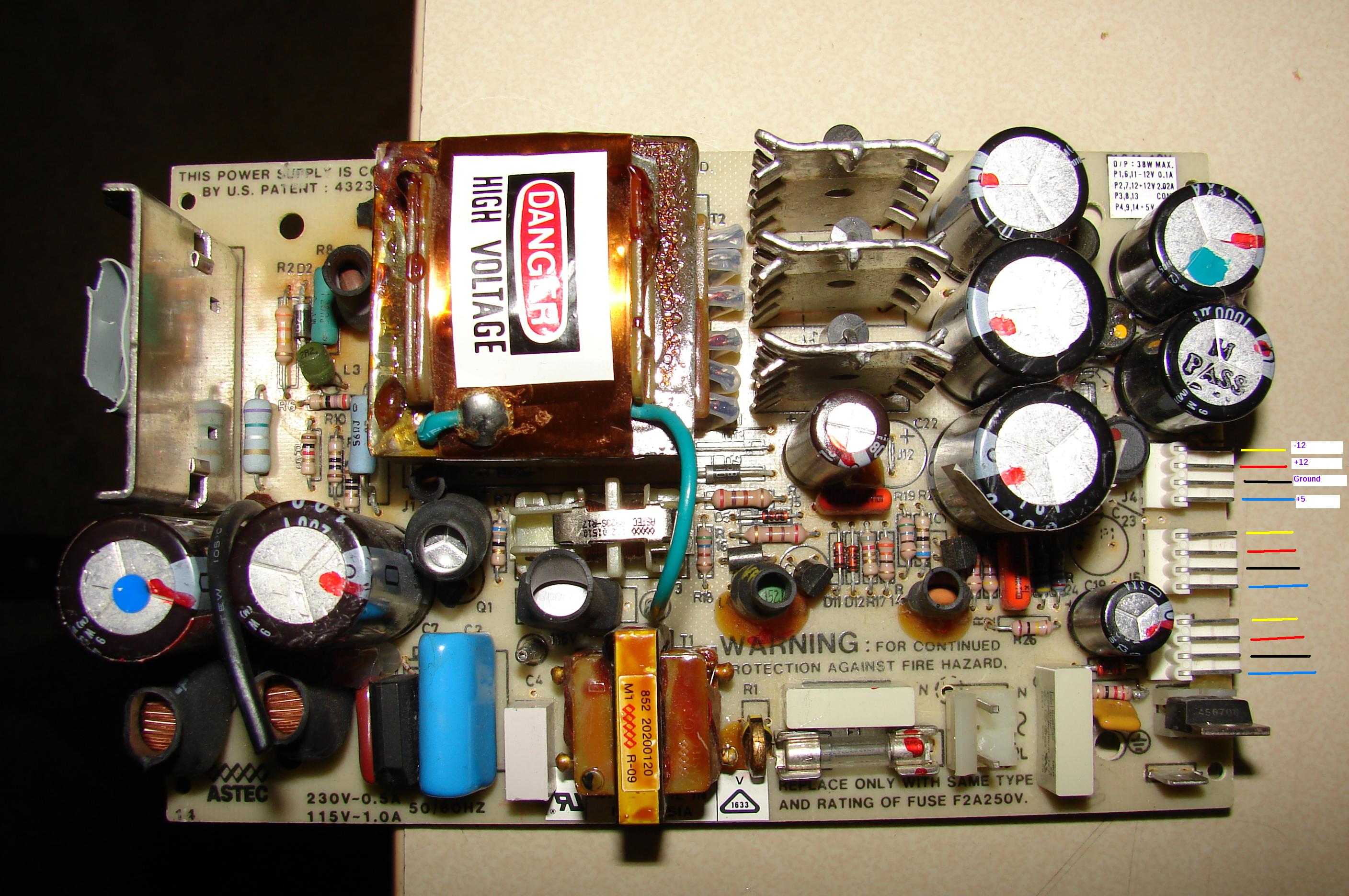

    I am trying to get a old Osborne 1970's computer working. I turn it on but there is no life at all and no noises or smells. The PSU looks in great condition and all caps and filters look like new with no visible damage. I have aslo desoldered some of the caps and tested them on a ESR meter and they seem ok too. If I turn it on and the PSU slowly warms up but still no life from the computer or its built in display. I am struggling to find anything wrong with it but I have noticed it is only producing -12 & -5v at 2 of the 4 power output connectors to the logic board. I thought there should be both + & - 12 and 5v. I am assuming its a negative earth. Can someone help me with this? I have got a manual for it and a schematic if needed.
    • 31304
    Re: Power supply with only negative voltages
    check the diodes and upload some foto's

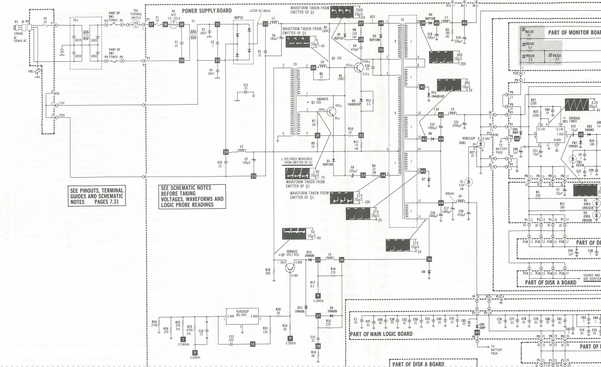

            Sorry didn't realise you had to sign up to dropbox to view a shared folder or document. manual is too big for this forum so took screenshot of main PSU part of Schematic and uploaded it.

                    I think your probes may have been reversed, or you used the wrong ground, They are using the +5 volts and the + 12 volts but the -12 volts at test pint 46 is not used (nc) no connection.
                    I would believe the the power supply is ok and the problem is elsewhere
                    Check page 5 (part of main logic board) that is where it gets its negative voltage, see if there is -5.1 volts and -8.2 volts if they are missing I might suspect C72 15uf is bad
                    also check the + 4.94V and the +8.7v

                      I think your right too the problem is something else but my probes were not reversed but maybe was using wrong ground. PSU was weak and wasn't producing enough current to power the chips on the logic board and if I checked the voltages on the logic board with a multimeter the voltages disappeared and only a power off and restart restored them. So something else is wrong. I've had the transistor I lost turn up today and just waiting for all the new caps to come now and I'll reassemble it and test it again. I have also tested the bridge rectifier and it checks out ok. Also removed a Diode block that appears to contain 4 diodes that I will test to. Other than that there isn't a lot more I can test as all the other diodes tested ok.

                              Astec was a good company, making good stuff. They also made the Apple II+ power supply. That's a discontinuous flyback design, very stressful on the output caps. If you are testing it outside of the computer it does need to be loaded to perform well.
                              Astec had the unpleasant habit of wire-brushing off the markings of their switch transistors. On one P/S I saw they did a poor job with the wire-brushing, and I made out the part number. It was a horizontal flyback transistor used in TV sets, nothing exotic. For 38W, the output power rating of that power supply, an MJE13005 would probably suffice, if it's a TO-220 package device.

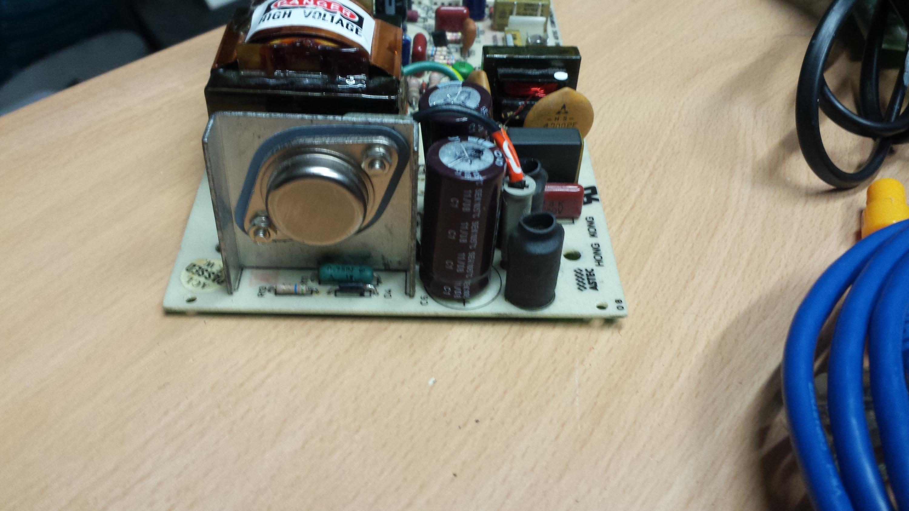

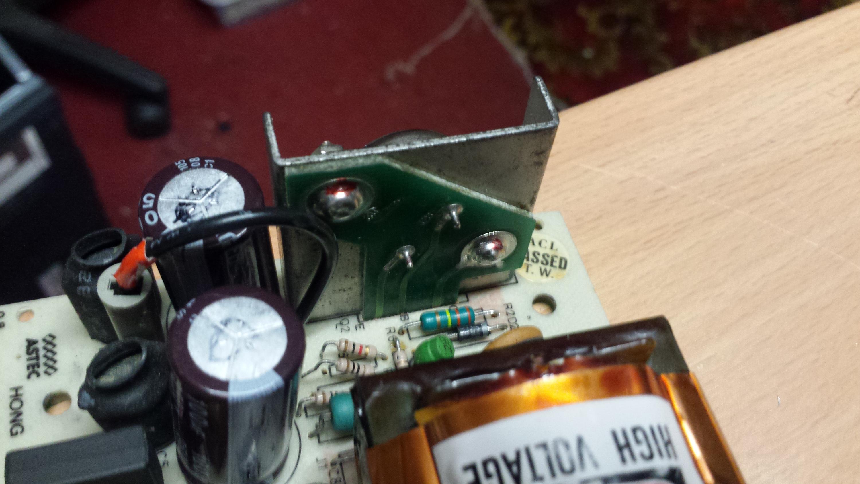

                                Yes you are right. look at the attached pics and you will see the markings on the transistor are ground off. There is no reference to what this isn anywhere in any of the manuals either. Do you know what this is?

                                  BU208a maybe.
                                      Well, I didn't expect that package type. Commonly referred to as a TO-3 package, it's actually a TO-204 package. And the part I referred to earlier was in that package. So that is probably a TV horizontal flyback output transistor. The part I figured out was made by Fujitsu, I think, and had a 2SC#### type part number. If you had to replace it a 2N6545 would work. At the die level, the 2N654x and MJE1300x series were of the same family, just in different packages.
