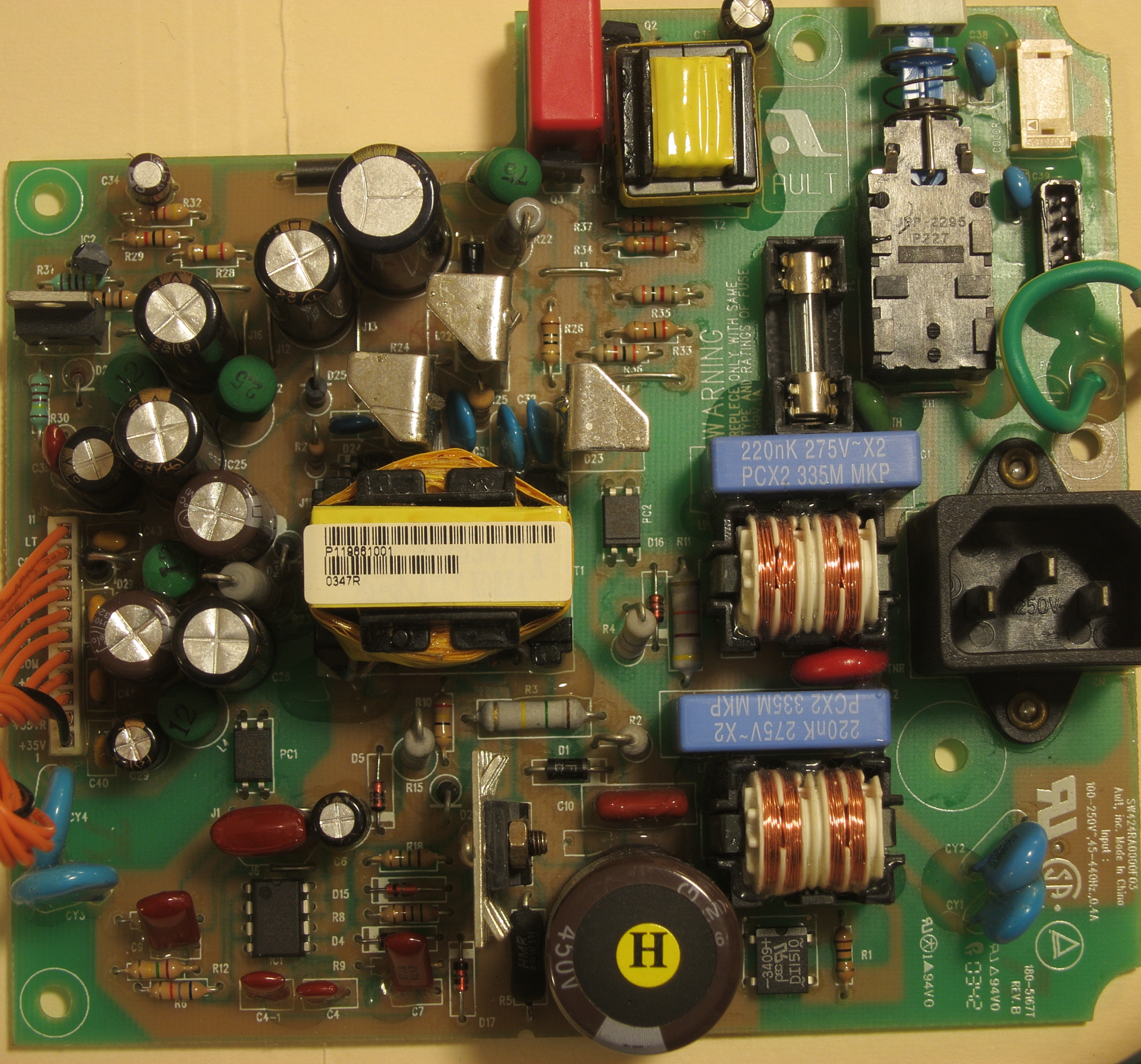

    What: Oscilloscope (Tektronix TDS1002) power supply made by Ault
    Symptom: Power supply randomly browns out and reboot. Temporarily fixed for a year or two by unplugging the CCFL from the power supply. (Turned it on again today and now it's browning out even so)
    Power supply: Ault branded switching power supply that emits (according to the silkscreen) -4V, 3.3V, 5V, and a floating 35V (for LCD contrast).
    All but one capacitor labeled "Lelon" ... which I see is in the "bad manufacturers" list. None obviously damaged, but I lack a capacitance meter that goes above 20uF.
    Between the symptoms and the capacitor manufacturer, is there any reason I shouldn't just recap this? Does it seem likely that this is enough to fix things? Is there a correct order? Any capacitors that I could get away with not replacing?
    Thanks, all!

      Stick the board back in there, heat all the caps up with an hair dryer so they are nice and warm and fire the ole O'scope up. See what happens.
      Change out C28, it looks a little off compared to the others. I bet that is for the 35V rail, the one you have trouble with.
      Change C6, start up cap.
      I can't see what C29 does, but if it is connected to the opto PC1 (feedback to PWM), change it out too.

          Stick the board back in there, heat all the caps up with an hair dryer so they are nice and warm and fire the ole O'scope up. See what happens. Change out C28, it looks a little off compared to the others.
          The power supply board looks like it is in primo condition from the photo. If we are dealing with a no-test-equipment situation and unlimited time, then fine, replace some capacitors. How difficult would it be to check the regulated voltages with your MM and look for filtering problems on the secondaries with a scope? Chances are you might find a single part on the supply that is causing trouble, or just as likely you may find that the supply is not your problem at all. In the end, you will find the problem quickly and you will actually know which part(s) have failed.

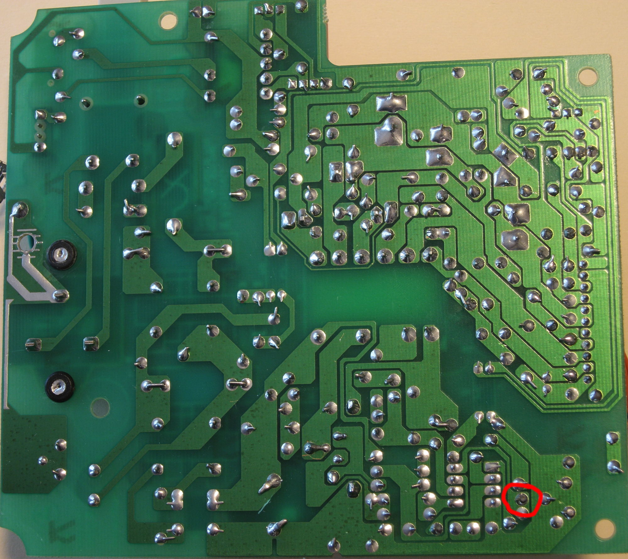

              Best I can do is provide a picture of the reverse of the single-sided board...
                The board looks fine on both sides in the photos.

                                While you are at it check this what I think is a bad solder joint.
                                  (Ok, that's the 2.2nF capacitor on the KA7552's "CS" pin). It looked pretty good to me, but lacking any reason not to, I tried reflowing the solder, tested, removed the solder and put down new solder, tested again. No obvious change.
                                      O.k. sometimes solder joints look bad on the picture.
                                      Anyhow I guess there is something to chew on, because the main filter capacitor goes low intermittent. That should not be. So easy game from here on. Make the PSU fail again, check the input of the bridge rectifier (AC) and see what happens there. 120VAC x 1.414 = 169.68V DC. If the AC disappears, follow it back to the switch and compare input to output of that. Then it turns out to be a broken switch or cord. lol.
