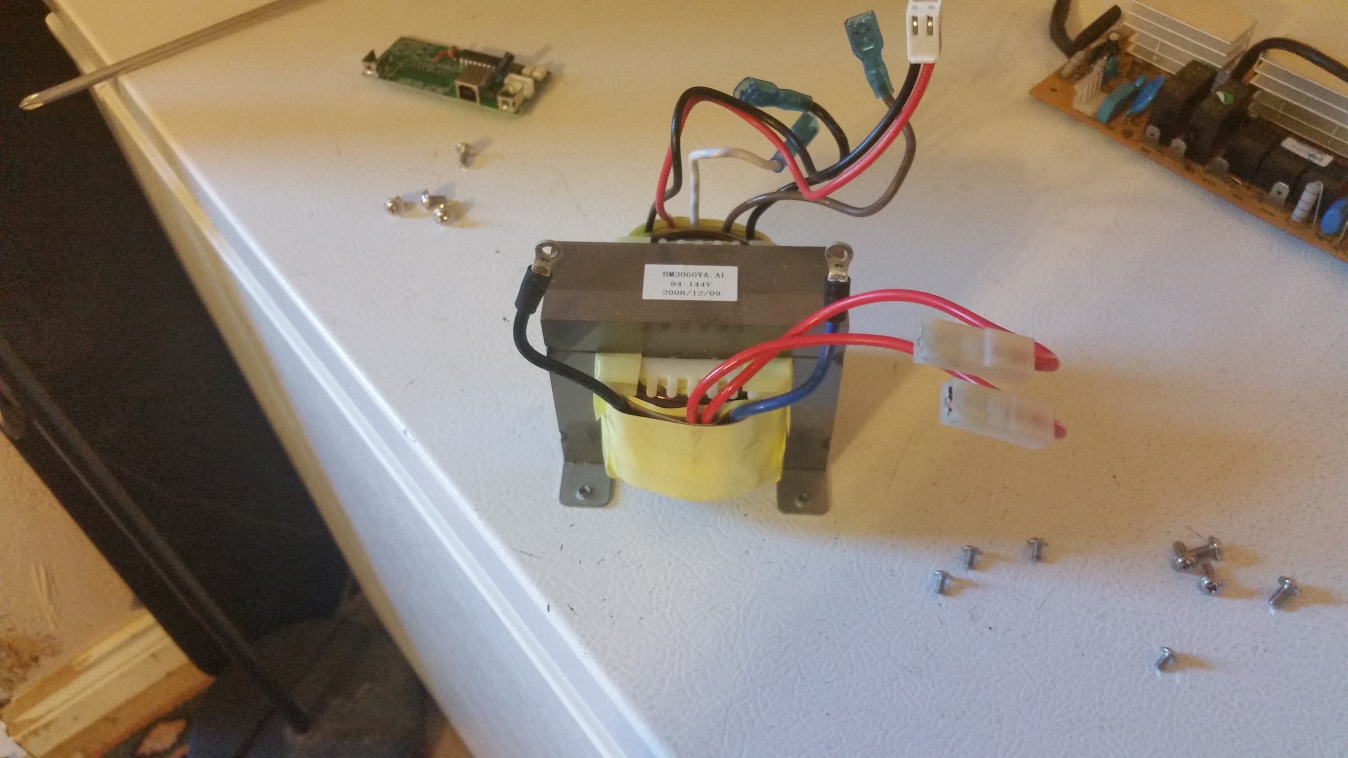

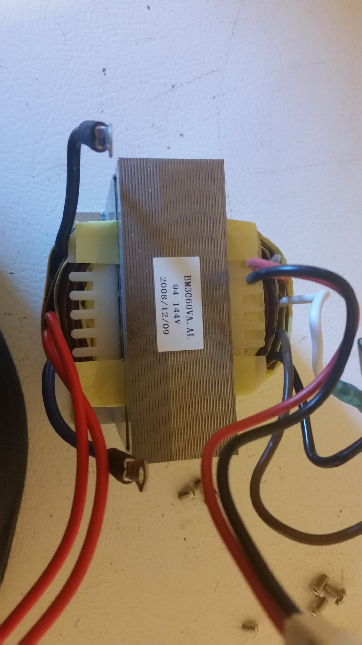

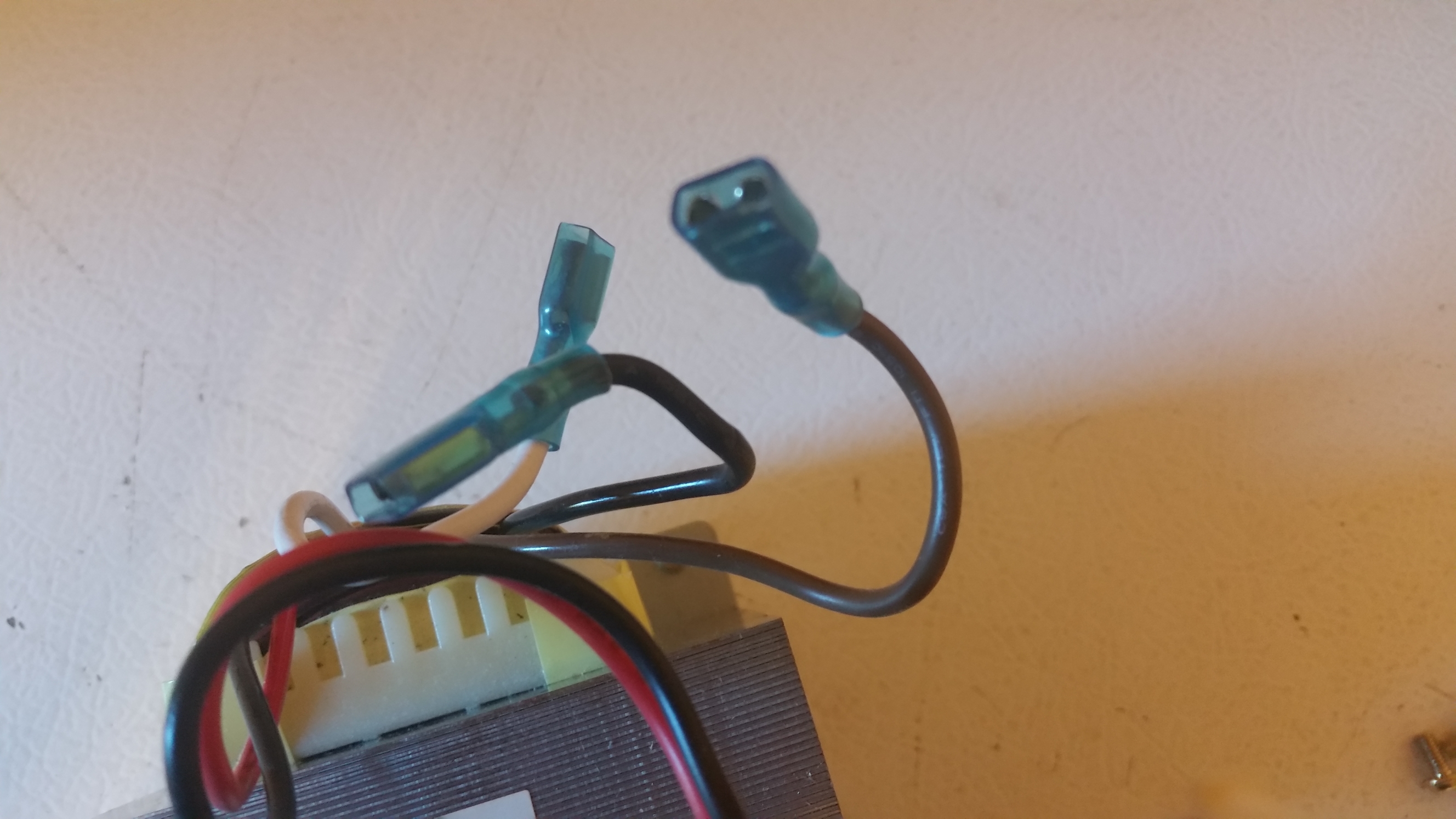

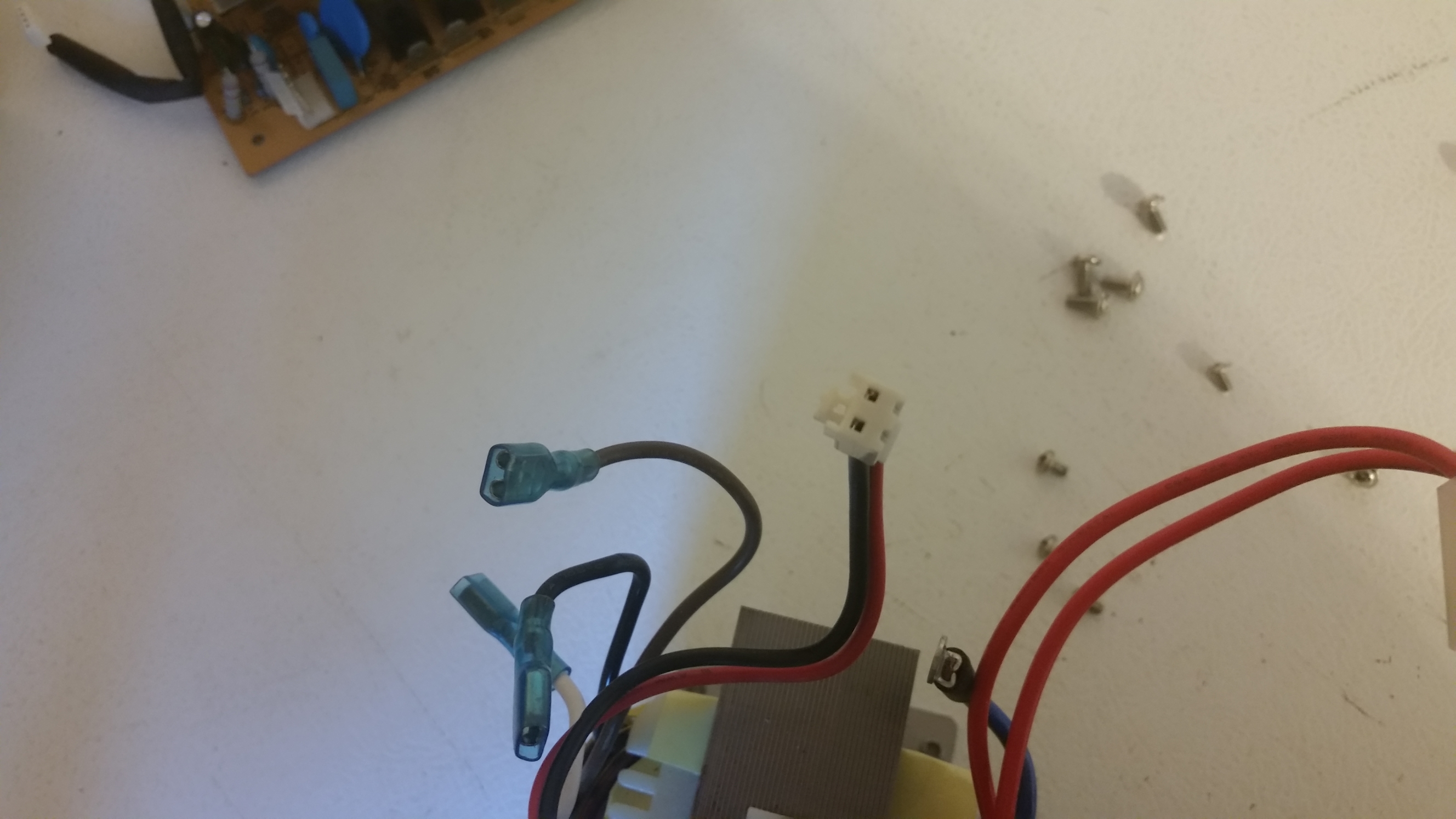

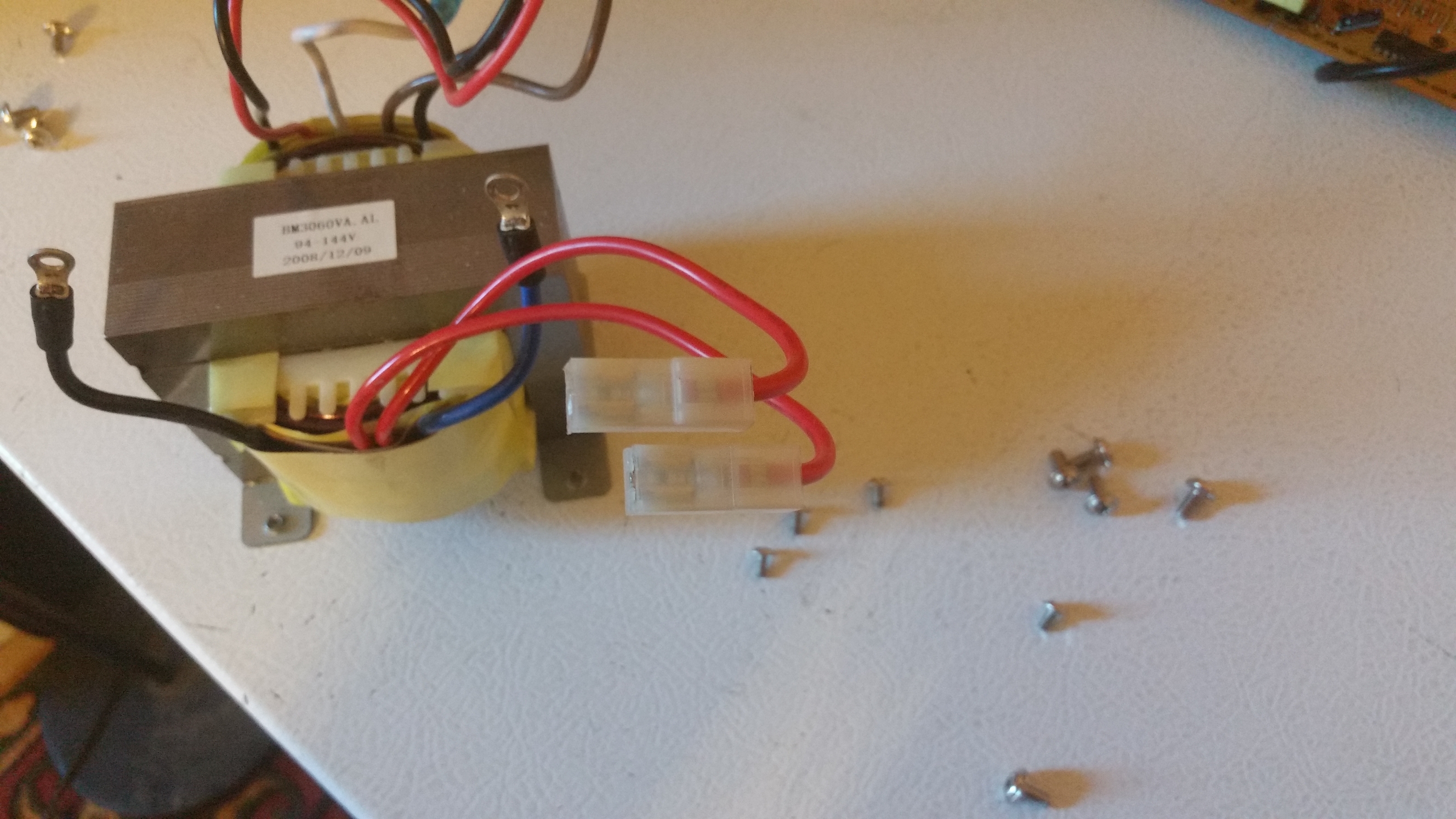

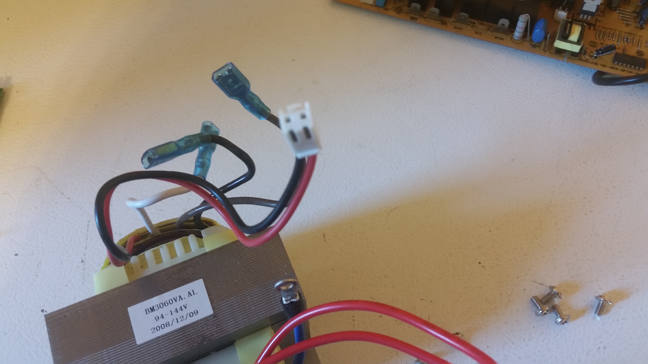

    Hi. I just pulled this transformer from this Xtreme Power Conversion(maybe APC knockoff?) UPS and I have no clue how this transformer is wired up. I have attached some photos below for reference. Googling the number on the top turns up nothing.

    You could use an ohm meter . Highest ohms is probly the primary.
    P.s. I do see 94 144 v

      That must be an inverter transformer...
      MAYBE

        Re: Transformer Help
        The side with two red wires and one black wire are connected to the POWER MOSFETs for driving the inverter transformer from batteries source when it is in UPS mode.
        The side with white (Neutral), the Black, and brown wires are for LINE, the UPS probably select which wire to use when UPS is in AC mode to maintain 120vAC output by tap switching. the white connector with RED/BLACK wire may be for power supply for running the board.
        If you can upload the pictures of the UPS with all the wires connected then we can verify.
          The BM3060VA name may indicate it's a 30v AC 60VA transformer
          There may be multiple taps from 94v to 144v so that if there's too low mains voltage or too high mains voltage, by changing taps it's possible to keep the voltage close to 30v AC.
          Or, the other way around.

            I'm actually stripping out the UPS, but I can do that. Will do shortly.
