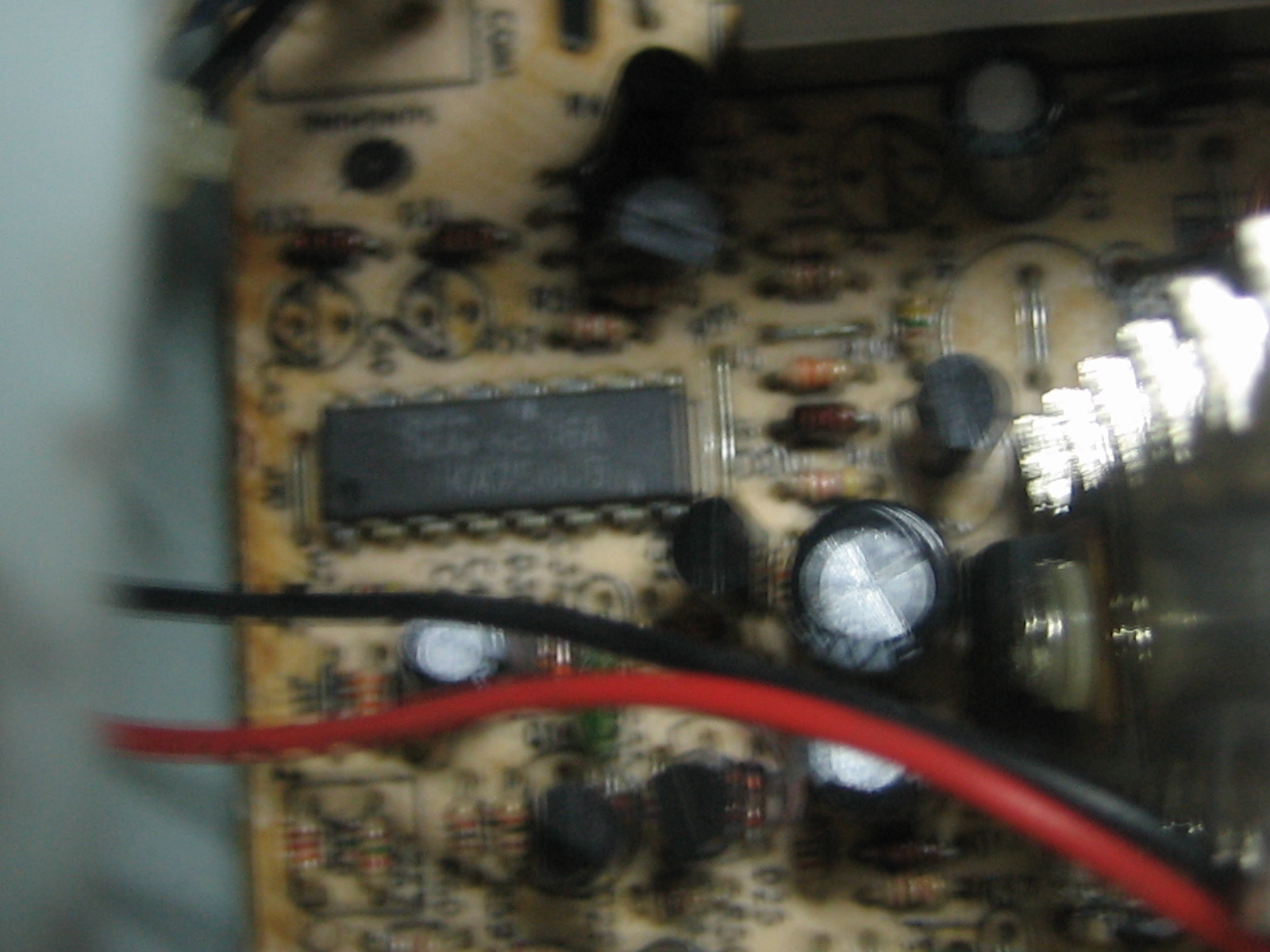

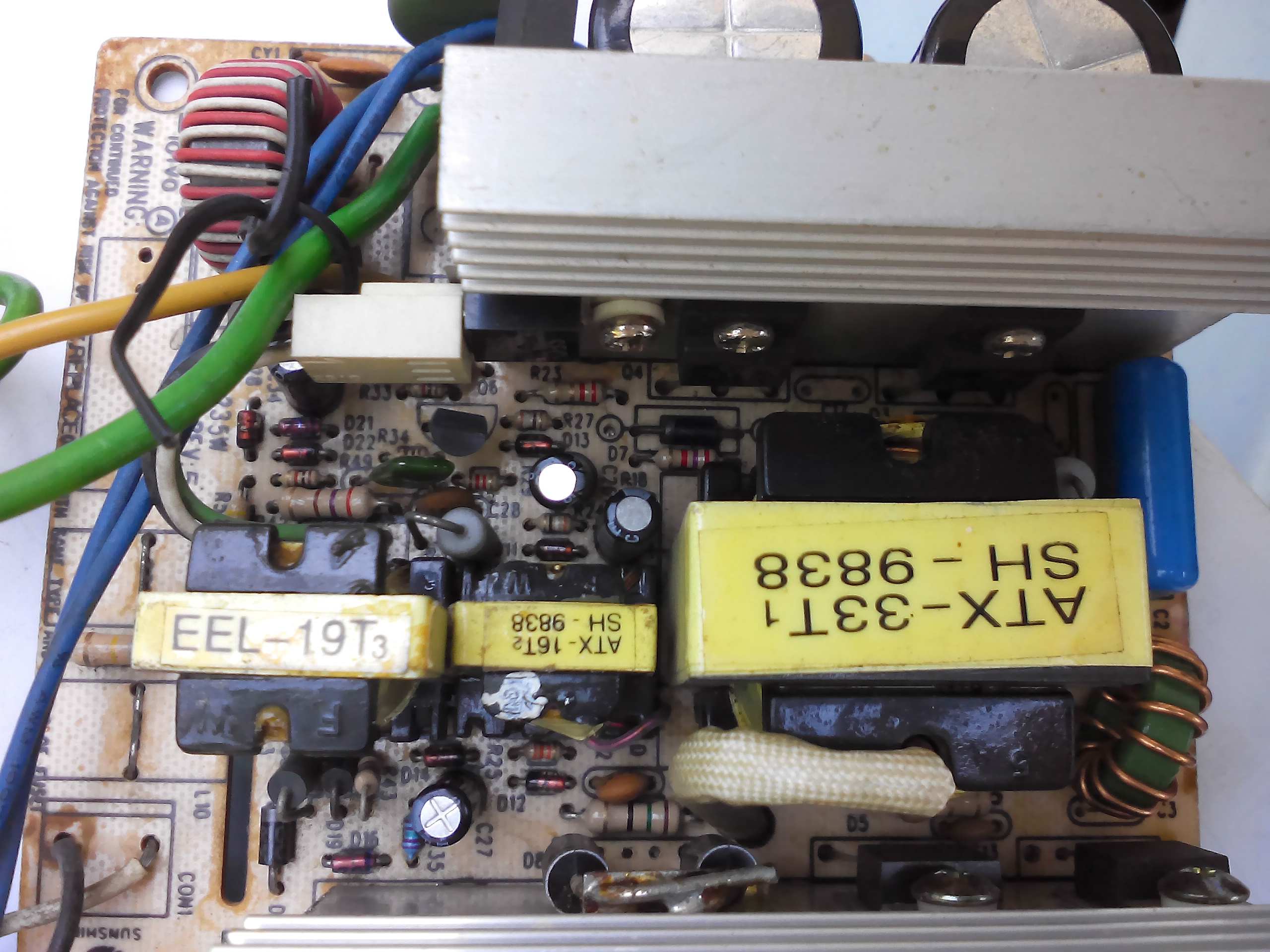

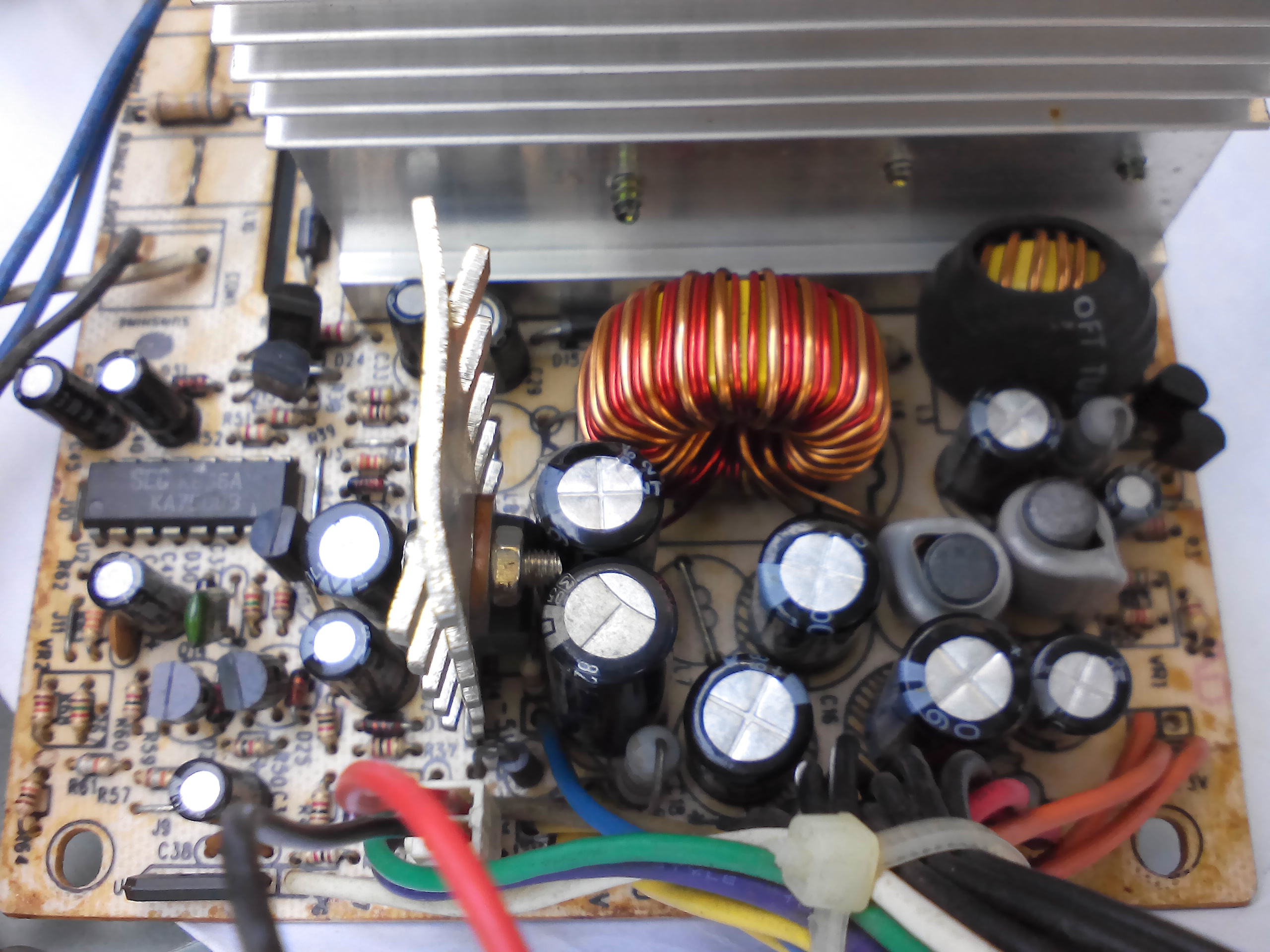

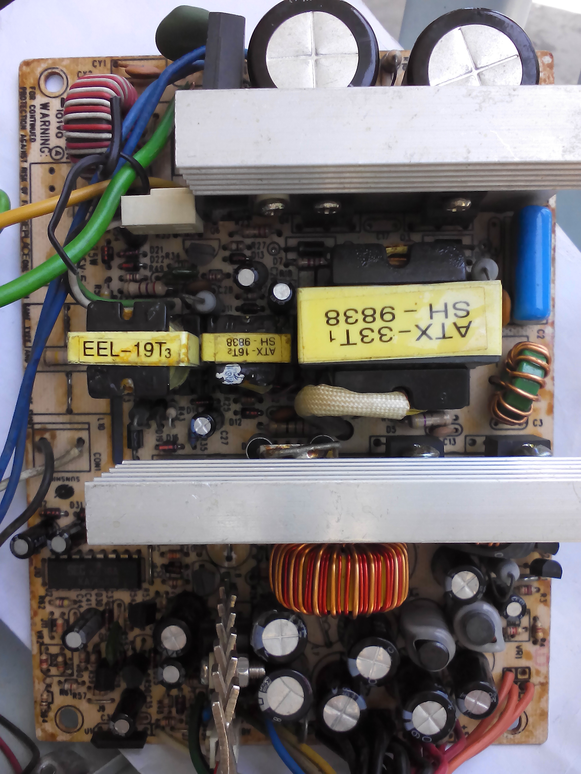

    Got this non working ATX power supply from a garage sale. The owner is not too sure if it is working. I noticed it is label as Sunshine Model ATX235 Series Rev 5. After opening the case,i saw THR 1 is empty;so I soldered in a SCK084 thermistor. Checking other area I don't see any burn marks and the 5A 250V fuse tested good in continuity.
    Before I switched on the ps,I soldered in a 60W light bulb in series in place of the fuse. By shorting the green wire to black ground wire, I switched on ps, the light bulb glows shortly then dims off. I checked the purple wire with a DMM, it reads 4.9VDC meaning there is standby power. But checking on yellow wire or red wire doesn't show any voltage on DMM.
    I also checked on the 16pin chip pwm IC KA7500B, put my red probe to pin 12 while black probe to pin 7 shows 5VDC.

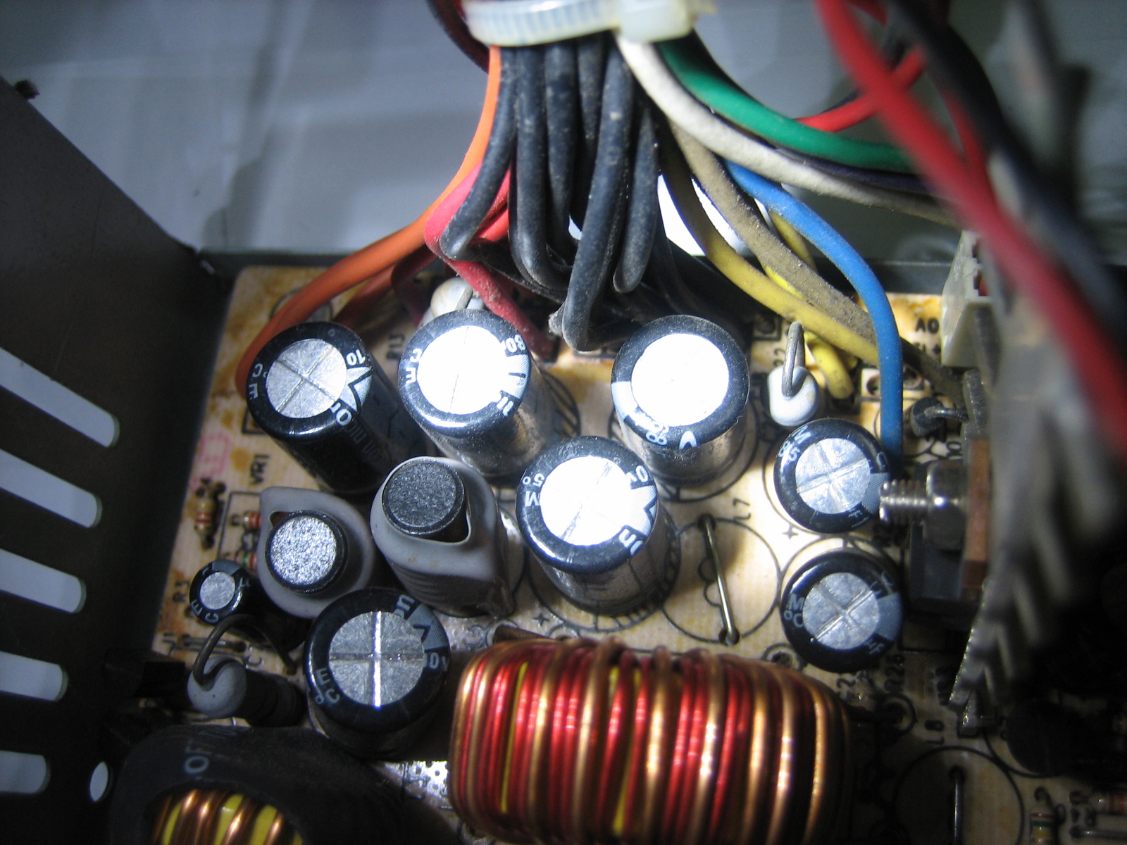

    Then I unsoldered all the secondary caps and I make sure ESR reading on yellow rail caps of 470UF 16V tested good since ESR reads<0.20 ohm.
    The caps on black rail of 680UF16V & 680UF10V ESR reads<0.10 ohm while the caps on red rail of 680UF10V tested good since ESR reads <0.10 ohm.
    I also tested ESR on smaller caps on C27(1UF50V reads 3 ohm),
    C33(0.68UF50V reads 3.5ohm),C40(4UF50V reads 1.4 ohm) & C45(1UF50V reads 3.4 ohm). All ESR reading on these four small caps are within good range.

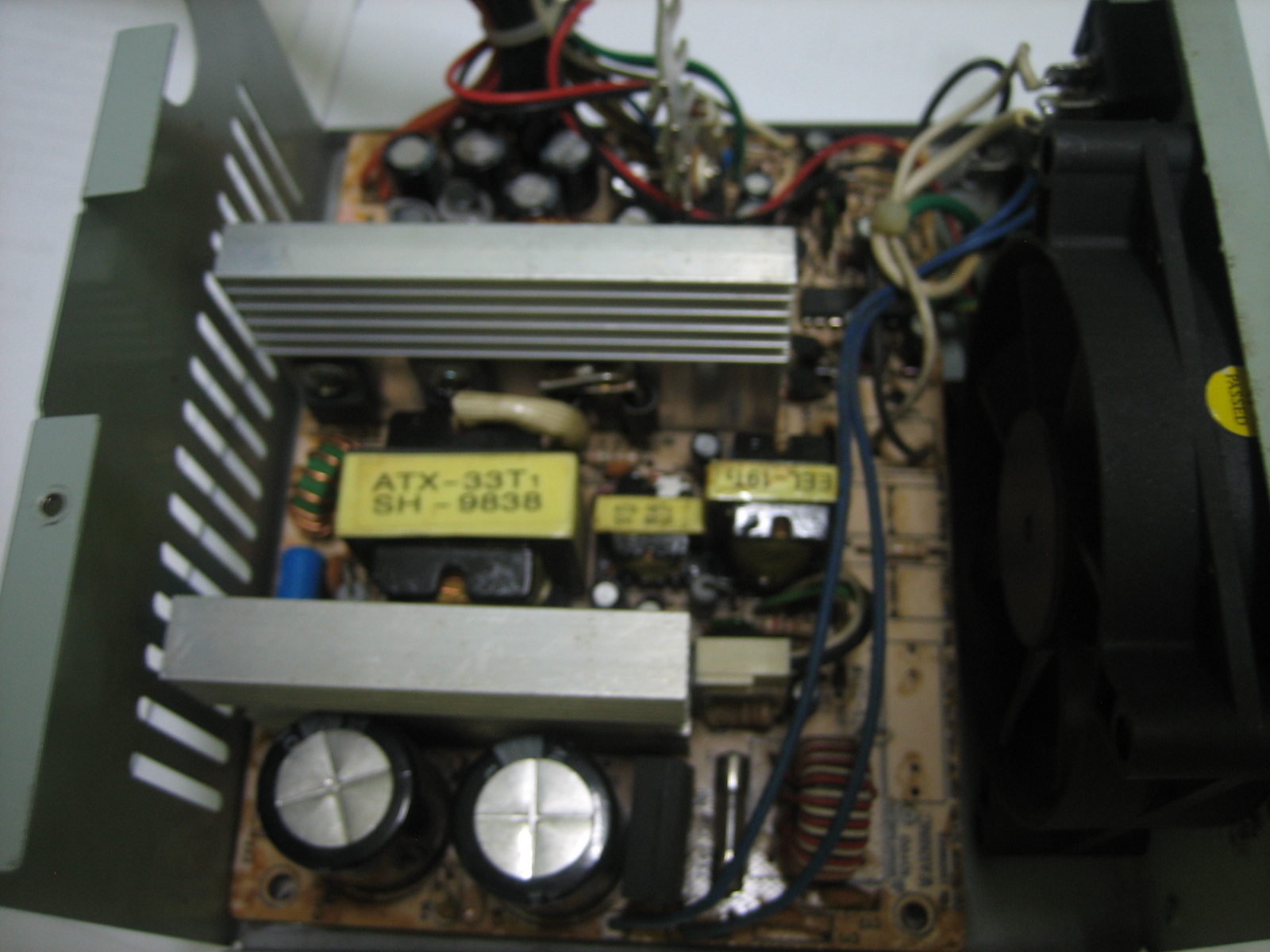

    By setting my DMM to diode test, off board the diode FR103 on D15&D19 along heat sink2 reads 466 on one side while "1" on the other side. Both diodes are not shorted or open.

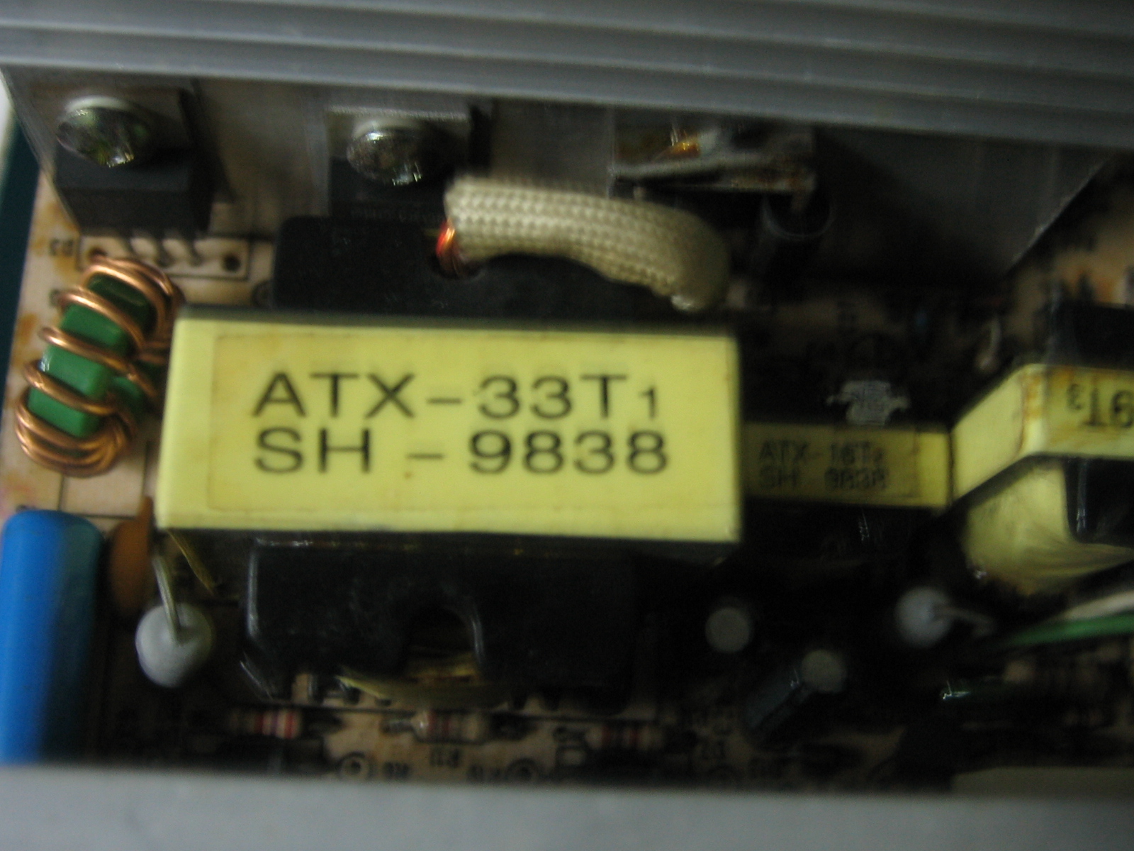

    Then I did diode test on 3 transistors on heatsink 1 which are C5027, and 2 units C2335F. The diode test doesn't find any short or beeps.

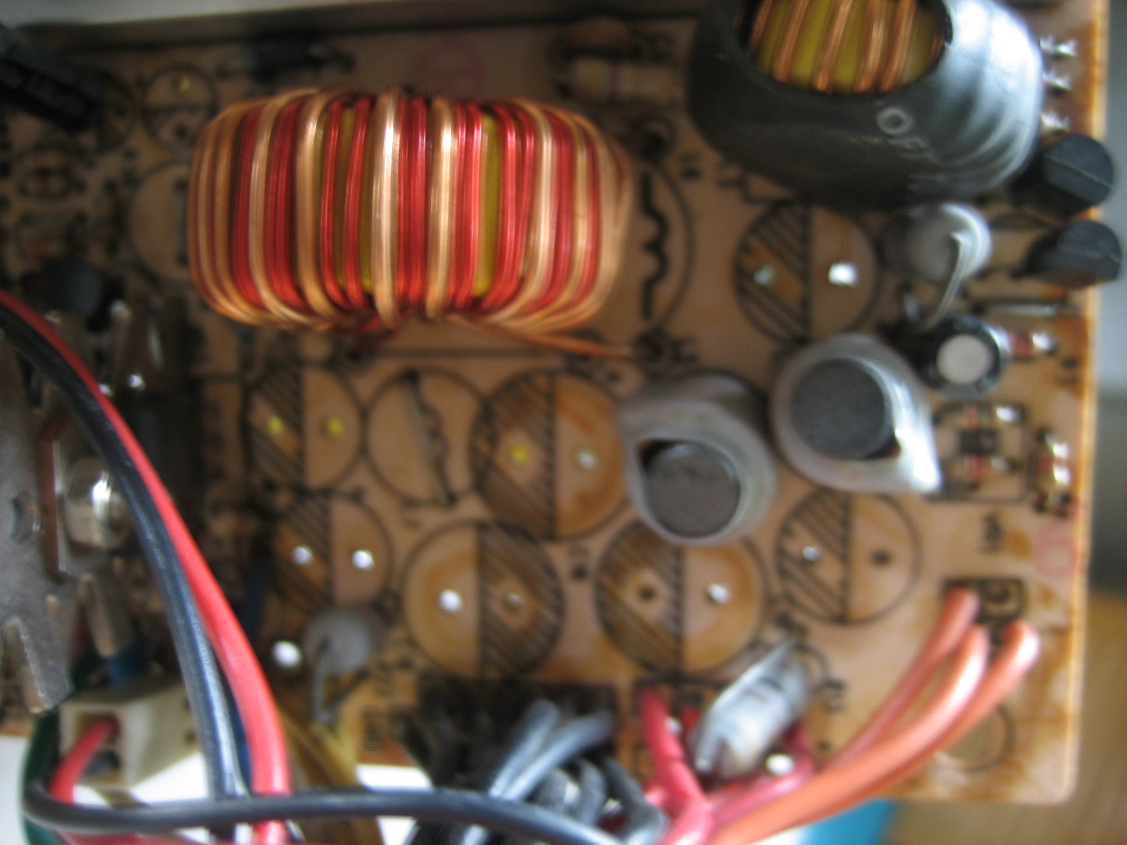

    I did diode test on schottky rectifier on heatsink2 which are double diode(can't see the type), PSR16C40CT and MOSPEC S10C40C. Black probe to cathode middle pin and red probe to left and right anode pin
    both shows around 79 ohm. The basic result seem to conclude there is no shorts. Refer to img 1897 on back of pcb, I saw a connecting black wire and
    zener diode and wonder if this is supposed to be here?

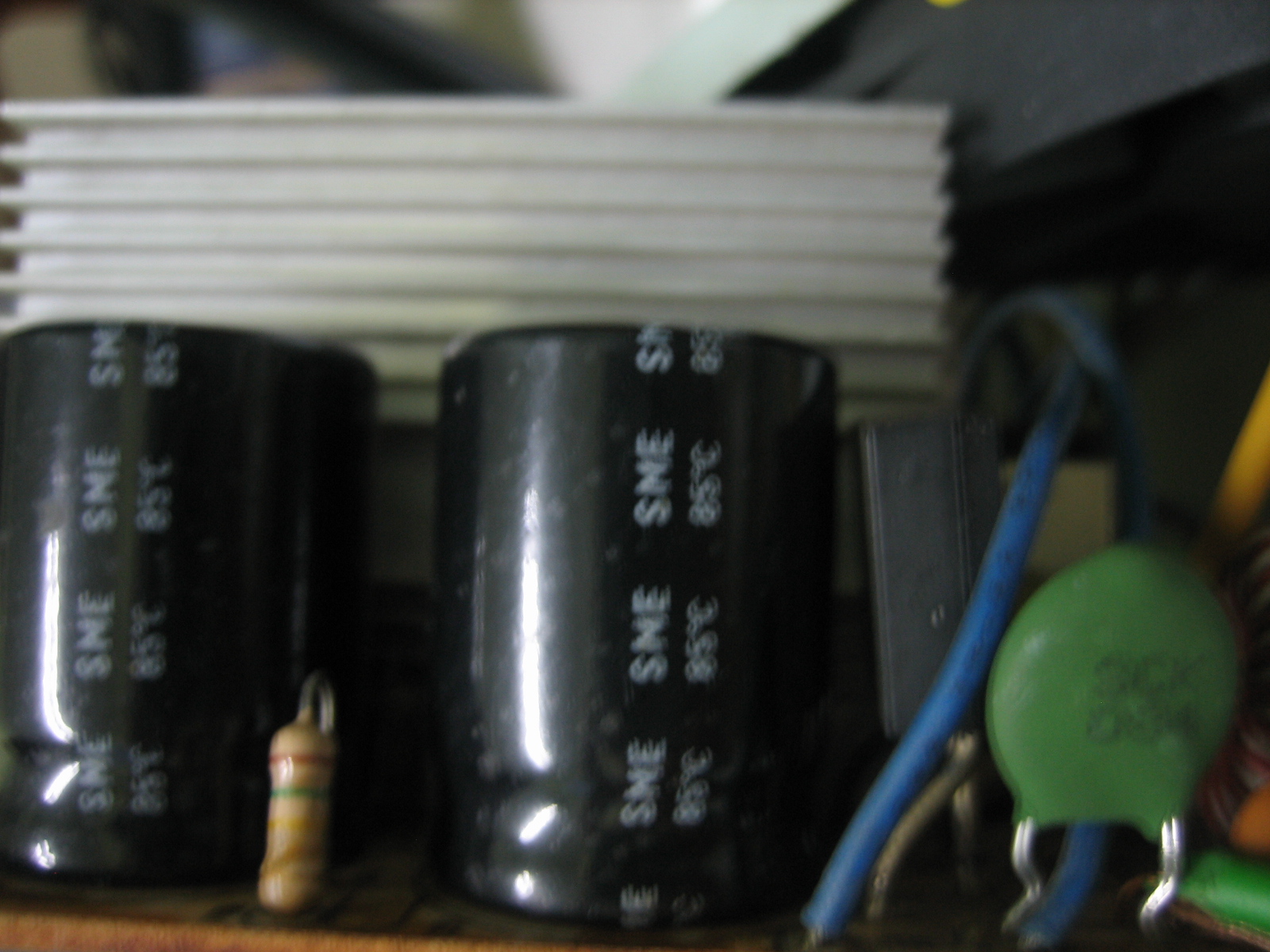

    But I have no idea how to test the two big main cap and the black square bridge rectifier. FYI, on hand I have a digital multimeter,a 40W soldering gun, a china made ESR tester(M Tester v2.07) and a digital capacitor meter.
    I will appreciate anyone kind and generous to advice on what to do next to revive this ps.

      If there are no shorts, the primary transistors could have failed open. Replace both C2335F transistors and see where that gets you. As replacements you can use 13007 transistors or anything else you may find in the same position on a similar power supply.

          Replaced all the small caps and two transistors C2335F with new 13007. Tested voltage
          on purple and black wire,it reads 5.03VDC.(standby power)
          This time after parts replacement, got merely 0.03VDC on red (5V)and black wire.
          Is this some improvement since the ps got a tiny 0.03VDC now?
          Where do I go from here in order to get the full power supply to work fully.
          Any advice please and thank you for reply.

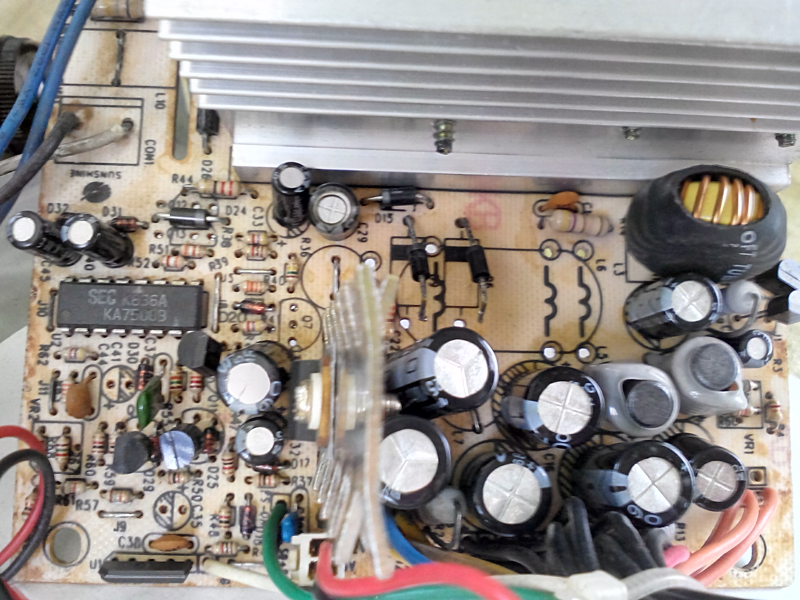

                In the opening statement you have posted some ESR measurements and concluded that they are all normal, but to me they all seam wrong, for example the 470u/16V on the 12V rail, you sayd you got 0,2 Ohms, but as you probably know a smps filters it's outputs with low esr caps, and 0,2 Ohms is not a low esr standard vallue, you should always want less than 0,1 Ohms for that vallue ( 470u ), preferably under 0,05, especially on the larger capacity ones. Another example is the small caps, over 3 Ohms for 1uF cap does not seam a good vallue to me... I suppose all the measurements have been done with the caps removed from the board. This is what you should do with the large caps on the primary side too, remove and measure them, you should find a capacity vallue close the one written on it ( within the tolerance level ), and the ESR should not be greater than 0,2 Ohm. The bridge rectifier can be measured on the board, you set the DMM on the diode function and you check each rectifier's diode.
                Another thing, you saud you have measured 5V on the 12 pin of 7500 chip, that is way too low for that IC, it is basically TL494 and it's UVLO is at about 8V, you really should first make sure you have the correct voltage at that pin ( about 12V ), without it the main converter will not work because of the UVLO of the controller. That 12V comes from the auxiliary converter ( the same as the 5Vsb ), so you can check it without powering up the main converter, when you have it, them change all the filter caps on the outputs, then try powering up the main converter again and see what you get.

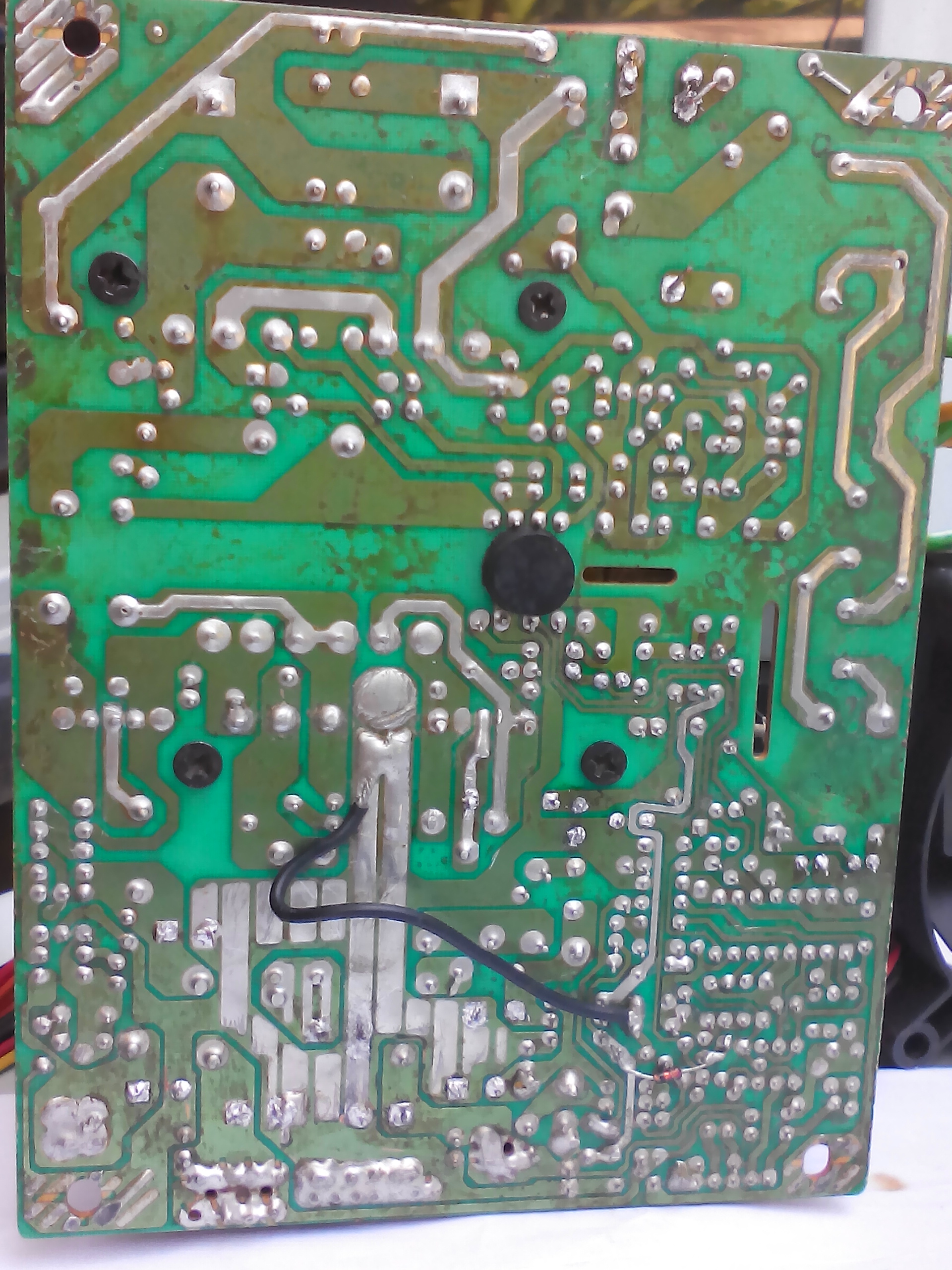

                    Re: Need help diagnose dead Sunshine ATX235 power supply

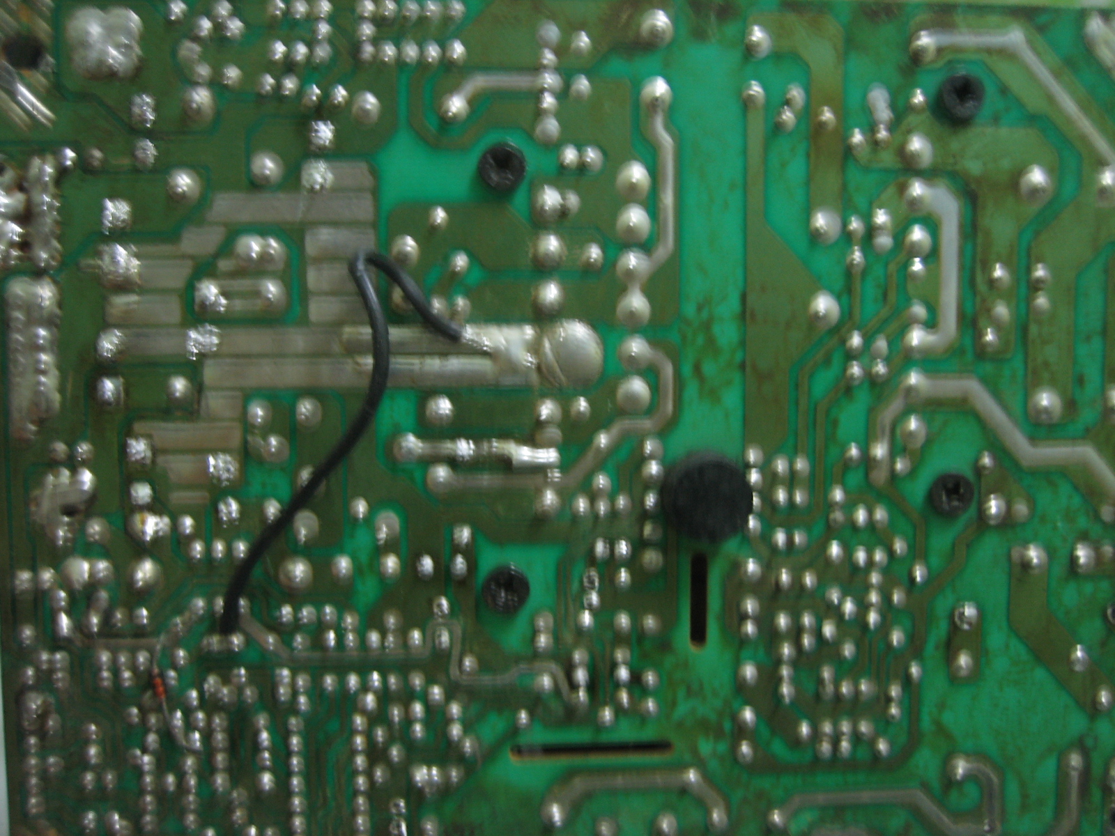

                    Your pictures are not clear enough to be of much help, but you said that after changinc some caps you found a good 5Vsb voltage, have you checked again the voltage at pin 12 of the 7500 IC after changing those caps?
                    You should follow back the trace for the controller power, put the black wire of the dmm on the output ground, and with the red one, probe at different points of the power trace back to the auxiliary transformer's secondary, you should find a rectifier diode from one of it's pins leading to a filter capacitor wich can be up to 100uF or so... Since you have corrected the 5Vsb voltage, the 12V for the controller should be ok as well, since it's coming from the same transformer and it's regulation is an indirect one.

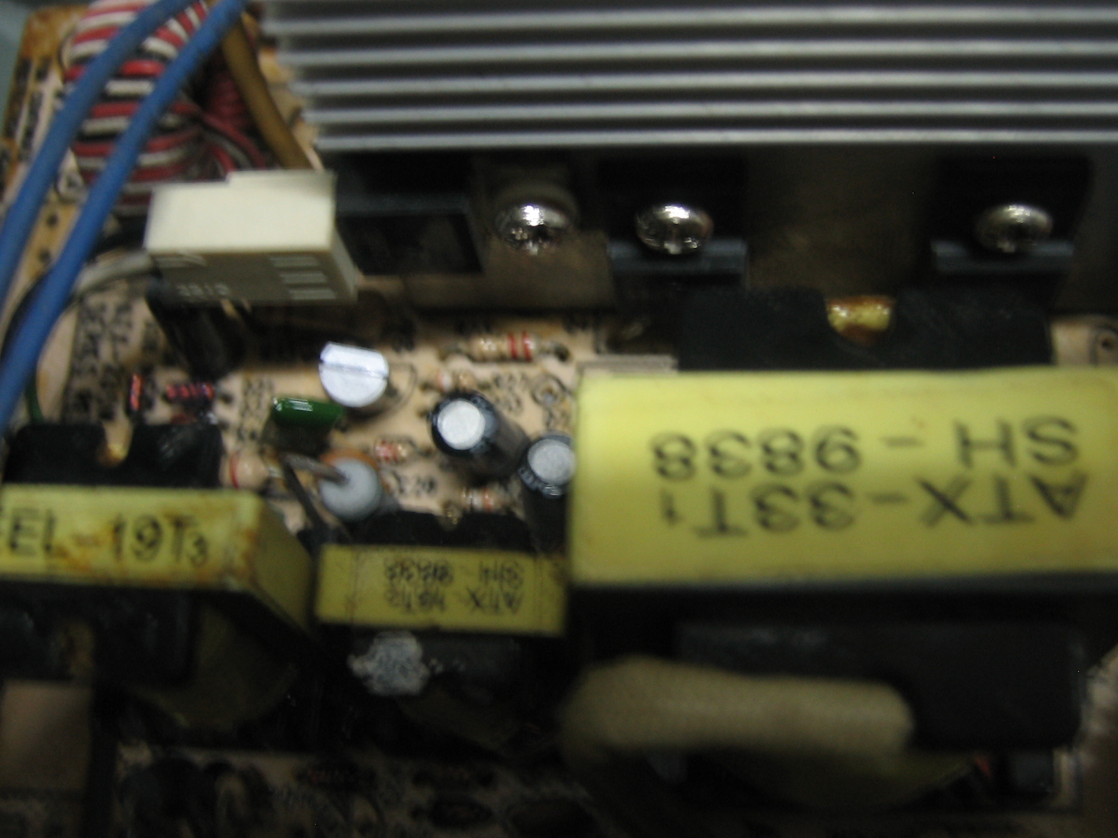

                                      I think the drivers are the 2 above the KA7500B controller in picture #6 of your first post. You can confirm this by tracing with your multimeter, see if the bases are connected (through a resistor) to pins 8 and 11, which are the collector outputs of the KA7500B.

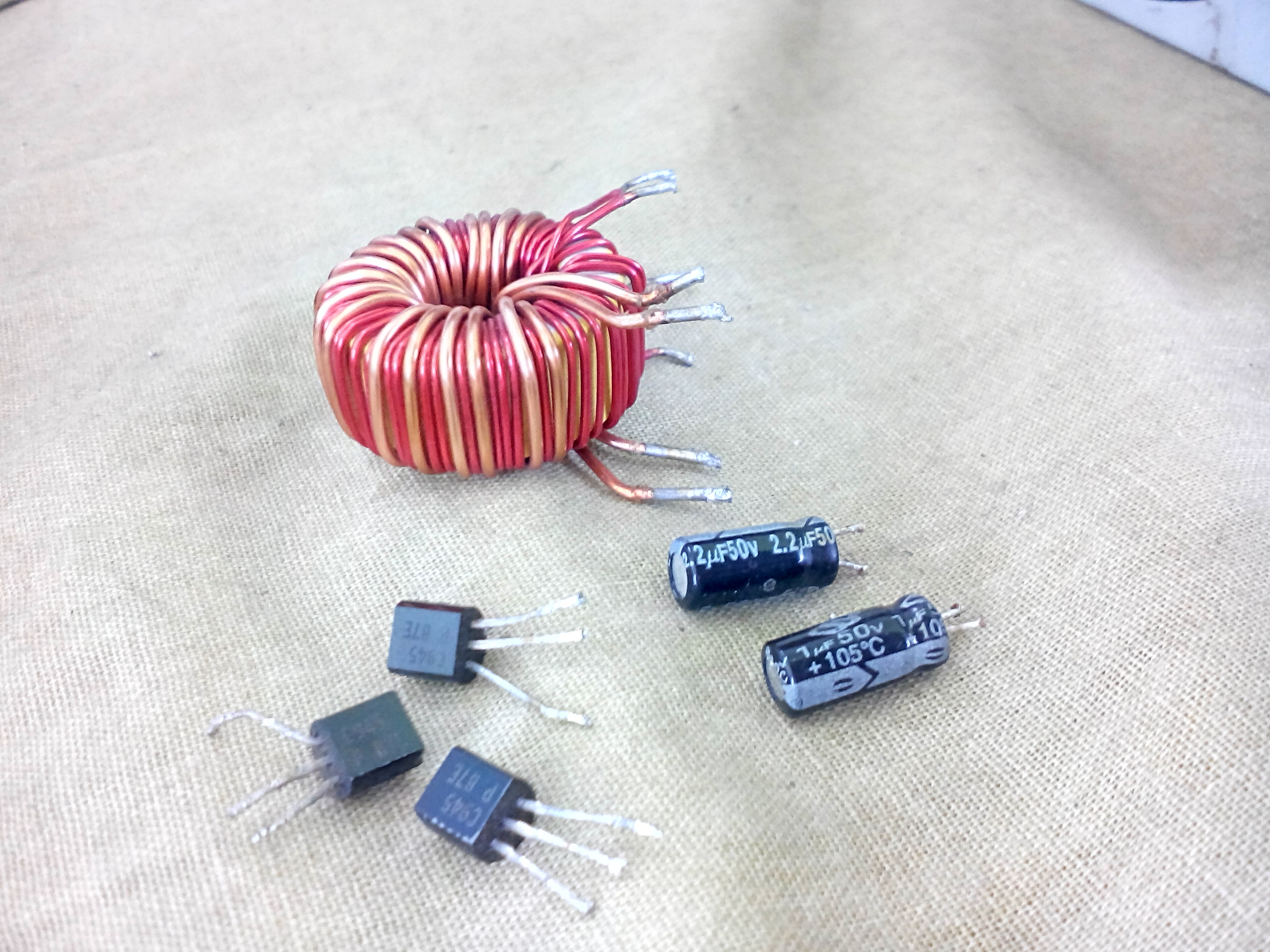

                                        I desolder the two driver transistor from board position at Q12&Q13-these
                                        are above the KA7500B controller and another one from Q7. The three trans are with
                                        label C945 which are TO-92 NPN Transistor; looking at front side with emitter(E) on left,collector(C) in middle pin and base(B) on right pin.
                                        Using diode test setting, black probe to B while red probe to E, DMM reads 1 (infinite),
                                        while black probe to B while red probe to C, DMM reads 1 (infinite).
                                        Then red probe to B while black probe to E, DMM reads 593; while red probe to B and black probe to C DMM reads 594. All 3 trans read almost similarly between 591 to 594.
                                        The way I see it, the driver transistors are good. Do correct me if I am wrong.
                                        I also desoldered two small caps at C41 (2.2uF 50 V) & at C35 (1UF 50V) and the big coil. refer attached picture. The small caps reads 3 ohm on ESR; are they alright?
                                        The big coil has continuity. I also desolder one end of the two diodes hidden below the big coil; but diode test showed 467 ohm at one side and swapping probes, DMM reads infinite. Then the result mean the diodes are good.
                                        I am stumped now and do not know what test to do. The 5VSB is present but still no 12V and 3.3V rail. Any tip or advice to revive this ps is very appreciated.
