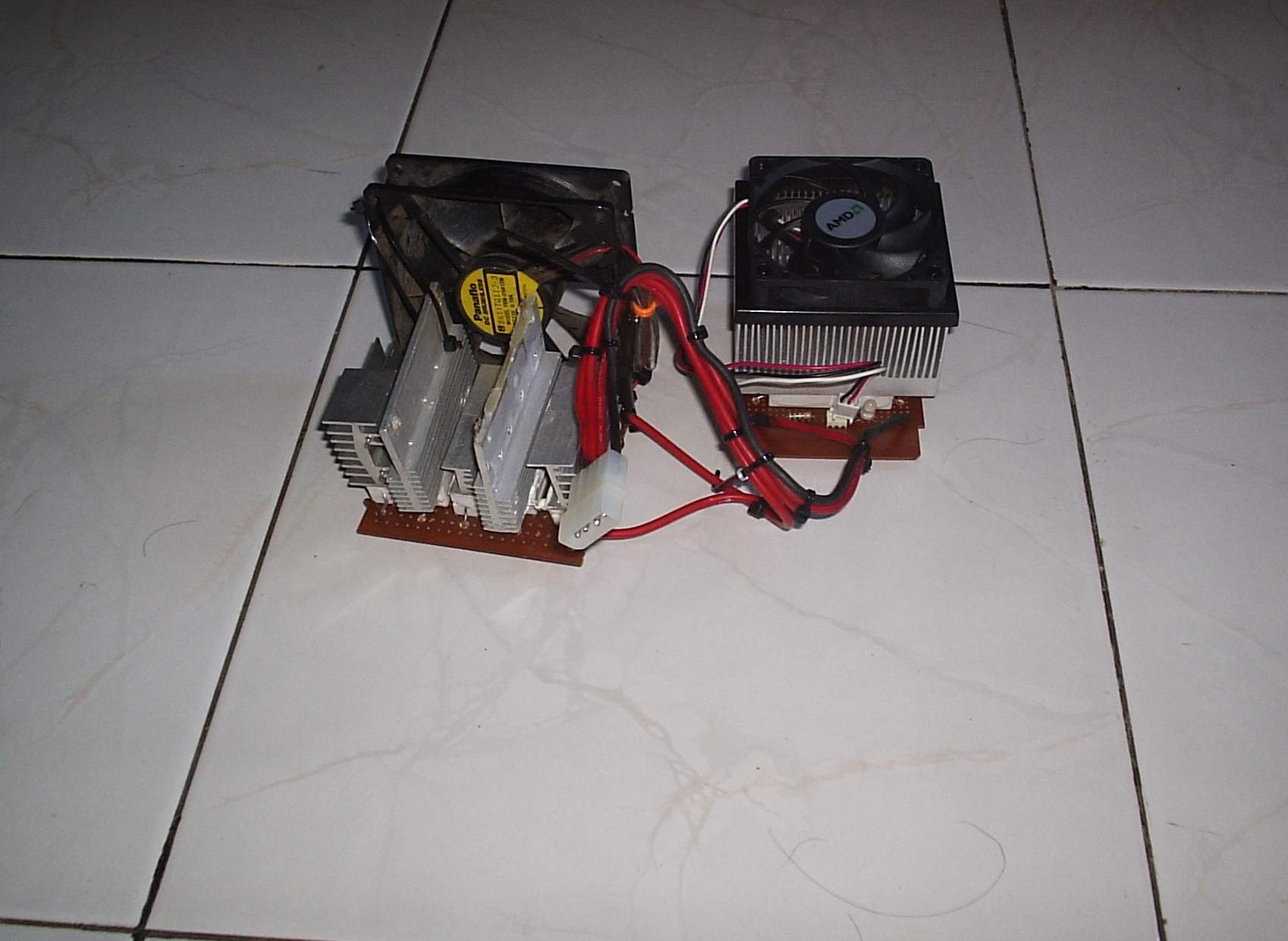

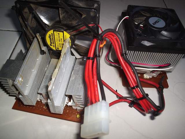

                My god, yanz, what is that? Thanks for the pics...looks like you can hook it up and load your 12v and 5v...but what about 3.3v?

                  yea they are each for 12v and 5v load, bout 15-20W each (~30W total, iirc...)
                  i never found problems with too low load on 3.3v, im not sure why.. with too low load on 12v and 5v there could be anomaly in voltage rail output, but with 3.3v, never...
