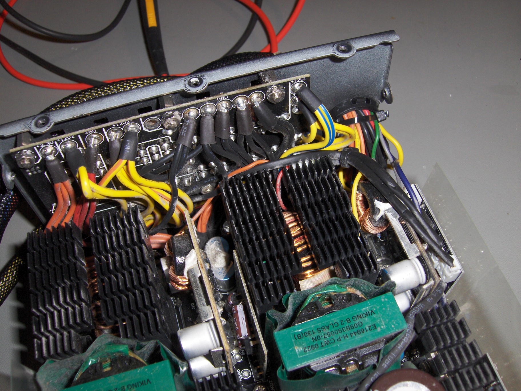

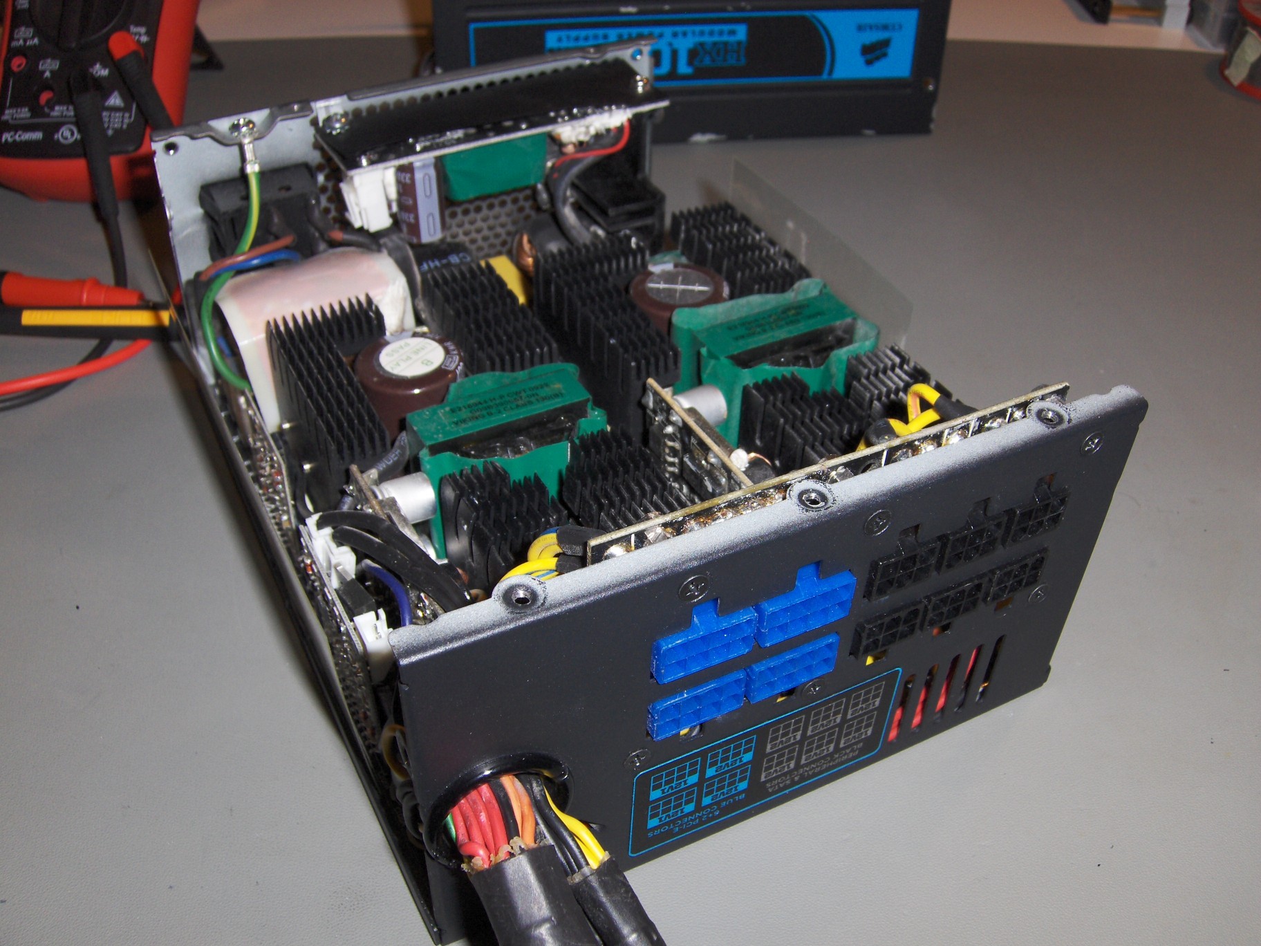

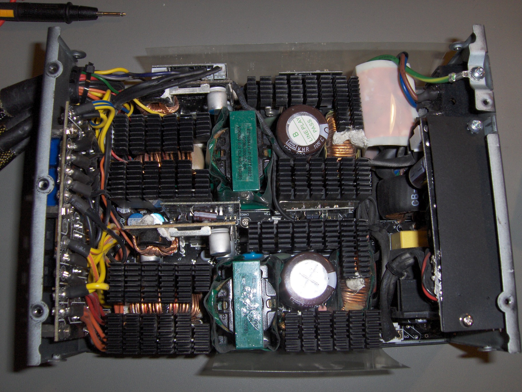

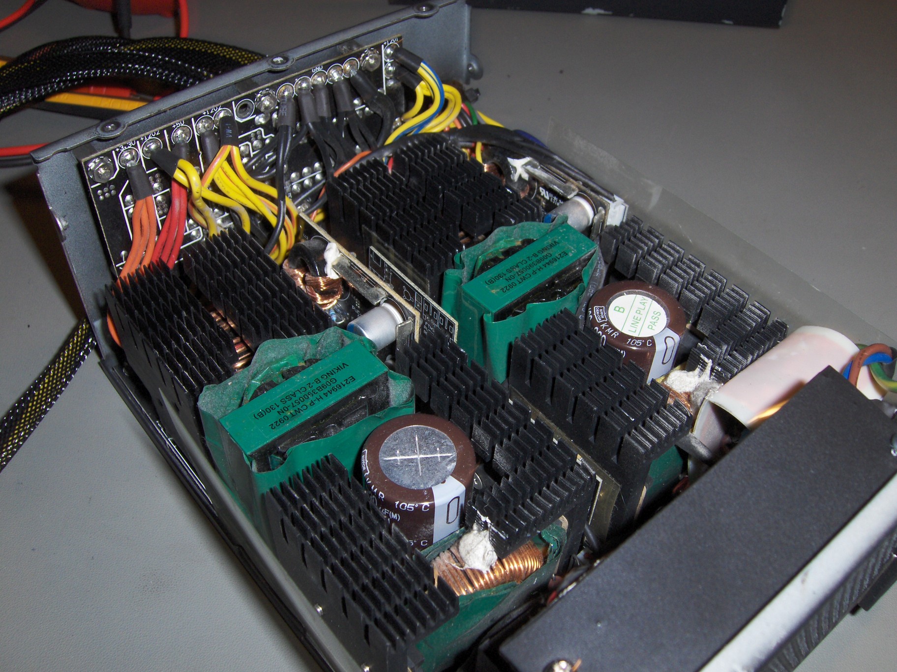

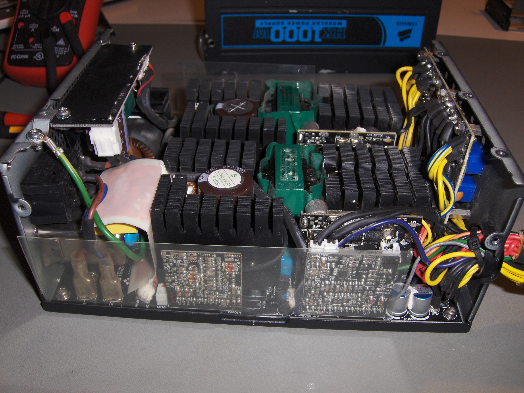

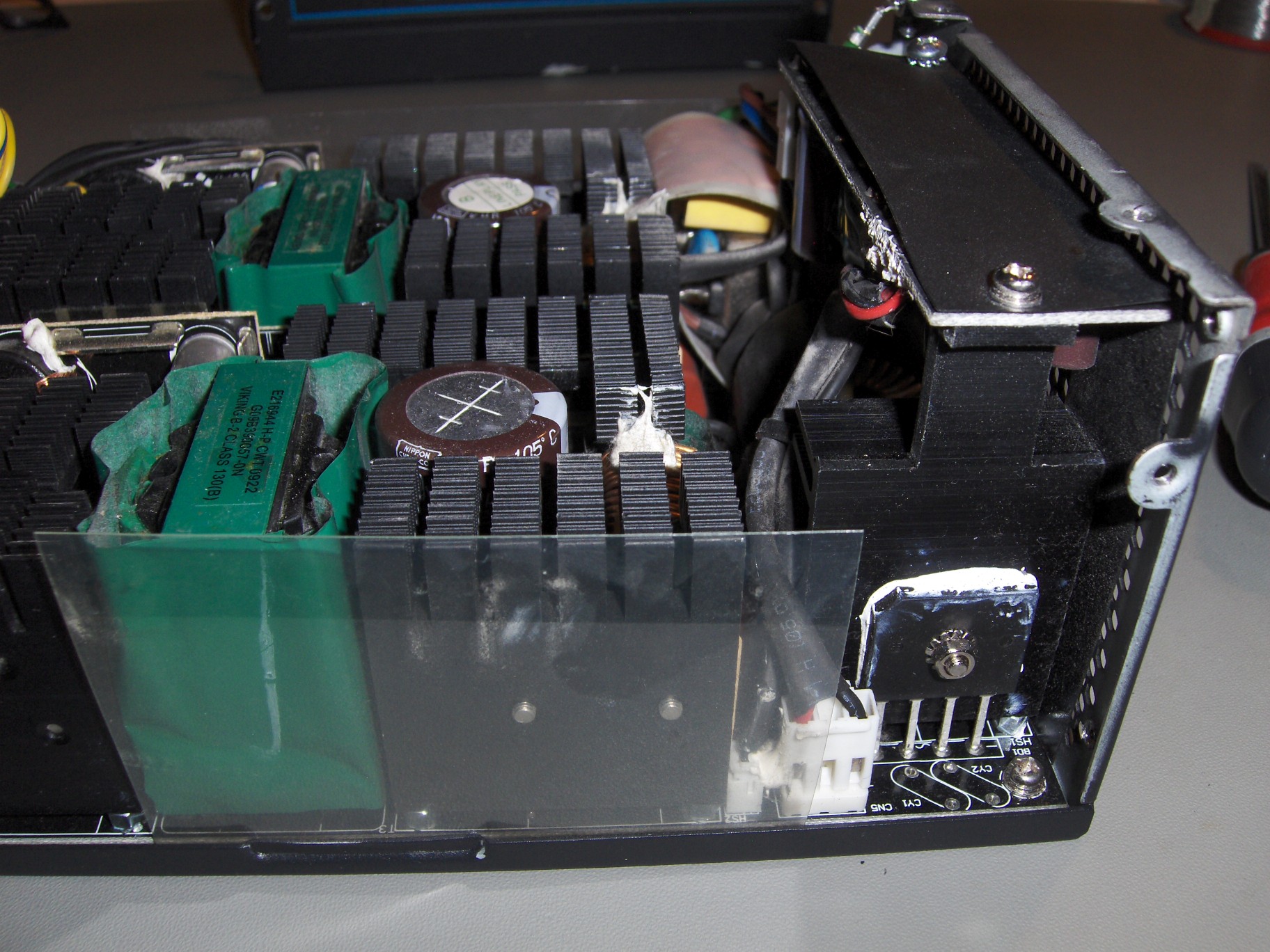

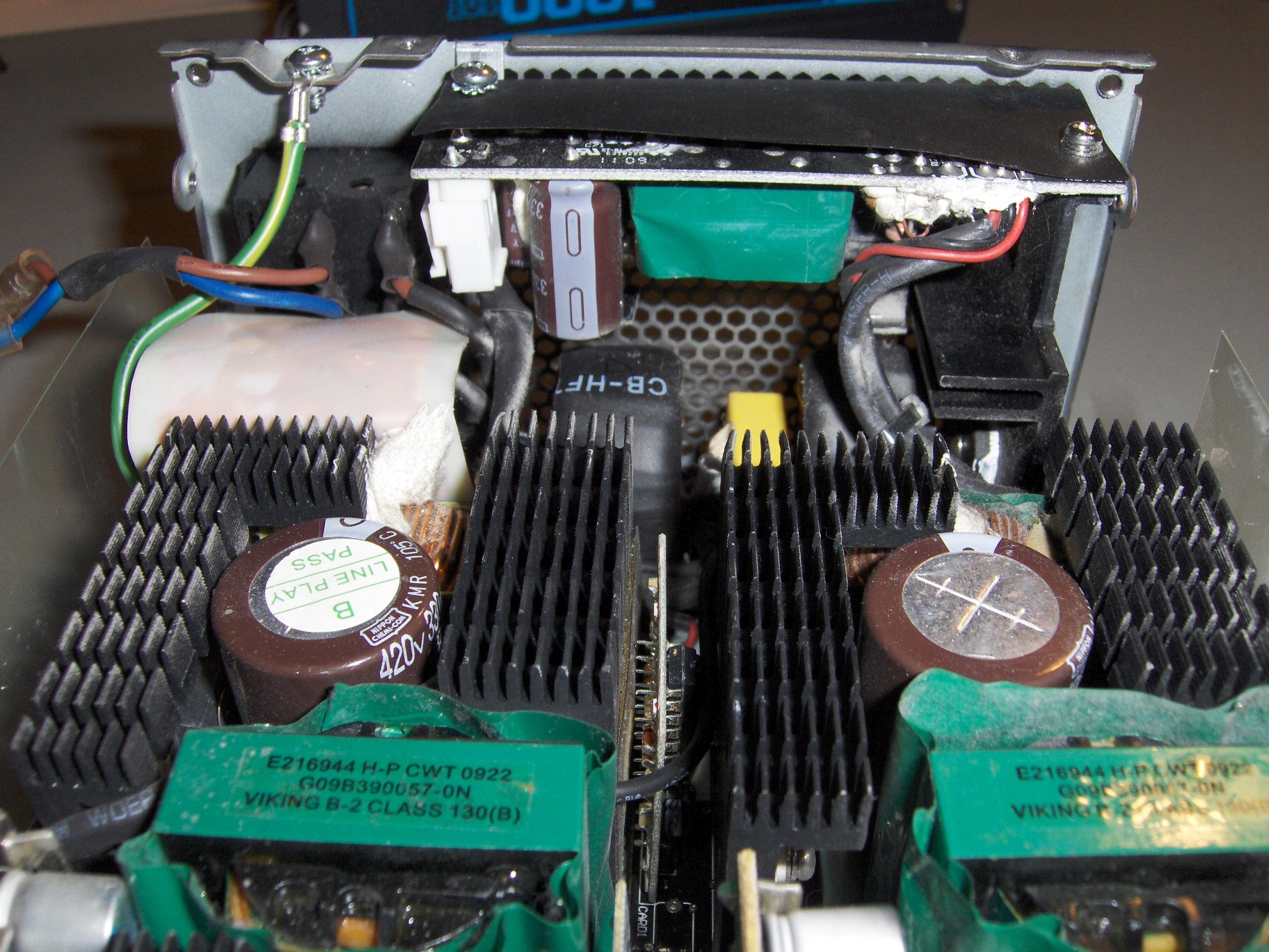

            Re: Corsair HX1000 not powering on
            Back from vacation and have some time to play with this psu again, I'm taking the boards out of the casing to have a look on the underside.
            Any suggestions for what to check while I'm at it ?
              I'd guess some small SMD components on the feedback. There are shitloads of them, this is lately the usual condition for which PSUs die. The more complicated it is the higher the chance something goes wrong.

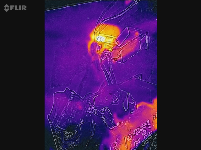

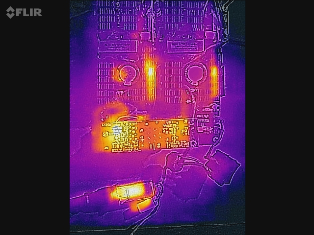

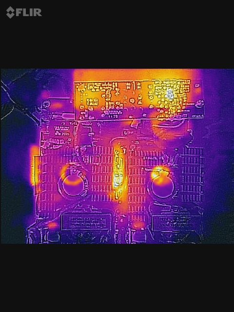

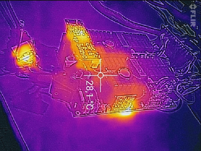

                      I tried to heat up main and and riser board components with a heatgun but it made no difference, didn't turn on using freeze spray either.
                      Borrowed a flir one and took some photos, as you can see both 500W supplies heat up in the same place around primary capacitors and both riser cards to the left of main capacitors heat up equally.
