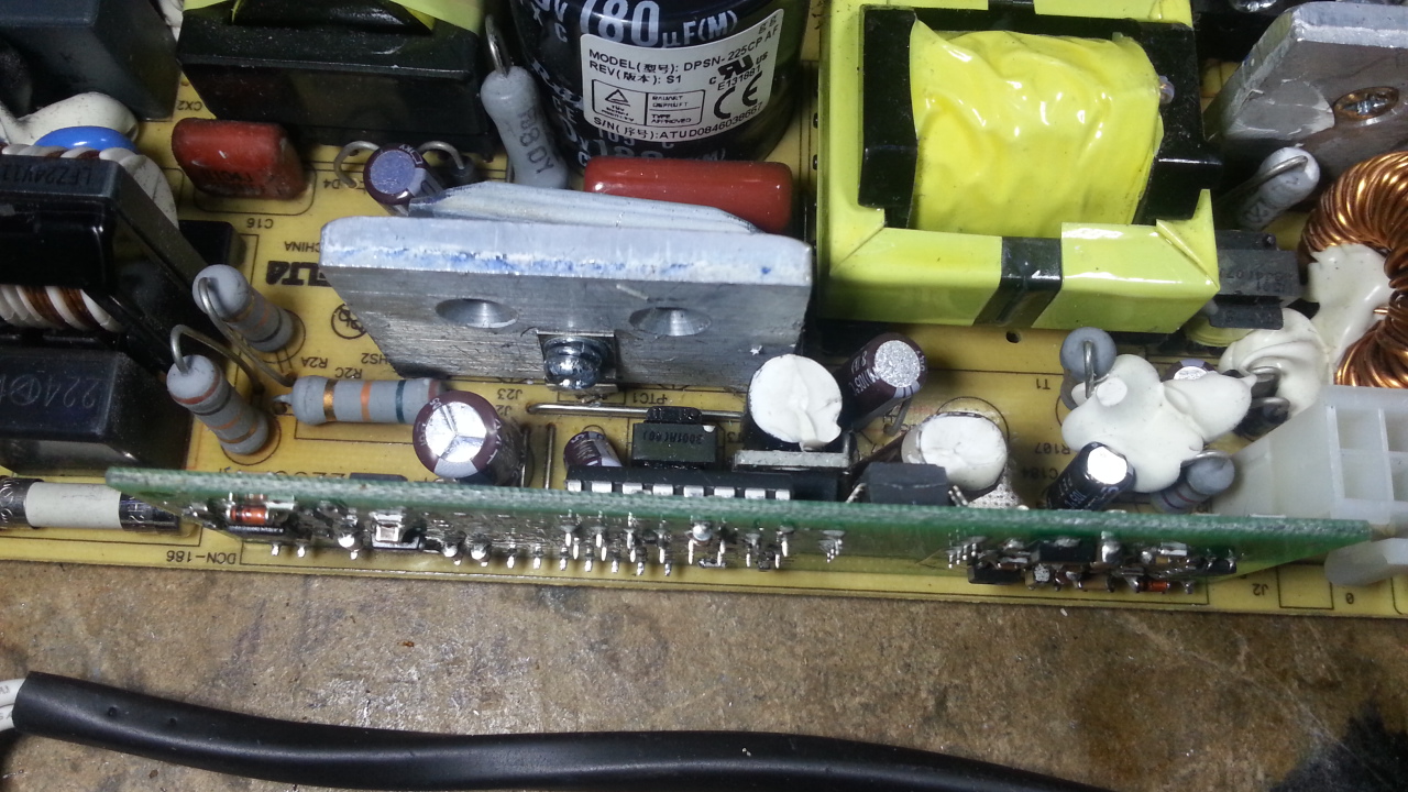

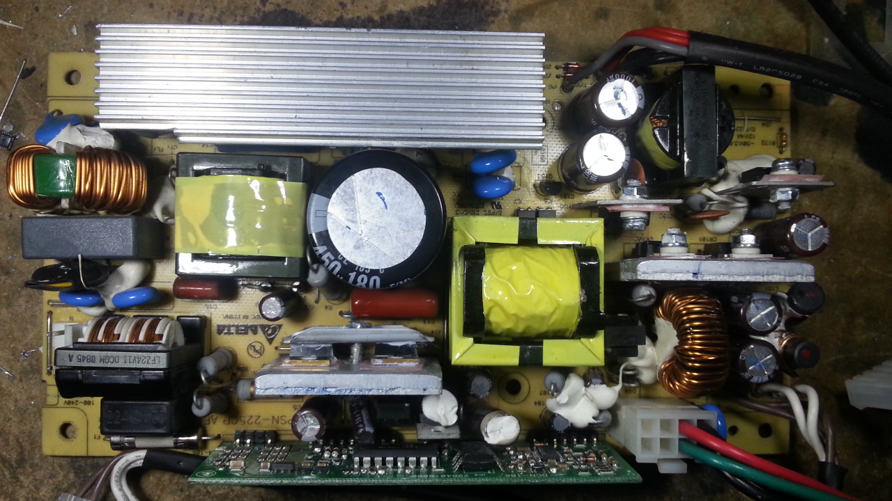

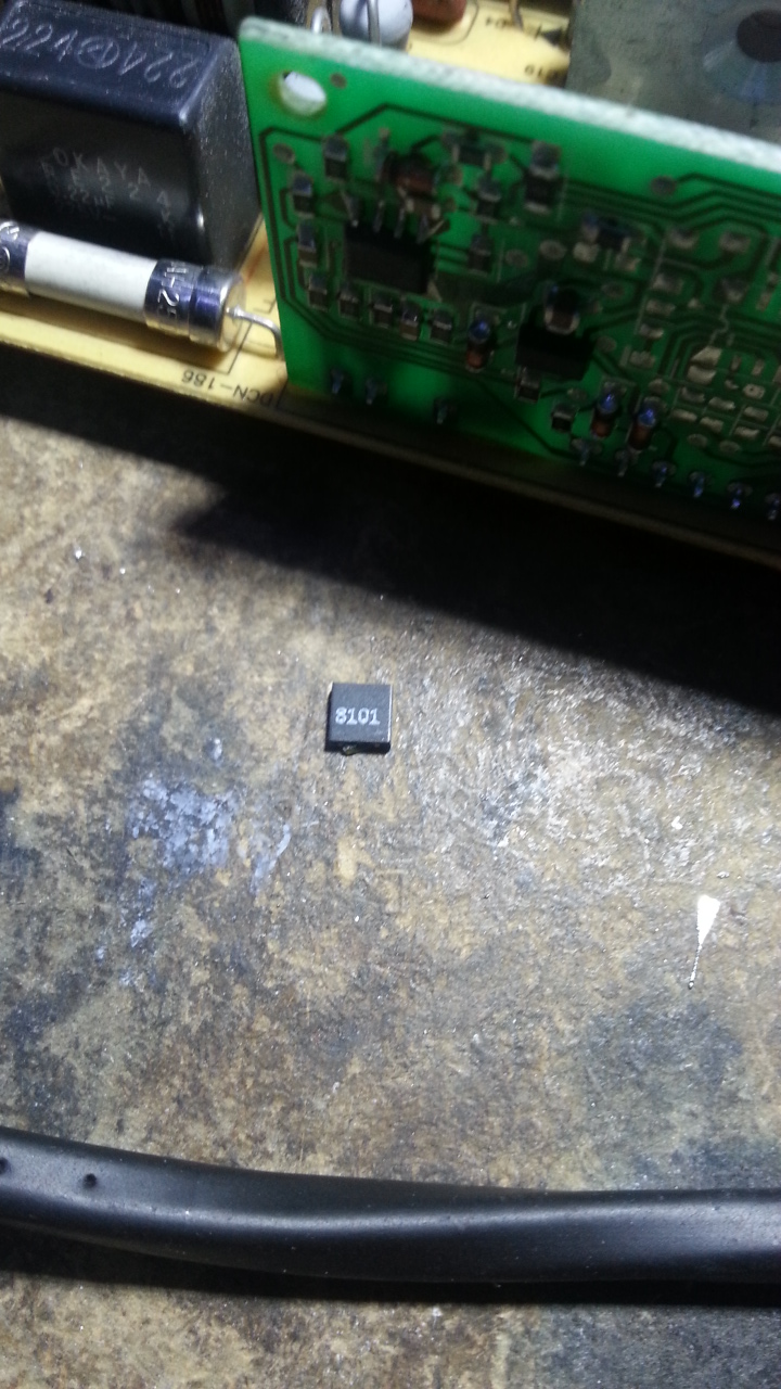

    Hello, I have power supply here from a Netgear POE switch.
    It has a broken off component. It's marked 8101 and goes in position PTC1, It has 2 legs.
    It has a resistance of 1.076 kΩ
    Any ideas what it could be ?
    Many thanks.

    Re: Delta DPSN-225CP AF broken component
    probably a PTC
    • diif
      • Feb 2014
      • 6978
      • England
      A thermistor ?
        • 31163
        not exactly.
        a thermister is used to detect temeraure.
        a ptc is used to control current.
          PTC is Thermistor.
          PTC and NTC thermistor.
          http://www.teamwavelength.com/info/thermistors.php
          How is it connected in the circuit? Does the resistance go up a lot when heated with hair dryer?
            Yes. When I heat the component the resistance does go up.

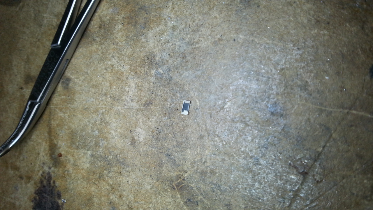

            I'm guessing its some sort of thermal sensor as its mounted on the back of the heatsink with two MOSFETS.
            I couldn't find my hairdryer so I lazily used by butane torch. I was a little over enthusiastic and the black casing combusted.
            Attached is a photo of the item inside.
            Looking for a positive, the component is still "alive" I measure the same resistance on it's two pads. Maybe I could solder a couple of wires to them and mount it back on the heatsink with some thermal adhesive if I can't find a replacement.
              I've tried to solder to the pads, but they are not taking it. My search continues.
