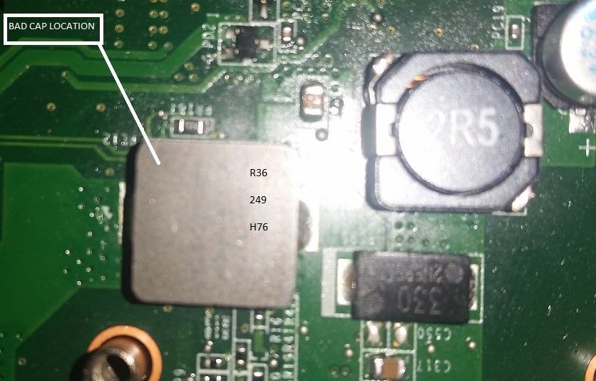

    hi forum,
    can any one help me find the value of a large flat SMD cap
    it reads these numbers on the cap from top down
    R36
    249
    H76

    Can we see the pictures of the cap?

      Re: SMD cap value needed
      picture attached
        that's an inductor.
          Originally posted by stj
          that's an inductor.
          oh ok,
          do you know how to find the values?
          I think i need to match up the inductance, current ratings and resistance to replace it.
          i would guess the 249 means Inductance 2.4µH
              I figure the R36 denotes 0.36uH for high-current low profile (flat) inductors.
              You would need the manufacturer's name to nail the part i.e series 249. My guess H76 is the date code/plant ID. Beyond this, look to the app note for the IC driving this inductor, for inductor part numbers.
              These parts don't fail unless cracked/chipped or overheated.
                shorted. reading very, very small resistance, less than an ohm
                it got wet
                    it's supposed to look like that - it's a coil of copper wire!
                    it shorts out the board when on, when off the board is not shorted
                    guess it could be something else beyond its circuit then. cant seem to see anything broken
                    probably one of the small smd caps behind it then
                        if it's off the board, meter the resistance between the pcb pads.
                        also, what's the resistance of the inductor off-board?
                        inductor is 0.8,
                        im guessing one of the tiny smd caps is the short now.
                          if it's part of a switching psu circuit then there may be a diode involved.
                            Good clear pictures of the whole board? What is this board used in?
                            Probably may have shorted SEMI on the board.
                              PC motherboard: there is nothing visually damaged,
                              a block of caps after the inductor leading to the cpu is still shorted when i pull the inductor off.
                              and if I also pull the cpu off, the rest of the board is not shorted, so i see the area where the short should be at.
                              Might be several shorts
                              I guess I should have checked that earlier before posting, Really, I cant think too fast, it takes me time to think everything thoroughly and its hard to focus around here
