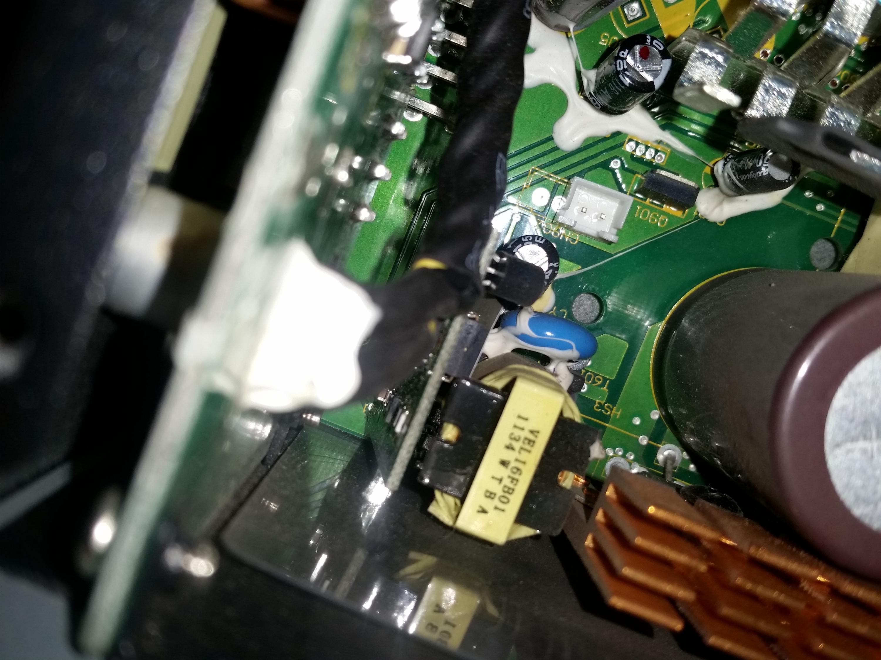

          Re: Is Seasonic SS-660KM PSU ErP Ready
          Hi, guys.
          Sorry for restarting this old thread, but I am still at a loss about this matter. I have sent an inquiry to Seasonic about SS-660KM's ErP support but I still haven't got a reply. I am even more curious now because of the following:
          My PC has started having power-on delays in a duration of several seconds. By this I mean that when I press the Power button on the PC casing, nothing happens - no fans, no noise, no LEDs, nothing. Then, if left for an arbitrary number of seconds, the PC would suddenly start and boot up with no error messages and work flawlessly under all kinds of loads and time duration. This leads me to believe that all the components are fine, otherwise lock-ups, BSODs or restarts would occur - nothing of such.
          Because the components are only 2 years old and the computer is not heavily used, I really doubt that something went bad - except for this PSU, which is over 5 years old. Strangely, this delay happens only after the computer has been down for a period of several hours - like over nights, after which it won't power on normally the next morning/day.
          Then, as a desperate measure, I re-enabled this ErP option in my BIOS and the PC now powers on normally regardless of how much time it has been shut down - just as it should be. But because I don't know if this PSU supports this ErP feature, I am reluctant to leave it on as a quasi-solution since I have little knowledge about what it might cause to the motherboard or PSU itself if used improperly. I actually don't know why this behavior even started happening.
          I really don't know what else to try as I have no idea where to even begin to look, especially since once powered on, the PC works fine.
          Would you by any chance have any suggestions?

                • 31015
                try warming it through the grill with a hairdryer - then pushing the button.

                    • 31015
                    not that unusual.
                    it's a way to see if electrolytic capacitors are failing - they perform better when warm than cold!!
                              As suggested by Quaddro, I used a regular hairdryer (for drying hair) for 2 minutes on its lowest setting. The back grill got really warm to the touch. And then, the moment of truth: I pressed the Power button and the computer powered on instantly, like eveyrthing is OK.
                              What does that mean now? Is it possible that during the nights room temperature drops to a level at which the PSU won't power on instantly as it should, and why it does with ErP enabled? Is there a specific component inside that could cause such a behaviour? Especially since once powerd on it works beautifully. Sorry for all these questions... I'm stumped.
                                Well, as stj said, this is the symptom of capacitor failing.
                                The easy way, recaps all of small electrolytic caps first.
                                And if the problem persist, all of the capacitor, small and big.
                                The hard way is using esr meter, to measure each of capacitor internal resistance and capacity.
                                But this effective.

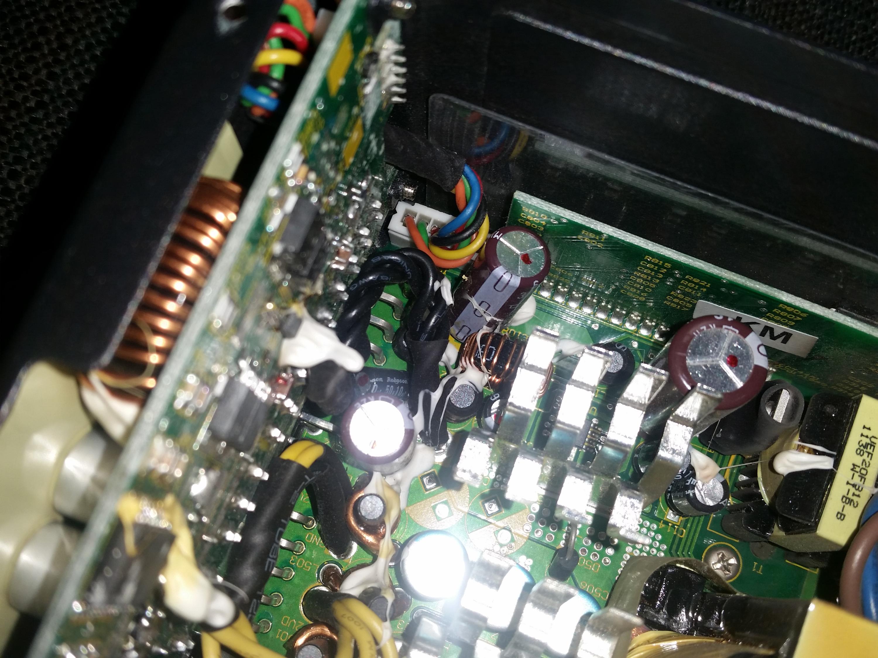

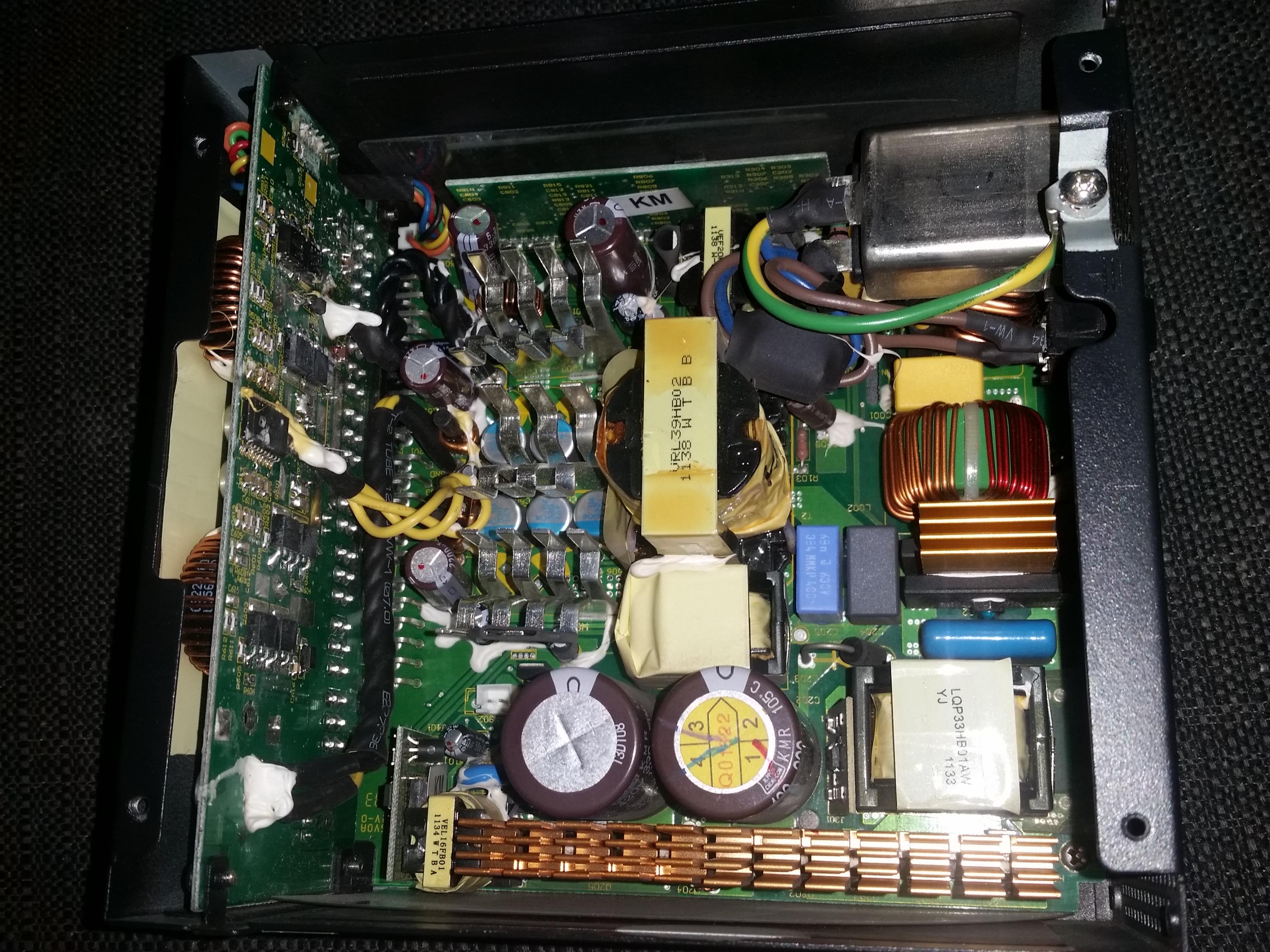

                                      OK, so I managed to open the PSU. Its interior is very compact and nothing like my previous cheaper PSUs. I don't know how to even begin to remove the PCB as there are a few of them inside. As you can see, it has a bunch of Rubycons and NCCs inside. They all look fine, no bulging. Output caps are all on the daughter PCB with plugs.
                                      Anyways, here are the pictures. You are probably more likely to spot something that I could have failed to notice.
                                        The caps in red circle for example, or wherever you find it small caps like that in your psu, especially in daughterboard, replace it.
