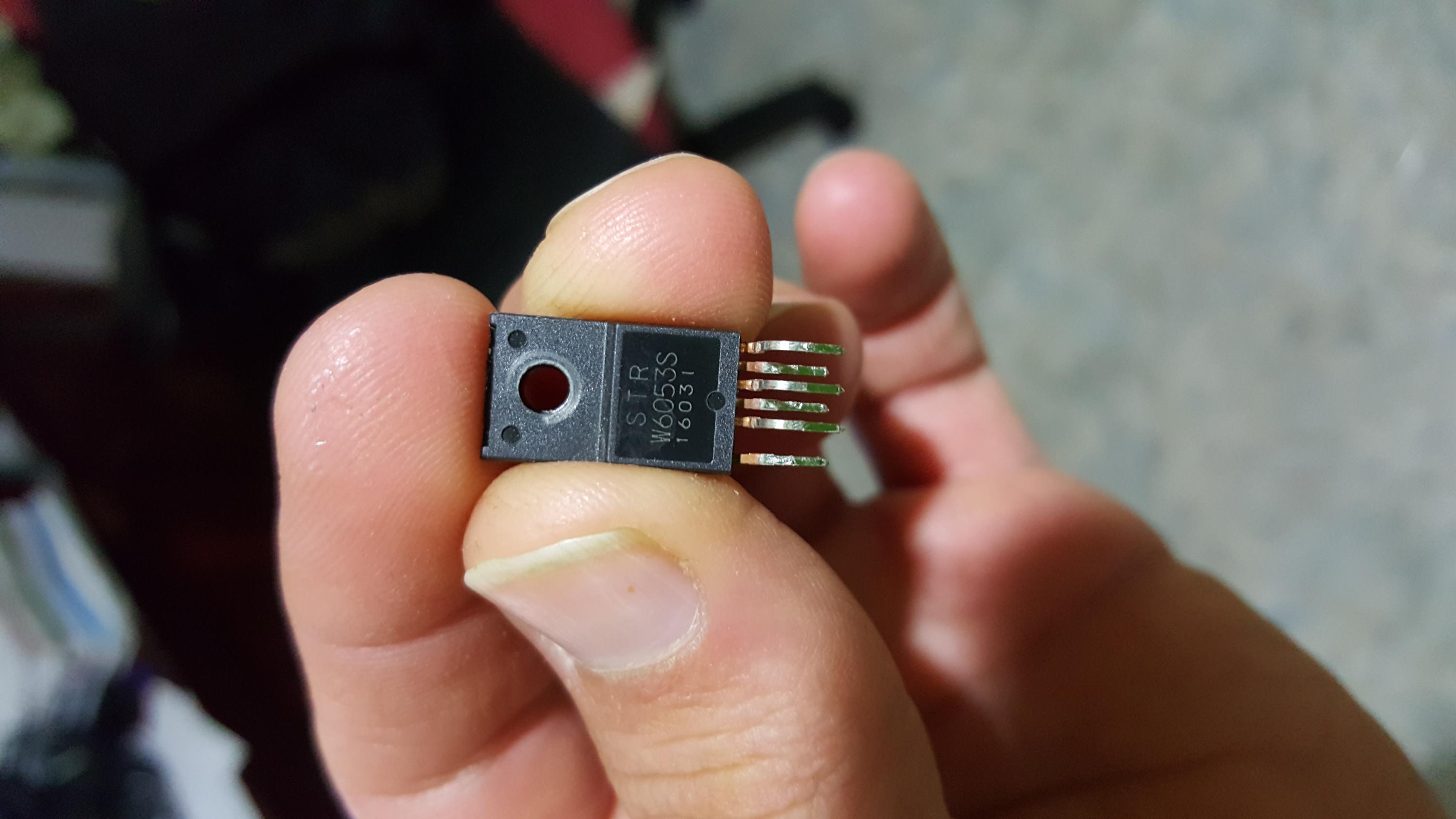

what is STR W6053S?
  • buchman
    • Aug 2015
    • 283
    • greece
    what is STR W6053S?
    And how do I check it to know if it's good or bad?
  • Stefan Payne
    • 1267
    Re: what is STR W6053S?
    Off-Line PWM Controllers with Integrated Power MOSFET+
    From
    https://www.semicon.sanken-ele.co.jp
    Costs about 3,4€ @ Digikey
    http://www.digikey.de/product-detail...53S-ND/3661848
    • Behemot
      • 4845
      • CZ
      You can measure if the MOSFET is no blasted, other than that I am afraid you'd have to connect it to a circuit and try. In such case keep safety (it uses dangerous voltage) and use lighbulb in series with it!
