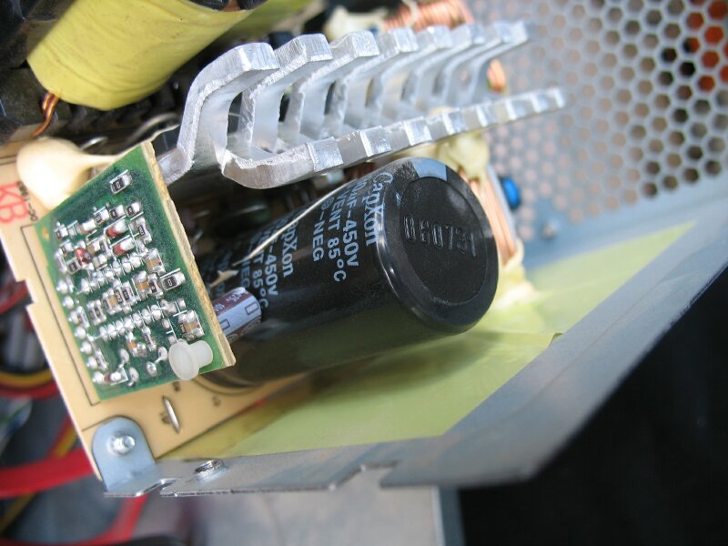

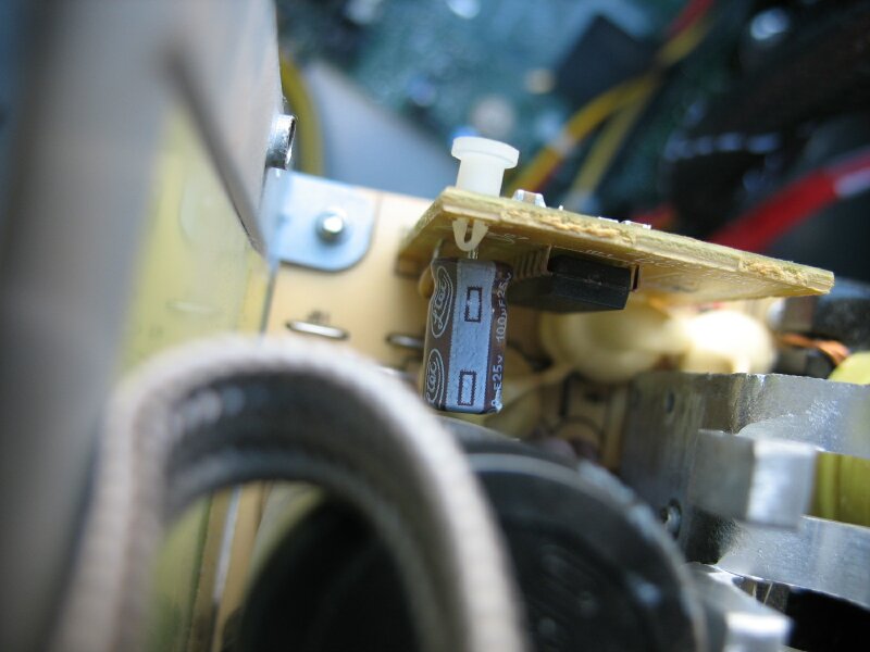

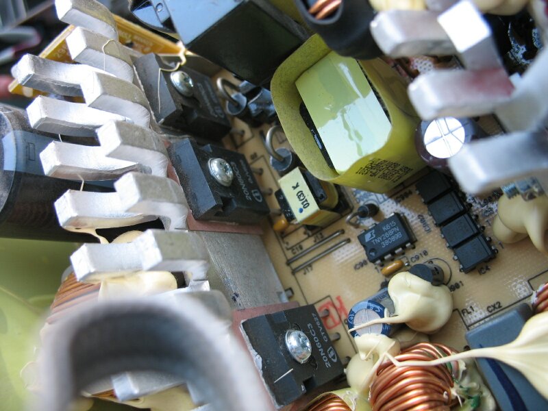

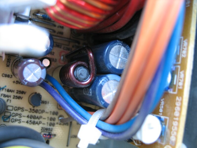

    Chieftec GPS-450AA-101A
    this is pretty decent mid-grade psu.
    primariy side is pretty much lytics starved, something i would like to see more from all mfrs(overall, i like designs with less elements better..).
    i only see 3 lytics there; main bulk(capxon) and ltec on a-pfc board and one for +5Vstb circuit.

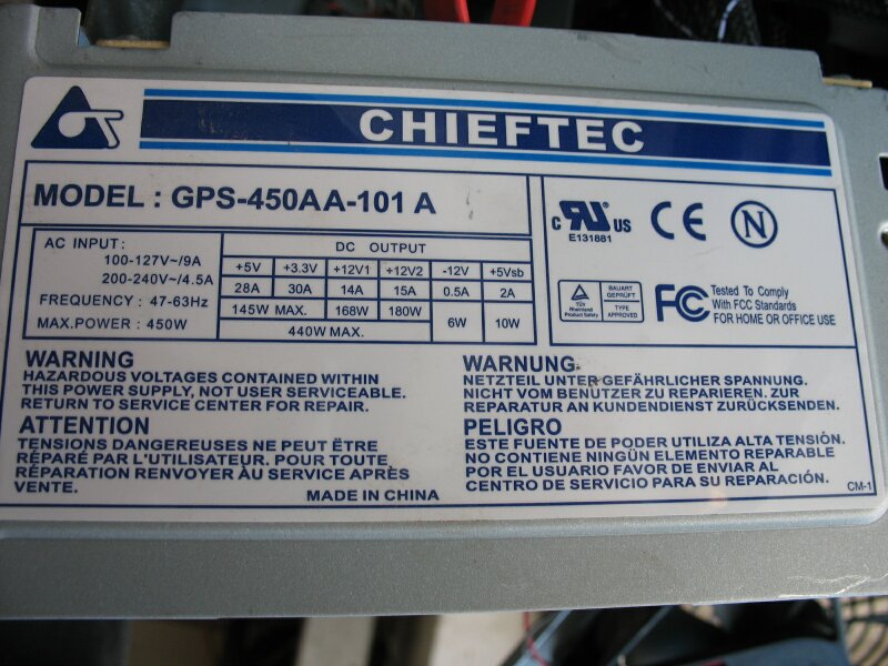

    Re: Chieftec GPS-450AA-101A
    hmm thats a delta. they used to use http://www.highpowersupply.com/
    • Brian C
      • Dec 2006
      • 156
      UL no. E131881 -- made by Delta.
      • i4004
        • Oct 2006
        • 2029
        dunno, we don't have that brand over here.
        but i do know i like the design.
        lytics are not top-notch(capxon and ltec...i've found some reference here that ltec is now part of teapo...) but after a year and a half in service it still looks pretty fine.
        i wouldn't hesitate to use this on my own machine.
        this looks like a fsp-class psu to me, and that's good enough.

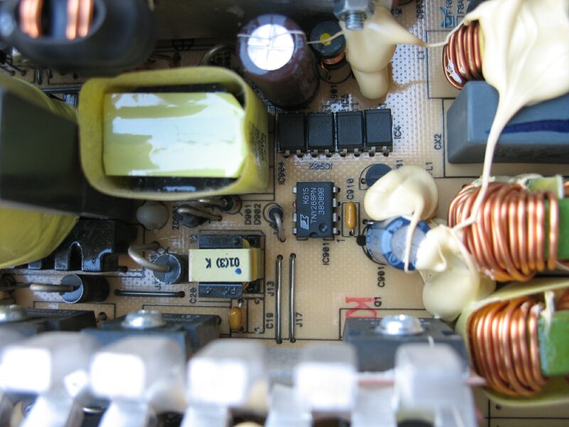

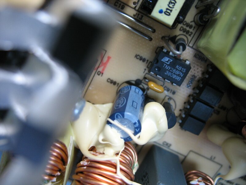

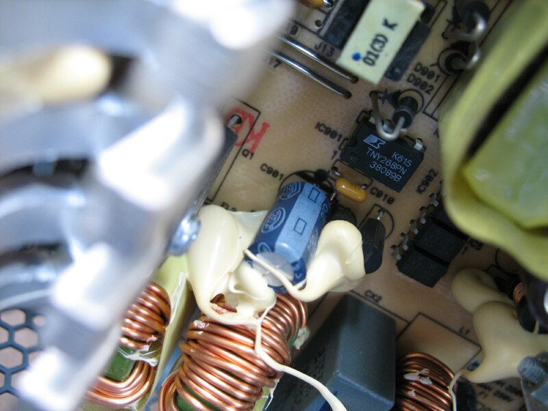

        • starfury1
          • May 2006
          • 1256
          cant see any other chip No.s
          heres a link TNY268PN chip here
          4 opto's by the looks of it ..interesting
          Cheers
