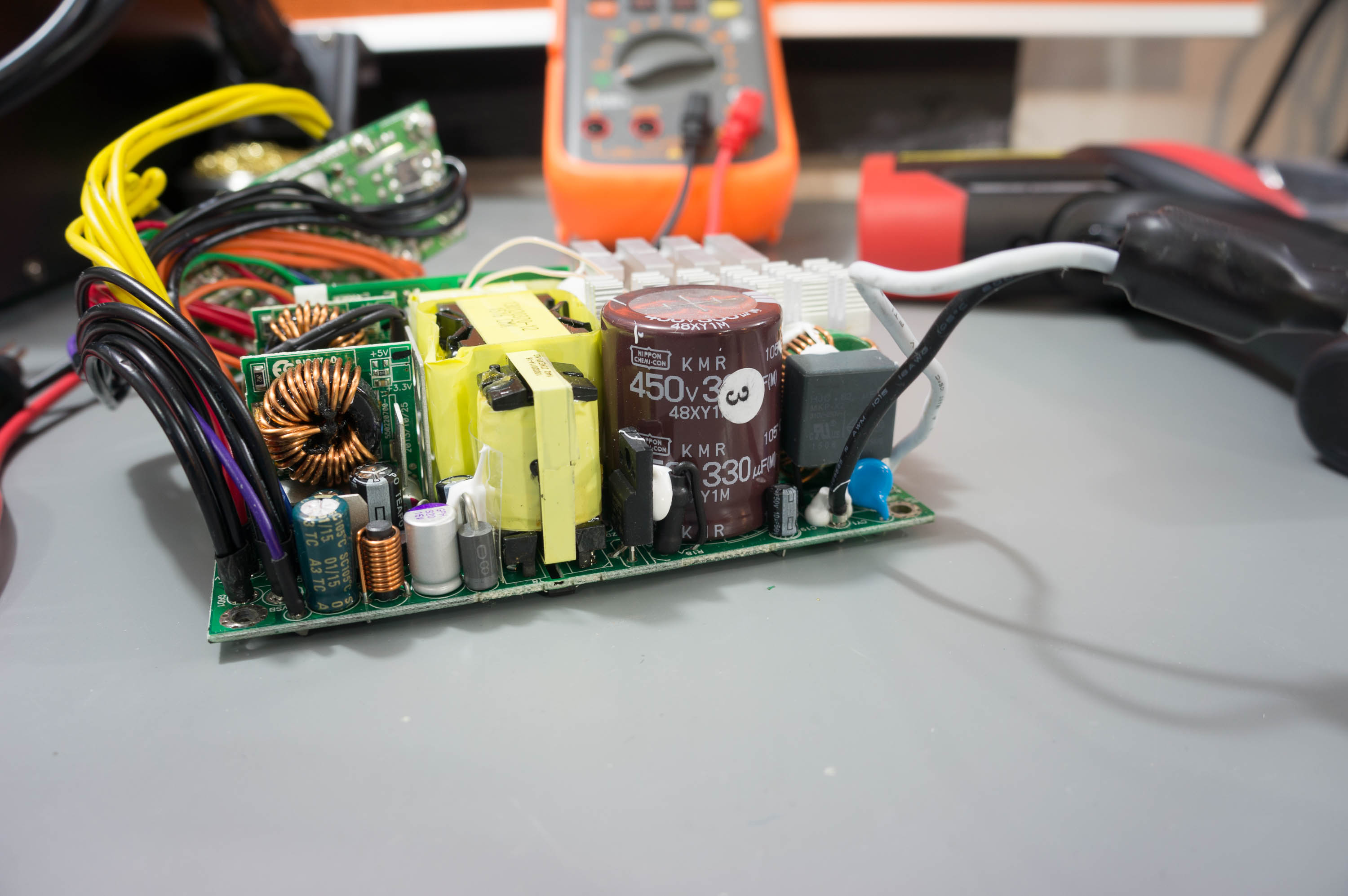

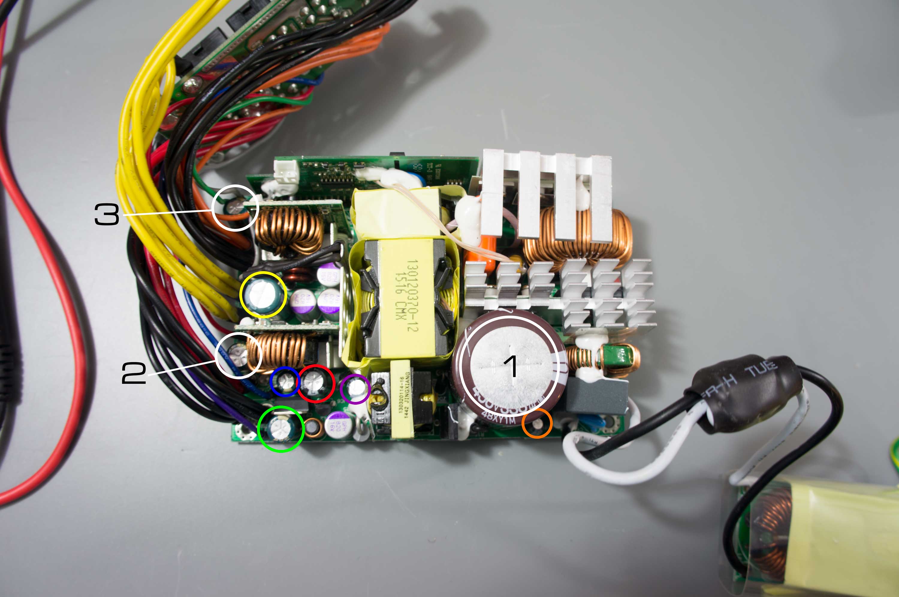

            I've attached some pictures that I took of the board. I've marked off what I believe to be the primary, and secondary caps. Here is what I have
            1. Primary Cap (White Circle)
            2. Secondary Cap (White Circle)
            3. Secondary Cap (White Circle)
            Beyond that there are a bunch of caps I'm unsure that I've marked in various colors to see if they could be identified, and if they should be replaced. Wish I knew this stuff better, but I'm still learning.
            Other Caps
            Yellow- ?
            Blue- ?
            Red- ?
            Green- ?
            Purple- ?
            Orange- ?
            Additionally there is the plug connection, with a small circuit board, and a couple x and y caps in it. This is seen in the lower left corner, but not opened up. Wasn't sure if I needed to do anything in there or not.

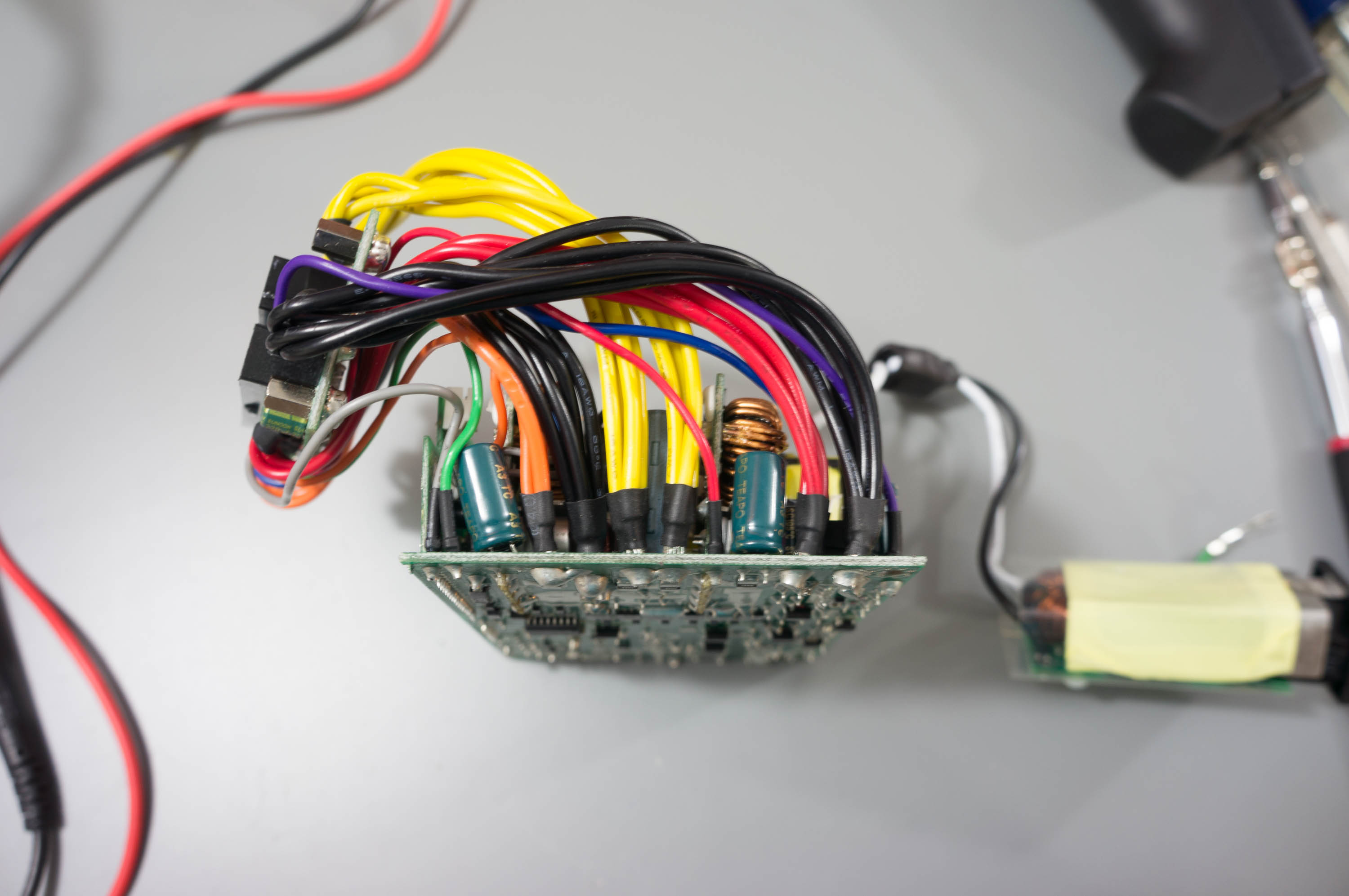

            There are some other pictures attached as well to give a better look at the various caps. Once they've been identified and I know which ones need to be replaced, I'll get the part numbers and ratings of them and post that info to narrow down what replacement caps to get.

              OK, this is different than about 3 reviews I have ckeched yesterday. The only good cap of those you circled is the big input one, that is Chemi-Con, you can leave that be. The rest seems to be Teapo, the green ones are SC series. Can you list their parameters (capacity, voltage, series)?

                Here is the information off the various caps on the board.
                [2]
                A3TC
                1500uf
                6.3v
                SC105c
                [3]
                A3TC
                1500uf
                6.3v
                SC105c
                [Yellow Circle]
                Taicon
                1425A(m)
                2200uf
                16v
                105c(pw)p
                [Blue Circle]
                A3TC
                2200uf
                16v
                SC105c
                [Red Circle]
                470uf
                25v
                SH105c
                [Green Circle]
                A3TC
                1500uf
                6.3v
                SC105c
                [Purple Circle]
                3M1508
                [Orange Circle]
                10uf
                50v
                SS105c
                The purple and orange circled capacitors are placed so that I could only read the numbers listed, the purple circled one (a little black cap) is partially covered in elastomer glue so I can only get one number off of it.
                With exception of the yellow circled capacitor being a Taicon, all the rest seem to be Teapo.

                  Yeah, three Teapo SC 1500/6.3, those will be for +3.3/+5 V rails. The SH 470/25 is for -12 V. SC 2200/16 and Taicon for +12 V.
                  SC is very obsolete low-ESR series but cheap so still used very often. The small SS is general purpose. Purple circle you will have to remove, that is only time code (possibly 8th of march 2015). Are you sure with the red and blue positions? There will be some caps of these parameters but the blue one seems to be 8x20 mm, too small for 2200/16. Maybe the other way around
                  I can supply you with replacements much cheaper than those big-ass distributors like digikey, but I do not have all types on stock, for example the shorter but wider caps. Usually there is room enough for caps as tall as 30 mms (or even more) in ordinary ATX units, so I always focus on diameter. How is it in this SFX unit? Is there room enough to go higher?

                        Okay, that all makes sense. Sounds like I should be replacing basically all the caps circled, with exception of the big Chemi-Con one?
                        I'll have to double check when I get home later the red and blue circles, it's possible I goofed them up in getting the information written down before work. I'll double check on those and let you know.
                        In terms of replacements and height, I would say there is some room for taller caps in places, the fan resides above most of the components, and the plug and inout board sit above the other portion of the board. I can take measurements and see what kind of height I have to work with and let you know.
                        I guess you'll know best in terms of what brand/series caps to recommend for replacements. I plan to push the PSU fairly hard at times, and want it to hold up to longer gaming sessions. The hardware it will be powering is a Intel 6700k and a GTX 980 Ti, both overclocked. So stability is very important.
                        I will double check on the red and blue positions, and I'll remove the purple circle as well to get the numbers off of it. Is there anything special in terms of tips or tricks as far as removal goes? I usually just heat up joint, remove the mechanical pin from the hole, use a solder sucker and some solder wick and remove the remaining solder, then clean the hole to make sure it's clean and clear.

                                    Just got home and went through and double checked the caps. You were right on the blue circle, I added an extra zero, it's 200uf, not 2200uf.
                                    Also was able to remove the white silicone from the purple circle cap and found it's a Rubycon YXF, 50v 47uf. So I assume that one can stay? I'll just need to re-silicone it.
                                    Here is an updated list of the caps

                                      Yeah Rubycon's OK. Whaddaya exactly want to do with that?
                                      Just have a look if there is room enough in the PSU itself, if it does not collide with something (fan for example).
