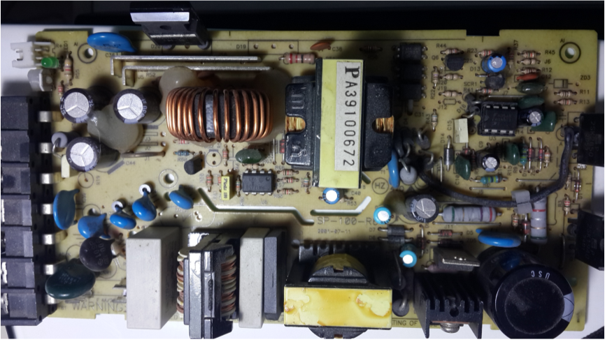

        Can you attach some photos of the PSU?
          Re: Meanwell SP-100-24

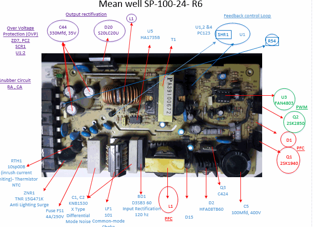

          I applied 20VAC, and tested the waveform on the filter CAP C5, show proper DC ... I checked the pin7 on the PWM shows shorted it should be the VCC.
          I tried to identify the components as much as I can as per the attached photo,
          but still I need more info identifying the following:
          1- Startup & run DC DC components.
          2- location of the B+ in the sampling circuit. F/B
          3- How to check the regulation circuit? & identify the sampling, error & feedback circuits.
          4- Identifying the protection circuit? SP, OVP is it only the PWM?
          5- PFC circuit ? only D1 & Q1?
          Regards,
          Hani
