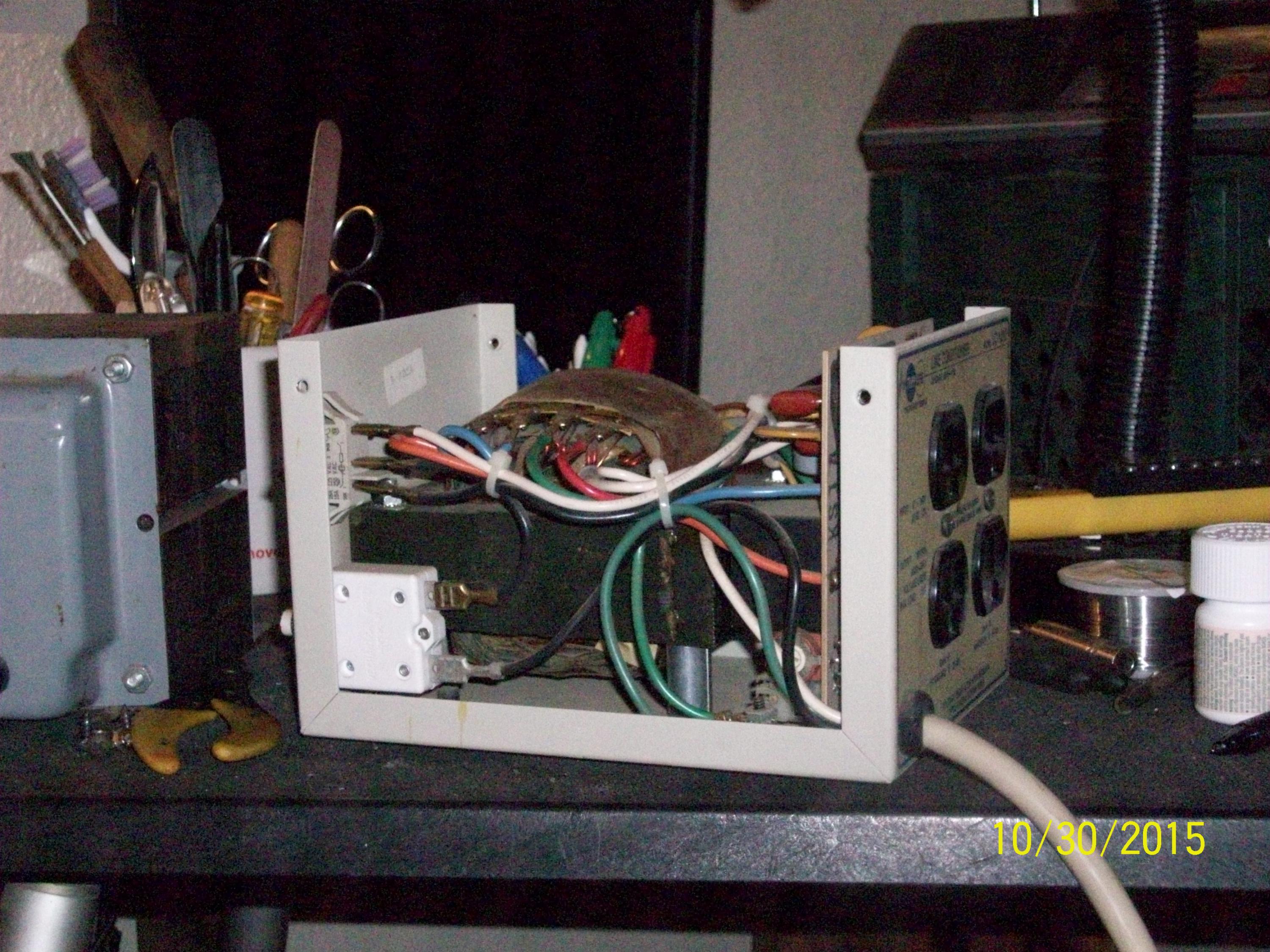

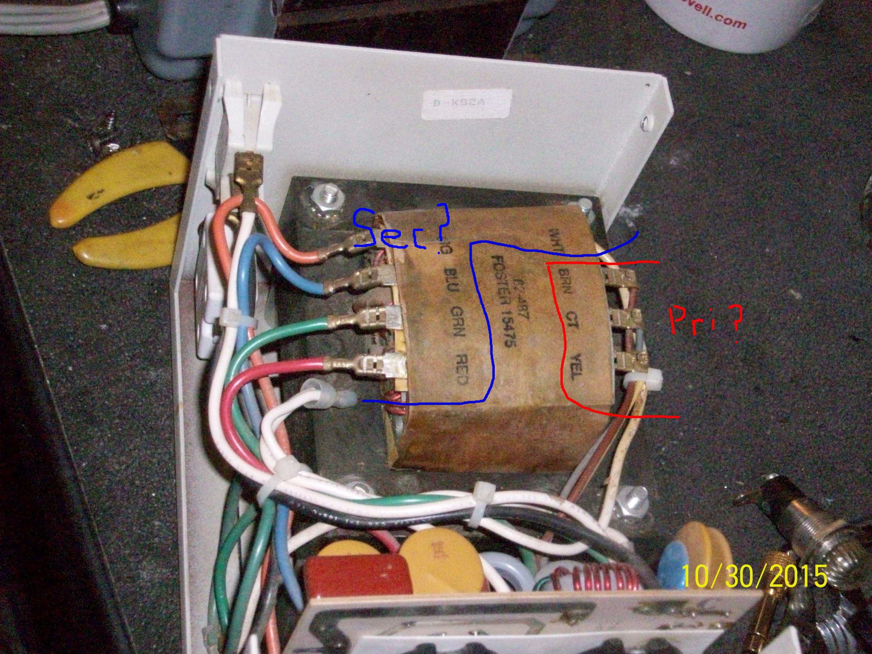

    Not a modern one. See attached pics. It's really not broken but I had to adjust the trimpot to get 120v output with a 120v input, it was switching down to 110v. Perhaps due to aging components. I can find no direct info on the unit as a whole or the transformer itself.
    I've checked the transformer voltages in operation and out of circuit with ohmmeter and determined there is a center-tapped primary and a secondary with four voltage taps in ten volt increments; 110v, 120v, 130v, 140v. In the transformer itself there is no continuity between primary and secondary windings but in circuit the input and output of the device share ac neutral. It has three relays, noise filters and a trimpot adjusting somehow I assume to be a power transistor(s) kicking the relays. I can only see one transistor from the sides.
    I am curious how this particular unit is designed, to the point of wanting to take it apart to find out. There are a couple of small electrolytic cans on the board I want to check anyway, it's old gear from the 90s.
    Trip light 2400 watt line conditioner bought used issue with low voltage oscillation going on between relays
    by sam_sam_sam
    I found two capacitors on the board and one of the leads on one capacitor had bad soldering joint and the other joint connections not much better and there were several soldering joints that way to much flux around the joint redid several of them
    The capacitors were a non brand that I did not recognize they got replaced and now it does not oscillating between relay but what concerns me a little bit is when the voltage is a little bit low the output voltage is around 130 volts and then drops down to 115 volts this happens around 105 to 108 volts if remember correctly
