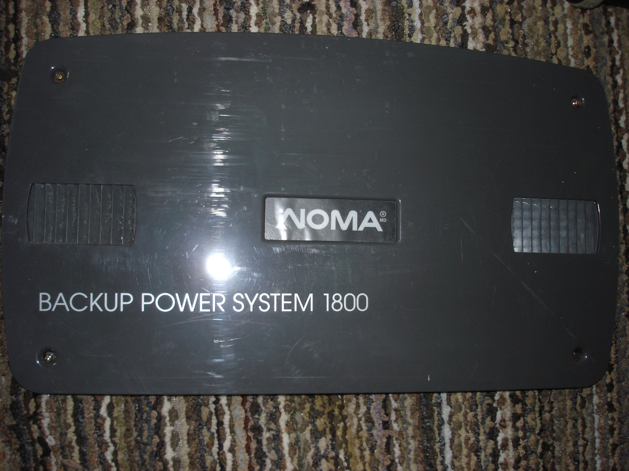

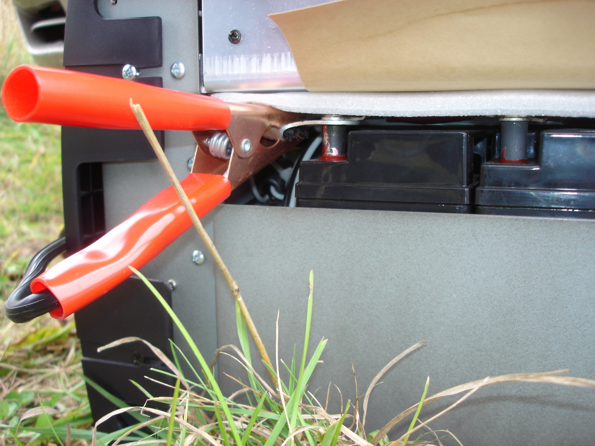

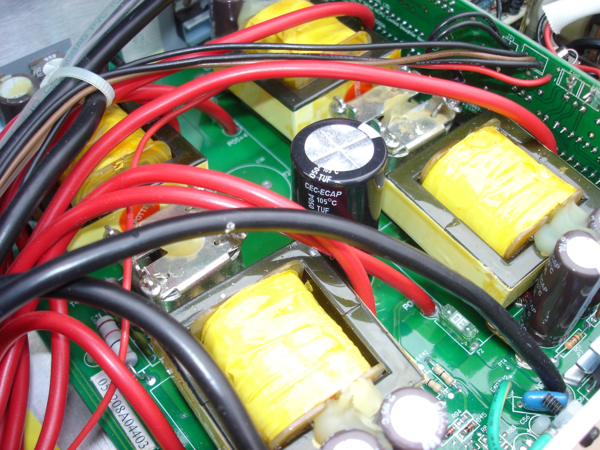

    Hi there, thanks for the great advice in these forums. I'm hoping to find a bit of specific advice on a Noma-branded Xantrex Powersource 1800 battery backup.
    It's an old unit, with maybe 10yrs service as a sump pump backup, so the batteries inside are not holding a charge anymore, but it does still supply non-sine AC power when connected with booster cables to a running automobile's red battery terminal and engine block.
    It is rated 1800W continuous and 3600W peak, but it is cutting out with an overload error (E03) with even just a 900W space heater or 1/2hp water jet pump plugged in by itself.

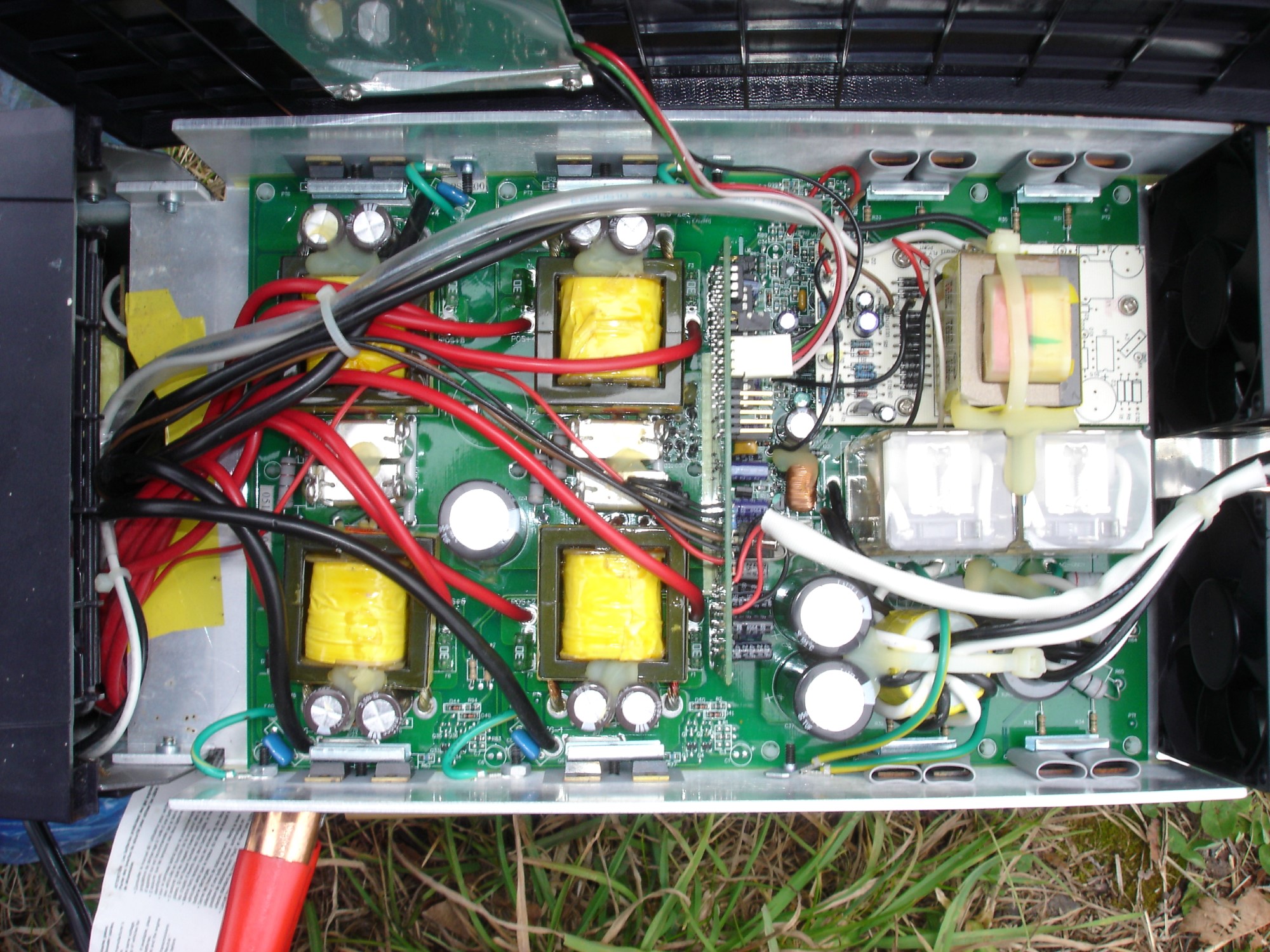

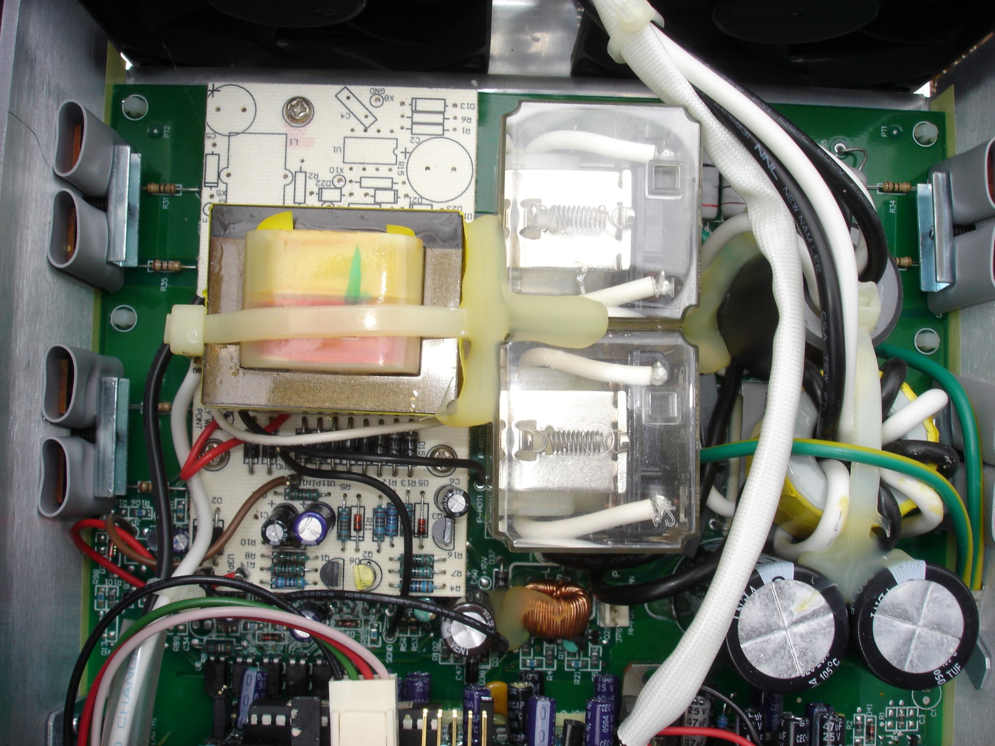

    None of the components on the circuit board seem to show any signs of physical damage or burn marks, and all eight 30amp fuses look ok.
    It might possibly have received a shock when a tree in the backyard was hit by lightning while it was in the basement, unsure on that.
    Here are a few pics of the setup and circuit board.
    There are reports online of this Powersource unit having transformer problems.
    Can these components be DIY repaired or otherwise jury rigged for a quick fix?
    I only have a basic digital multimeter for testing, and am learning as I go what can be tested for what.
    Thanks for any advice that will get this unit running strongly again, it'd be great if it could power the oil furnace too!

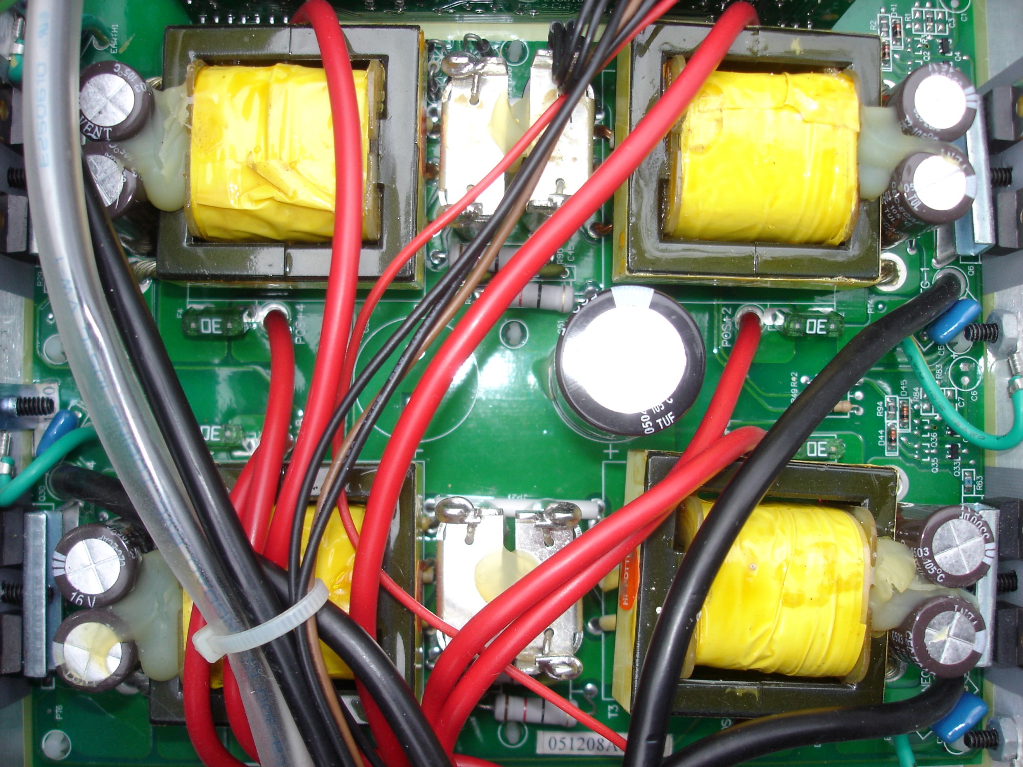

      could be dry caps.
      i would replace all the small ones wih panasonic FR,
      i wouldnt just replace the large ones because they are expensive - i would desolder and test them with an esr & capacitance meter.

          With ESR/capacitance meter.
          You may get any of low-ESR caps, Chemi-Con, Rubycon, Nichicon. Panasonic is usually overpriced, NCC is among the cheaper ones.
          Running any motor on non-sinewave source is just wrong.

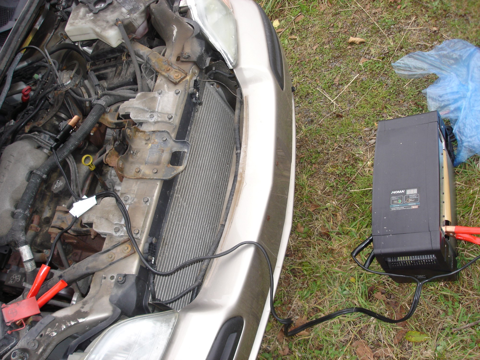

                  With the booster cables attached and the car running the battery reads 13.5V.
                  Once disconnected, it drops to 0.1.
                  As soon as the 900W is connected there is an overload error.
                  I'll have to check again to see if there is a visible voltage drop before the unit shuts off.
                  Thanks!

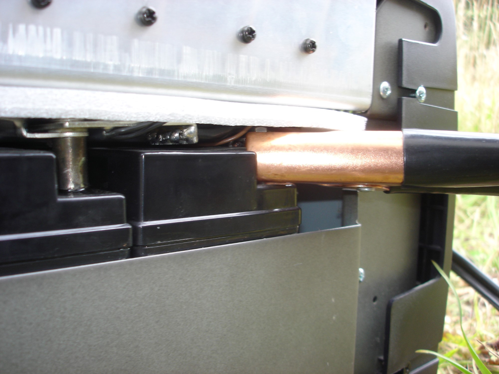

                        I believe that the poor contacts and small diameter wires you are connecting to your 12VDC source are insufficient for your load. You need some heavy cabling for this, heavy and short as possible with solid contacts
                        For a 900W load you would be pulling 75A at 12V f the inverter were 100% efficient, which it is not. Probably need closer to 100A...your toy jumper cables just aren't going to do that mate. And that is assuming that your vehicle alternator can make that, which I doubt.

                          Hi Thanks for your messages.
                          Yes, the batteries seem to be dead, understandable since they are 10 years old.
                          Yesterday, tried plugging in the 900W heater with voltmeter attached and watched it drop from 13.5 to about 10.3 before overload cutoff.
                          Today, tried it again (in light rain) and -Surprise!- the heater ran without overloading the box. Didn't get the volt reading though - will try again later.
                          Thanks again.

                            recommend you stop playing like this, you risk overloading your vehicle alternator or melting those little jumpers
                            this inverter requires a serious source of 12V for large loads
                            I think the inverter is fine, you need to invest in a way to feed it.

                              Tried retesting the 900w heater, dropped from 13.7 volts to 10.7 then cut out.
                              Checked the 10yr old batteries after an hour on the car and they measured 5.5 volts.
                              Thanks!

                                The Owner's Guide specifies a "low battery shutdown" voltage of 10.5 V (nominal).

                                  That is interesting. Seems to indicate that the unit is operating normally then?
                                  Not sure how to reconcile that with it's claims of handling 1800W continuous.
                                  The built in terminal cables don't seem that much more substantial than my booster cables (but much shorter obviously).
                                  Perhaps that's the limiting factor?

                                      Yes OP, the length of the wires is very much a factor when trying to move very high currents like this, as is the contact area of the actual connections.
                                      The good news is that your inverter is very probably just fine, you just need to build a solid, dedicated battery bank to power it.
