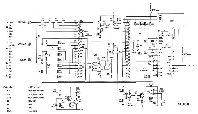

                                  For the scientific interest I've done some tests with a cheap multimeter on a couple PSUs while running comps.
                                  1) With MM set on AC 200V, red probe on yellow wire (+12V) and black probe on black wire (ground), it displays ~26.1V AC idling, ~25.2V AC full load.
                                  2) With MM set on AC 200V, red probe on black wire (ground) and black probe on yellow wire (+12V), it always displays 0.00V AC, no variation.
                                  • modemhead
                                    Lurking
                                    • Jun 2012
                                    • 52
                                    Re: AC Adapter problem.
                                    Cheap multimeters are DC-coupled on the ACV ranges (ie. they have no DC-blocking capacitor). They also have a single diode rectifier for AC-to-DC conversion. The reading is scaled to display 2.2 times the average of this half-wave rectified signal, which for a sine wave, would approximate the RMS voltage.
                                    Because of this design: 1) cheap multimeters are not useful for measuring very low AC voltage because the rectifier forward voltage drop begins to create significant error below say 10V or so. And 2) they definitely will not accurately measure AC voltage in the presence of a DC offset.
                                      "2) With MM set on AC 200V, red probe on black wire (ground) and black probe on yellow wire (+12V), it always displays 0.00V AC, no variation." That is due to the single diode as mention above. Cheap meter, that is all.
                                      I.E. D1 in the diagram of MASTECHS METER MAS830.
                                        Thanks, there goes down in flames my "poor man's scope" . Was worth the try, you always learn from failures.
