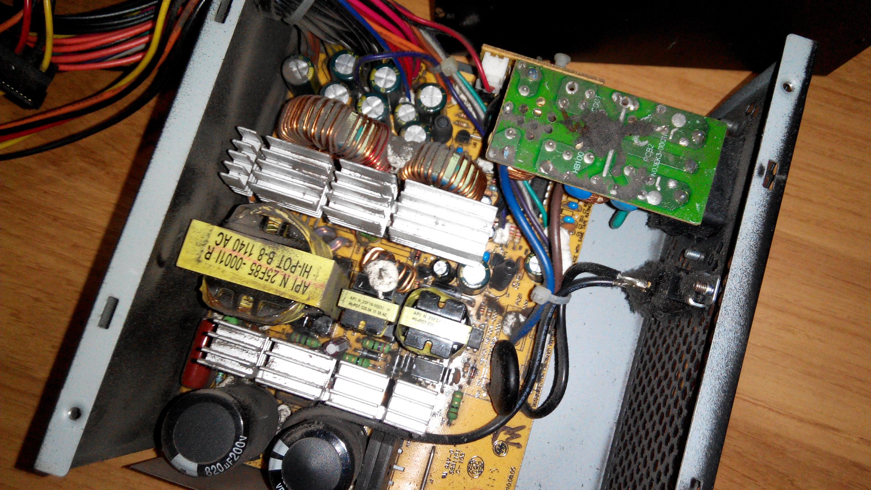

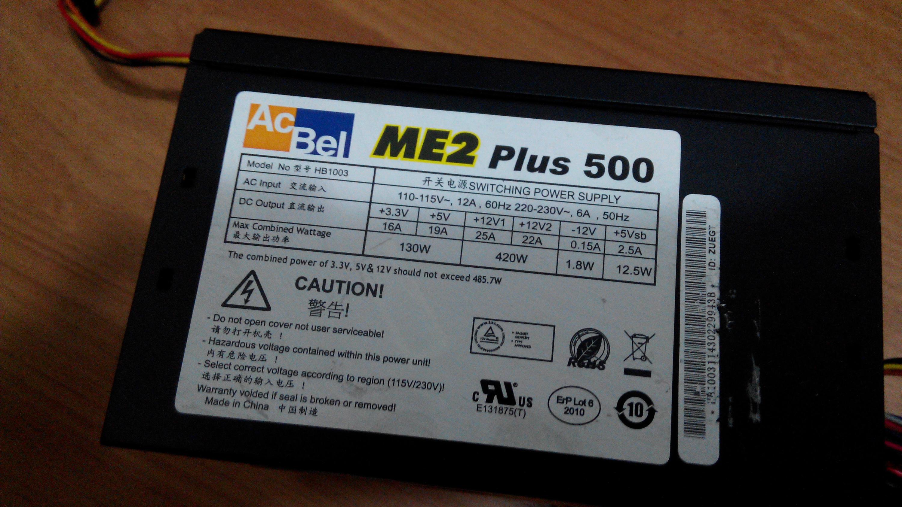

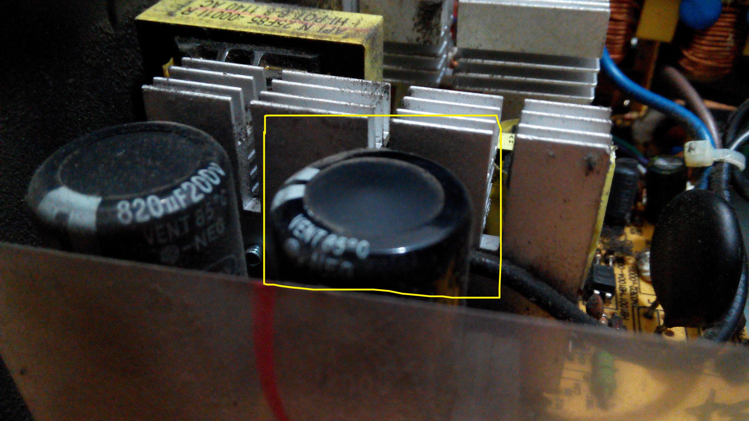

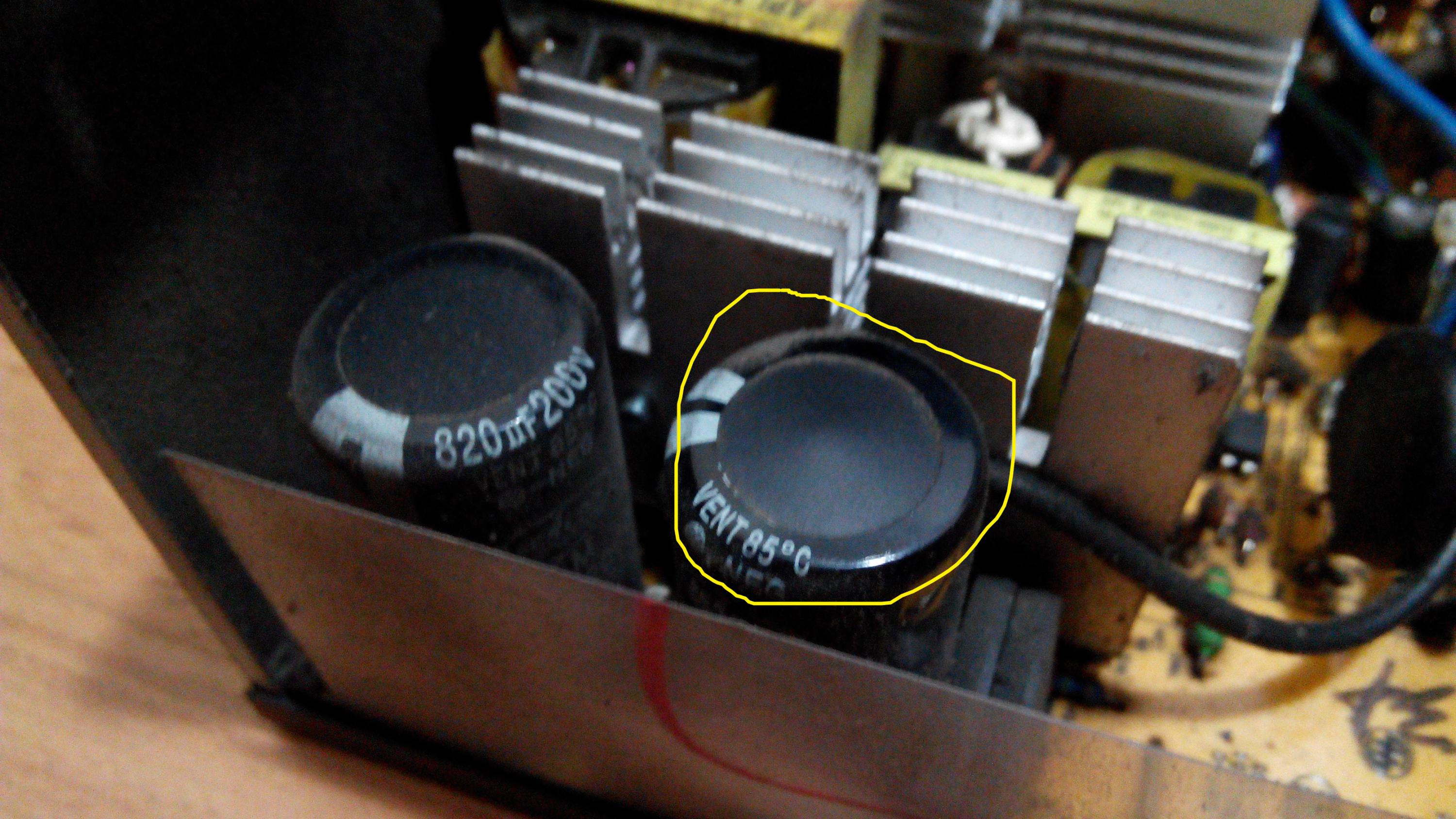

    I salvage this PSU from a working dell server, found a big 200v filtering cap was bulging. What is the recommended type/brand/series of caps for replacement ? I am kinda afraid sooner or later that cap would blow up on me, I seen it happened to my friend on a cheap PSU, it literally smoke then it "Pop". Other than that, other caps are in good shape based on visual inspection.
    Thanks in advance

    You need to check the dimensions of the capacitors if we are to be able to make any recommendations
    Also post the brand and model of the capacitors.
    P.S: Sometimes only the plastic top is bulging, you can push down on it to feel if the actual capacitor is bulging or if it's only the plastic...

        This one seems it is bulging too much - definitelly cap problem.
        As always, I'd replace all caps while at it, the rest will fail too.
