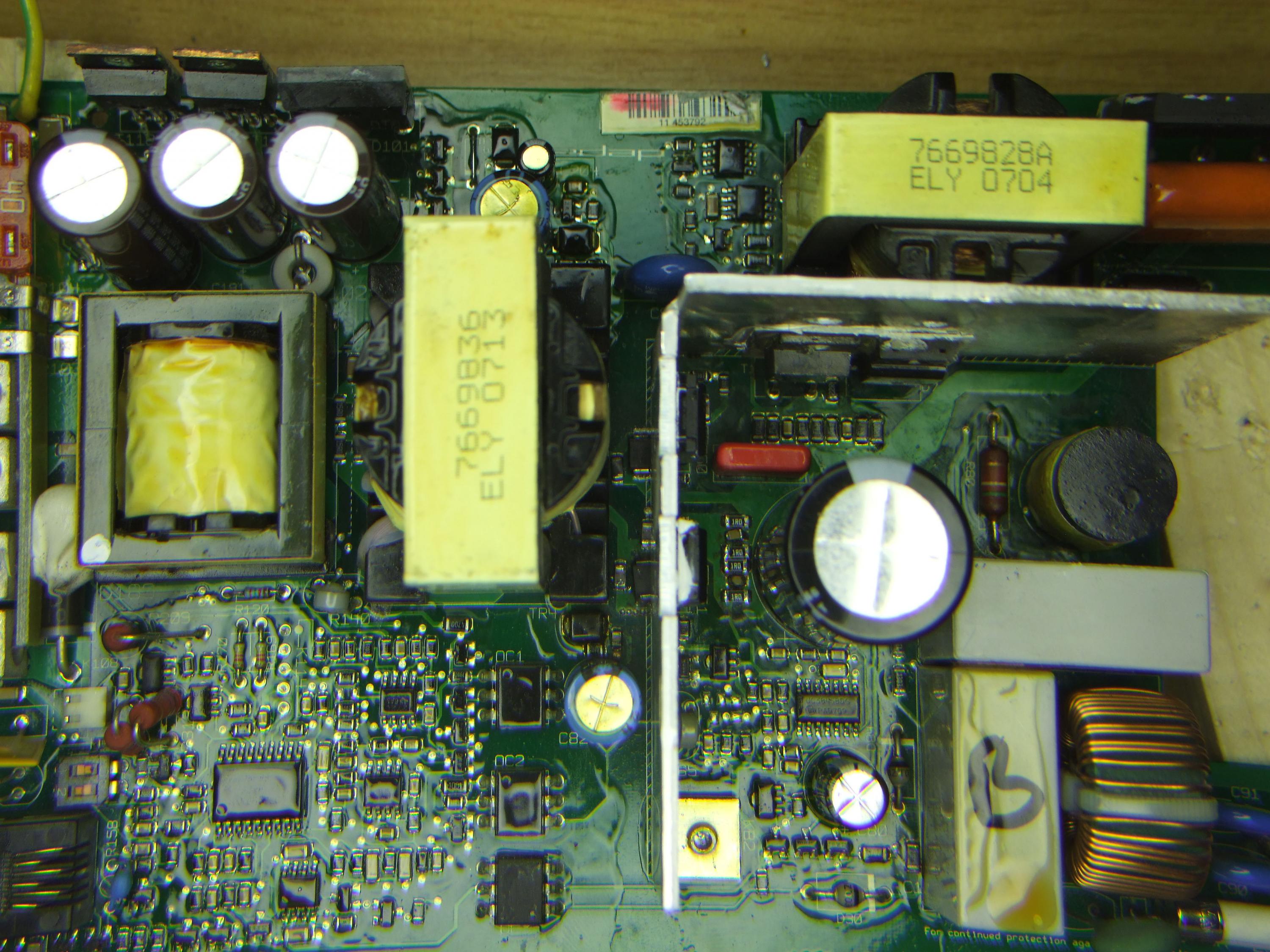

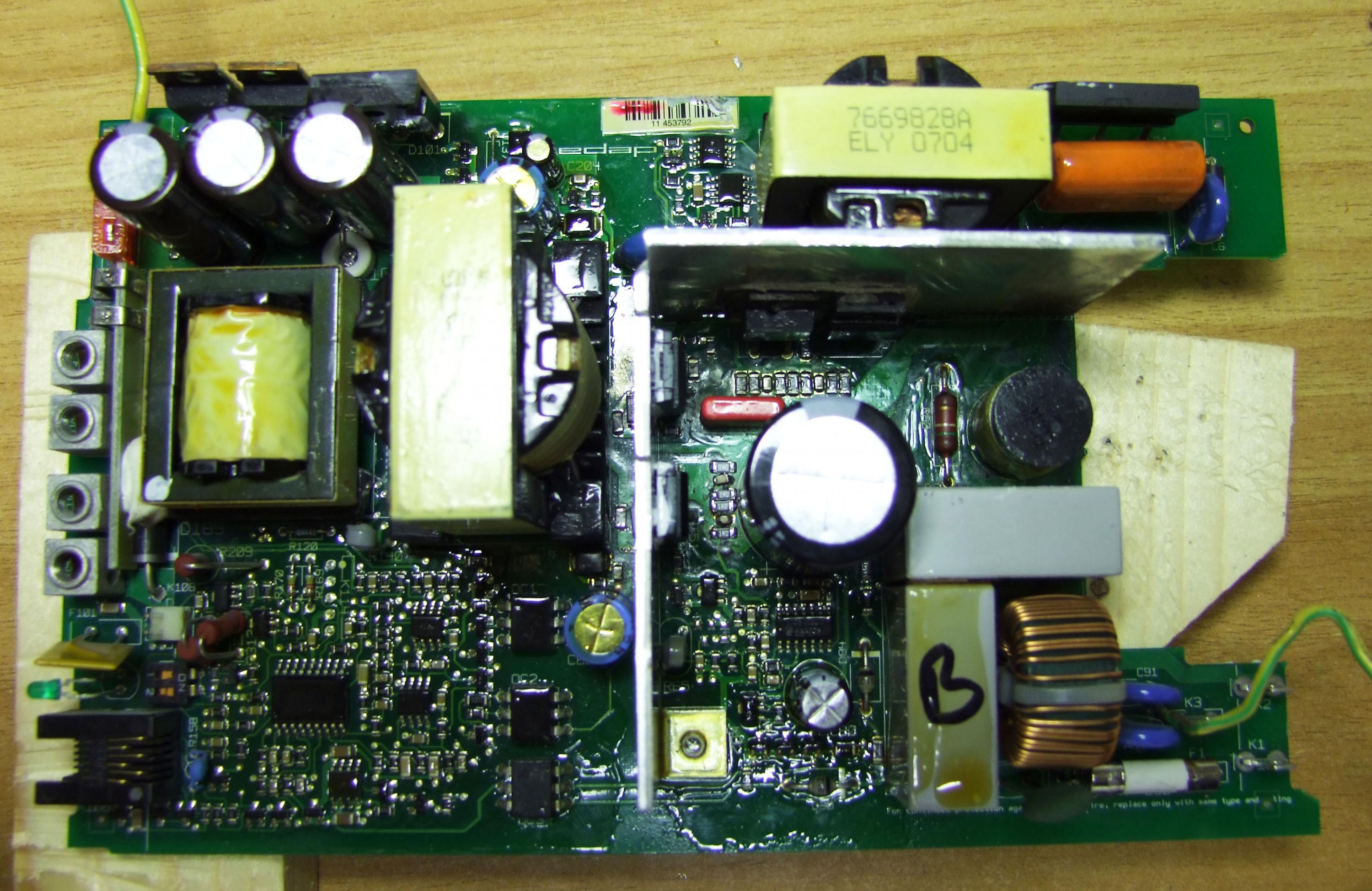

    I have this charger where the fuse was blown. I found one of the two main power fets shorted as well one of the smd diodes beneath the heatsink (STP9NK50ZFP and MURS160T3G).
    I connected a lamp at the fuse and switched on the power to see that the lamp is pulsating. Upon further inspection i noticed four 1R smd diodes open so i replaced those as well. The charger still does the same thing.
    Output on bridge rectifier is pulsating from 295V to 305V.
    VCC on power IC (UC3845) is 8V steady, although according to datasheet it should be around 32V or 15V and above in order to get started.
    I am not sure if the diode i installed is in correct direction as i did not note it before removing and there was no print under it...
    Those two powerfets are interconnected..
    If i reverse the smd diode and is in wrong direction afterwards will that kill more components??
    I am totally stuck! Any suggestions greatly appreciated!

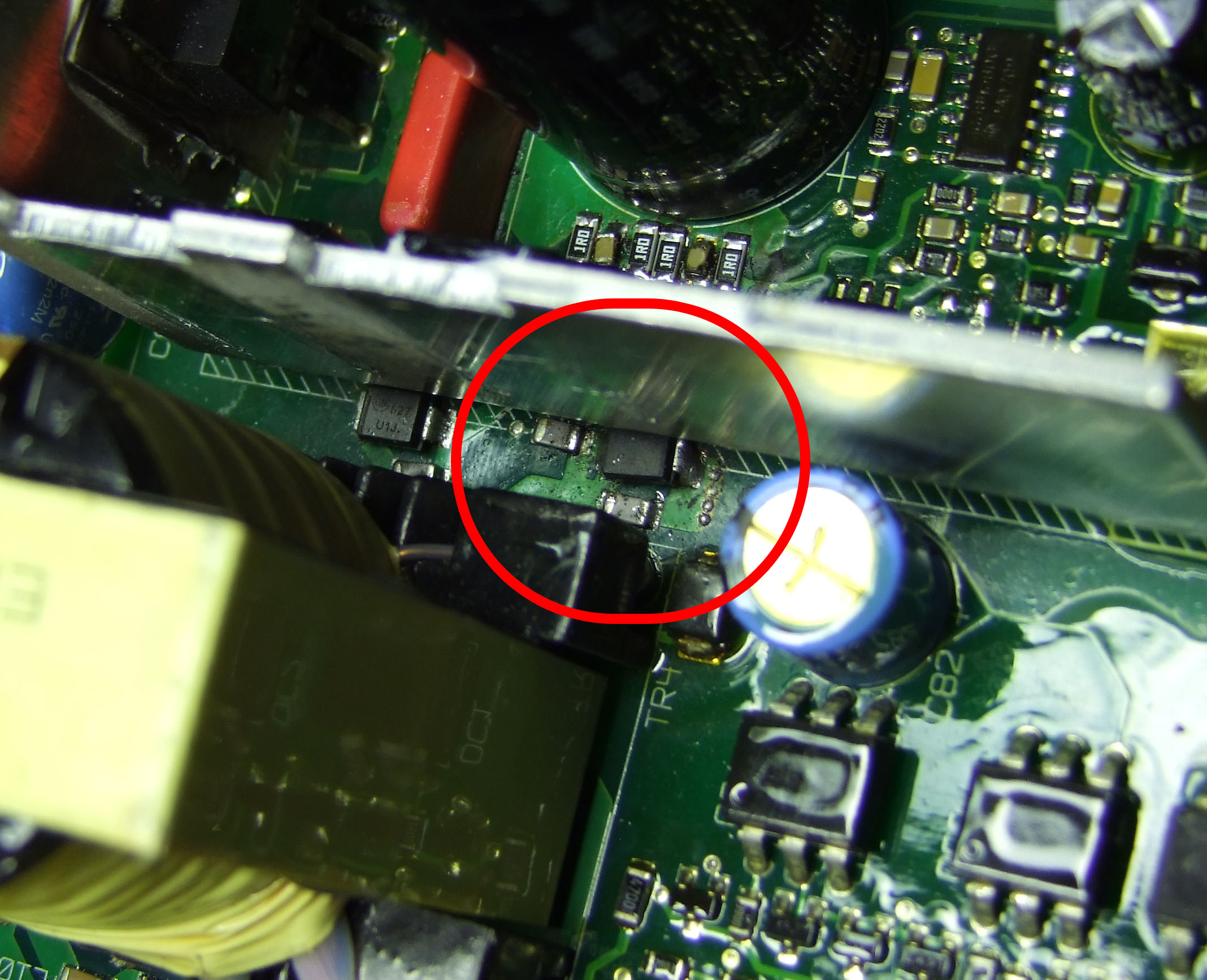

      Re: MasterVolt IVO 12/25-3 Marine charger - replaced power fet but now pulsating

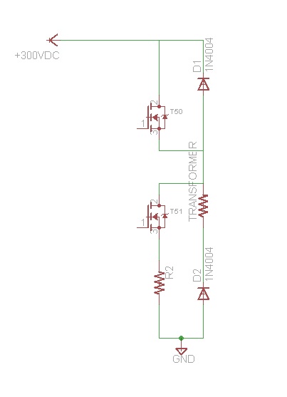

      Yes that is the case for this charger as well. However, according to manual, there is a switch for float charge, that when on the charger can be used as a power supply.
      At the moment kathode sides on both diodes are facing towards the outer board.
      I am trying to make a small schematic of how the fets and diodes are connected....

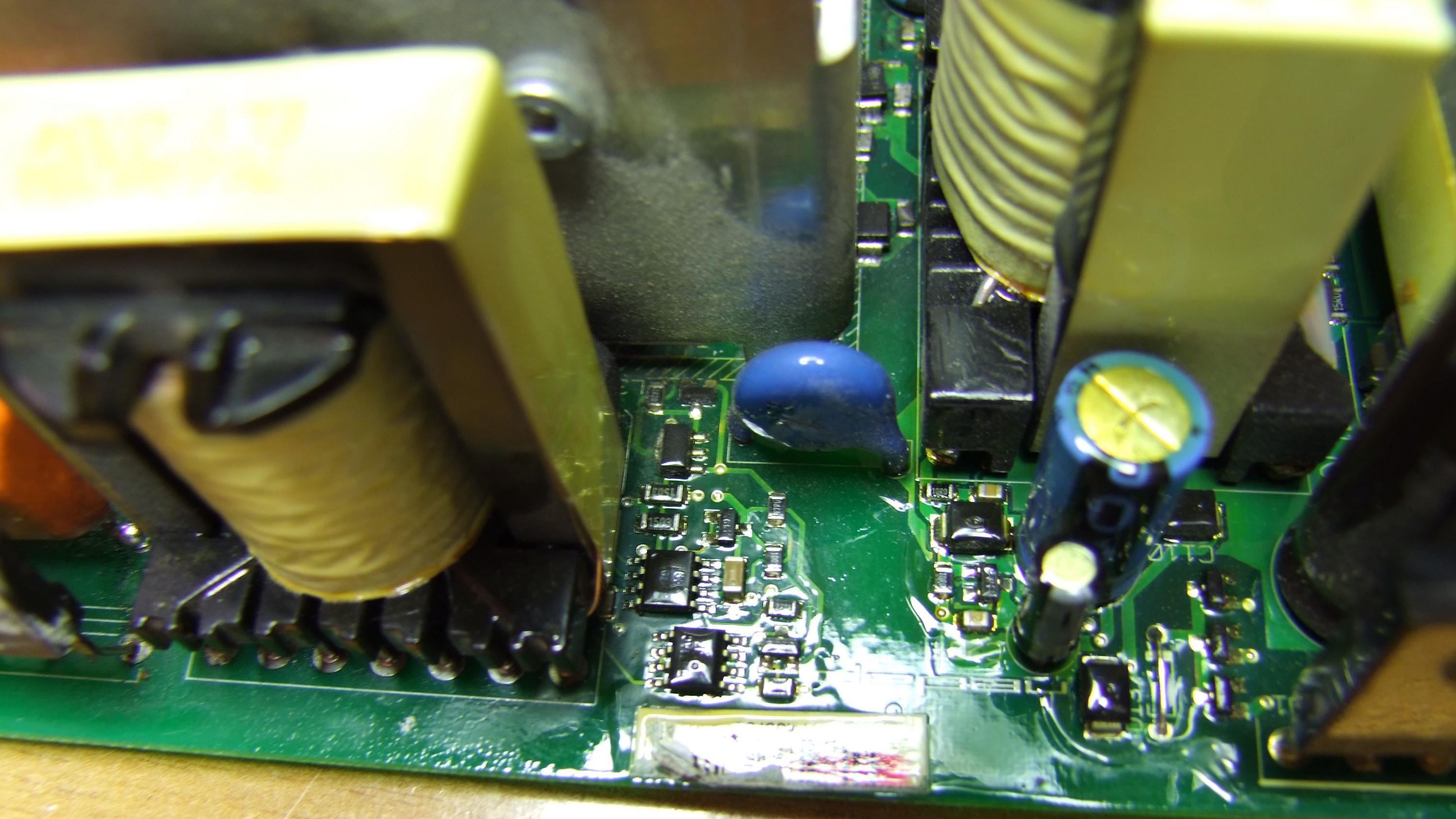

        i am "almost" positive that this is how they are connected...
          Is the positive leg of that cap to the right of the SMD diode connected to one of the Diode leg? or see where the right pad of the diode is connected to, it should go to a filter cap some where.
          • sententia
            • Oct 2013
            • 269
            • Greece
            The right pad of the diode in circle is connected to the main filter capacitor thus getting 300v.
            If you mean the blue c82 cap, it does show a connection with the anode of the diode on the left with 2kr resistance...

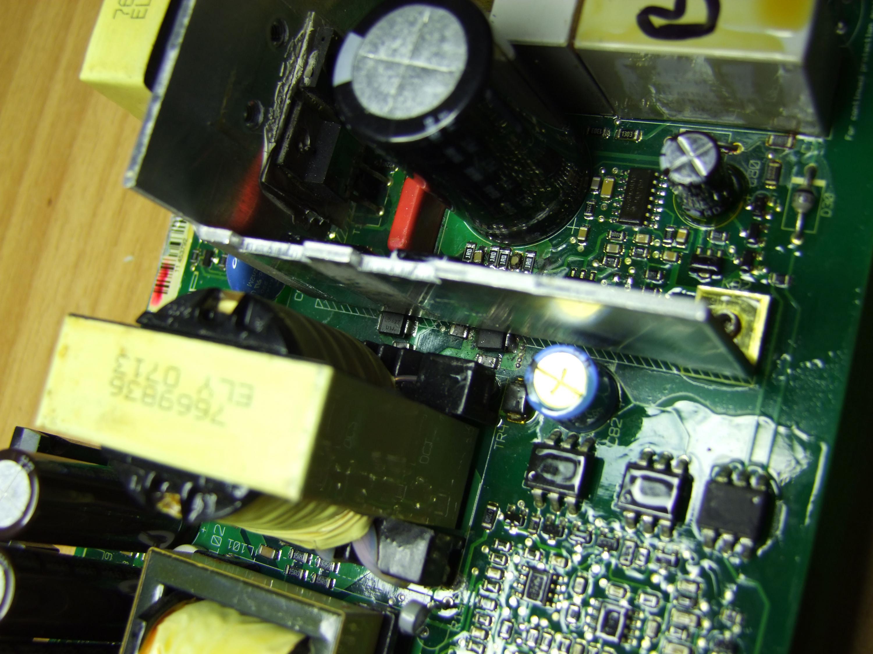

              Is it possible that the original diode is one of these? https://en.wikipedia.org/wiki/Transi...pression_diode

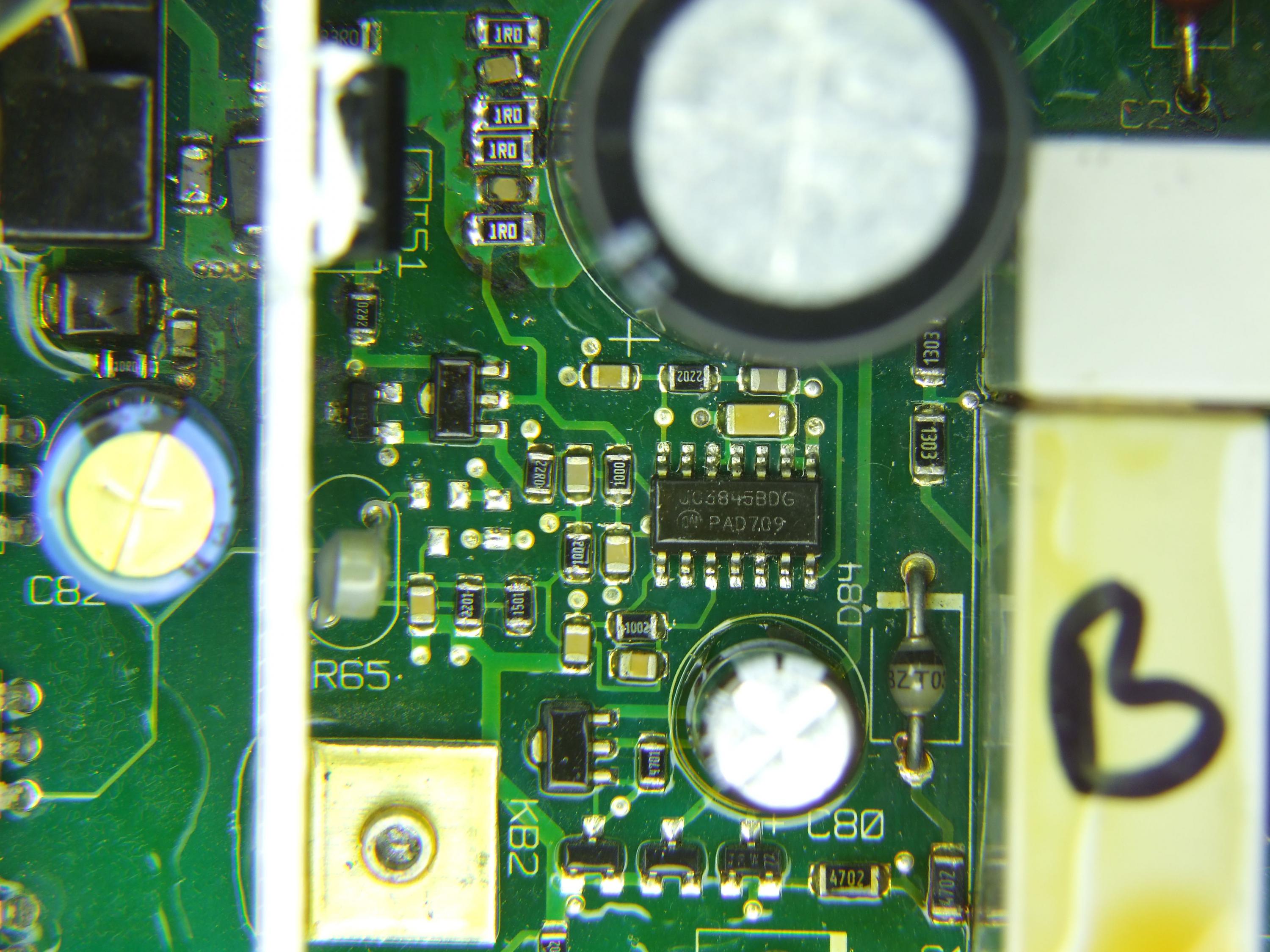

                This power supply has PFC Voltage booster, you can see the PFC inductor ELY0704, and next to it are the POWER MOSFET and the PFC Diode mounted on the heatsink.
                So the DCV on that main filter rated at 450VDC should have steady >360VDC on the filter cap if the booster circuit is working.
                BTW, so the Main power MOSFETs and the Diode you replaced are the one that drive the power transformer? If the MOSFET had shorted between the Drain and Gate , then for sure the IC that drive the MOSFET will be damaged, including the Gate drive R/D network.
                  Rievax the diode was replaced with exactly the same part number so it is definitely a diode.
                  Budm,
                  You observation is spot on!!!
                  There is a booster circuit running on a TDA4863-2 and the other so8 is a TL431.
                  The mosfet is indeed the one driving the transformer and was shorted gate-drain. 4X 1R resistors where burnt as well as was a 2R2 on the other mosftet.
                  The main filter capacitor is 400V 220uf rating and not 450V! It measures a bit lower at 198uf but i doubt this is causing the problem.
                  So do you think the main power ic UC3845B would get damaged?? There is definitely not enough VCC to run it at 8V.

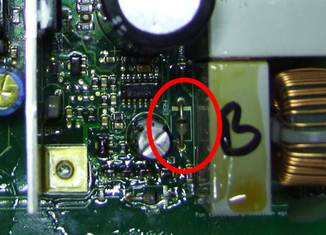

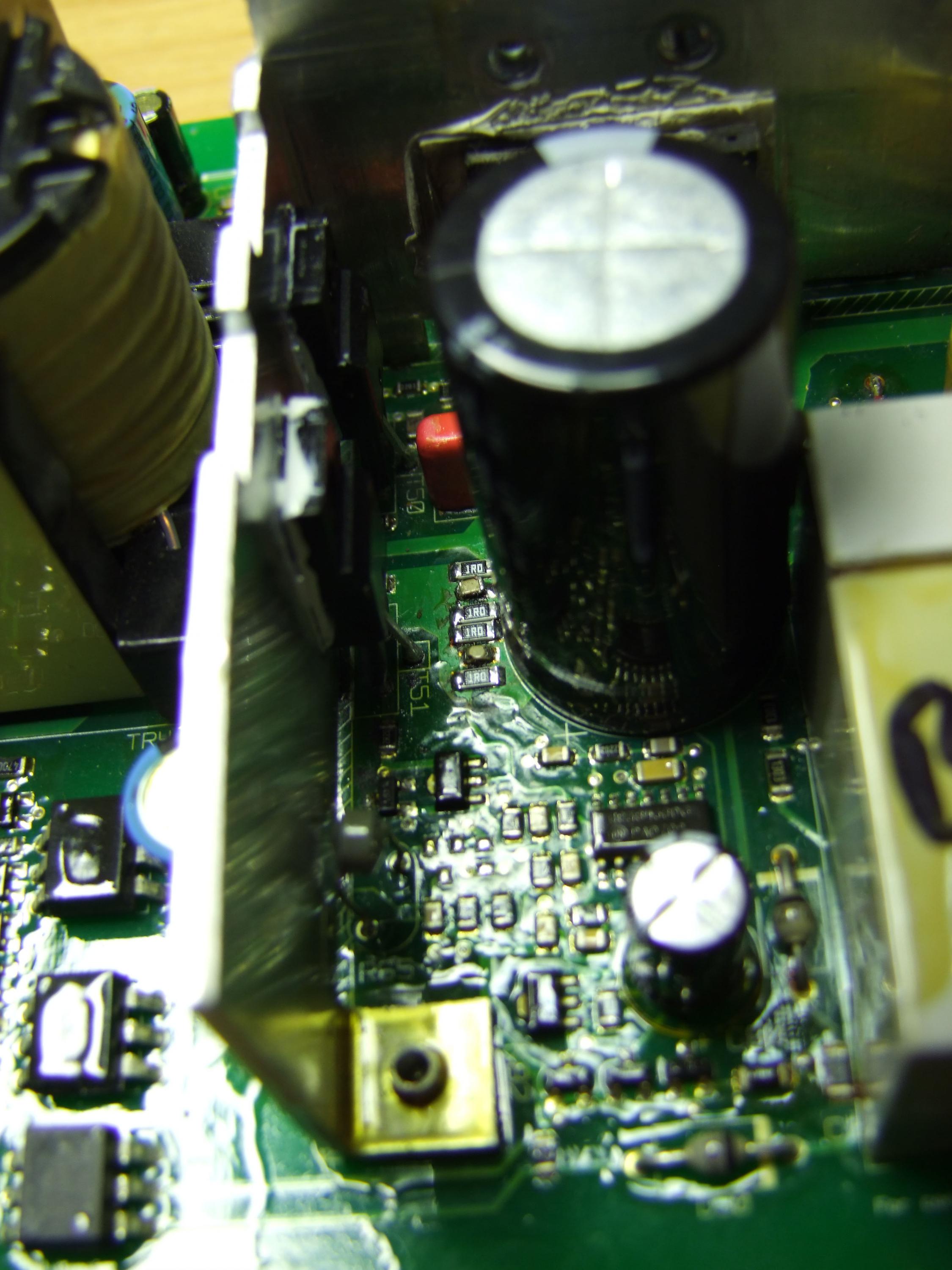

                  Another observation is that i measure on the red circled zener diode D84 208V on its legs that might have to do with the VCC supply of the power IC.
                  Many thanks for the help!!

                      Current sense pin 5 of power IC connects through the 100R resistor to source (check image).
                      Resistor is good. The 4X 1R resistors forced current to go through there maybe??
                      I am still concerned about the voltage measurement of D84 zener diode. I cannot see the voltage of the diode but if i measure 200V there doesn't that mean that the zener is not conducting? As a diode it measures ok.

                          Please check previous post with D84 zener which shows 200V on its terminals.
                          It connect through a 150K resistor straight to + of bridge rectifier and i think it might be part of the power IC supply. Is it possible that it is not conducting?
