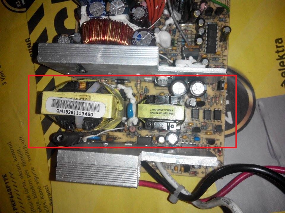

    Hi all
    I repaired an dell psu model H280P-01 which was dead i replaced some 10v capacitors and the power supply its fixed but when i power on the psu i hear a buzzing sound coming from this two transformers.Is this sound normal or not.Thank you.
  • ReeceyBurger123
    Never Give Up !
    • May 2014
    • 7325
    • Britain
    Re: Buzzing Sound coming from transformers
    How loud is the buzzing is it abnormally loud ?
    Normally the ac switching frequency noise that passes through the transformers is slightly audible but shouldn't be too loud. If its very loud it could indicate a short on the secondary side of the psu.
    • R_J
      • Jun 2012
      • 9582
      Yes they make noise, some louder than others, a loose winding or core lamination can even sound louder. If the supplies are working I would say they are ok and normal.
      • ben7
        Capaholic
        • Jan 2011
        • 4059
        Might want to check the capacitors in the PFC circuit (if it has one), it might be 120 or 100Hz noise you hear. It might also be normal no-load (or light load) oscillations.
        -Ben
        Muh-soggy-knee
        • ITSYSTEMSALBANIA
          • Mar 2015
          • 37
          • Albania
          The psu makes the buzzing sound when no load is connected when i conect a load the buzzing sound stops.Thank you all for your replies.
          • ben7
            Capaholic
            • Jan 2011
            • 4059
            Yep it's because of the very light (almost none) load. The power supply does provide a slight load for it's internal circuitry, but that's only a few watts at most.
            It basically ends up skipping pulses, hence you get a sound that humans can hear.
            You can add some minimum-load resistors if it bothers you.
            -Ben
