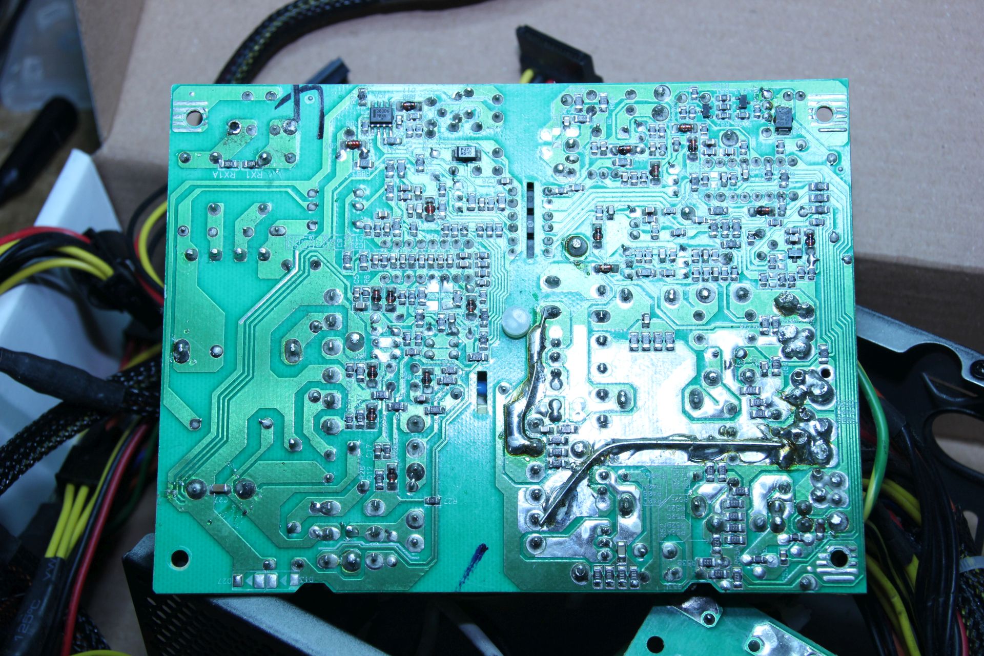

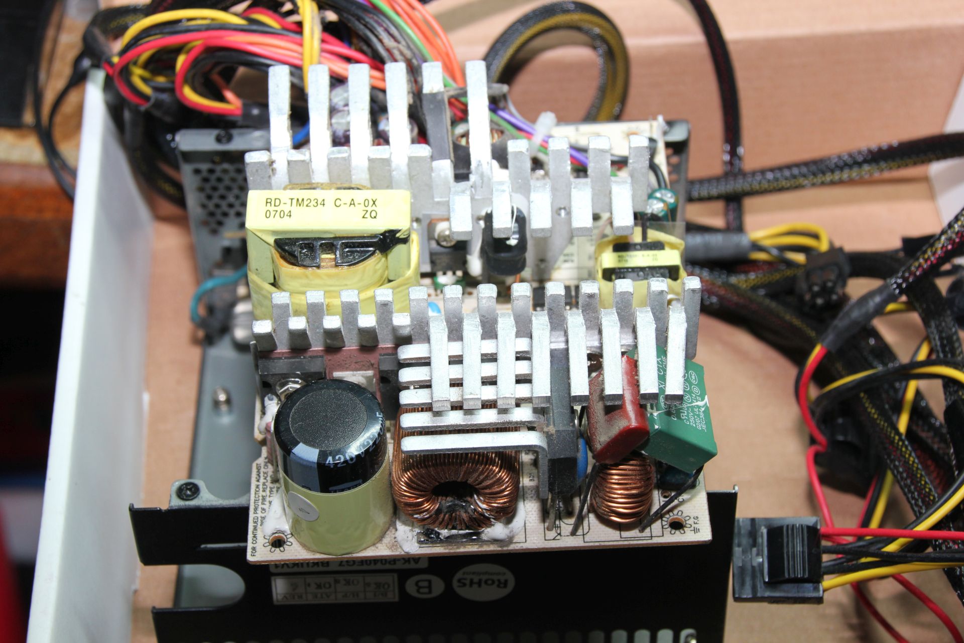

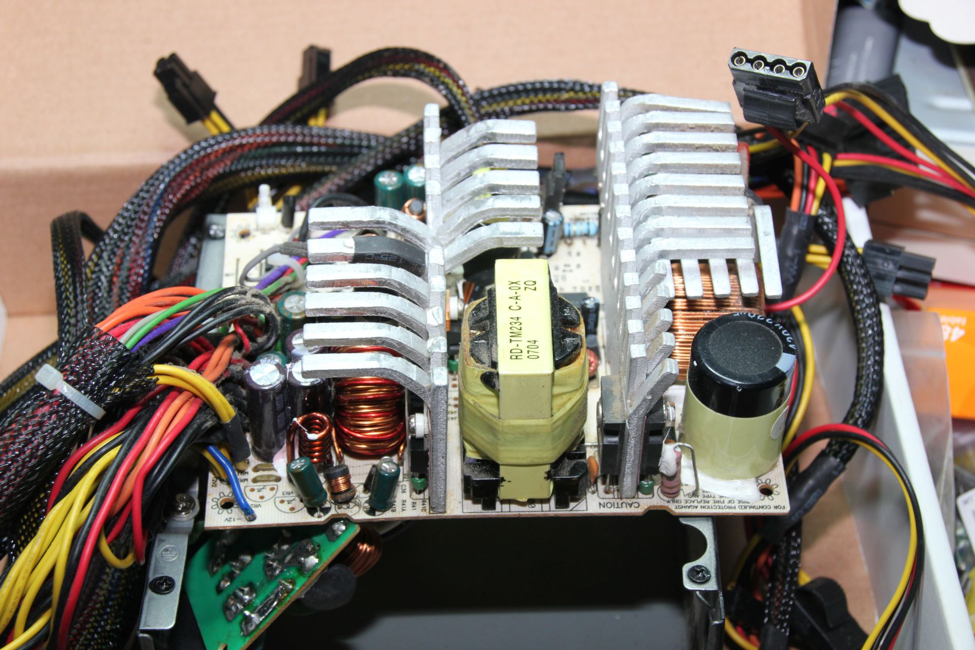

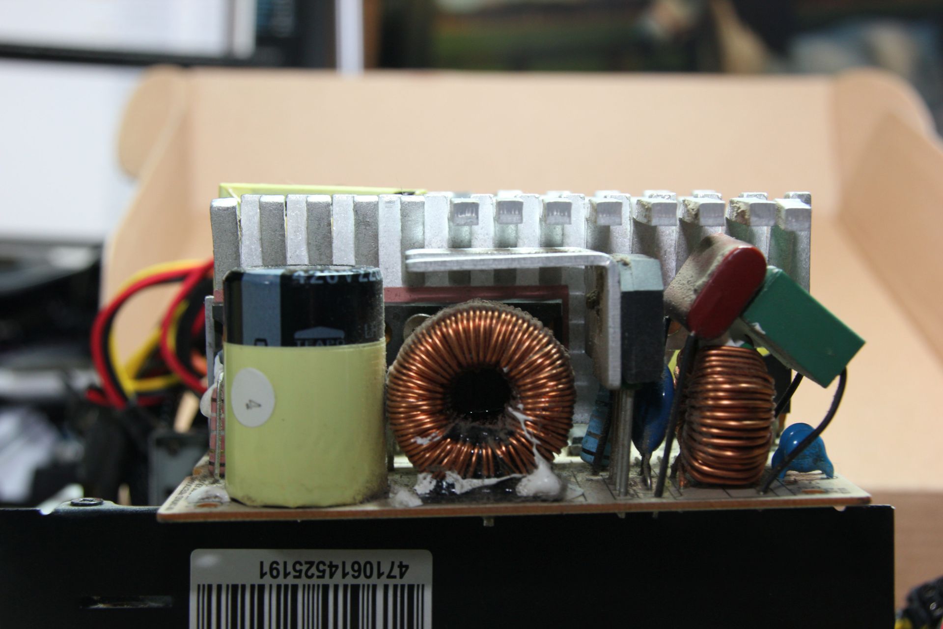

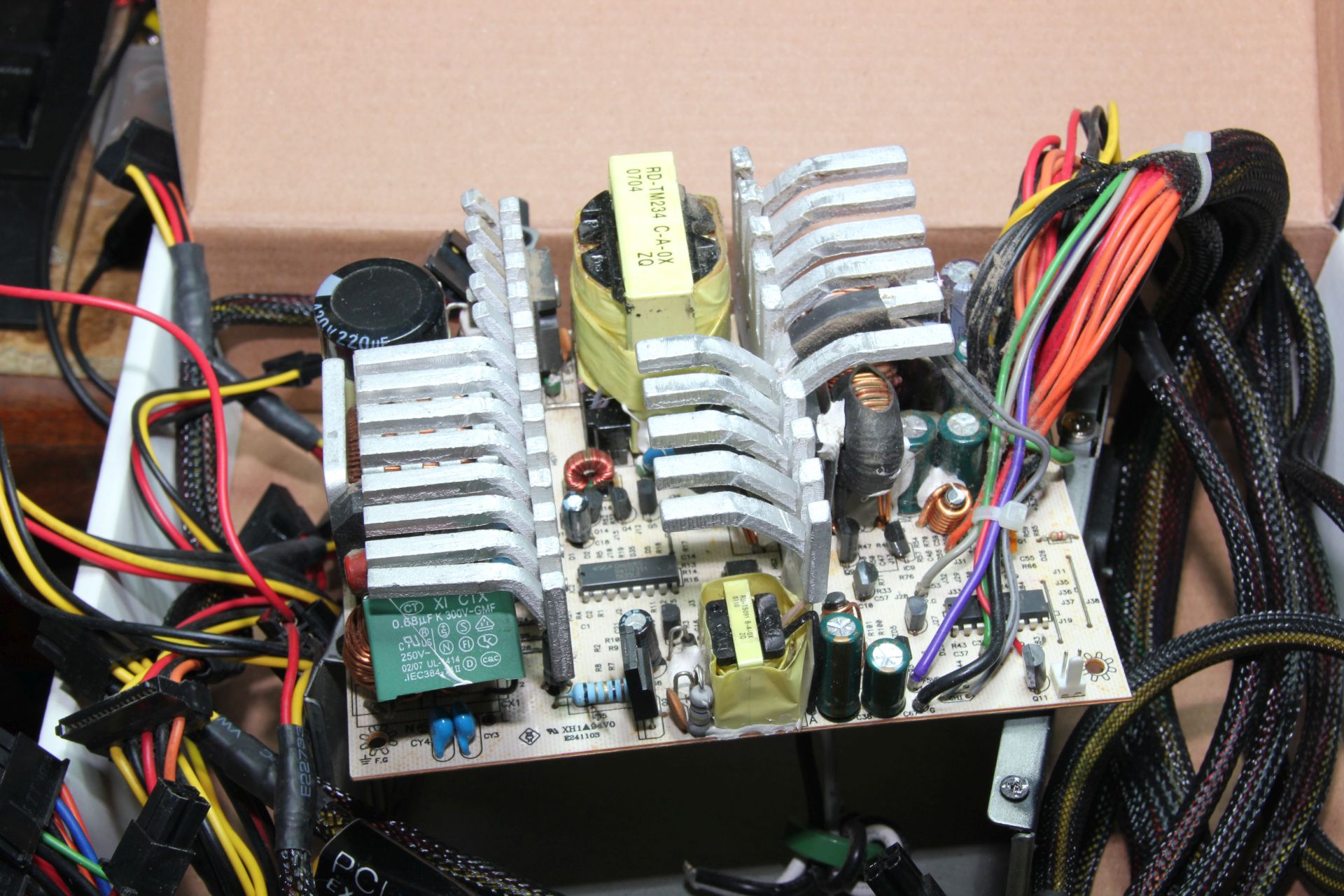

I've an Akasa branded PSU (AK-P040FG7, 400W ATX 12v with PFC) I'd like to revive, but it's currently deader than a dead thing.
Was installed in an old system I was given, about 2006 vintage, which had been stored in a stable for a while (without horse). On switch on, video display was showing digital noise, and then was interesting spark from rear of PSU and system shut down. Usual checks proved PSU had died (trial with replacement PSU showed that the system was ok). There was a lot of dust on the video card surface, so I wonder if slight dampness was causing shorting and a) caused the video artefacts and b) shorted/loaded the card power circuit and thus the PSU.

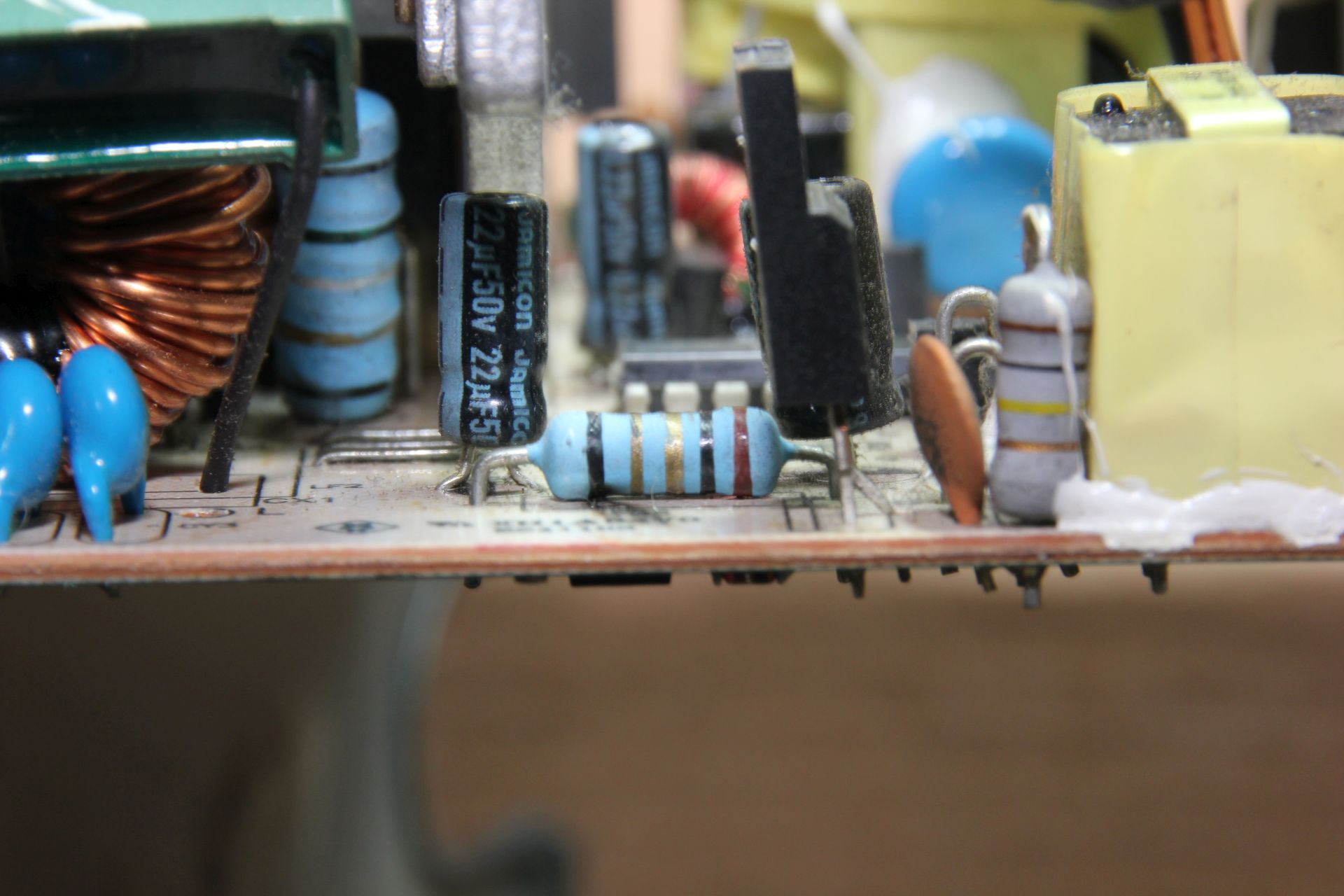

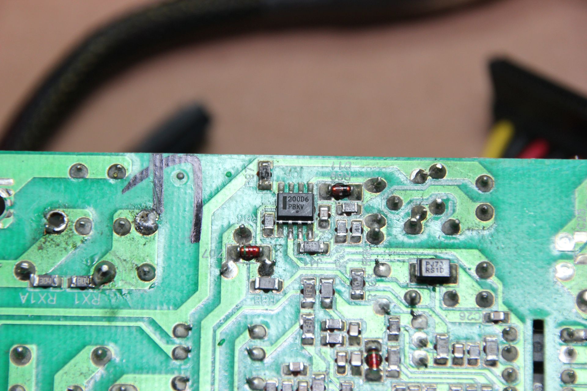

Digging into the dead PSU found an obvious burn by a ceramic (fuse?) resistor (R95, I think) and a not so obvious burned out SMS resistor (R97) on the track side. No 5vsb, though fans on a connected mobo will twitch when power button is first pressed. No obvious bad caps, but I only eyeballed so far.
I have found that these Akasa supplies were badged "Enhance" units, but not much more than that. I hope that replacing the resistor and SMS resistor will bring some sort of life back so I can check outputs. What I need are values for them - the ceramic res should be easy for anyone who had normal colour vision (guess who hasn't :P ), but the sms device is a bit trickier. Suggestions please people
Pics attached, some overall views and then closeups of the ex-resistors.
