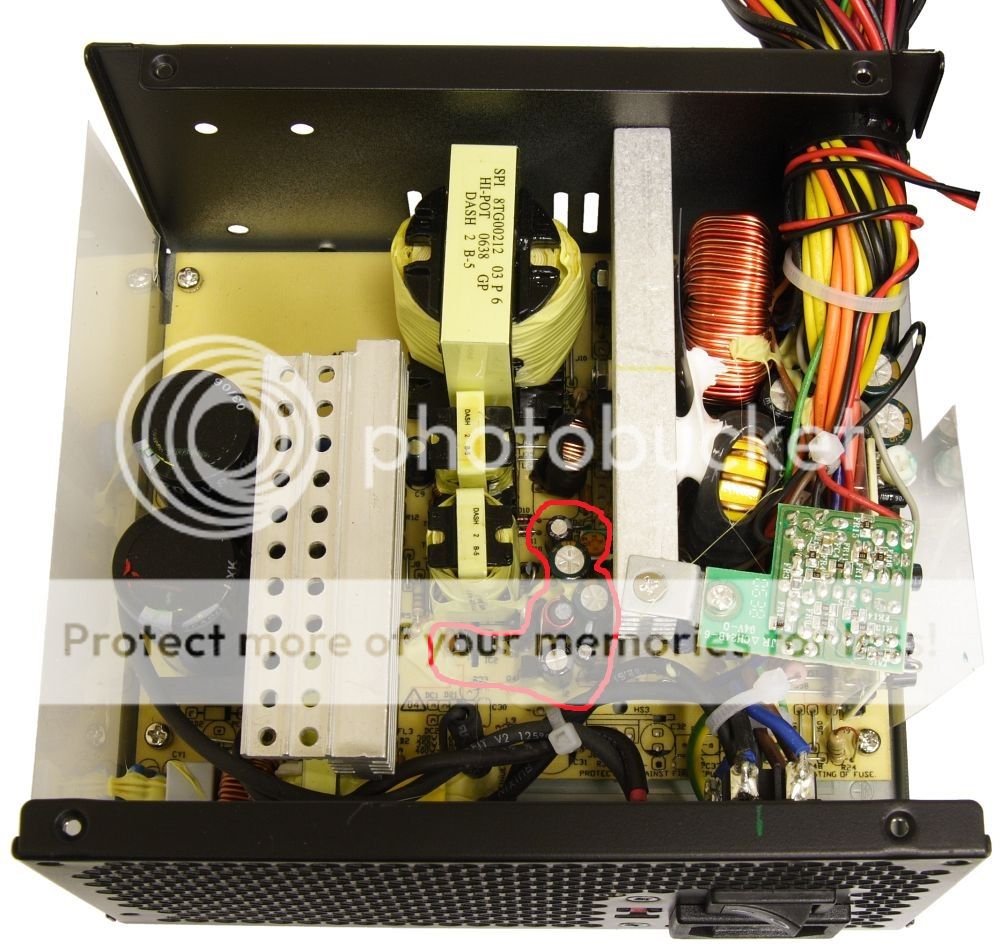

3) Enlight 500watt APFC with dead PFC IC.
the third psu is old enlight psu, model pps-500-204d, delta design with apfc.

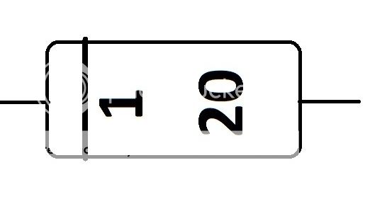

dead psu, then i found one of zener diode in pfc modul shorted.
i pulled it, and found marking code 1 20 like the illustration below.
Without the zener, suddenly that enlight can running, except rather low in all rails (12v => 11.1v, 5v => 4.2v etc)
at my first taught, this is maybe 20v zener diode..
so i replace it with 20v 500mw zener diode..
but it can't working with the replacement..
then i found the other zener from my box with marking 2-15.
the stupid of me, i put that zener in pfc module, and switch the power supply on, and pufff..spark from the ucc3818n pfc ic.
I tried to replace it with CM6800 but not working.
So i wonder, what is the specs of zener diode with 1-20 marking code?
and, about cross reference of ucc3818 pfc ic...can i replace it with other ic..?
