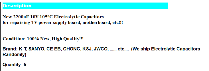

    Problem: I opened her up yesterday and pulled out the PSU. Low and behold, there are 3 obviously bad electrolytic caps. Im not sure what part of the circuitry it controls, but it must be causing something because when I plug it in and try to test voltage, i get 0vdc everywhere. So, im goanna start there. I already cleaned off the electrolytic material (not thinking I would post here) but I marked them with a red sharpie. I ordered 3 new replacements from Ebay for $3.80 that should work great and have a slightly higher voltage rating, same capacitance though.
    http://www.ebay.com/itm/231172679183...%3AMEBIDX%3AIT
    I will update when I get the new caps in and start my install!

      Yes, replace the 5VSB caps if they're anything but Japanese. Unfortunately, those TWBOR PSR caps also don't have very good ripple current ratings compared to CapXon GL. And it doesn't list impedance, so it could be significantly higher. I guess if you've already ordered those caps on eBay then you can at least use them to see if the unit works after replacing the caps, and then you can order good quality caps for it.
      Also, the 3 caps that did fail that we can see are on the 3.3V and 5V output filtering. After the unit is verified working, I would also highly recommend replacing any of the other CapXon caps and the Ltec LZG(?) on the 12V filtering.

        Well, nevermind. It looks like they "randomly" ship caps....that's terrible! You don't even know what you'll get!

            Not to mention it is 5 caps for almost $4, so that brings them just about on par (price-wise) with Japanese caps.
            But yes, those caps should at least be good enough for a test. If it does work, pull those new crappy caps out and get real Japanese caps... and stay clear of eBay for that, because 99.99% of the caps there are counterfeit.

              Yeah Sanyo and Chong, it's them same for sure

                  UPDATE: well, i got my caps in today. They wound up being fcon brand. Tested then with my meter and all were within spec, though varied between 2.24mF and 2.43mF. I used the closest ones.
                  Got them installed pretty easily. I didn't replace the 4th one that someone reccommended because i was lacking energy (work kept me over night last night).
                  She fired right up! I'm letting it sit for a few hours to op test it. Hopefully those cheap caps hold up for a little bit. Who knows, i didn't lose much if they do fail. But, I'm going to have to shut it down for the night because we have bad weather rolling in and i dont want to tempt fate with her yet.
