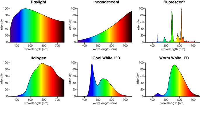

        Re: Power supply for LED light box (for photography).
        In photography, I have mixed results using white LED's. Usually not the greatest. Their spectrum is "peaky" compared to incandescent lamps and correcting white-balance in Photoshop doesn't work for me, it's impossible.
        Try any white LED lamps first with your camera and editor before spending the big bucks. Warm white seems better but pure-white looks to the eye better.

                        Then there is correlated color temperature (CCT), the "color" the light appears to be. It refers to the temperature of an ideal black-body radiator.
                        Please note, you can have high CCT and abysmal CRI- those disgusting "full spectrum" and "daylight" fluorescent lamps of years past are shining examples.
                        You'll want a CRI of at least 90, and CCT from 3k to 4k. I would actually use several CRI grades of LED; you'll be using the peaks of one grade to fill the valleys of the others.
                        So maybe one 2700, 3000, and 4000; with two 3500, per 5-LED array.
                        You'll want an even number of such arrays, each pair arranged like this:
                        3.5k-4k-3k-2.7k-3.5k
                        3.5k-2.7k-3k-4k-3.5k
                        If multiple pairs:
                        etc...
                        This evens out the different CCTs, so you don't end up with areas illuminated by mostly one color.
