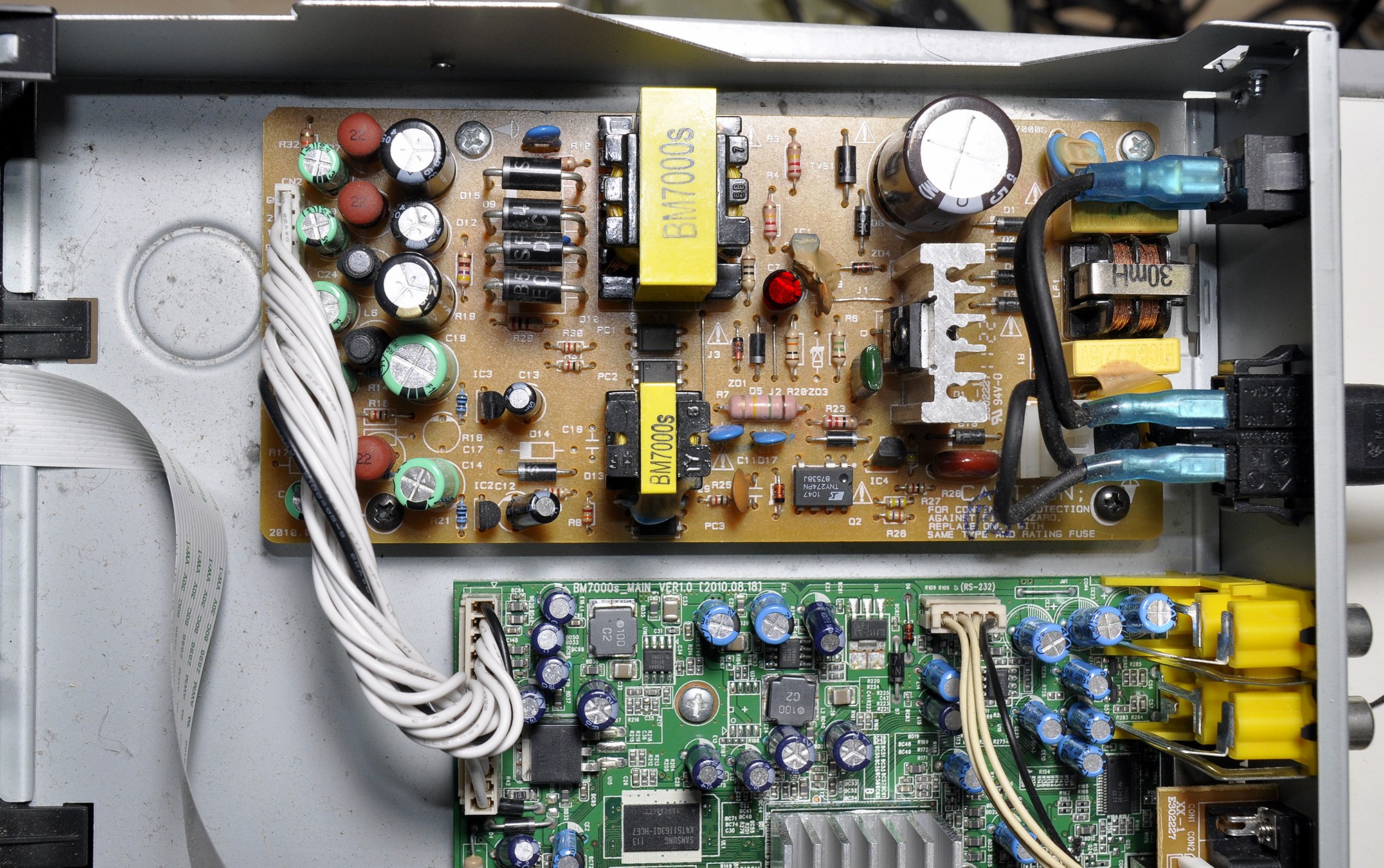

    Hi all, Hope everyone is well. Need some help please.
    I have a Blade BM7000s SAT receiver that is determined to be a PSU issue.
    There is an issue that could happen known as the 'blinking red light'
    and a software/reset type solution works in many cases and if not
    it is determined as a PSU problem.
    Those who have had their PSU replaced or repaired then have working units again.
    Mine is the aforementioned PSU problem.

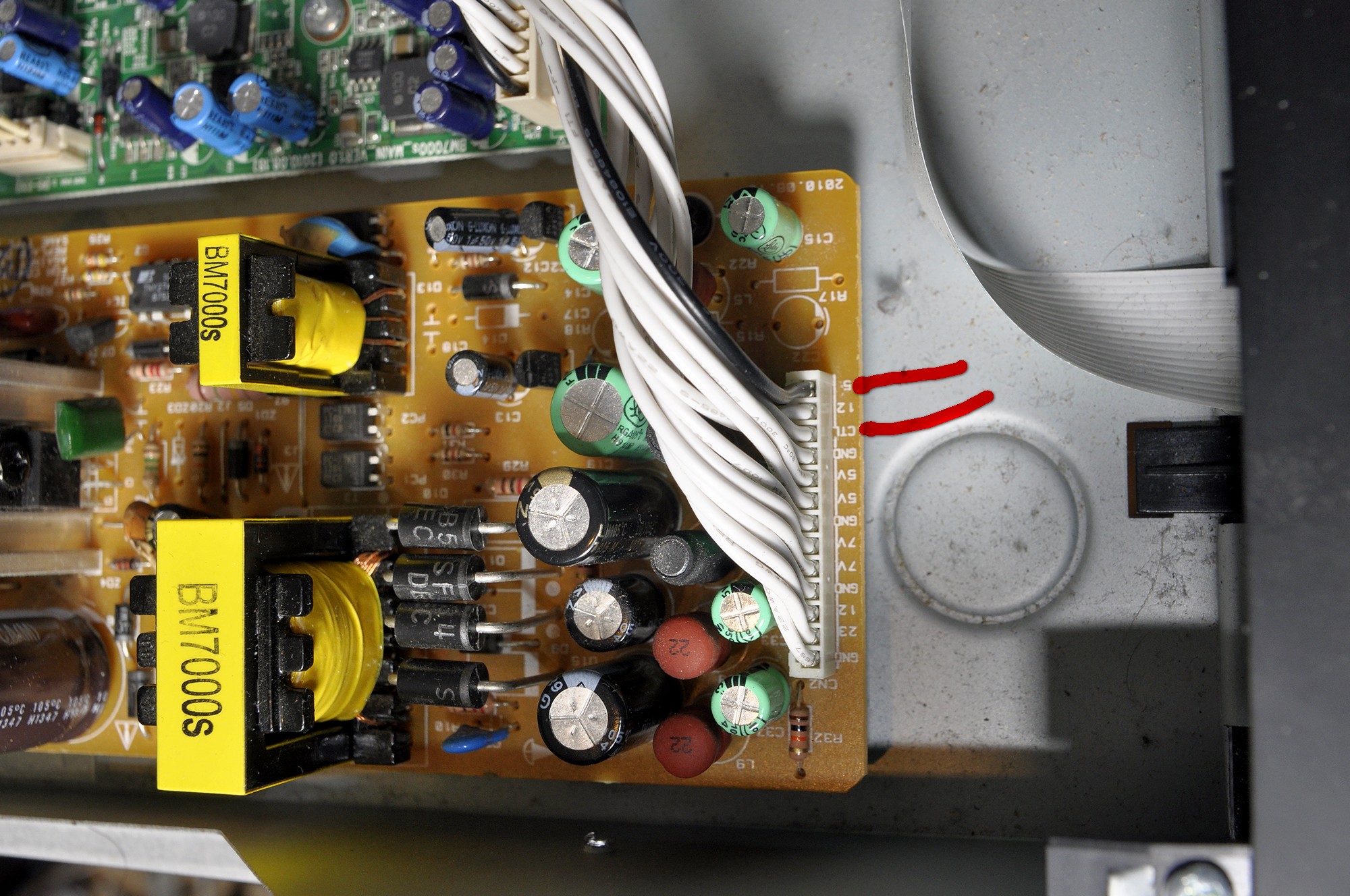

    I have uploaded 2 start up pics for starting purposes.
    I have replaced a 47uf 450v (large brown) and 100uf cap (marked red)as they were laying around but the problem is still there.
    I have tested the power output points and only the 5v (marked red) has power, with the ctl (marked red)also having 3v.
    The rest have nothing.
    As the front red led is blinking, there is a buzzing noise that is also present that syncs with the led flashes. Higher buzz with led on and lower when blinking off.
    I would welcome any advice or clues. Thank you

    I guess the standby voltage (5V) is o.k. if it is constant, or is it going on and off all the time? Did you check the diodes for short?

      Hi CapLeaker. Is that particular 5v for standby? It is constant at exactly 5v. Only the standby LED flashes.
      I have only tested the zener diodes. Though I'm not sure if I get correct readings in circuit.
      Would I need to check all diodes out of circuit?
      Thanks for looking into this.

        Yeah, 5v is the standby and that is always on and goes to the main board. When you press the on button, the main board uses the control wire and tells the power supply to turn on all the other supply rails. So I am thinking there is a short on there some where on the power supply, or the main board has a problem. If you find a short in circuit, take it out or lift one leg and retest it again.
        You can force on any power supply that has standby voltage and a PSON pin with a 500 to 1k ohm resistor. Unplug the main board, and wire the standby to the control with a resistor. Once power is applied, the power supply should turn on and you should be able to measure all the voltage rails.
