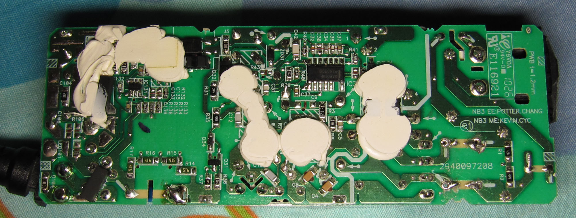

    I thought this was a usual cable problem, turns out the psu has no output voltage and the primary cap doesn't charge.

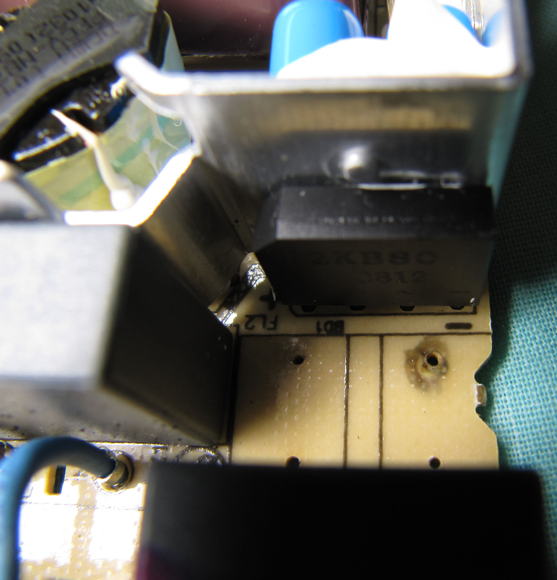

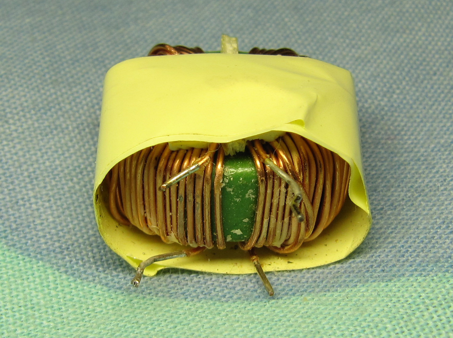

    During further inspection, I found that the AC filtering common mode choke has 1 of its 4 legs disconnected. I removed that choke and as you can see in the photos, the pcb has burn marks around the cut leg.

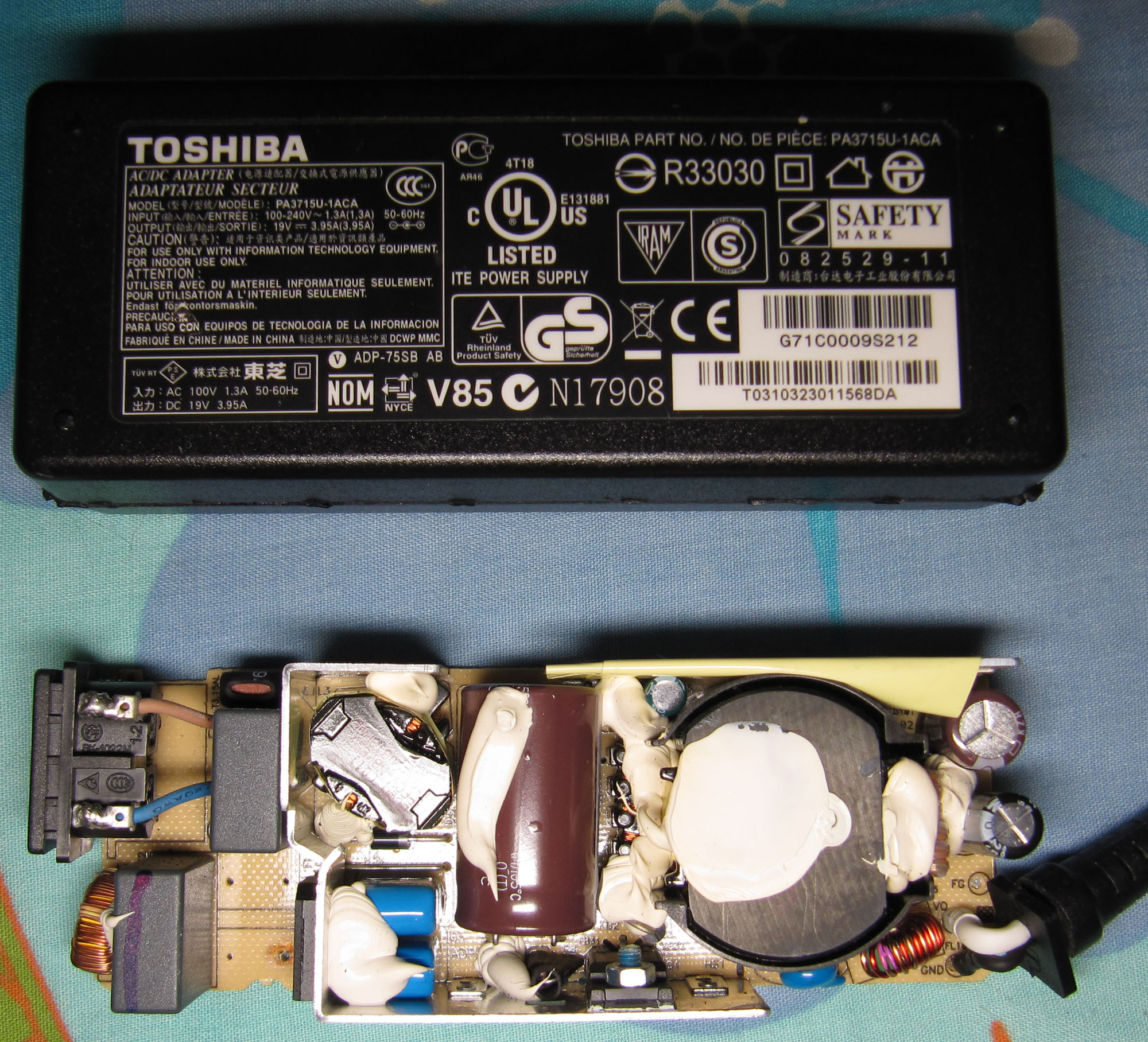

    It seems strange to me also that the AC adapter label doesn't state who the OEM is. I was unable to specify it even after opening the case.
    I checked the coil and I din't find it shorted (between Live and Neutral) or open circuit.
    What do you think caused this fault? Should I try to reuse the coil?

    bad solder joints can heat up till they burn.
    i'd clean the legs and solder it back in properly.
    i used to see this type of problem a lot with mains inlet connectors.

      The UL number points to Delta.

        If there was no glue, it may have been moving/vibrating, breaking the wires over time. They are pretty thin while the choke as a whole is kinda heavy…

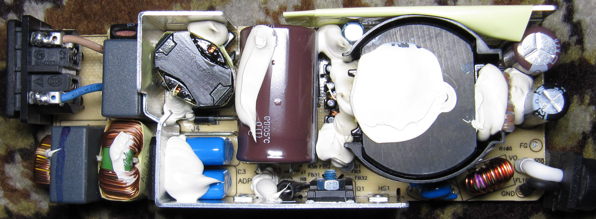

          That is a cleverly designed AC adapter. I have two just like it. They have managed to share the one MOSFET for the PFC and Flyback SMPS stages. It will run a bit cooler that most other AC adapters.

                  Ive seen this kind of problem in many devices, it tends to happern to heavy components or power sockets that have no mechanical boltdown. Just the solder holding it in :-(
                  I would just scrape the pins down to the clean copper then tin every wire untill they gleam , plop it back in with a good quality solder, it wont happern again.

                    I guess maybe the thing was dropped and a bad solder joint finally popped O/C.
                    That is a beautifully designed PSU!

                      Enlight corporation, now part of Delta Electronics.
