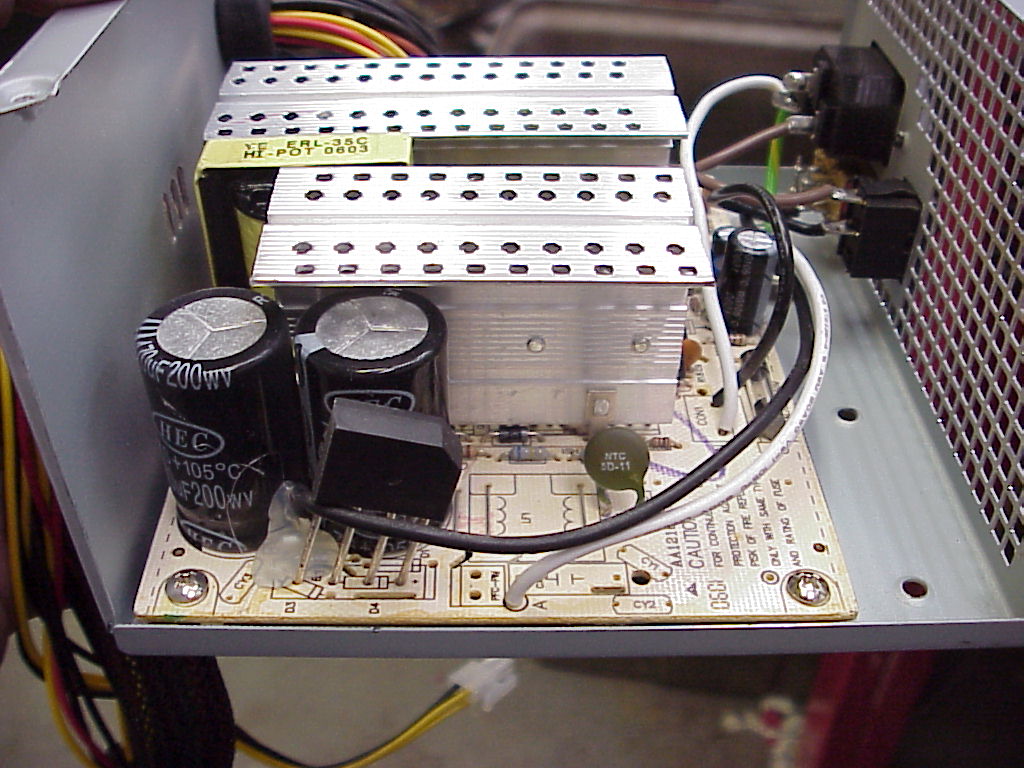

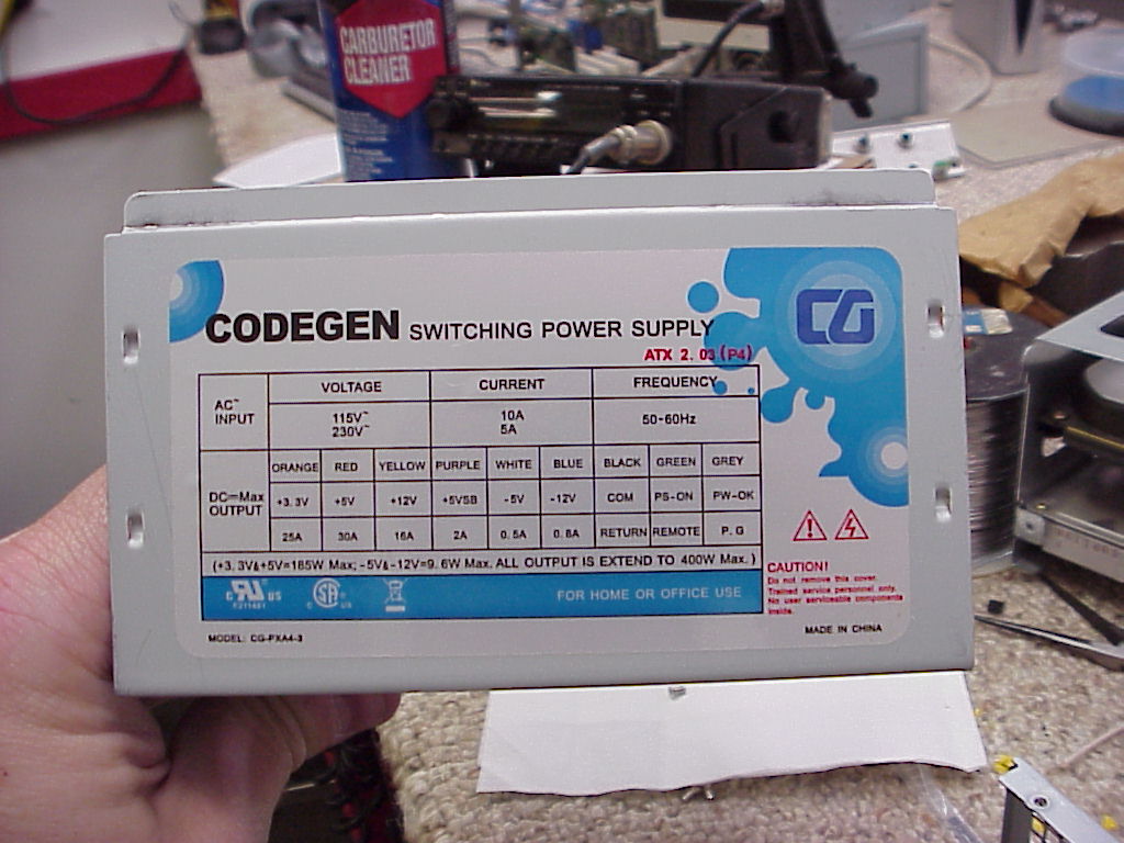

    new codegen pos
    found this in a customers system.
    had random bsod.
    its a gutless wonder.

    Where's the rest it?

      I have seen some empty PSU's but that one has more empty space than actual PSU.

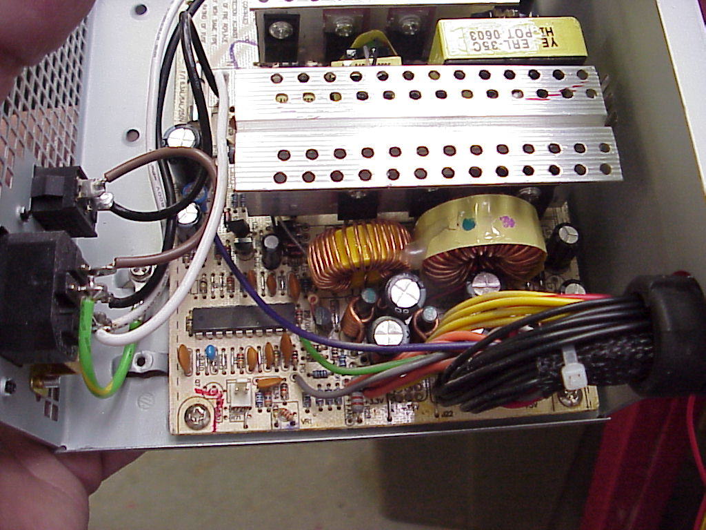

        That's not too bad, actually. The secondary side looks OK - it actually has the inductors in the pi-filter populated. I'd probably recap it, maybe put in a primary-side RFI filter and use it.

          too late.
          after i took pics i reasembled it.
          customer asked what to do with it and i said toss it.
          it got left behind so being in a destructive mood i crushed it with my bare hands and wadded it up.next time i will wear gloves as they didnt deburr the sheetmetal and i got cut.

            And I thought that my Deer PSU was empty enough.... This Codegen is even emptier than my Deer PSU.
            Wow, this Codegen even says it will pump out 400W.... I highly doubt it. Maybe 200W max?

                Actually, it's TERRIBLE! Not only is it missing an EMI/RFI filter and any sort of surge suppression (a good PSU will have at least one varistor), the output rectifiers are WAY too small. You'd have to rebuild the entire thing. I suspect that the transformer is grossly undersized as well. Oh yeah, the heatsinks are too small too.
                Oh yeah.... as tradition among craptastic PSU companies, this one also has crap caps.
