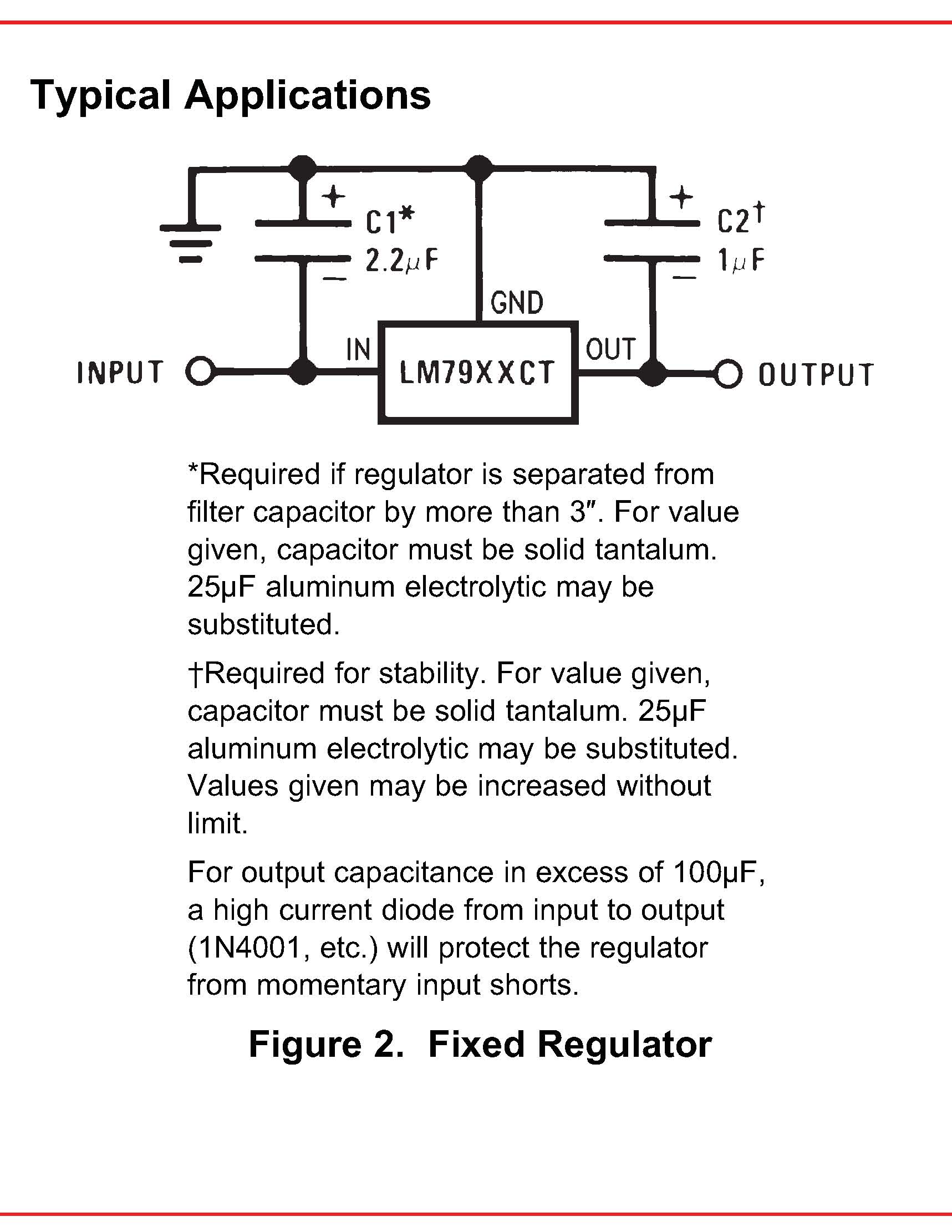

                  How about a 7905 negative regulator with its input connected to the -12V rail?

                    japlytic, that was basically what etnietering mentioned earlier but how exactly do you find the -12v rail and is there a tutorial somewhere showing how to do the connection for the circuit illiterate?
                      Re: Need a replacement power supply with -5VDC
                      So the Corsair CX750m has -12V output (0.8A)
                      http://www.corsair.com/en-us/cx-seri...ed-modular-psu
                      LM79xx series, see PDF for how to use it.
                      Do you know how much the current requirement for the -5V will be?

                        Thanks budm as always! Am I correct that I only need to hook up to the input leg and then basically have the output going to where the white wire is on the ATX Motherboard power connector? The -5V should be no more than 0.3A as thats what my PC Power & Cooling Turbo-Cool 450-ATX outputs according to the specs on the PSU casing so that number should be able to handle everything.

                          The -12 V rail has blue wire on the ATX connector. I also suggest some capacitor for the regulator output, something like 100 uF is more than enough. The regulator usually has pretty smooth output enough but just to be sure…
                            You need to install small caps at both input and output so it will not oscillate, see the notes in the spec sheet.
                              There is a cap on the other side of the blue wire, in the PSU, so I think that one will be enough…
                                Good design will have the caps installed as close to the IC, I always have the caps installed in my designs. That -12V feeding wire will be longer than 3 inch.

                                  Seems like the Rubycon ZLH or 16v 100uF caps would work. I noticed the spec sheet says 25uF, wouldn't 100uF be too much though?
