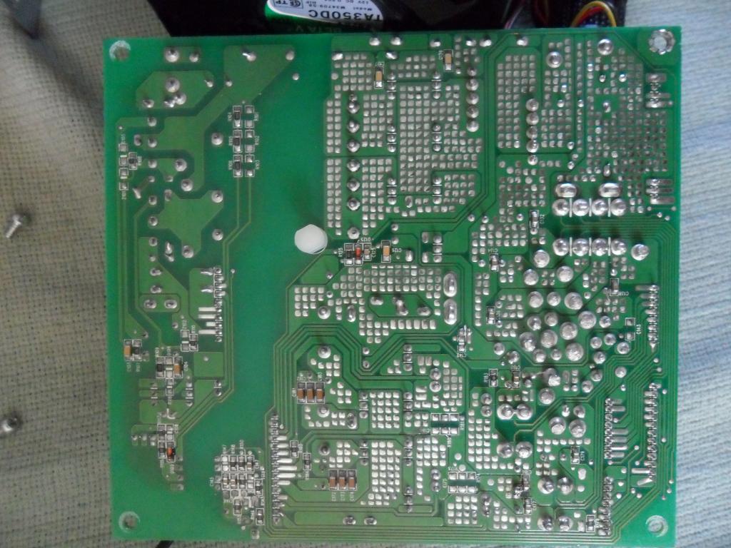

    Hi, a faulty Dell XPS720 PC.
    The power supply powers the motherboard on and gives a green motherboard LED but the motherboard is a no boot and no bios, just a black screen and components are A ok.
    No beeps, no PC LEDs light up.
    The capacitors in the PSU and on the motherboard all look ok.
    I checked all the PSU solder joints and may have found one or two cold solder joints so re soldered them.

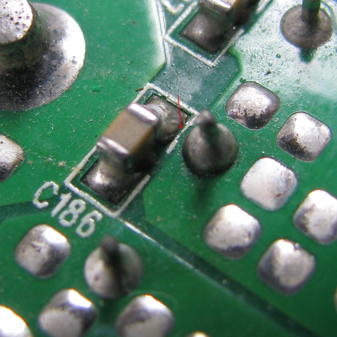

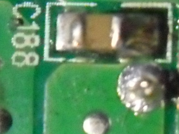

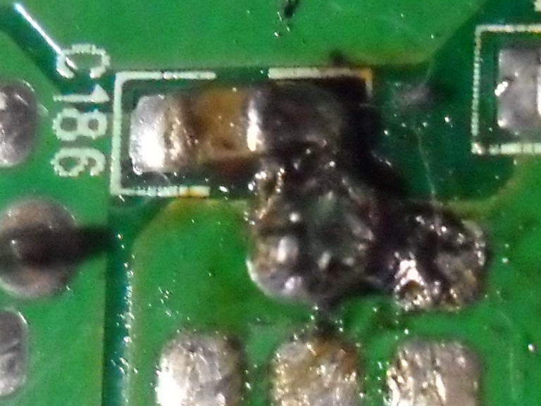

    When I was checking the PSU solder points I saw what seemed like two messy solder joints. I removed the solder from one and found a white board marking under where the solder was and it is a boundary line for solder.
    In the two photos the first shows almost all the white line between the two points that were soldered. The second photo shows the second place where I am quite sure same kind of components are used and a same white line exists beneath the solder - but with this second soldered point I am having an especially hard time removing the old solder.
    Can anyone tell me whether the two points in question that have the white line beneath the solder(100% sure there is a white line beneath the second) should have been soldered?
    It seems logical that if one of the two soldered points of two same components is soldered and the other two same components is not soldered then there may be a mistake. The odd soldering appearance that attracted me to these two same components soldered points makes me think there may be a mistake, maybe someone did this aftermarket.
    I do not understand why the motherboard will not boot but I am prepared to replace the larger motherboard capacitors.
    Also, I am not sure if I should replace any PSU or motherboard capacitors at this point either but seems a logical step for repairing and I may have found a PSU dell connector pinout for testing the power supply, which is an exciting step for me to have made I am pleased to say.

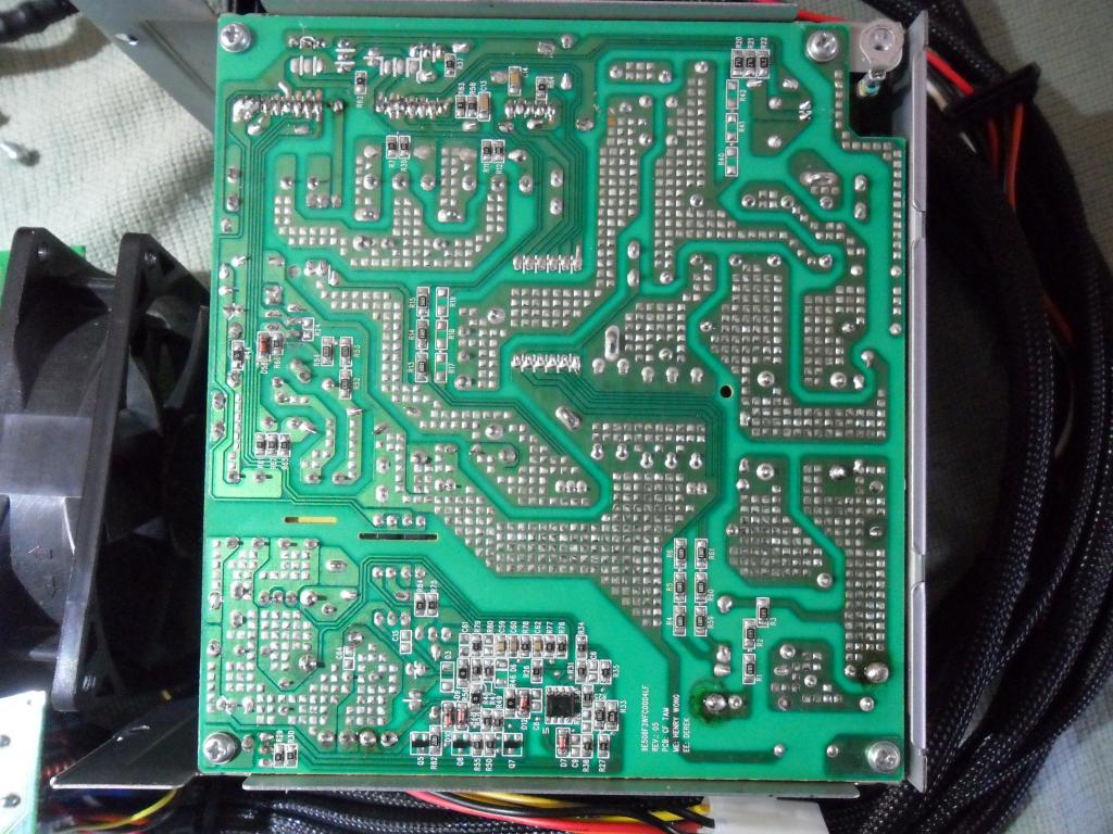

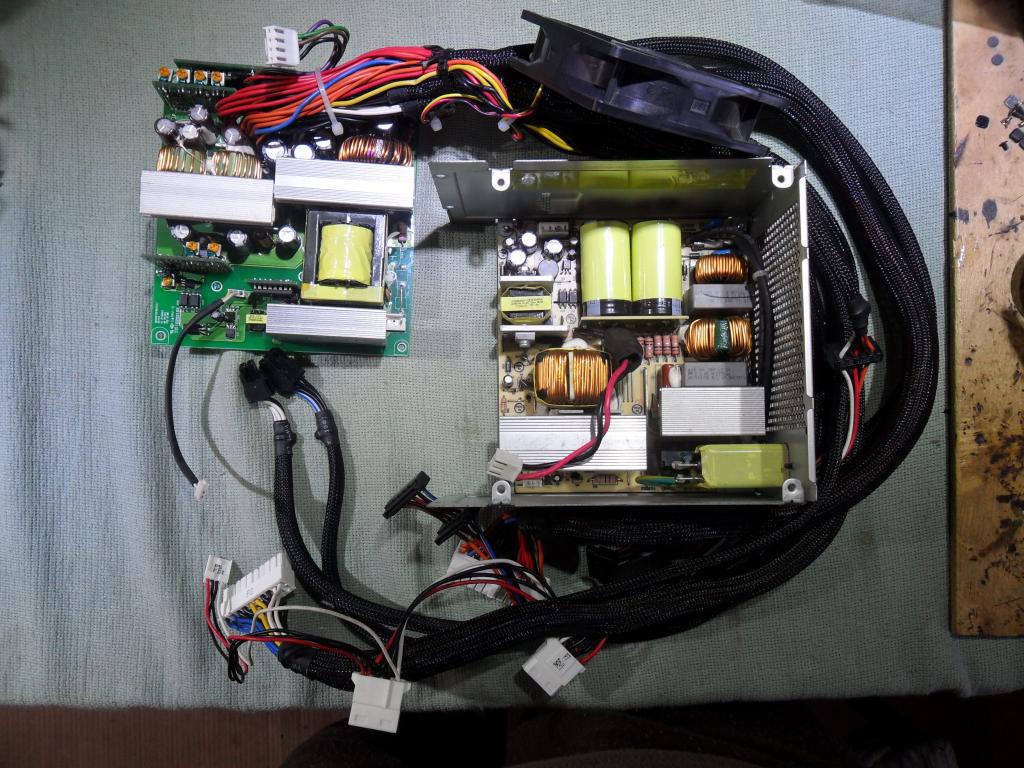

    You don't want to bridge the two joints like that if they weren't like that to begin with, they're separated for a reason. There was probably an option to install an additional component on that section of the board, but the manufacturer doesn't always install every component if they aren't necessary for the boards intended application. Could you post some overhead pictures of the board and power supply?

      Anyhow, the first of the two sets of the two components that were soldered together in the photos, was soldered to begin with. I wanted to resolder a few extra solder points and arrived at the two first of the two sets of same components, and noticed the solder removed from the components was not the first original solder for the components. The two components had each of their original solder soldering them to the power board. After seeing the white line I recalled the reason for the white lines. Btw, this is a Revision A05 power supply. Dell P/N: HPW7508F3.
      One question: how do I test this power supply? Is it enough to power on the power supply with a load then use a digital multi meter and probe any black (earth), and any white yellow red blue etcetera wire connections? I do have a cheaper PSU tester but I dont this works correctly with this proprietory Dell PSU.

        Here is the PSU power boards and info on the PSU label.

          We prefer photobucket or other 3rd party image hosts not to be used here. I have attached the pictures locally for you.
          Incidentally, I have the exact same PSU here in my stash. Those things are built like tanks.
          EDIT: I have had a look at my unit, and I can confirm that the joints are indeed bridged. You can see it if you look very carefully, and my DMM confirms that they are connected.

            ok, thank you. I will solder those components.
            I tested the motherboard capacitors and got many different readings for capacitors of the same ratings. I grounded the multi meter terminals after each reading so think I got accurate readings.
            All the 716/SEPC/ 560(I think the 560 indicates uF correctly)/4 meaning 560uF 4V imo..., on the motherboard around CPU socket all gave something like 1950uF readings which is a bit confusing seeing all reading way over the 560uF rating.
            There was not many same rated capacitors on the motherboard that gave equal readings. I guess I should go ahead and replace all of them. At the least this would be the perfect solution wouldn't it?

              those 560 are all in paralell on vcore.
              sepc are sanyo polys and very unlikely to fail.

                  You will get 1950uF if you have four caps in parallel. In reality, though, they would have to be just under 500uF each (which is still within tolerance).
