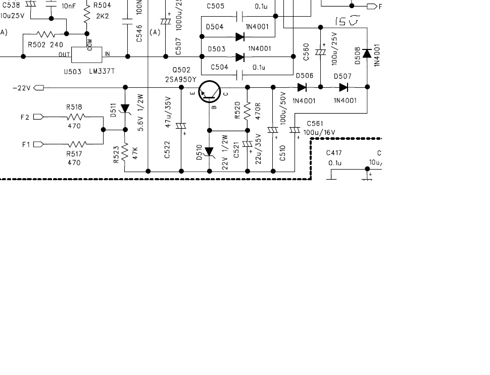

NAD C541 Cd player Negative rectify ?
  • Sevenqi
    • Jul 2011
    • 292
    Anyone know how this negative rectify works ? This schematic is from NAD C541 CD player, the input is around ~ 15v to 17v AC, output should be -22V, but I only got around -11v. I checked the capacitor diode, or resistor they all looks OK.
    • 31010
    Re: NAD C541 Cd player Negative rectify ?
    d510 acts as a voltage regulator.
    what voltage goes into the transistor?
      It's a charge pump voltage doubler. Check the diodes and capacitors. A failed diode or capacitor will disable the doubling function.
