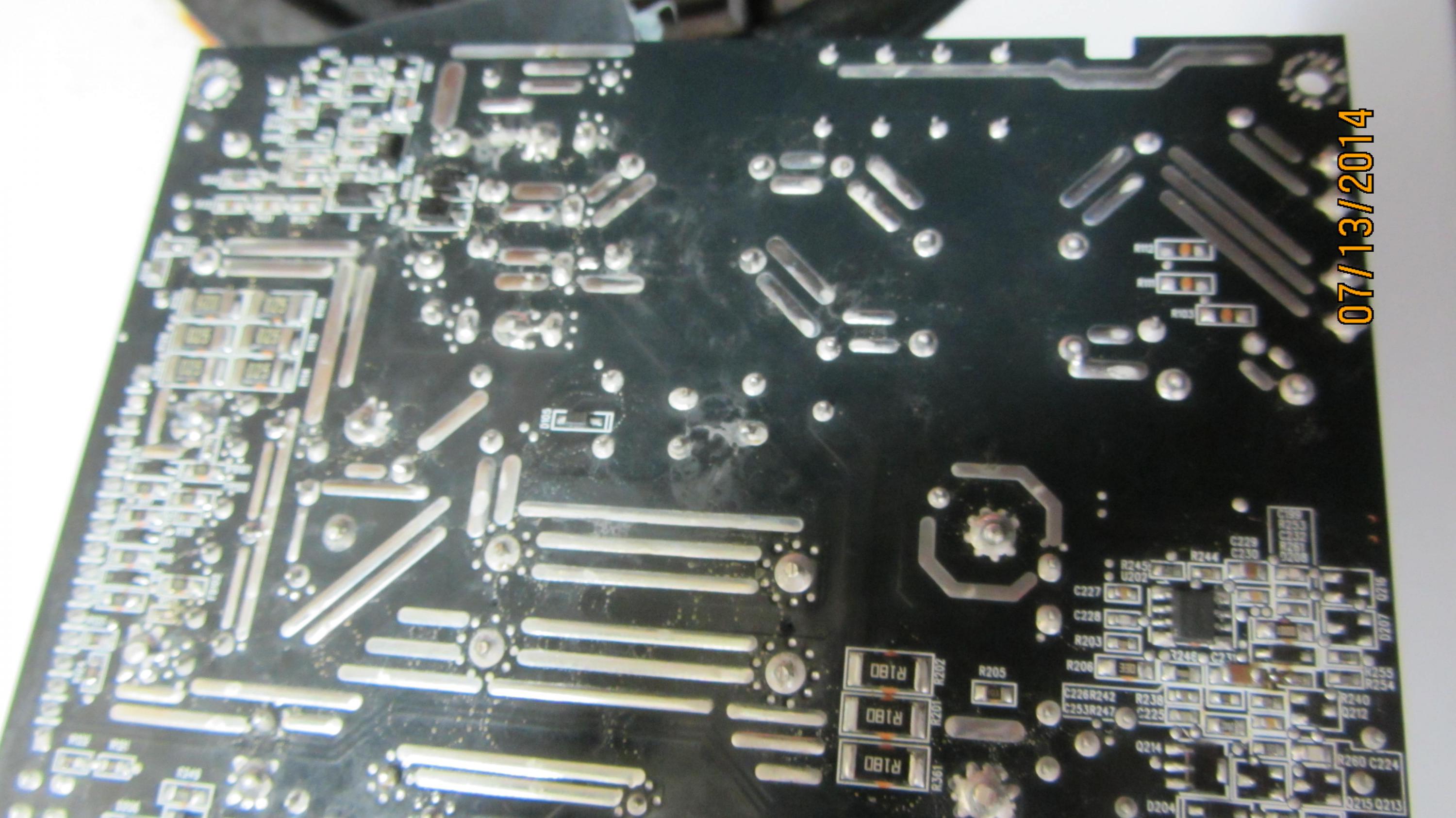

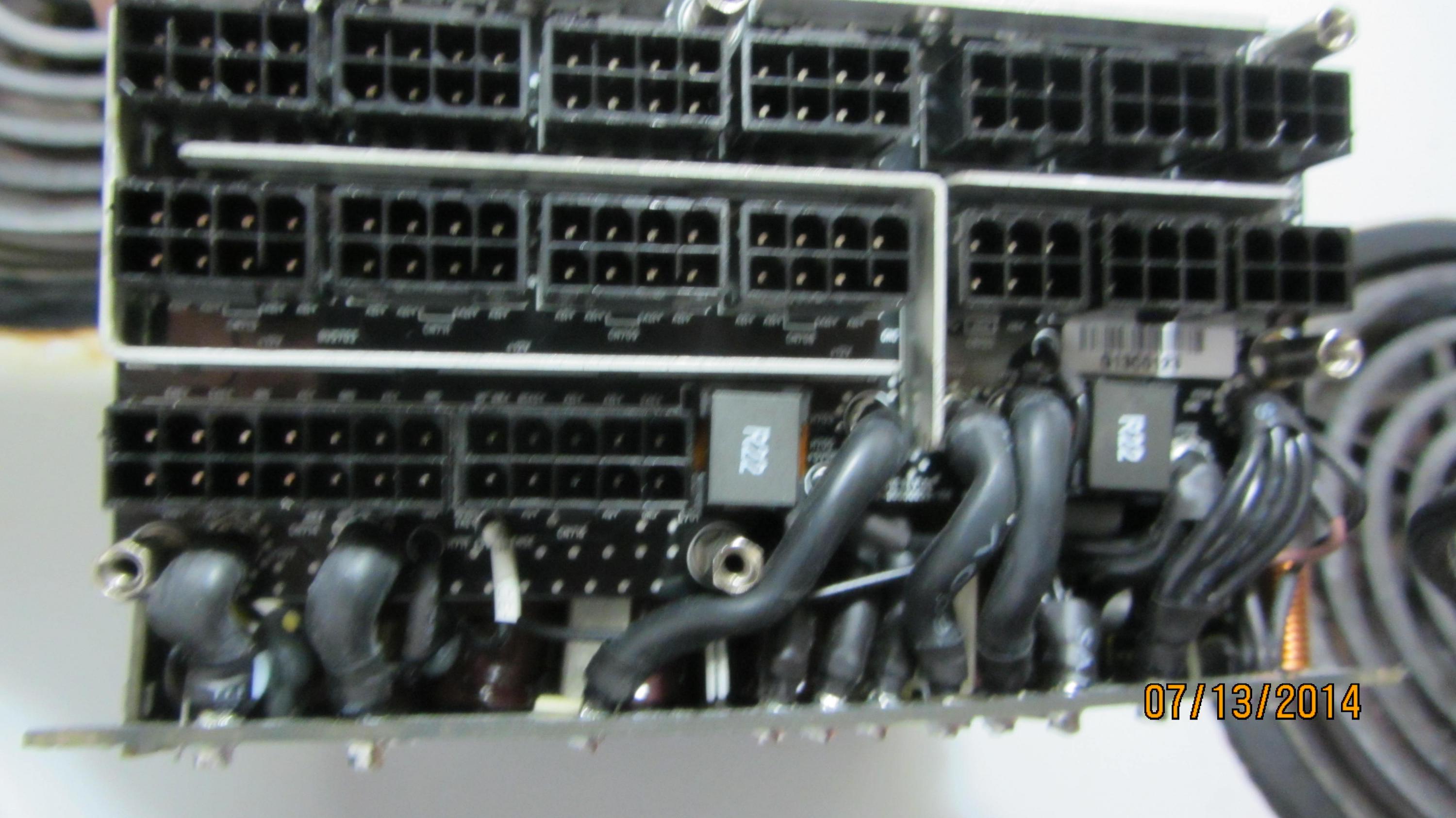

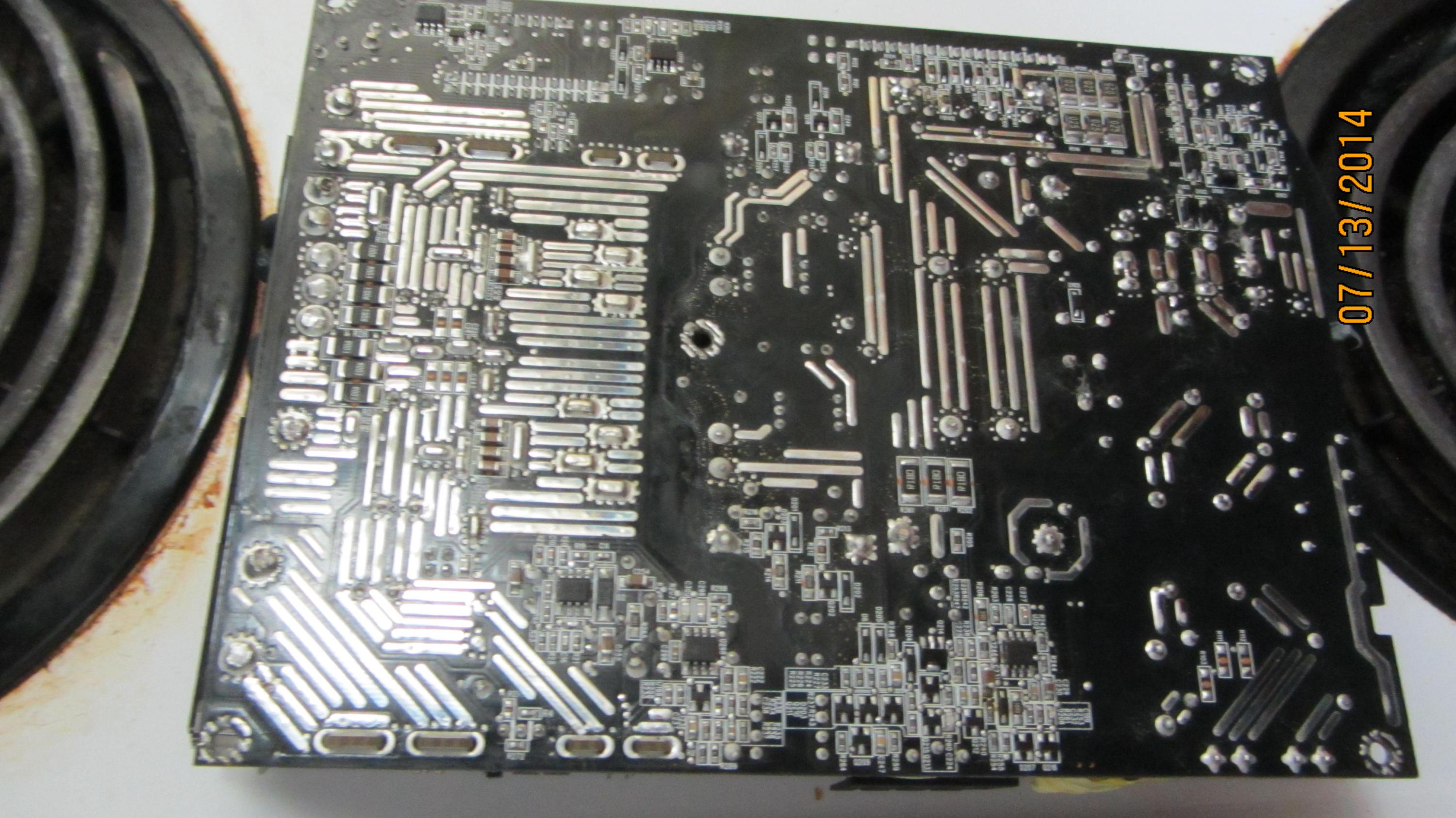

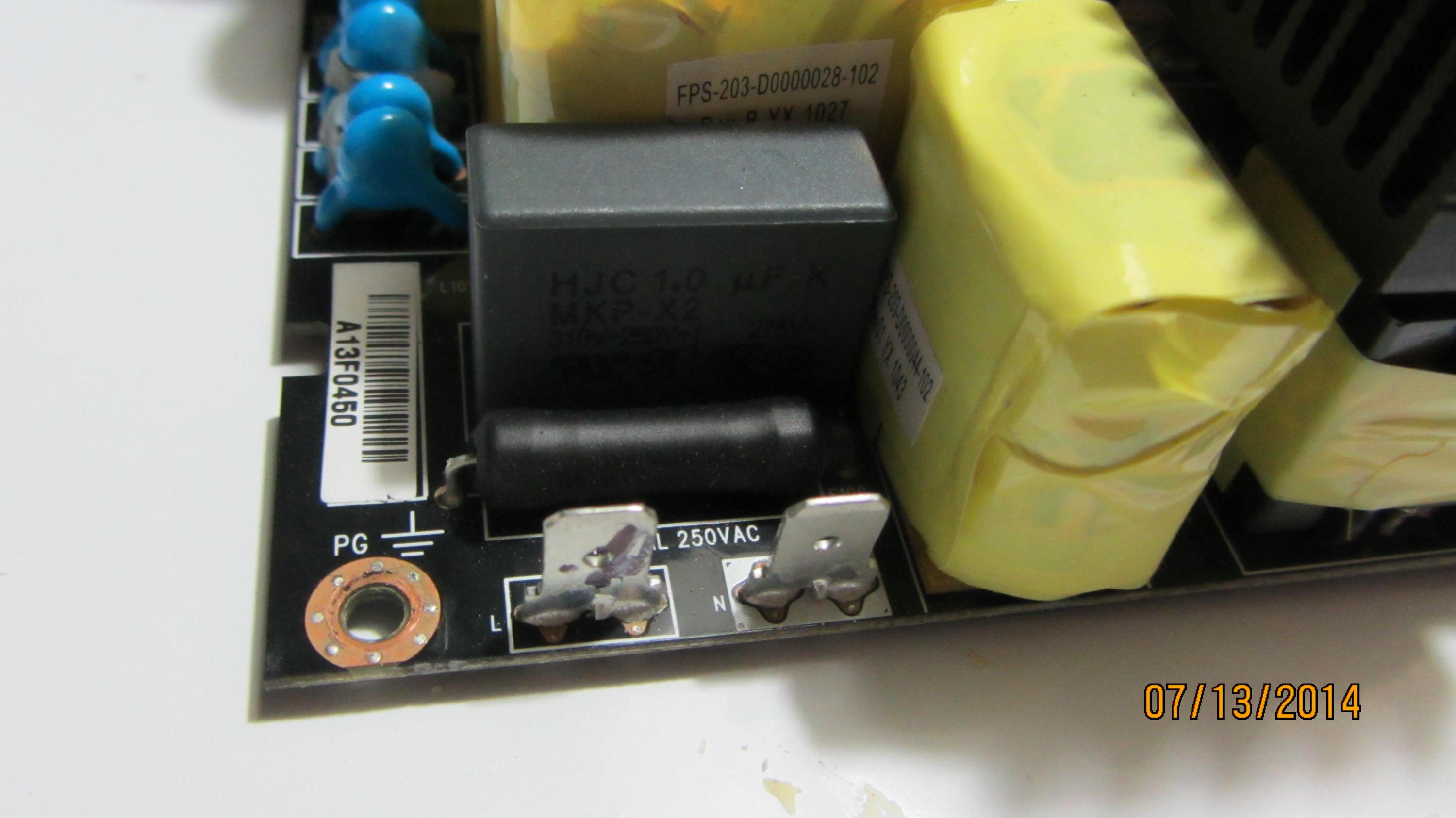

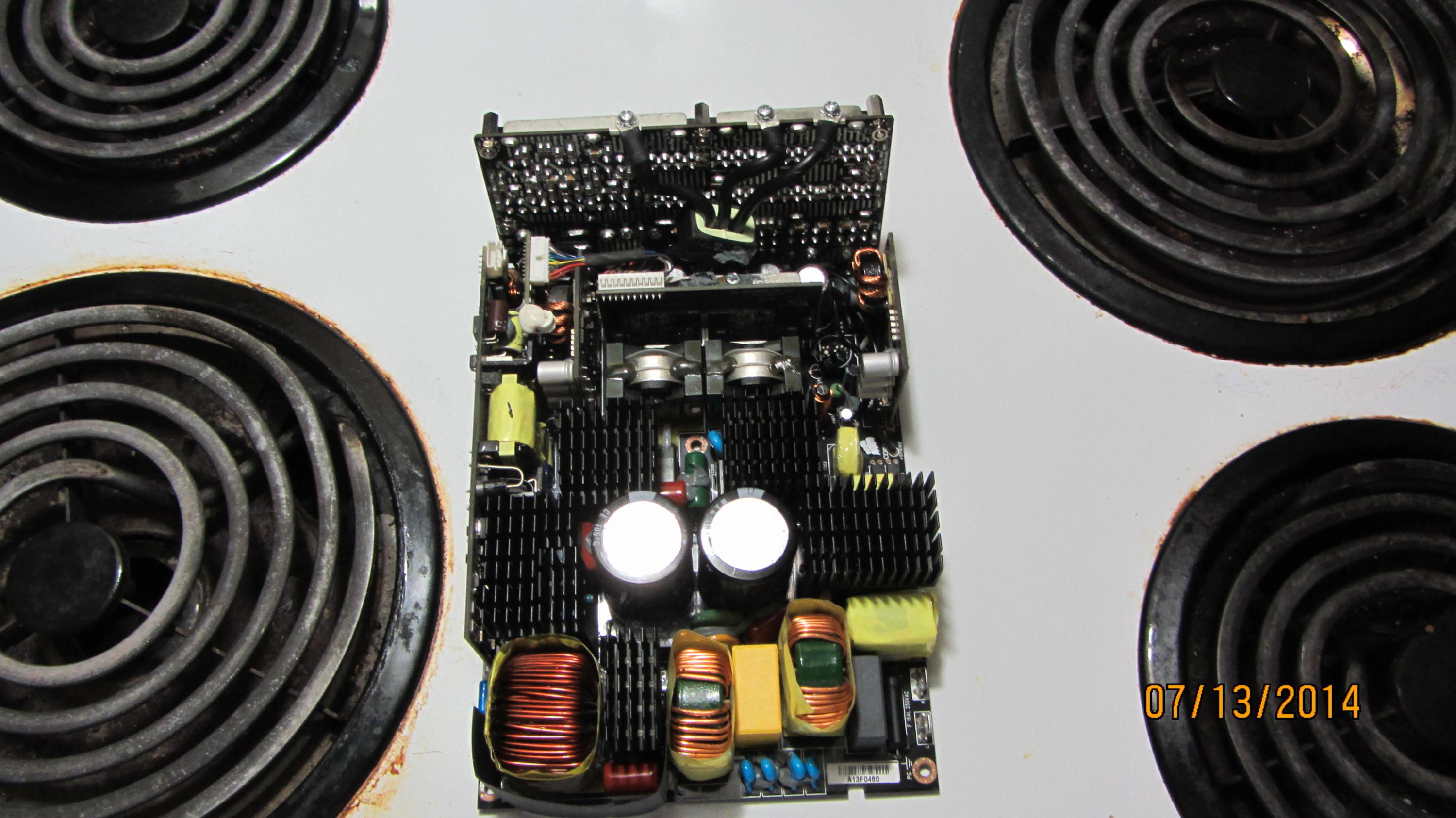

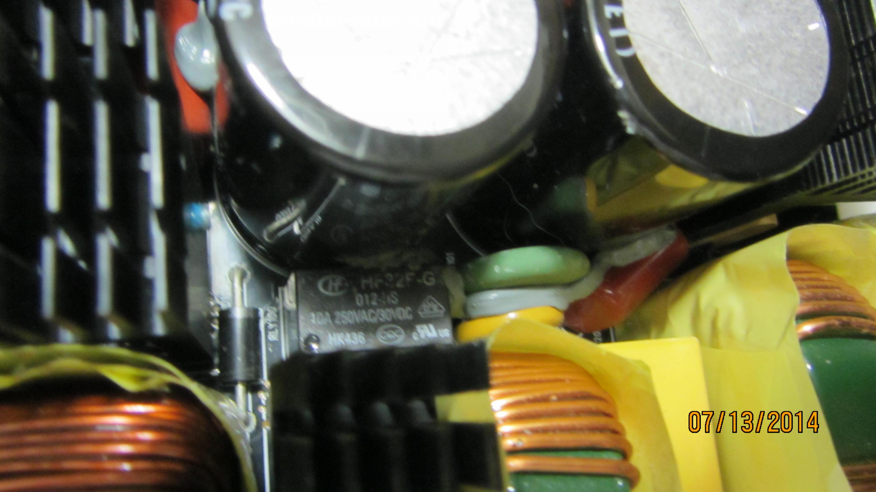

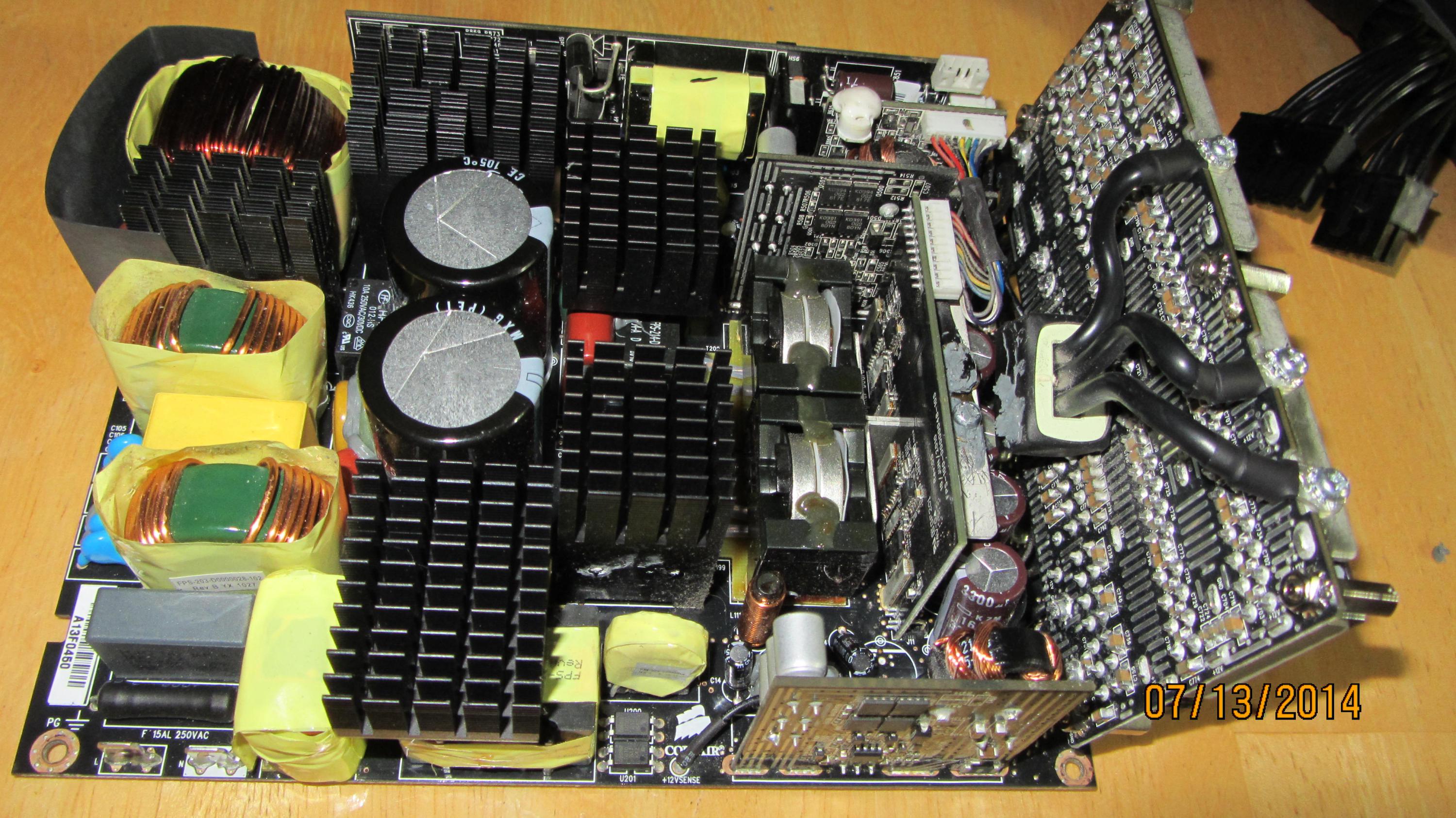

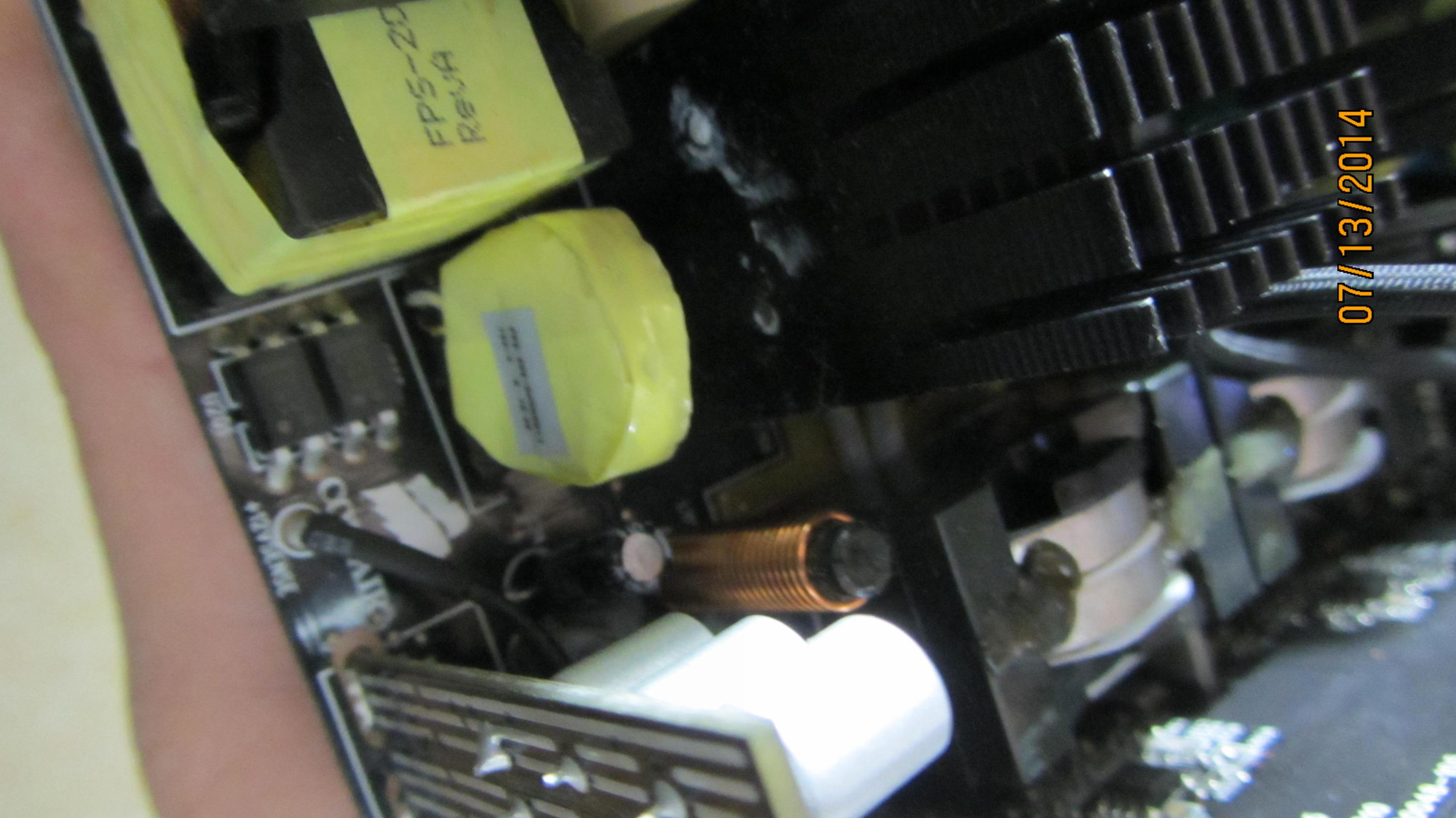

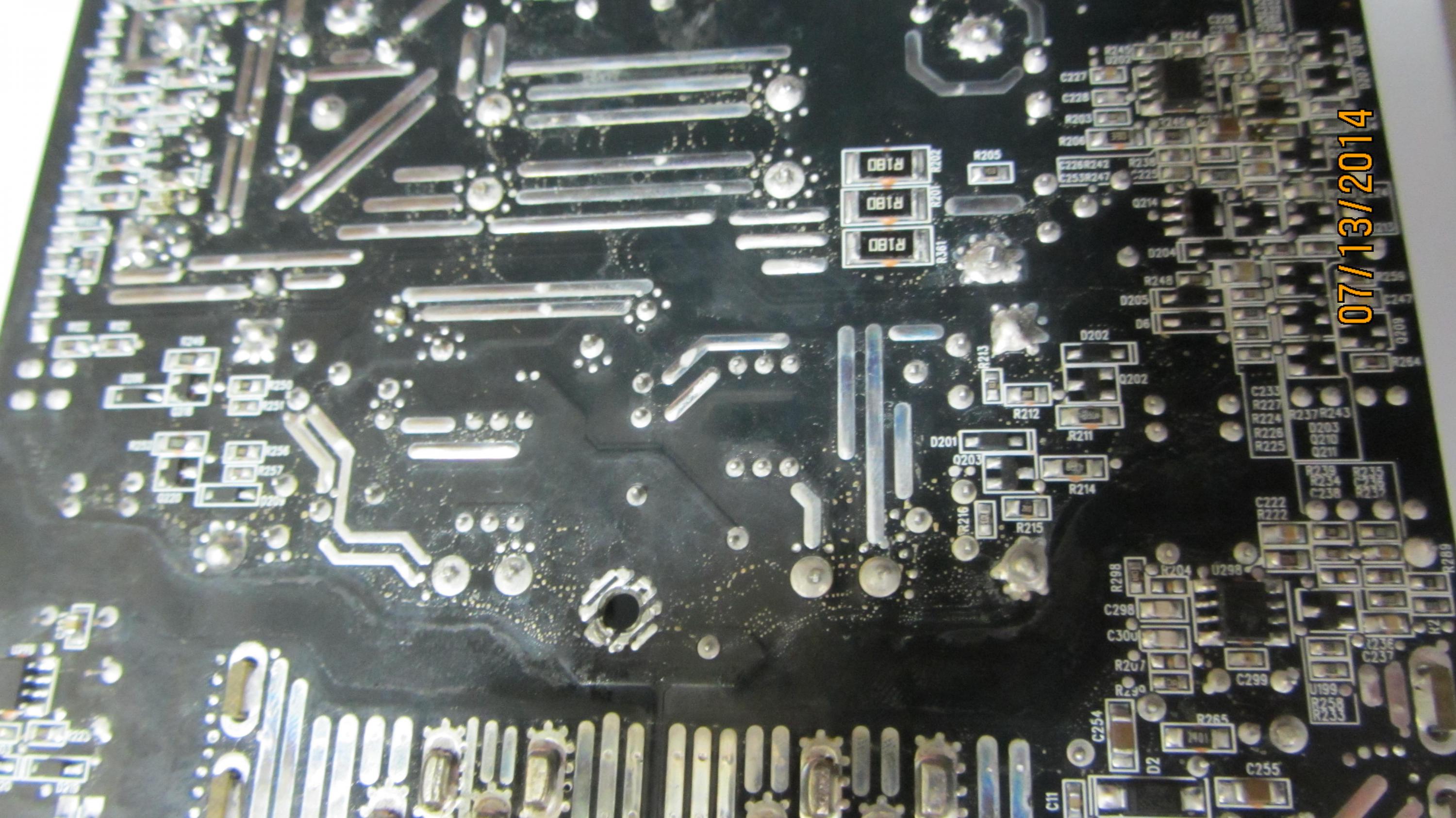

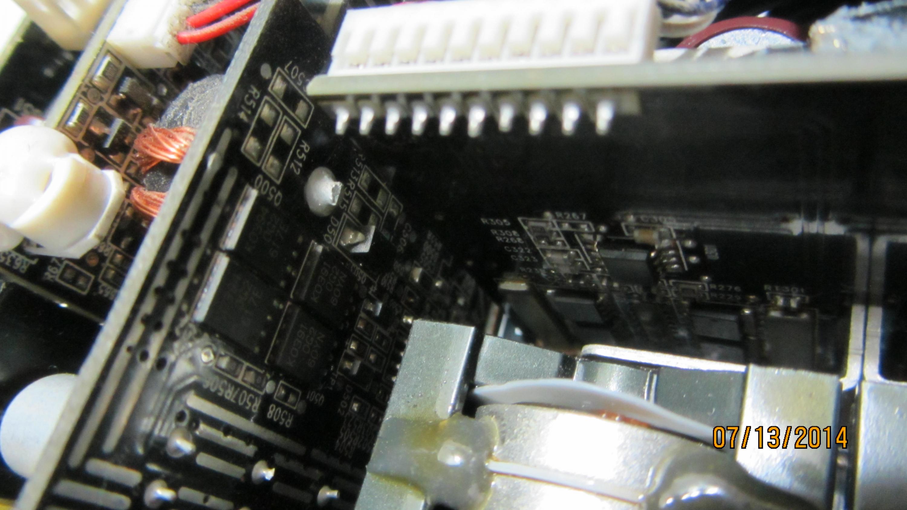

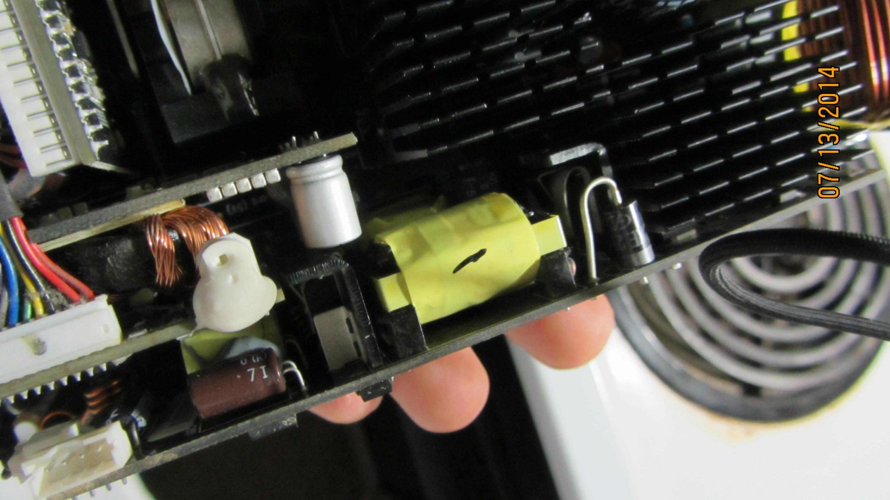

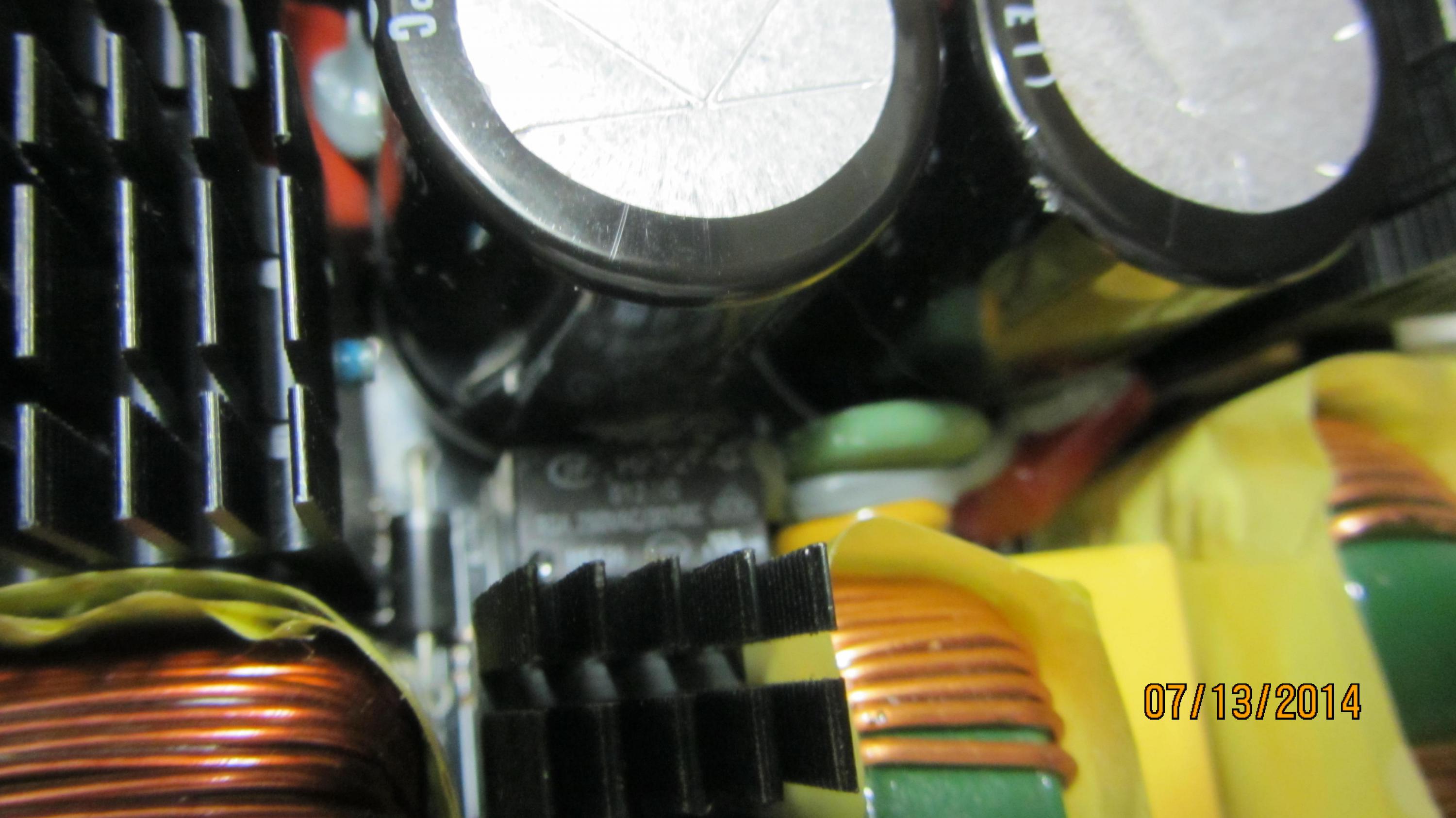

    The fuse is good it tries to turn on with pwr on jumpered to ground and a load connected but does not there is a faint brief burnt smell after you hear the initial spring like sound and then a quiet bzzt almost like a crossed wire, but nothing looks burnt nothing smells burnt inside of the supply.
    So would it be around the sense circuit by the optocouplers and the resistor or do you think it would be the diode next to the 300v caps none of the caps look bloated or bad to be honest I'm thinking it is likely something else even though I recall there being other supplies that the slightest bit over on esr made the difference but for the most part it seems if a cap is not bloated it is most often still good could it be the optocouplers themselves IDK the more and more I look at this thing the more I am in wonder.

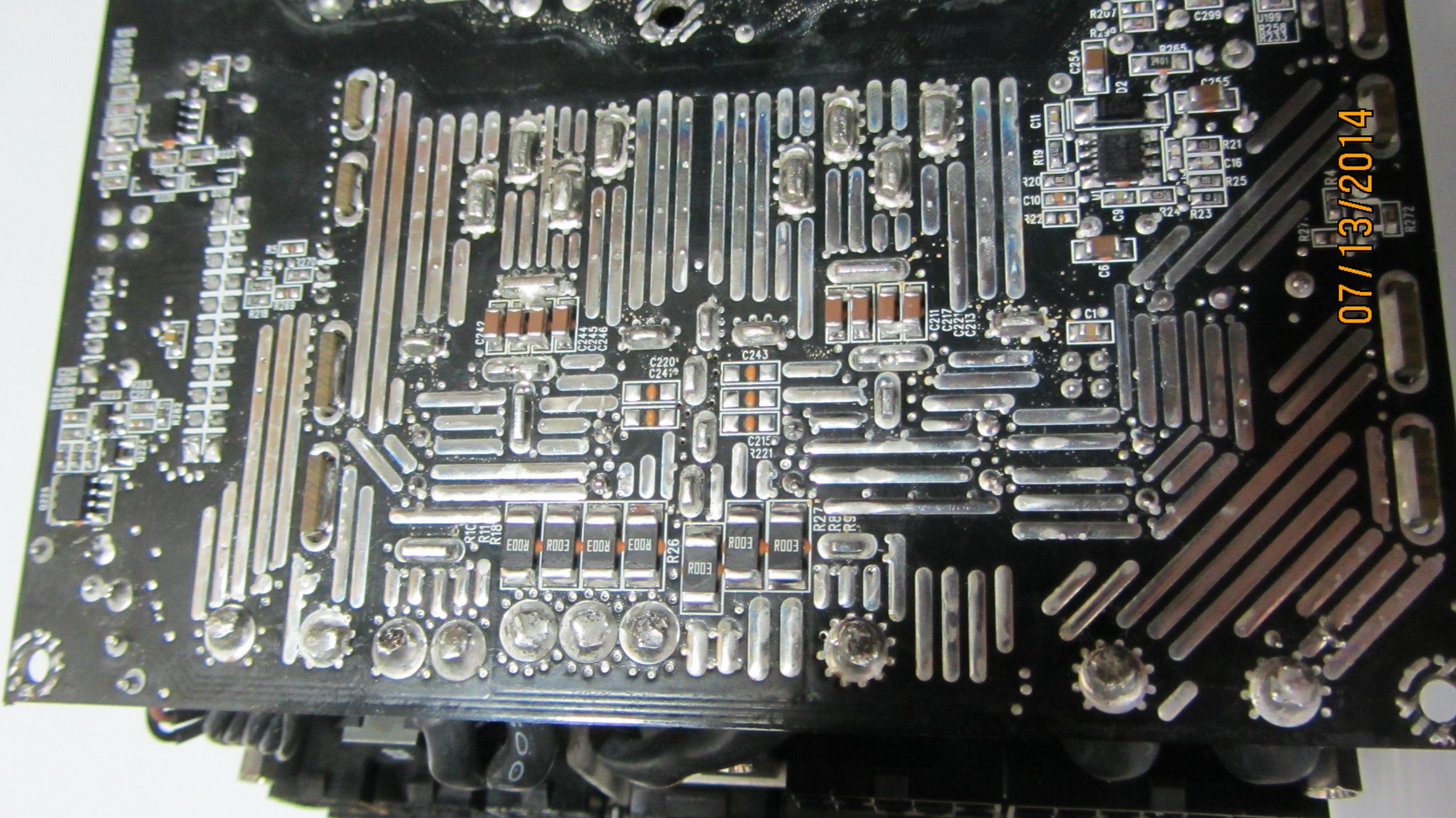

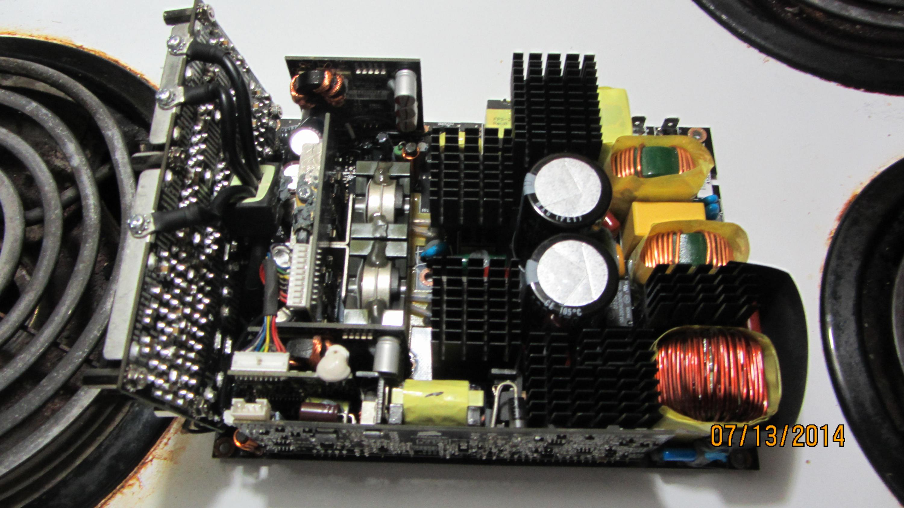

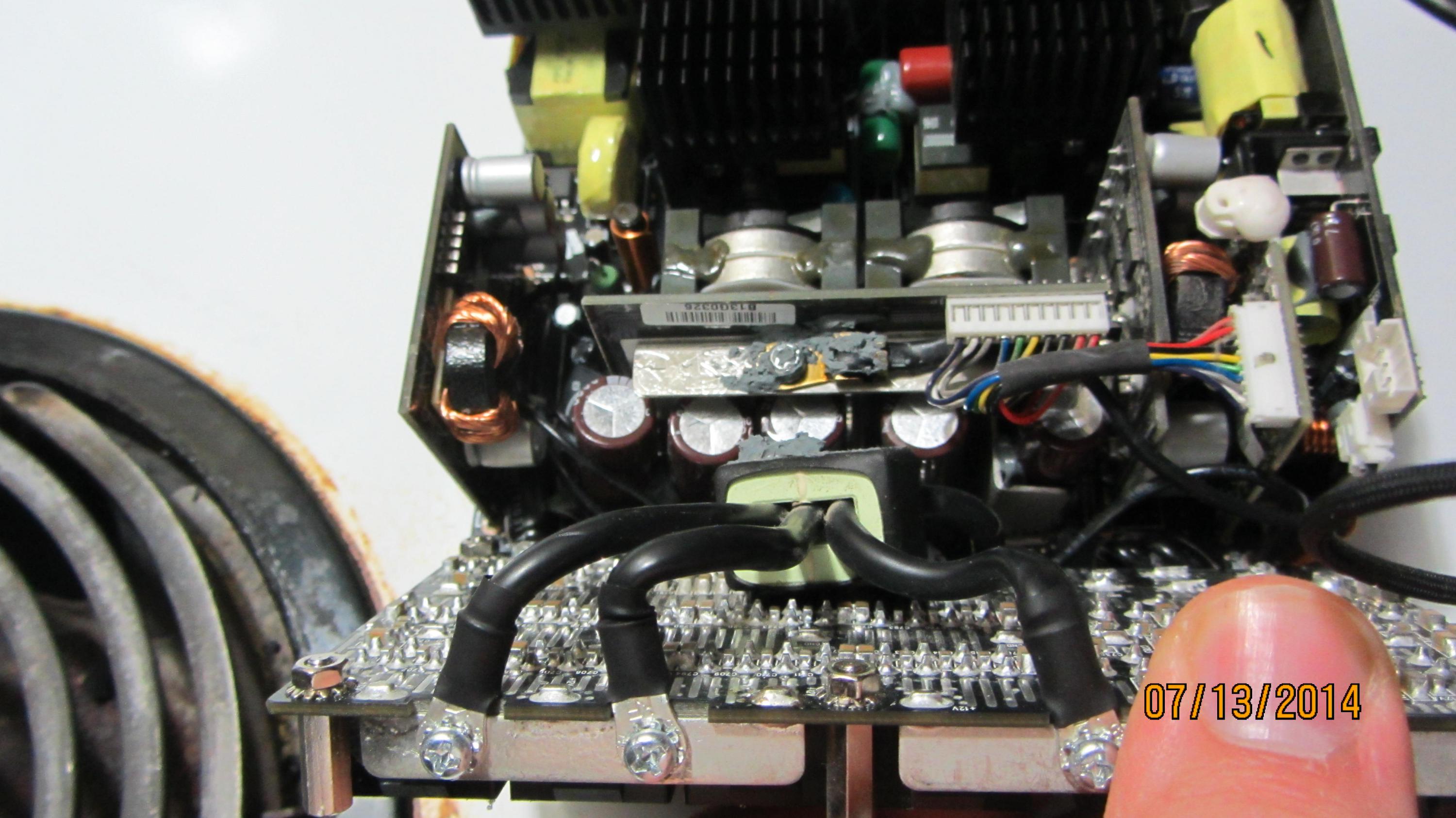

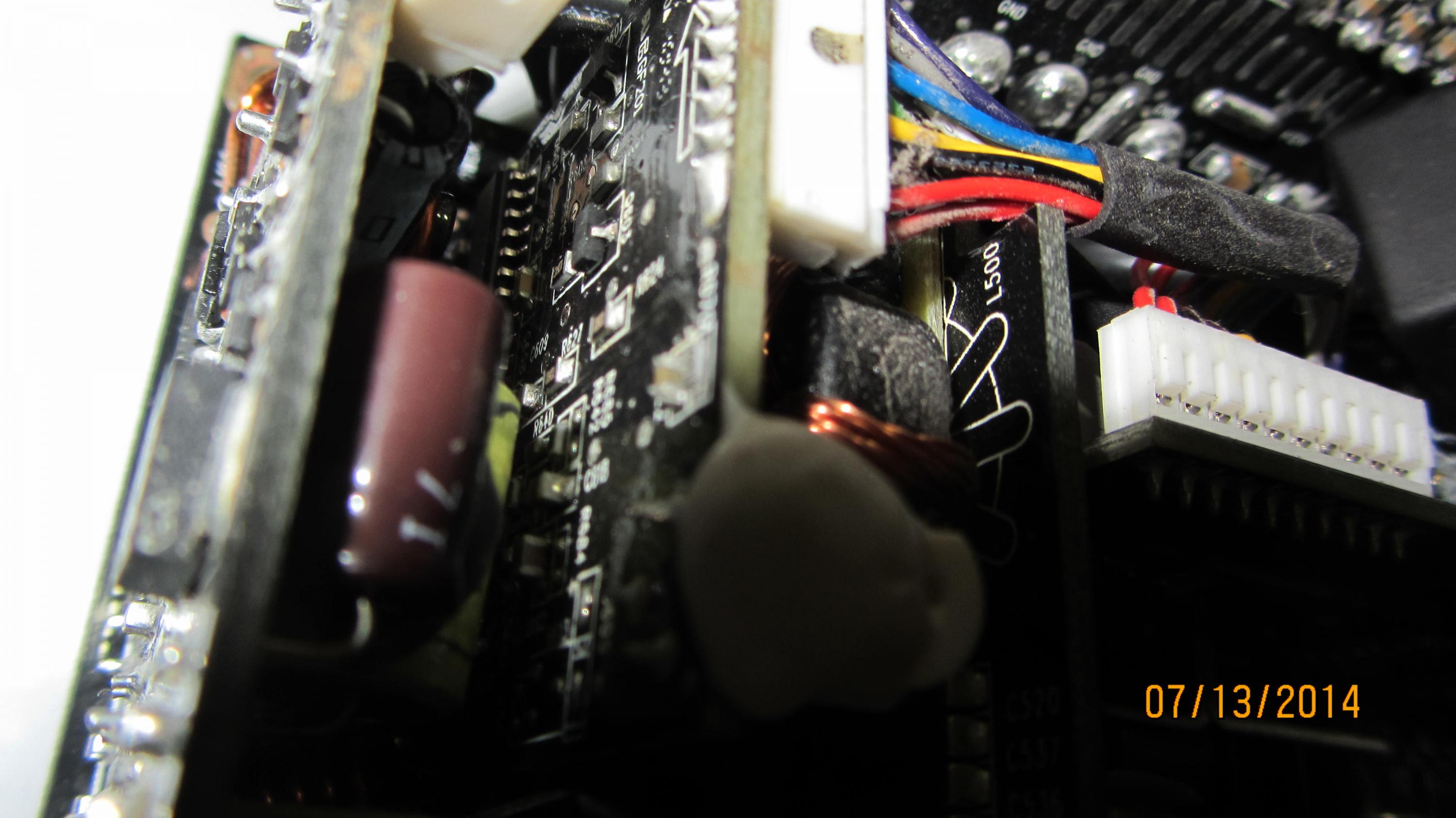

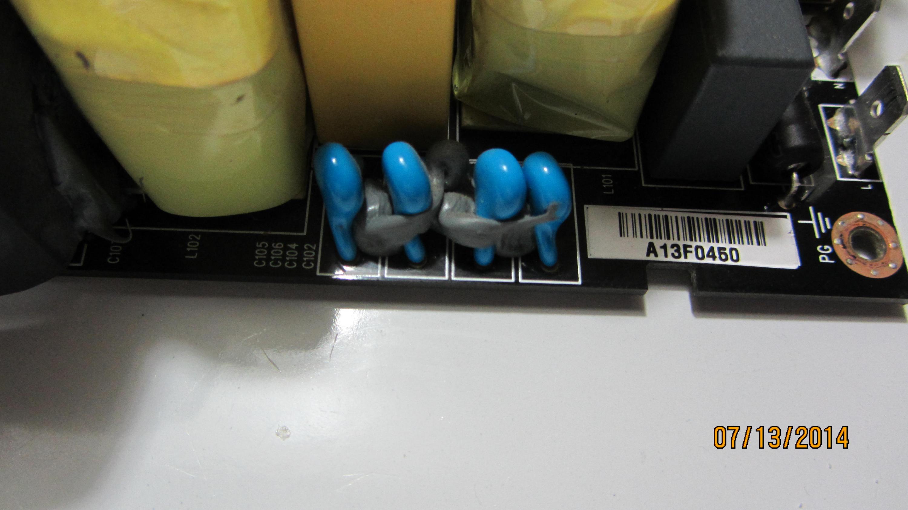

    I have taken some pics to share providing they all upload.

    I'm half tempted to try and trick the optocouplers to make it stay on and see what burns up but I don't really want to make it any more expensive of a fix that it already is lol.
    I know there is some people with a lot more working knowledge than I on this forum when it comes to power supplies so any direction would be appreciated to try and save me a bit of time.
    Thanks in advance!

      Don't assume the optocouplers are bad (they actually rarely - if ever - go bad) and definitely don't "force" or "short" anything in there. If anything, this will likely make the PSU very hard to repair when other parts blow. Lastly, if the fuse was blown, you wouldn't get power on at all.
      The fact that the PSU "tries" to turn on with a blip probably means there's a short circuit on one of the outputs.
      Do you have a multimeter and do you know how to use it? Let me know and we can start.
