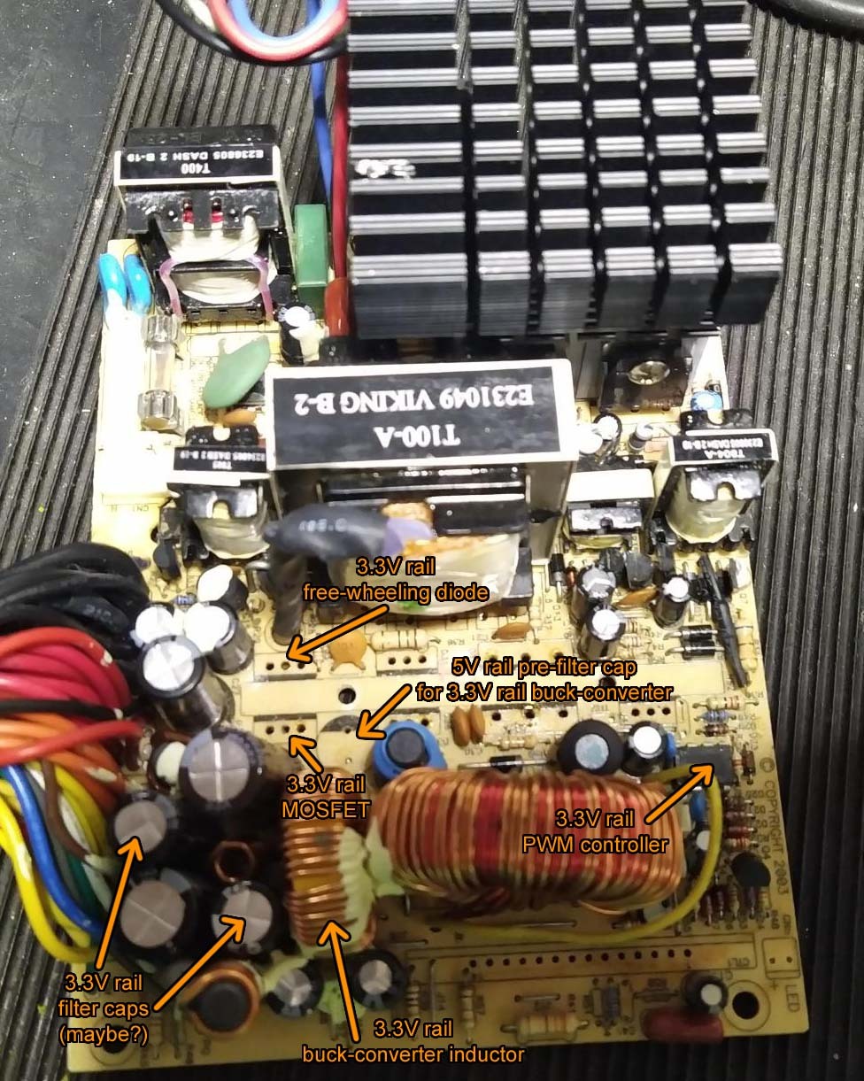

                    Now, if I remember correctly, my ePower PSU had a buck-regulated 3.3V rail that's directly generated from the 5V rail via a single-ended buck-converter (comprised of a small toroid, a single MOSFET, and one free-wheeling diode rectifier.) I think this is the same for your PSU, based on what I could trace from the pictures you posted in post # 5 on the previous page. See my annotated image below and confirm your components match the descriptions I put. If your 3.3V rail circuit seems to match this, then make sure not only the 3.3V rail caps are good, but also the 5V rail caps. In particular, there are 3 caps on the 5V rail: two as main filters and one after a "PI" (rod-core) inductor that's used as a pre-filter (which I annotated on the picture) for the buck-converter circuit that generates the 3.3V line. If any of these caps are bad (despite the 5V rail looking "OK"), that could be why it's not generating a proper voltage.
                    Also, can you read the part numbers that appear on your 8-pin PWM controller. IIRC, I couldn't find any info on mine, which was "KEL231" from ST-Micro, if I remember properly. But write down all of the numbers you see on yours, just so we can compare and so that I can look for a datasheet.
                    Here is the annotated picture:

                      #30
                      The 8 pin IC you've marked is an AMC34063AN (bottom markings) and with an 0407J top marking (manufacturing date?).
                      Those "3.3v rail filter caps" you've marked are actually on the 3.3v rail, although no idea why they are 10v instead of 6.3v (cost cutting maybe?). The 5v pre-filter is an 2200uF 16v which I have replaced with an 1000uF 16v low ESR nichicon for testing (an 2200uF 16v ltec cap with low esr also landed me the same results). As for the diode its an SBL2040CT schottky diode rectifier (I think) and the mosfet is an P80NE03L from ST micro electronics (W1Z116, MOROCCO (?), P80NE03L full markings from top-bottom). 3.3v buck converter inductor is on the 3.3v rail.
                          Ah, finally! I couldn't find a datasheet for mine based on its markings, but based on this, it looks like the 3.3V rail PWM controller is an IL34063A. Datasheet attached at end of this post.
                          OK, that confirms it then that it's the same circuit as in my ePower PSU.
                          I just had you do this because I used the solder-side picture of my ePower PSU to trace the parts, since yours wasn't clear enough to trace (hint: you could use more light in your shop / work area, I think. )
                          Another idea would be to just ditch the 3.3v entirely and drop in an buck converter on the 5v rail
                          That's exactly what you have there right now. The components I annotated are all part of that circuit. Instead of replacing it with a new one, let's try to troubleshoot this one.
                          First, check all of the resistors, diodes, and small caps directly connected to the 3.3V rail PWM controller - i.e. the IL34063A.
                          Also check the two small TO-92 transistors that drive the 3.3V rail MOSFET. These 2 transistors are located where the 2 small transformers are in the middle of the PSU. There are actually 4 small TO-92 transistors total in that area - two closer to the edge of the board, separated by three diodes between them (the BJT drivers for the main power supply) and the two transistors closer to the big main transformer (right above where I put the text "5V rail pre-filte cap"). The ones that drive the 3V3 rail MOSFET are the latter ones - i.e. the two closer to the main transformer. Pull them out and check them out of circuit. Also check any resistors connected to them. And very important: pull out and check the three small electrolytic caps near those transistors.
                          Next, power up the PSU and check the voltage on pin # 1, 6, 7, and 8 of the IL34063 PWM IC. Pins 1, 6, and 7 are all tied together, so should measure the same voltage. Pin #8 I believe is pulled up to the same voltage as pins 1, 6, and 7 through a resistor... but still check its voltage and report all of those back here.
                          Also check the voltage on pin #5. This is the feedback pin that senses the voltage on the 3.3V rail. When the 3.3V rail is at 3.3V, you should see about 1.25V on it.
                          From what I've been able to trace so far... well, this 3.3V rail buck-regulator circuit is quite weird.
                          If you look at page 7 of the attached IL34063A datasheet, it shows a sample step-down buck regulator circuit, but with "external NPN switch" rather than a MOSFET. So the circuit in this PSU will be quite similar to that, but there are some notable differences - one quite obvious that the "NPN switch" is a MOSFET in this PSU. And the MOSFET Gate is not driven directly from pin # 2 on the IC, but rather through a pair of BJT transistors, as noted above. There's also no equivalent of the Rsc resistor in the circuit of this PSU (as evident from pin # 6 being tied to pin # 7 and 8 of the IC), implying that I_peak current detection is not used here.
                          Of most interest, though, is the feedback on pin # 5. I haven't been able to trace it out completely (and I've spent almost 1 hour on this now), but it looks like part of the primary side current-detection circuit for the main PS via the small middle transformer also feeds back some of its signal into the feedback pin of the IL34063A. This MAY BE why the 3.3V rail is low and why it goes higher once you remove power from the PSU. And of course, this could be due to the APFC circuit not running... so we still need to figure that out too.
                          Anyways, do the above component tests I mentioned and report back the voltages I asked so that hopefully we can get a fuller picture of this circuit.
                          And if bad comes to worse and there's no easier way, it may be possible to convert the 3.3V rail buck-regulator circuit to a linear regulated one, since you already have the MOSFET there. But let's leave that for now - I'm just jotting it down here as a thought/idea, in case I forget it later.
                          So now I have no idea where to go next besides putting test leads on the cathode of the diode and drain/source of the MOSFET and seeing if the 3.3v is present there...
                          The gate of the MOSFET seems to connect directly to the cathode of the SBL2040CT diode.
                          No, not quite.
                          5V is present on the Drain of the MOSFET (middle pin). The Source is the output pin and connected to the common Cathode of the SBL2040CT diode and also to one side of the 3.3V rail toroid. The Anodes of the SBL2040CT are tied to Ground.
                          How it works: MOSFET turns on (allows current to pass from Drain to Source) for a short moment and current starts passing through the 3.3V rail toroid. The MOSFET then closes / turns Off. Because inductors don't like sudden changes in the current passing through them, the 3.3V rail toroid then pulls current up through the SBL2040CT diode from ground. Yes, I know that sounds very strange, but that's how all step-down buck-regulator circuits work. If you think of the 3.3V rail toroid as a heavy flywheel that is turned when current passes through it from the MOSFET, then when the MOSFET turns off, the flywheel will still want to spin and creates "suction" (due to its rotational energy) which can suck up current from... anywhere. With the MOSFET turned off, the only place where the inductor can take current from is the SBL2040CT diode. This is why the SBL2040CT in this circuit is called the "free-wheeling" diode/rectifier.
                          What's also interesting about buck-circuits is that we input square pulses of current through them (when the MOSFET turns On and Off sharply), but the output at the other end of the inductor is a triangular wave (with DC offset)... which with the help of the filtering caps is smoothed out to become nearly DC voltage.
                          And that's how buck-regulator circuits work, more or less.​

                                    On the 5v rail currently it's nothing. I was doing a quick test with that bulb on each of the rails too see if they are in spec.
                                    I am currently testing it without the toaster since it looks to be interfering when I stress test the lines. It powers on slightly when I put load on the rails (I can hear it "hum").
                                    Do I still need to do the testing on primary caps without the protection?
                                    • kotel studios
                                      • Dec 2024
                                      • 193
                                      • Poland
                                      #38
                                      Scratch that I used an real load (lga775 shitbox mainboard + two sata 3.5" drives) and the votlages are within spec. I guess I'll do some more test just as a sanity check before calling this repair done.
                                      • kotel studios
                                        • Dec 2024
                                        • 193
                                        • Poland
                                        #39
                                        Okay I done some testing on the rails and it seems to be okay, so I'll summarise this repair in short:
                                        Low 3.3v (2.4v)
                                        Break one 1n4148 zener
                                        5V transistor cathode and anode shorted together after soldering the primary heatsink after replacing all the 3.3v, 5v and 12v rail caps
                                        Primary 2SC3320's diying due to cascaded damage
                                        Replaced with E170009 transistors^
                                        3.3V low (2.3v)
                                        3.3v PWM IC voltages seem good
                                        See another zener cracked near the 3.3v PWM IC
                                        Replacing
                                        Fix
                                        Many thanks to Momaka for guiding me while reparing this PSU!!

                                          #40
                                          No problem, glad to hear it's up and running.
                                          So looks like really the 3.3V rail was the main and only problem here the whole time.
                                          BTW, 1n4148 is *not* a Zener diode. It's just a regular small signal diode.
                                          So that's 1 out of 3 for the count... with the FSP being almost there.
