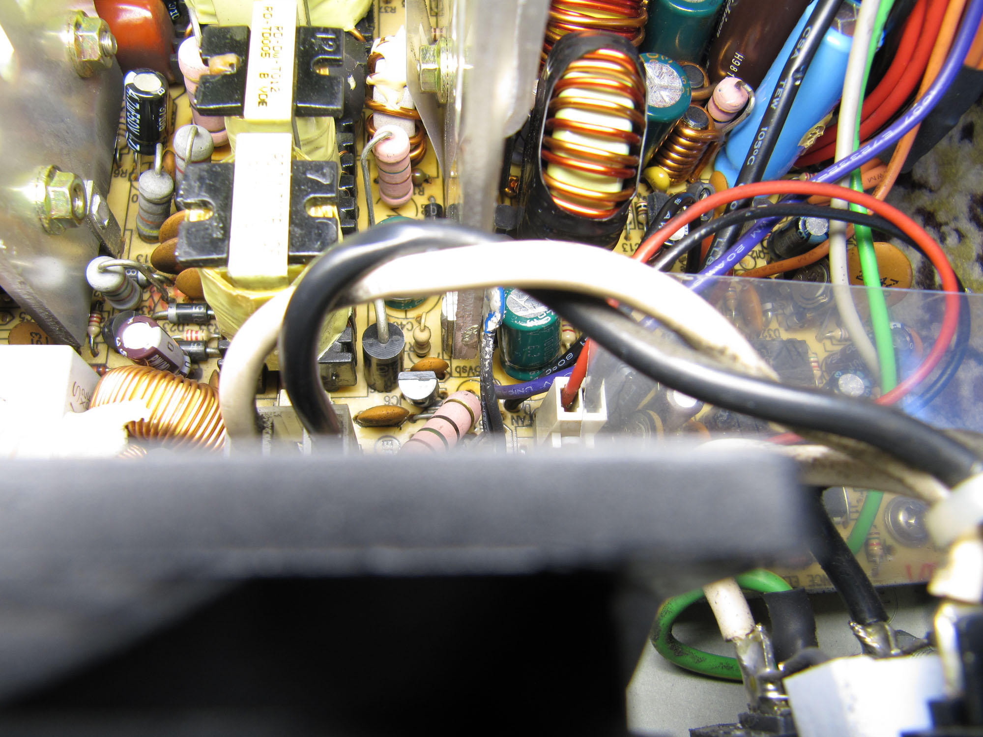

    The TNRs in the photos are in the feedback circuit and those are not stressed or heated, so I left them.

      Re: 3 power supplies from the past
      Good save!
      The 5VSB circuit looks interesting as I see Q1 has 4 pins instead of the regular 3. Perhaps a dual transistor of some sort? I wonder if it is a 2-transistor design or perhaps Q1 is actually an IC (like a TOPswitch or something similar).
      The only thing I would do extra is take a flat screwdriver and open the gaps between the heatsink fins. This should help with the heat dissipation a bit. But overall, it looks like a well-built PSU, so it may not need this mod.
        Originally posted by momaka
        Good save!
        Originally posted by goodpsusearch
        This psu doesn't have the typical 2 transistor circuit, as it uses a Fairchild 1H0265R Power Switch(FPS). I don't know if that means 5vsb is safe from failing or overvolting, but it's interesting to see that very old psus went a level higher from CWT motherboard killer Antec psus.
        The fan is in series with the thermistor, so it rotates fast enough to keep the psu cool.
          ^ Ah okay. Probably pretty safe from over-voltage then.

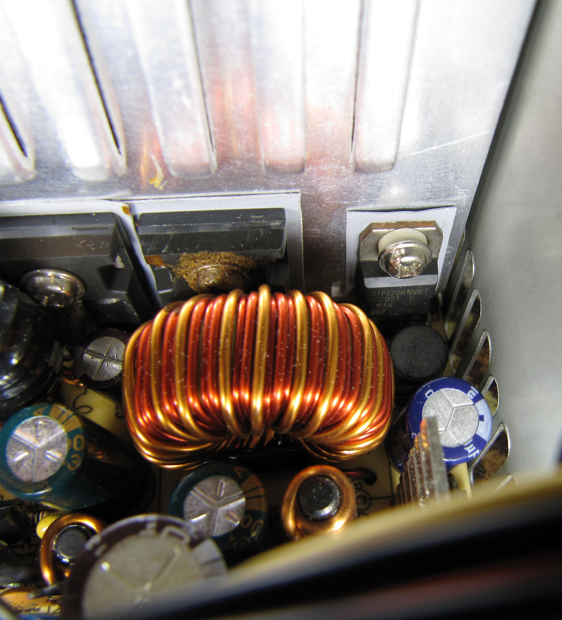

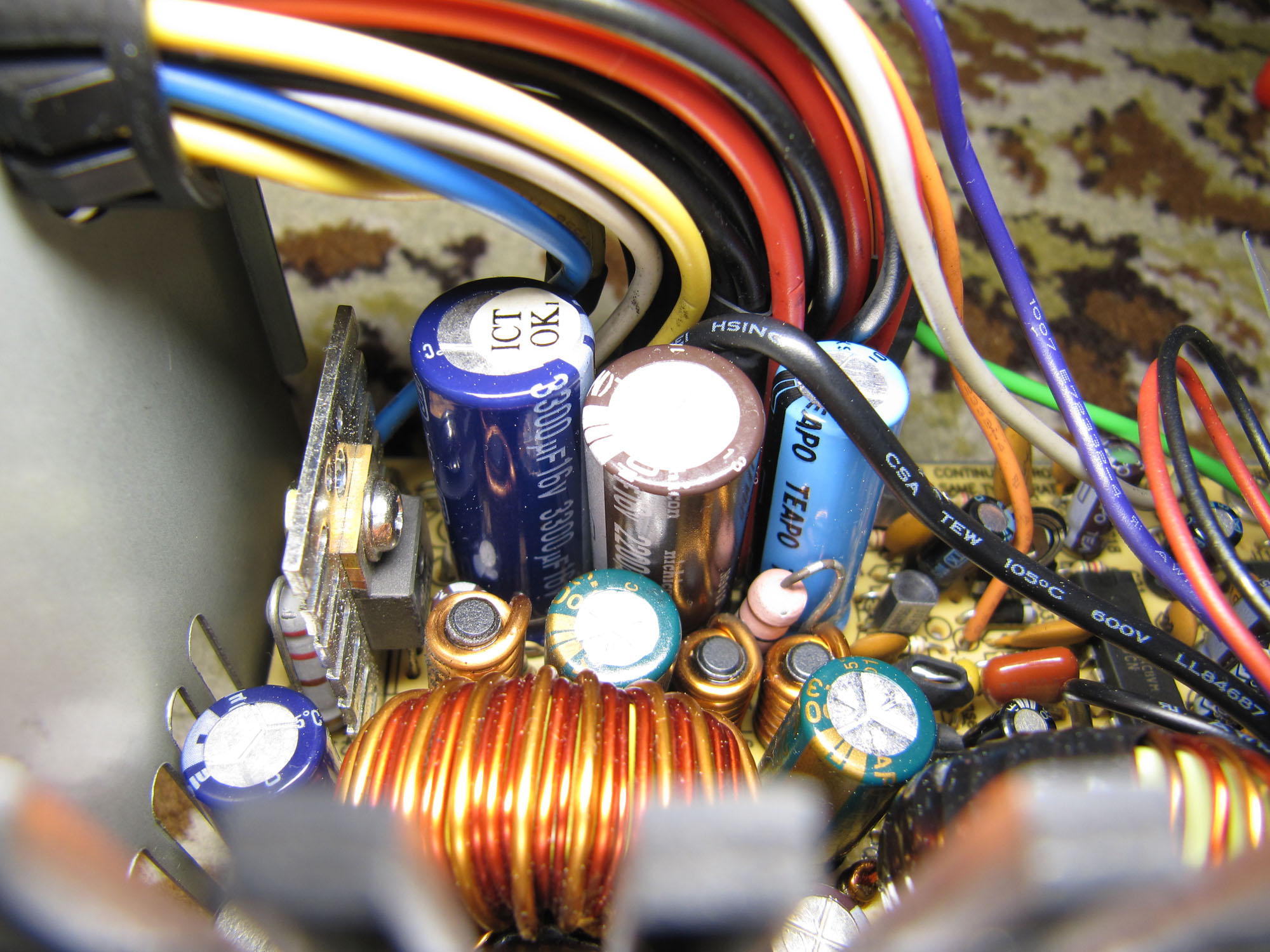

            I modded and recapped the Enhance power supply.
            Wester547 was right about the ADDA fan. It was completely dry and noisy! I oiled it using singer sewing machine oil.
            The fan speed controller circuit is designed to keep the psu cool. This power supply is not by any means silent. Even when completely cold the fan moves a reasonable amount of air.
            Another thing that I liked is that this unit's protections are fairly tight. With no load connected the 12V line settles at 10.7V, and the psu shuts down immediately. This does not happen with Linkworld psus or Macron. I have crossloaded them to the point that the voltages went clearly out of specs without shutting down.
            I replaced the BYQ30E-200 ultra fast rectifier, rated for 16A with STPS20H100CT.
            5vsb: 2x470uF 16V Jamicon WG --> 2x1000uF 6.3V Sanyo CG
            -12V: 1x470uF 16V Jamicon WG --> not changed
            -5V: 22uF 16v Teapo SEK --> 100uF 16V Teapo SEK
            3.3V: 1x 2200uF 6.3V Teapo SC & 1x 1000uF 6.3V Jamicon WG --> 2x 2200uF 6.3V Teapo SC & SX
            5V: 2x 2200uF 6.3V Teapo SC --> 1x 2200uF 6.3V Teapo SC & 1x2200uF 16V Nichicon PL
            12V: 1x 3300uF 16V Jamicon WG --> not changed
            I removed the glue from everyplace and used Arctic Silver Thermal Adhesive to permamently attach the thermistor to secondary heatsink.
            It works and the voltages are stable with 12V computer.
